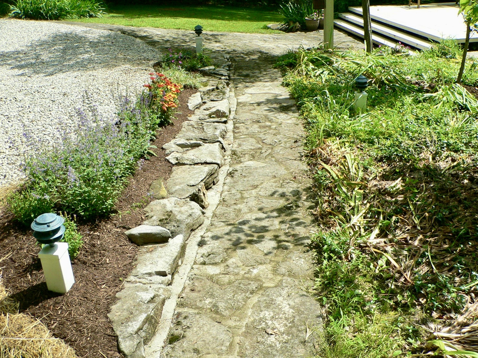

What did I do wrong with my flag stone path install?
   / What did I do wrong with my flag stone path install? #31
Leave the compacted base gravel in place. Set the stones in 3 to 4 inches of concrete with welded wire mesh. Grout between the stones. Will last for decades and no place for weeds to grow. I’ve done my flagstone this way.
#32
Yes, the soil is clay.
