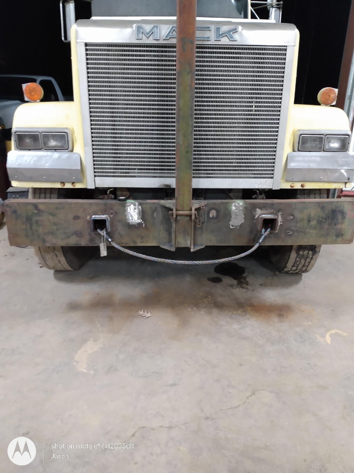

I have a Mack truck here and have been running it lately. Bought it ten years ago but haven't needed it. Fuel was 5 years old 10 years ago. We got it to put a log loader on the back of it, but the other truck kept going longer than we thought. It still cranks and runs fine. We had to put a front bumper on it with a fold up leg that holds the boom of the loader up as it goes past the front bumper at rest. Then we have to be able to fold it down to tilt hood.
