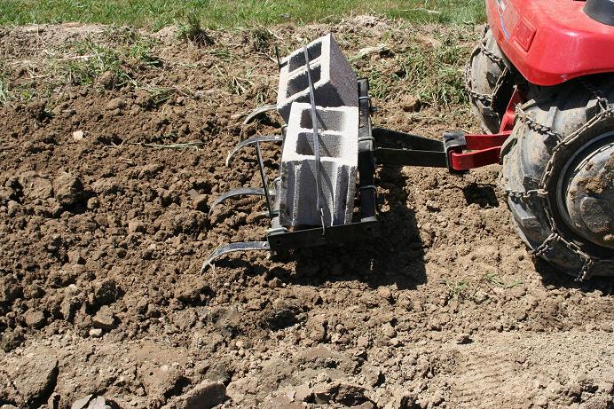

What brand tractor is that? is it a 3pnt hitch or something custom?
