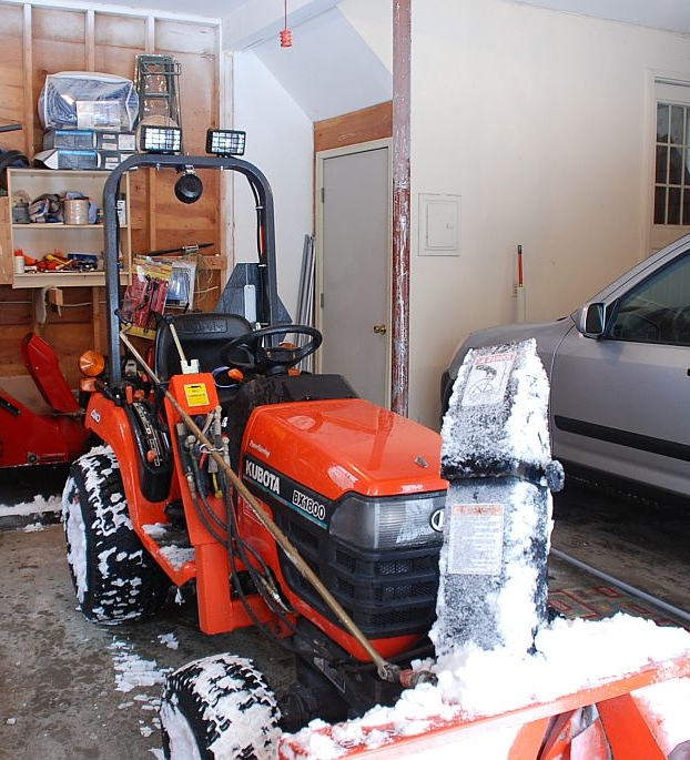

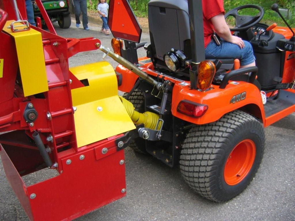

KUBOTA.- Hope the Pix helps as the last two Kubota dealers thought that the light was too much of a bother and recommended a cheep off the shelf light with no switch. Kubota ones with dedicated bracket and on/off switch on light do cost a little more, but the connection point is power on with ignition on. $65 dealer option. Now after getting the right light for the project, at my determination, the last dealer is probably going to stock in the future. I chose the mounting point, which might be lower than the instructions. There is enough wire to mount any where on the ROPS. The lamp is factory mounted with the eye brow in the vertical position. In pretty much any location on the rops the light needs to be mounted on its side. Don't take it apart to make the glass beam pattern correct. it is spring loaded and will rotate. Ignore the eye brow position of the outer black casing, and enjoy the function ability. I only wanted a reverse light when plowing snow and dealing with three point equipment at night. I think that it was the ticket.............Enjoy..

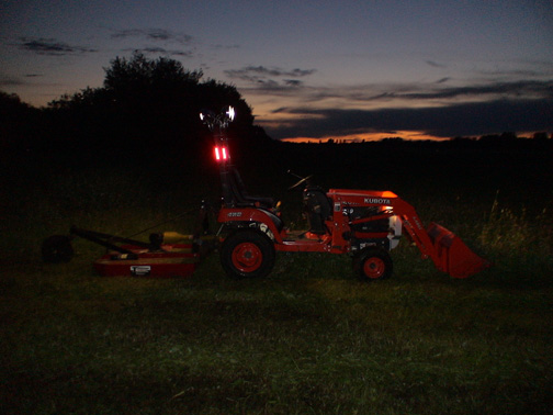

I put these on. They are a discount no name chinese lights 100w and they are great!
Close.jpg A close-up Side.jpg From the side Fore.jpg Hard to tell in daylight On.jpg Here they are a twilight.

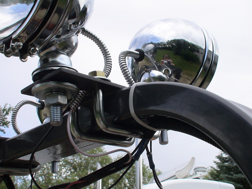

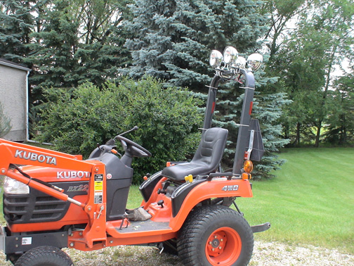

I mounted two 100 watt Generic lights on top of my ROPS and one 50 watt pointing to the rear under the first two. The lights have replaceable bulb inserts, so the light housing never changes. I don't have them on all the time, but have only noticed a problem with battery drain when operating with every light I have available at night (and I only have them all on when near the road, so it's not constant.) One bad storm required being lit up for a couple of hours and the next morning I had a flat battery. This spring I bought a new DieHard (AGM) battery and have it on a battery maintenance system....also new. I went 5 years before buying the new battery and felt good about that, but suspect I could have done much better if I'd had the maintenance system over those years.
You can find alternators for your tractor easily and I think most threads price out needed wiring, alternator, do-it-yourself installation, etc. at around $180.00 and there is one thread detailing step by step installation. I asked my dealer to price a Kubota alternator (40 amp) last week and he quoted their price as $330.00. I also checked Messick's and a brand new alternator with necessary wiring can be had for around $280.00. The new battery for me was over $100.00, but I felt good about getting 5 years out of the first one. With the maintenance system, they are predicting many more years of service from the new battery, but I'm skeptical. Dyer, retired

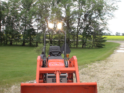

On my l3400 I have the foldable ROPS. There are two factory mounted nuts welded onto the lower portion of the ROPS. I checked the size and went to walleyworld and bought a set of BLazer 55 w halogen driving lights. using a standard switch i mounted them today and ran all of the wire in loom and it looks very professional. i also mounted another 55w light facing the rear on the fender. at night I dont plan on running the factory lights because they aint worth nothing with a fel. i can try and get pics later
