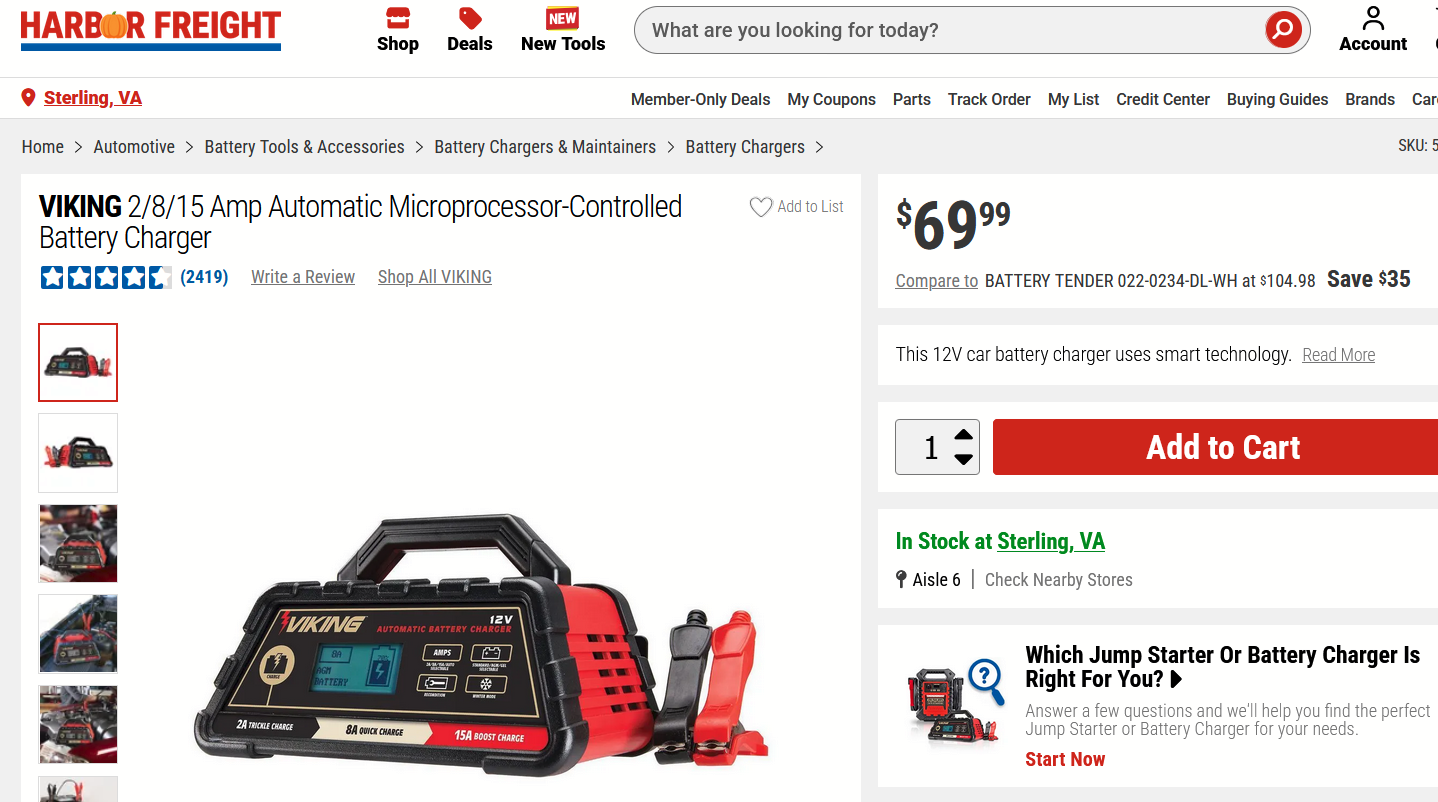

The only AGM battery I might have would be inside my computer Universal Power Supplies, and by definition those units contain the charger. But, the last 10 amp battery charger I bought - from Harbor Freight about five years ago - has a switch on the front to go from "standard" to "AGM."
