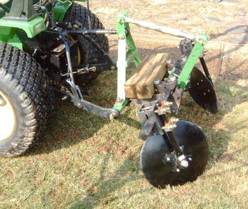

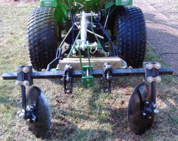

I created a disc hiller by mounting big, 45 degree opposed discs on an old JD soil ripper diamond bar. Agri Supply has a similar frame and the discs to purchase. They call the frame a Keulavator.
Attached are pictures of mine.
My little 18.5 hp JD pulled these fine. Your bigger tractor may be a tad wide for doing a single row. Mine is great.
