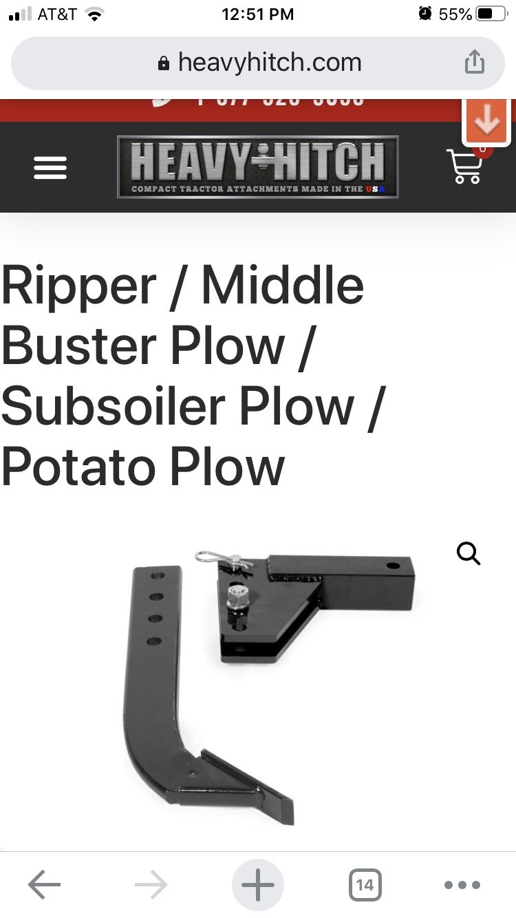

Hi, folks.
Has anyone attached anything resembling a "potato plow" (or middle buster) to a 1.5 or 2" tool bar (i.e. Keulavator)? I'm working with a local metal worker who may fabricate a tool bar that resembles a Keulavator for my Kubota L3400. Among other modifications, I'm thinking of asking him to extend the tool bar thru the center (the Keulavator, on the other hand, leaves a space in the middle so that the implement clears crops in-row). I'd like to occasionally mount a middle buster-like plow to this center portion, namely for digging potatoes (but also for furrowing before planting). I'd only be pulling this "potato plow" thru loose soil (that is, not breaking new ground). Has anyone mounted a similar plow/middle buster on a standard cultivator shank (spring shank)? The bolt spacing is adequate for the potato plow that everythingattachments sells but I wonder how they'd work together? I'm curious what you folks think.. thanks for your time.

It seems like I saw something along those lines on a YouTube video. Not sure whose channel or what product. Seems like it may have been a heavy hitch item they reviewed bu far for certain on the brand.
The biggest issue I would foresee would be the possible extra wiggle from the receiver tube in addition to the sway linkage. You could end up with quite a bit of side to side movement.
Decided to check my memory and found this on Heavyhitch.com.

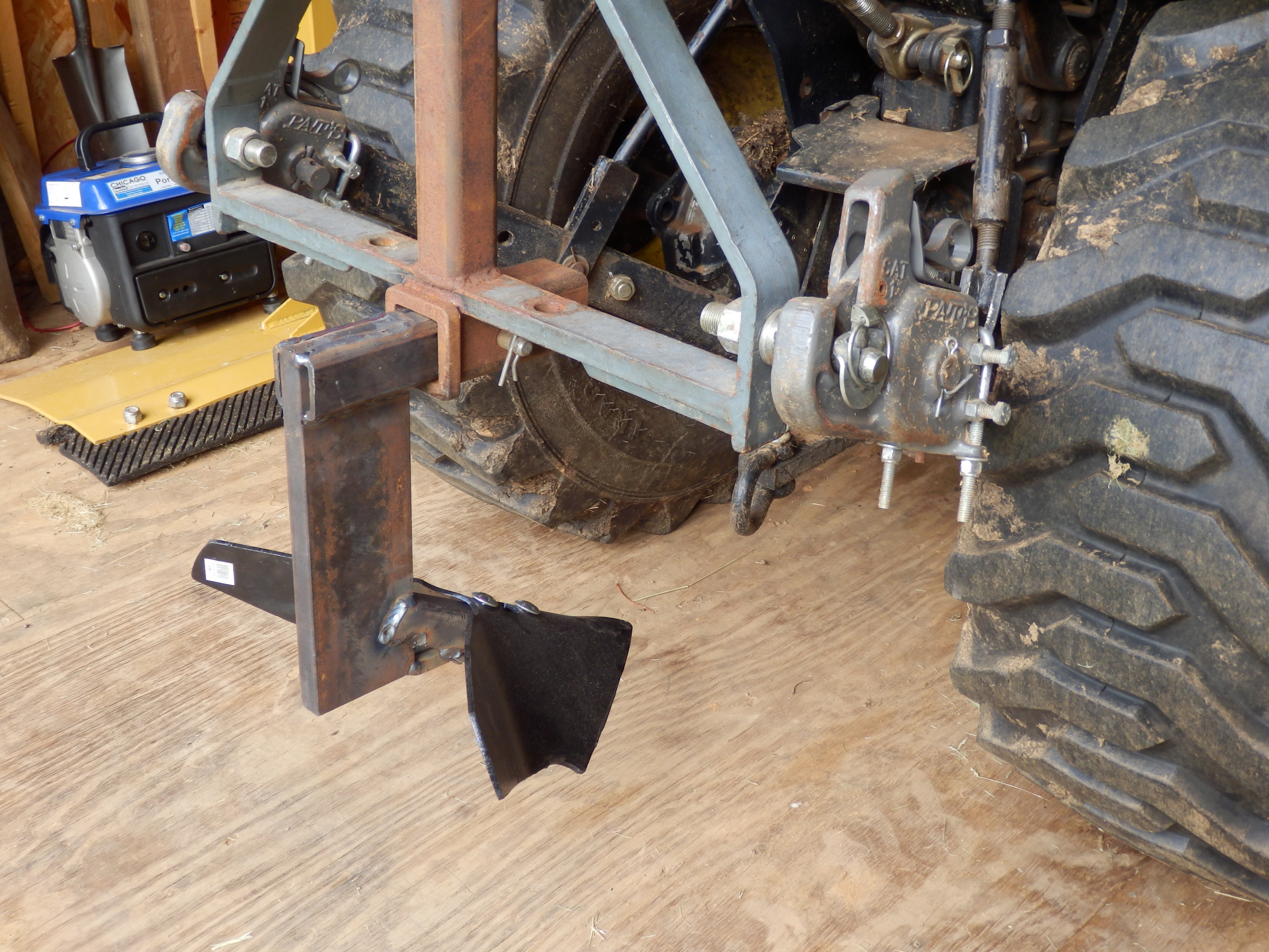

I’ve used this setup a few years now for furrows to plant in and for digging. It works great . No excessive side to side sway as P9111579.jpg
mentioned by one commenter. It was welded together for me by an Amish friend from a conventional potato plow share and some 2” receiver stock. P9111580.jpg
