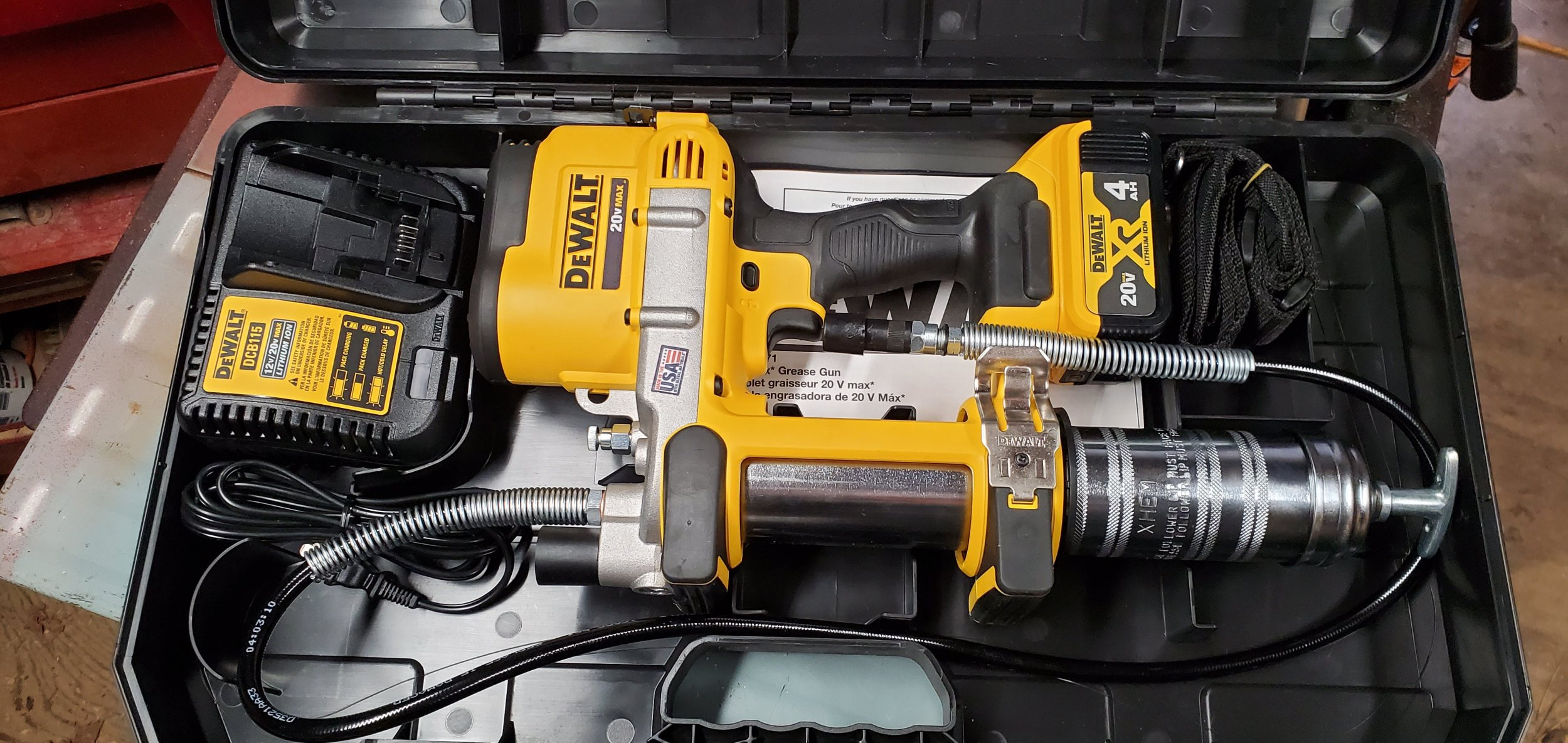

Tractor Supply grease and a Dewalt grease gun.

The Bauer20 volt cordless is the mirror image of the DeWalt for a lot less but something I'm not interested in anyway. I find them to be messy and they don't hold much grease anyway. Never been a tube grease person, in fact, I bulk load the lever guns I keep with my implements.
I tried using my manual grease gun, but between the loader and the backhoe it was just much easier and faster to use the battery powered gun. There are just too many grease fittings to do manually in my opinion. I bought the Dewalt because I have other Dewalt tools that use the same battery.
