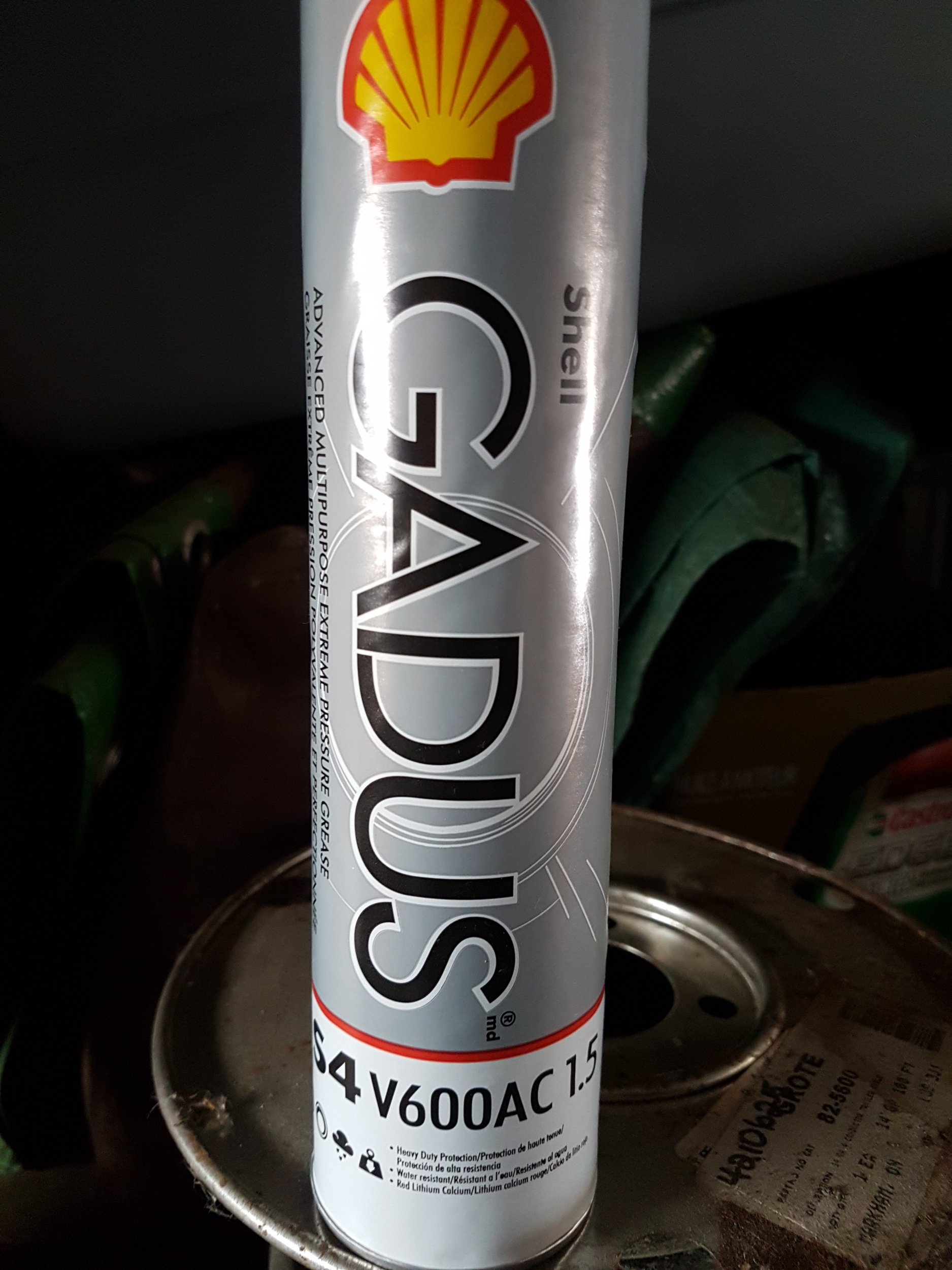

This is the grease I use. I like it because it's water resistant and u-joints last a lot longer. It's also fairly thick and seems to stick around longer than a thinner grease.

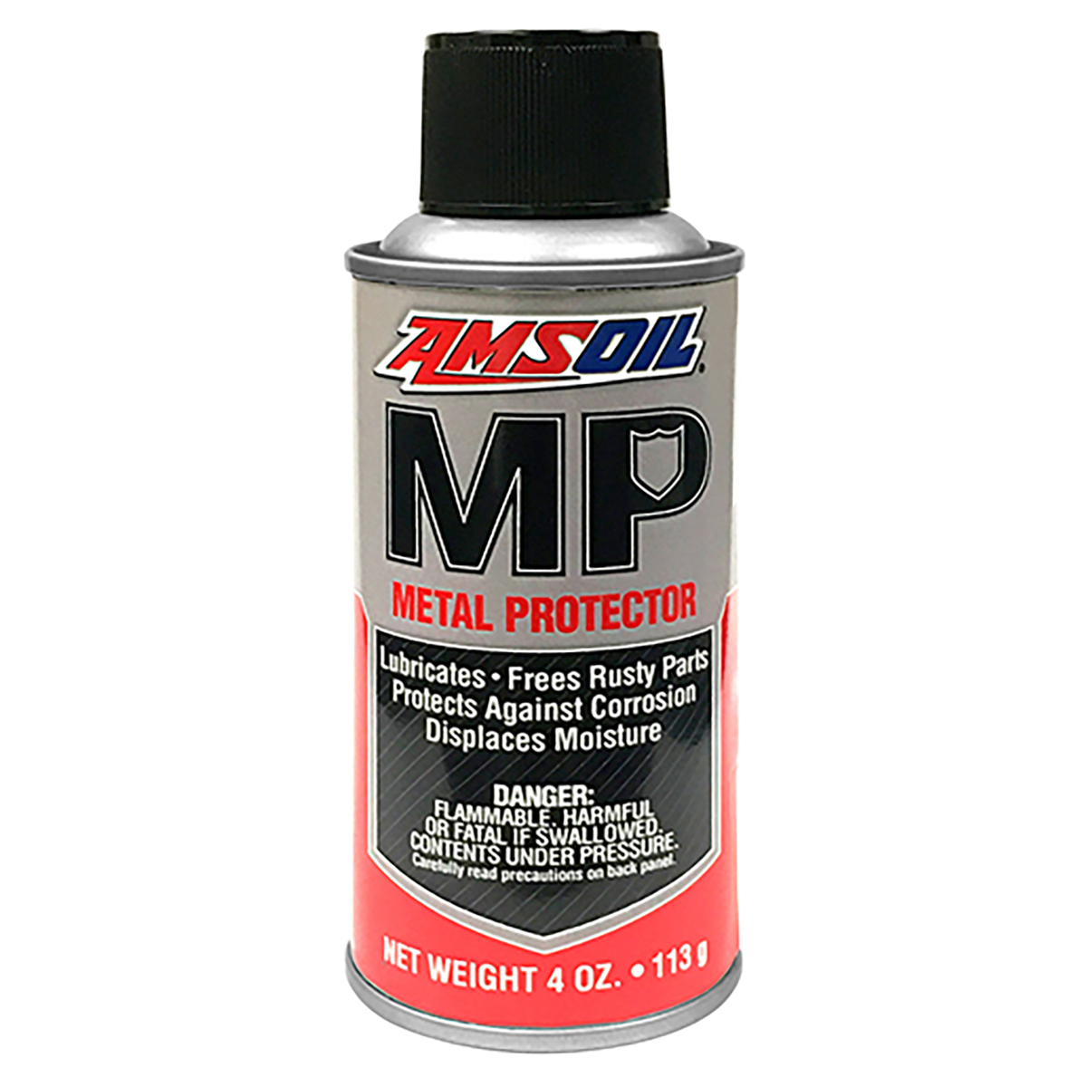

Shell Gadus S3 V220C Red hi-Moly grease NLGI 1, 2 and 220 Viscosity grade. (Caterpillar Spec) for all Zerks on my machines. I have it in all my lube guns as well as in tubs for pto shafts and open lube parts.
This is the only grease I keep around for EVERYTHING! trailer bearings, ball joints, loader pins, hinges, pedals, spindles, bushings ect. this grease will do it all and outperform most anything on the shelf. It is red, tacky, and stays where you put it. A case is $70 on amazon for 10 tubes.
Everything else gets Fluid Film or Amsoil MP.
