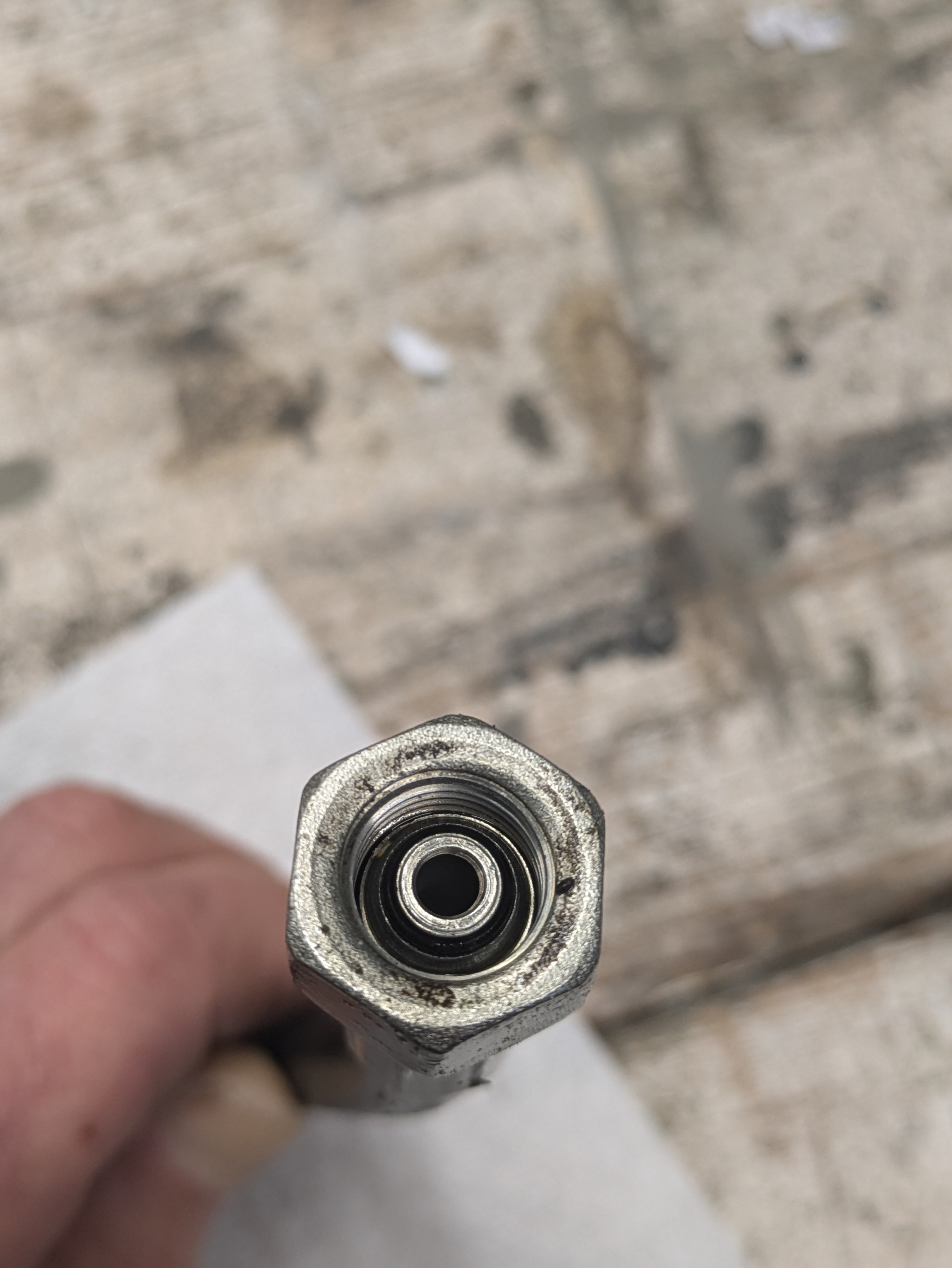

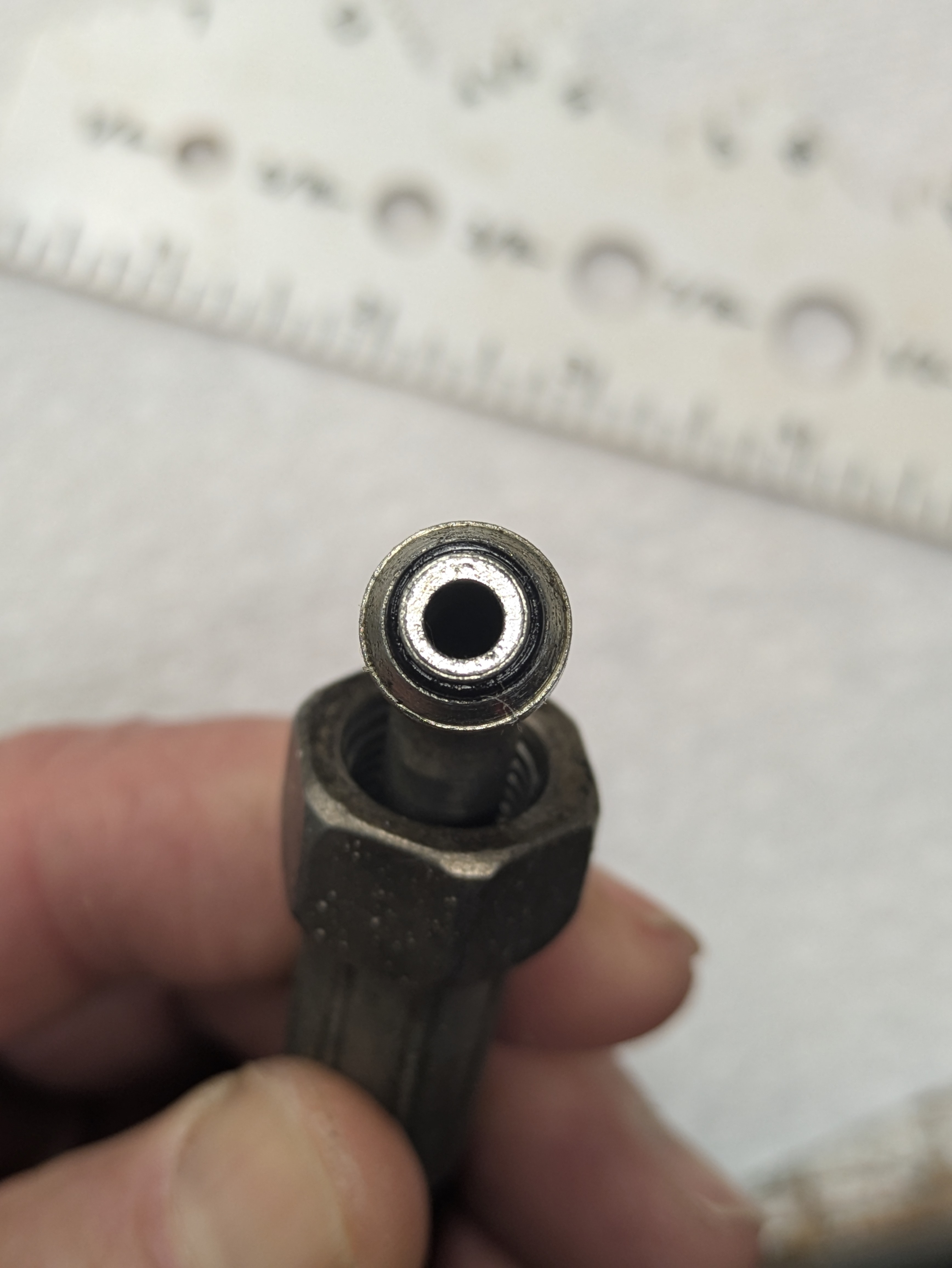

What are these hydraulic fittings called
   / What are these hydraulic fittings called #21
1/4 bsp

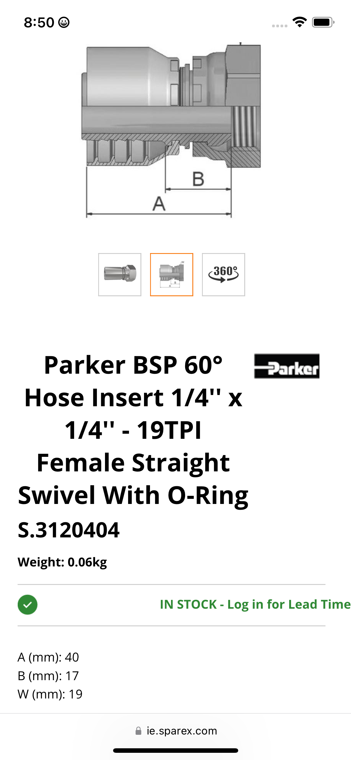

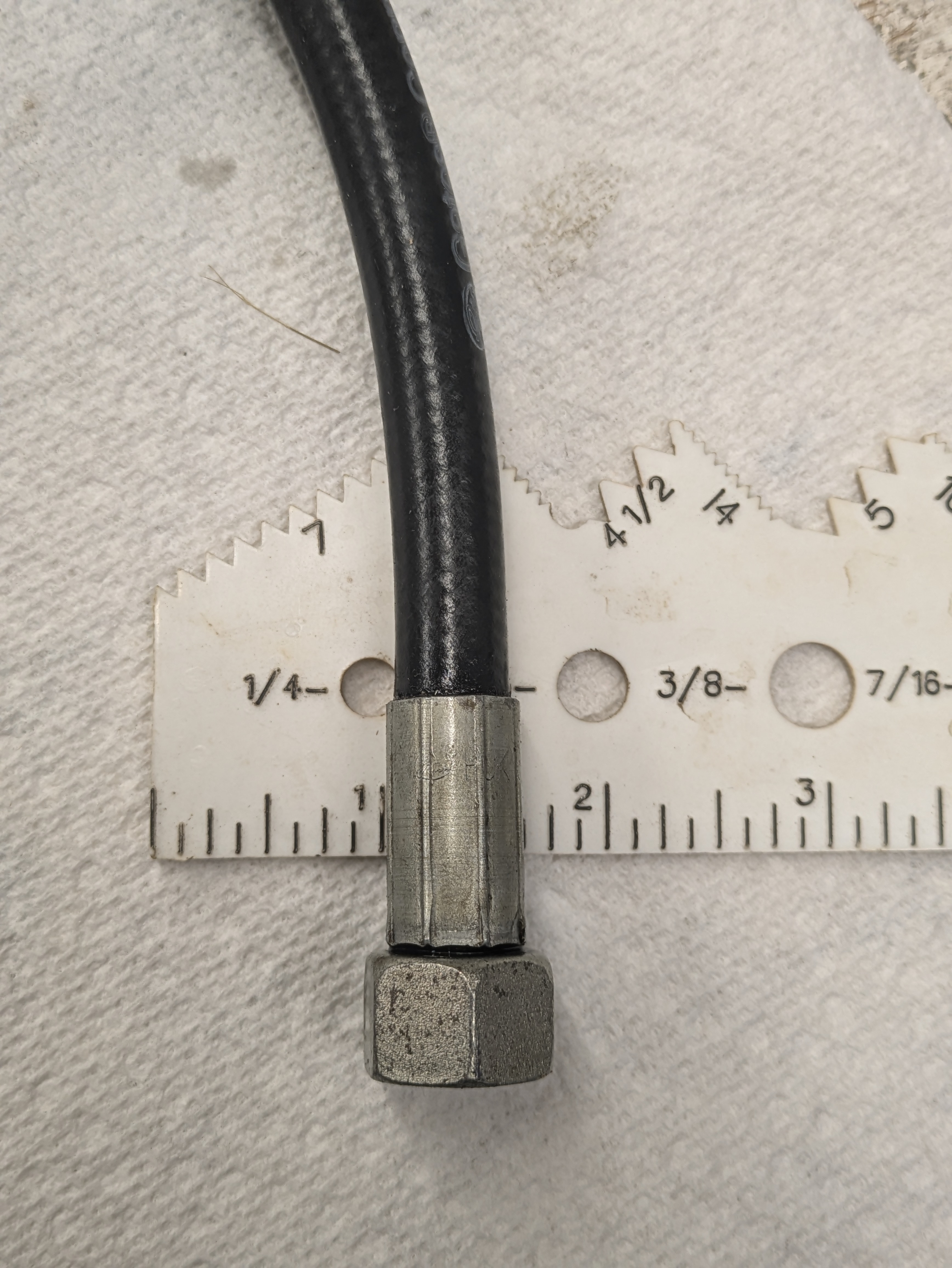

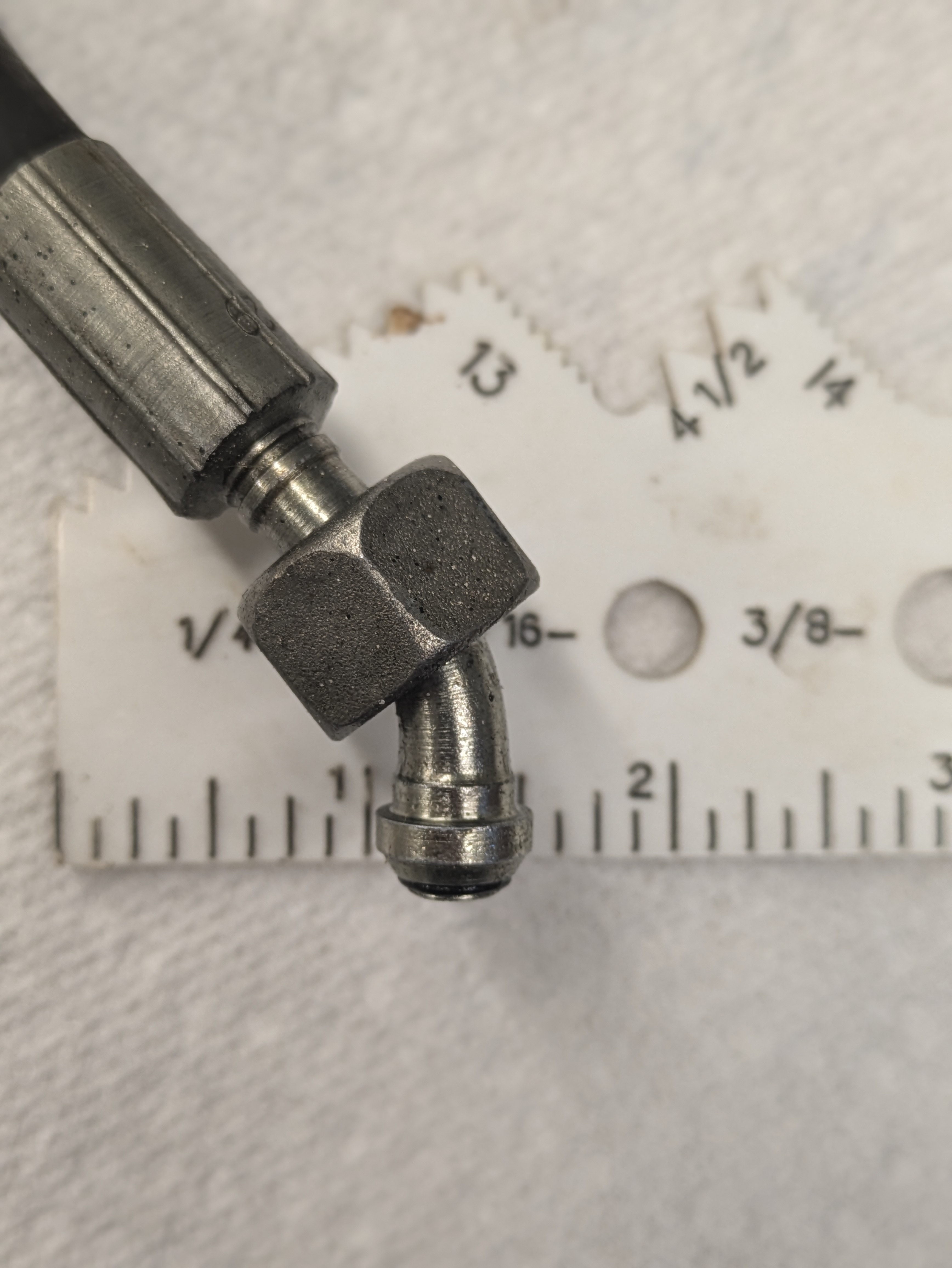

I fix a lot of hydraulic hoses. If it is a Kubota tractor, it is more than likely British. Looks like 45 deg. bend in one end. If it is a 1/4'' hose it is probably 1/4 '' British female pipe swivel. They do make jump sizes, but they are rare and expensive.
   / What are these hydraulic fittings called #30
Since we can’t measure it or check the thread pitch I have two suggestions. First is to look at an old invoice that may show the part numbers they used to make the previous ones. Second is go to www. hoseandfittings.com and look at their selection which is where I get mine when I can’t find them anywhere else. I have bought lots of metric conversion and other fittings there.

They look like BSP (British Standard Parallel Pipe,) fittings to me! I use them quite a bit! Especially if your machine is English made!
Or Chinese made. I have those on a hydraulic hose crimper I just bought. I'm changing the pump configuration so I can also use my air-over hydraulic pump. It's also using ~5/16" ID hose so it must be metric something or other. My guess is BSPP also. The male side looks like just a tube with a short taper on the entry side. The side that's being held in the OP's pictures is the female side.

I had a hose made up at the hydraulic shop, $85. The invoice has some crazy part number so I still don't know what kind of fittings they are. He did say they don't use that style fitting with orings any more, they just ended up leaking.

It is probably a common JIC connector, which has a 37-degree bevel and is suitable for hydraulic systems and has good sealing. If it is not a JIC connector, it may be a metric or BSPP connector.
