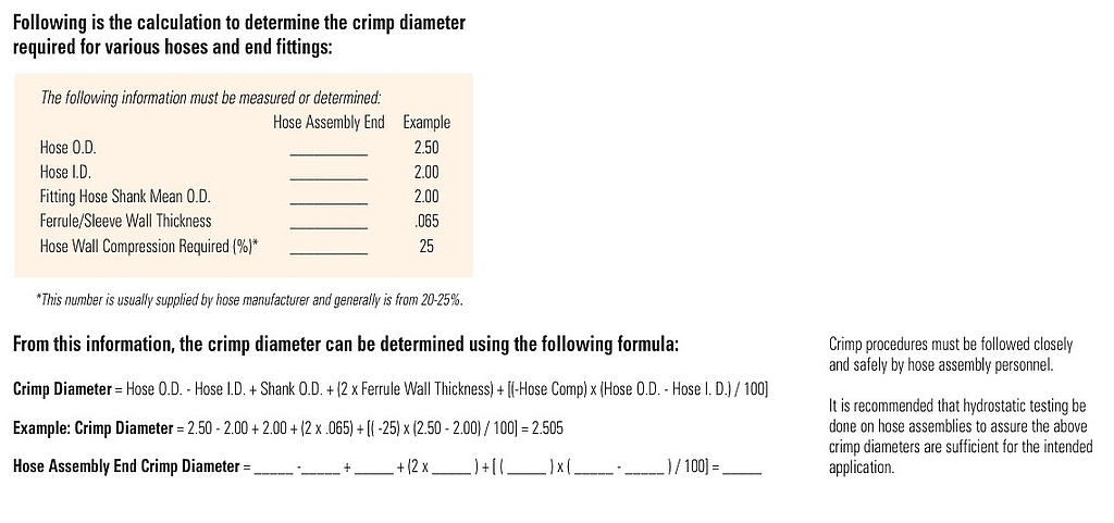

Since you'll likely be using various brands of hose and hose connectors without specs, get familiar with the hose crimp formula. (Shown Below) It's imperative that you come within +/- 0.005" on the crimp diameter. There's a phone app out there to do the calculation but it only works for Apple phones. So, I downloaded Excel to my Android phone and created a worksheet with the calculation. You can use metric (mm) or inches in the calc but stick with the same throughout.

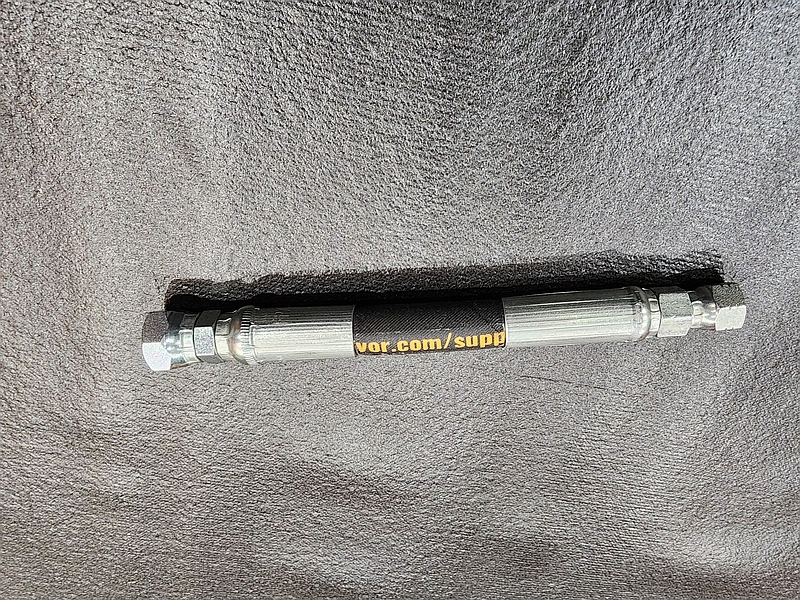

I posted a picture of one. I made it 1/2" too long so I made another. The other one is mounted on the crimper. It took a trial of around 5k psi and had no leaks. I don't see the crimp gauge go past about 2k psi on a normal crimp. I could have gone higher on the trial but didn't want to crush one of my sockets.
The test crimps don't look like they should because I used 16mm dies instead of 14mm and turned in the micrometer to compensate. The higher the die size, the wider the footprint on the die. It worked but this is not something I'd do on a regular basis. I did this to get my crimper back together.

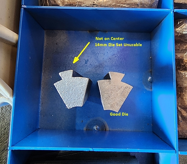

I hope you get one soon. What was wrong with the ones that came with it?
The key on the back of one of the 14mm dies was not centered (see image). This made the whole set unusable. They sent me two replacements but those were 16mm dies. I'm now waiting for a complete new 14mm set. If this turns out to be a bust, I'll machine down one of the 10mm dies to be a 14mm and leave my scathing review.
The radius on the crimp side is about 7mm. The dies are pretty hard, but I've got a 1/2" round-nose carbide end mill that should come pretty close.
someone sure missed that on QC imspection. Was all 8 like that? Hope you get them soon.

No, it was just one, but you can't use it or the rest without one die. The dies are pie shaped so they come together when crimping. The offset key would cause one side to contact the adjacent die before the crimp is complete. It would probably break the keys off or break the press. The press segments that hold the dies float on a tapered piston.

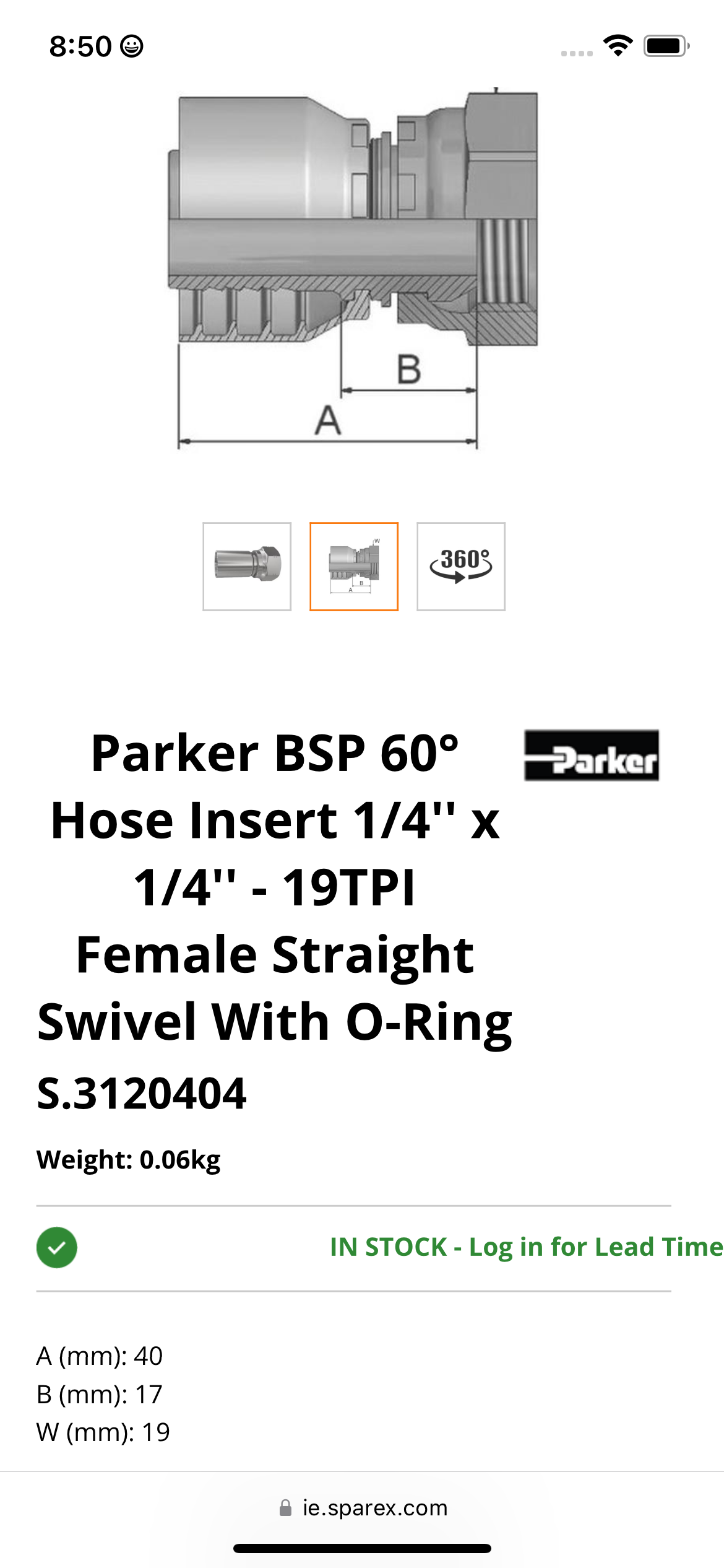

How about BSPP. If you are sealing on the o-ring you don't want a tapered pipe thread.

I've been buying the Vevor brand hose. I have 1/4, 3/8 and 1/2". It has very good specs. I used the 1/4" hose on the hose press and ran it to over 5,000psi. That's 25% of the burst rating. I plan to use it on my air over hydraulic pump as well.
What you have to watch is the inside diameter of hose fittings. Many of the "brand-name" fittings are custom sizes for their custom hose. It's a scam. The type of hose also matters (R1, R2, R7, etc.). You need to know the outside diameter of your hose as well as the inside diameter of the fittings you buy. Don't buy either of them if the specs aren't provided or don't come close to fitting (.001-.002"). The crimp size can be determined by the formula provided in a previous post above--You can't use the "brand-name" charts for crimping unless you're using their materials.
