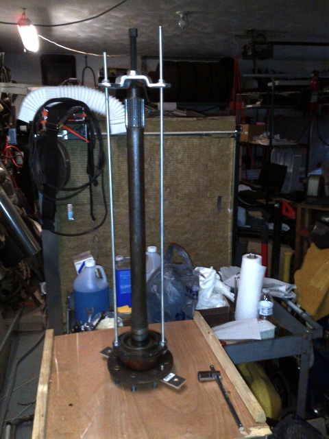

No love so far trying to pull the bearing + bearing retainer casting. Started out with two 3/8-16 threaded rods going through the casting (the stud holes are 7/16-20, so the 3/8 just passes through) and the other ends through a "chicken footprint" puller head from my slide hammer set (which I took the excuse to buy while working on my boat's lower unit):
Cranked on the center screw and the puller wanted to lean one direction, so I switched over to this other head I had from a steering wheel puller kit that had three of the slots 120 degrees from each other and tried it with three equally spaced threaded rods through the casting. The puller head stayed flat, but nothing was budging down at the casting/bearing despite cranking on the screw with a 2' breaker bar and a long piece of strut channel acting as a de-rotation bar.

Coyote machine - I've got a 20-ton shop press like that in the garage. Flange on the axle shaft won't fit through the C-channels of the table. I could support it above the table, but that would require a semi-elaborate fixture to hold everything and get in between the axle shaft flange and the bearing retainer casting.

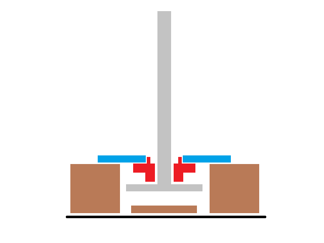

shona - something like this? Axle shaft is gray, bearing retainer casting is red, that flange you were talking about is blue, and the brown pieces are wood.

G'Day dbotos.
That ,s the idea .
I would put the blue under the red and press down on the axle shaft. This should press the shaft down, and the red bearing retainer up off the shaft's bearing 'seat'. Does that make sense to you?
