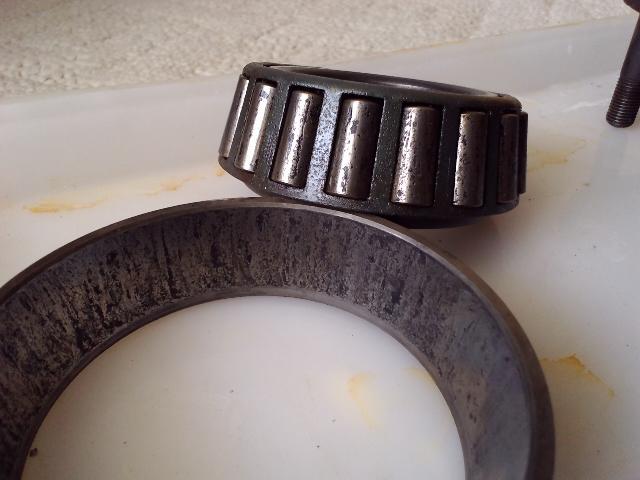

Thanks! I'm glad it's apart and that the casting is intact. Even if I'd had to make the press plate by other means (torch/drill), it definitely would have been worth it. It was also handy for getting out the outer seal and the bearing cup. The 5/8" thick steel seemed adequate. The bearing cup and rollers have corrosion, so I'll be shopping for new ones of those:
Cone is a 3795 and cup is a 3720.
   / what are the four holes for in the bottom of the TO-30 differential case? #102
Yeah, those puppies are shot! How'd you get the race out?

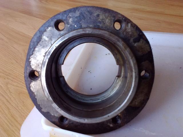

The casting has two convenient notches (180 degrees from each other) in the shoulder that the cup of the bearing seats against. Had the casting supported by the press plate on wooden blocks and used a scrap aluminum rod to tap the cup out with alternating hits in each of the notches.

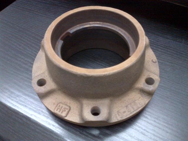

Last night I clean-up machined the major OD and outboard end face of the casting. Today at lunch, I masked the ID, sandblasted, removed masking and washed, and put in the oven to outgas. Here's what it looks like post-outgas:
My carb had a similar bronze/gold tinge to it after outgassing.

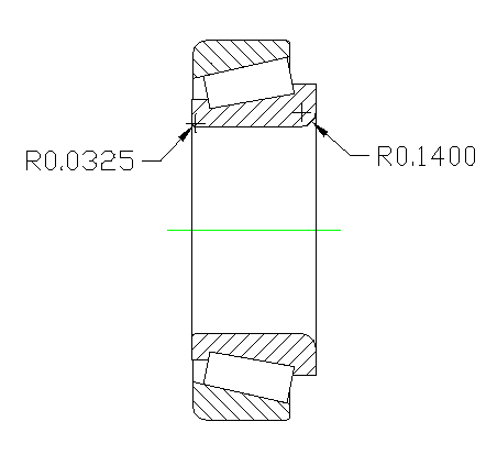

To make a long story short on my search for a replacement bearing, Sparex lists the cone as a 3780 (in contrast to the 3795 I took off the shaft). A call to Timken regarding 3780 vs 3795 difference said the 3795 has a "special frontface radius" (which translates into layman's terms as "this bearing will be more expensive than the more common 3780"). Their CAD file says the 3780 is about a 1/32" frontface radius and my measurements (of bearing and shaft) say the 3795 is about 3/32". Sent email back to confirm with their engineering (since the CAD file I downloaded for the 3795 has the exact same frontface radius as the 3780).
As to why the Sparex catalog says the 3780 bearing fits the TO-30, I'm guessing Ferguson may have changed the radius on the shaft at some point and earlier models did in fact have a smaller radius where the shaft jumps from 2" (bearing ID) to 2.375" (outer seal ID). Mine's a '54, which was the last year of the TO-30s, so it seems plausible.
Here's what the 3780 / 3720 cross-section looks like (0.140" is the backface radius, 0.0325" is the frontface radius - which is the one that matters in this application):
