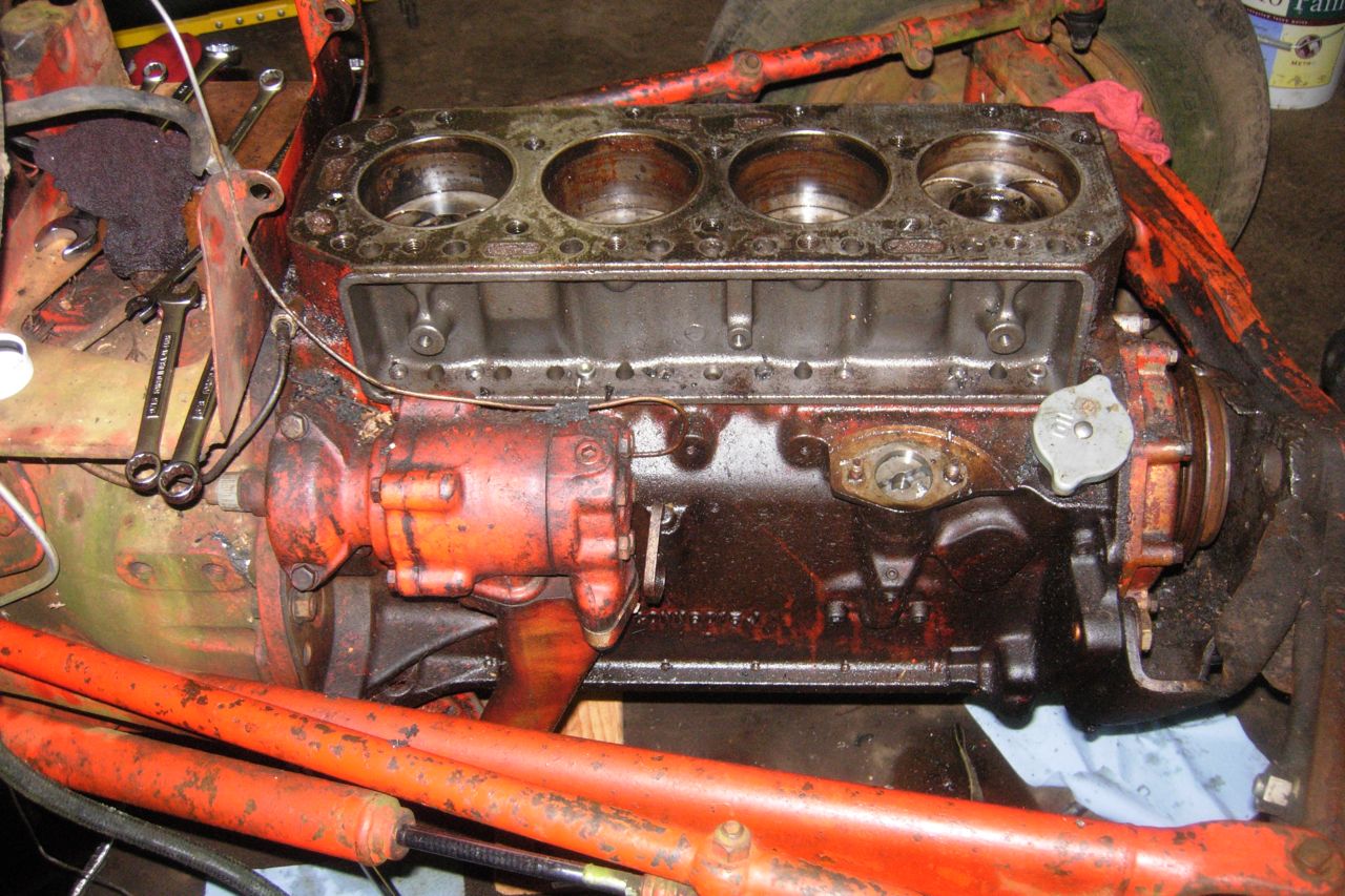

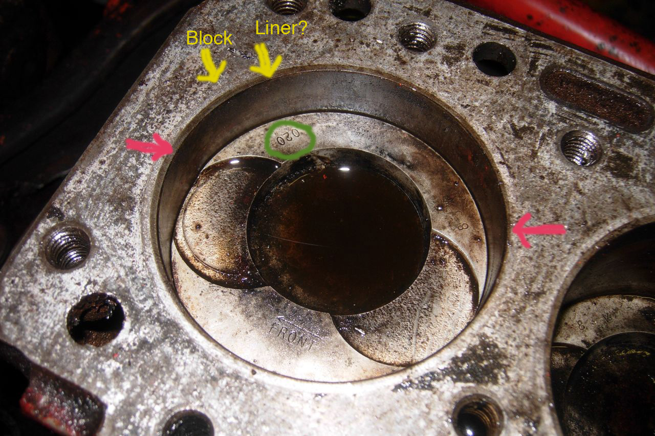

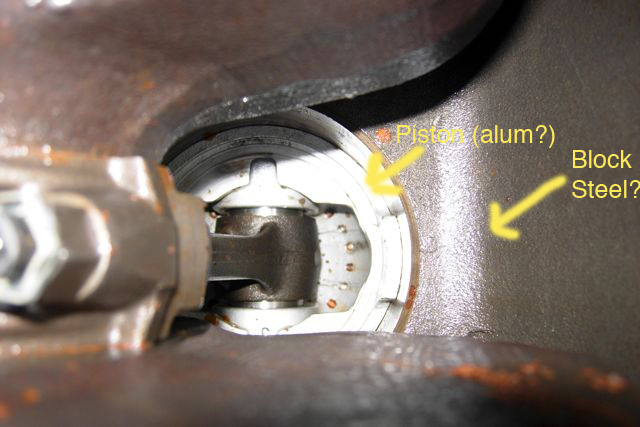

I think I'm following you around TBN danno1. Good question about the block. I know that these blocks did not have "liners" per se and were directly bored, however there does appear to be two different metals (based on color) that comprise the "block" and the "cylinder" (see pic). My engine was clearly rebored larger by 0.02 (stamped on the pistons; green), but the bores seem to stay within the original cylinder, but rebore was not quite centered (red arrow), likely intentional.
If you look at the underneath pic I've highlighted in yellow the piston and block. To me the pistons look like bright shiny aluminum; block looks like steel.
I suppose this really doesn't matter for using heat to induce metal expansion, but it's an interesting thought exercise based on several assumptions (never a good mix). Nevertheless, unless I'm mistaken, if you were to heat the pistons directly, being aluminum they would swell up more so than the cylinders and it would be even harder to get them out.
dunno. . danno1 :)
Pete
Based upon engines that I've rebuilt, the darkened area at the top of the cylinder you indicated with red arrows is most likely caused by the head gasket being just slightly larger than the bore and exposing the metal to heat. The "off center" is due to sloppy fit of the gasket on the studs/bolts.
/ What am I looking at?
#43
That's really interesting orezok. Let me see if I understand what you are saying. Basically, if the gasket was actually "centered" properly over each cyl and the diameter of the cutouts was matched to the cyls, the block wouldn't have "suffered" from excess heat exposure and we wouldn't see the darkened rings. This also means that there is really nothing "structural" would stop me from reboring, if necessary due to rust, etc., to 0.04 or even larger (assuming I can by properly sized pistons).

TYMinColton - take a wire brush (preferably a power one) and run it over the area. It will most likely all turn the same shiny color.

You can over bore right in to the water jacket. I wouldn't bore past .040 oversize, and I would sugest you take the block to an automotive machine shop to have bored. To remove .020 with a hone can be done, but it will be a chore.

Agreed. I was merely thinking ahead a couple of steps. I honestly have no desire to bore a block myself. In fact, if possible depending upon the condition of the pistons/cyl, I'll most like hone out the cyls, clean 'em up, replace the piston rings, and fire her up. There's some cyl pitting, but I suspect its somewhat cosmetic and she'll run - just burn a little oil. overhaul kits are available for several over sizes, but they're not cheap!

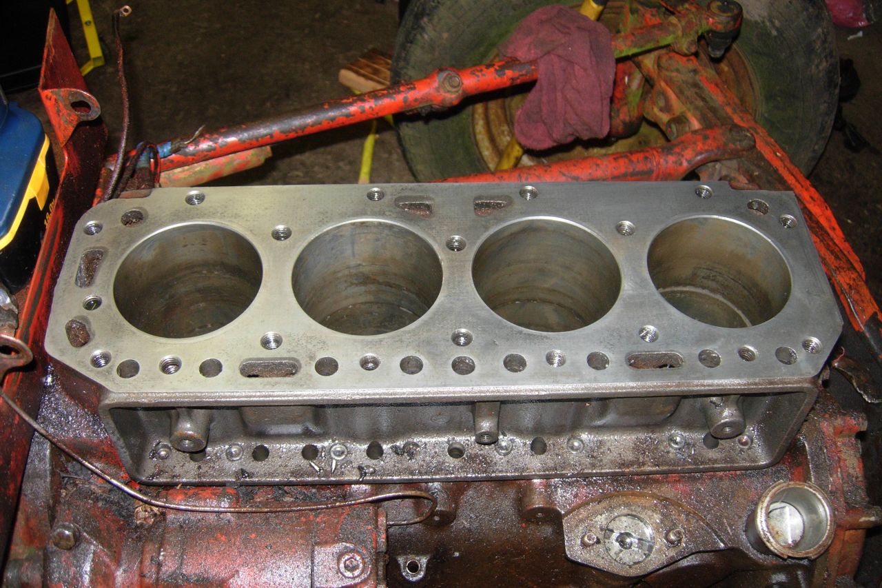

Here are some before and after pics that bring the whole engine rebuild project up-to-date.
The Block before (pistons still stuck).

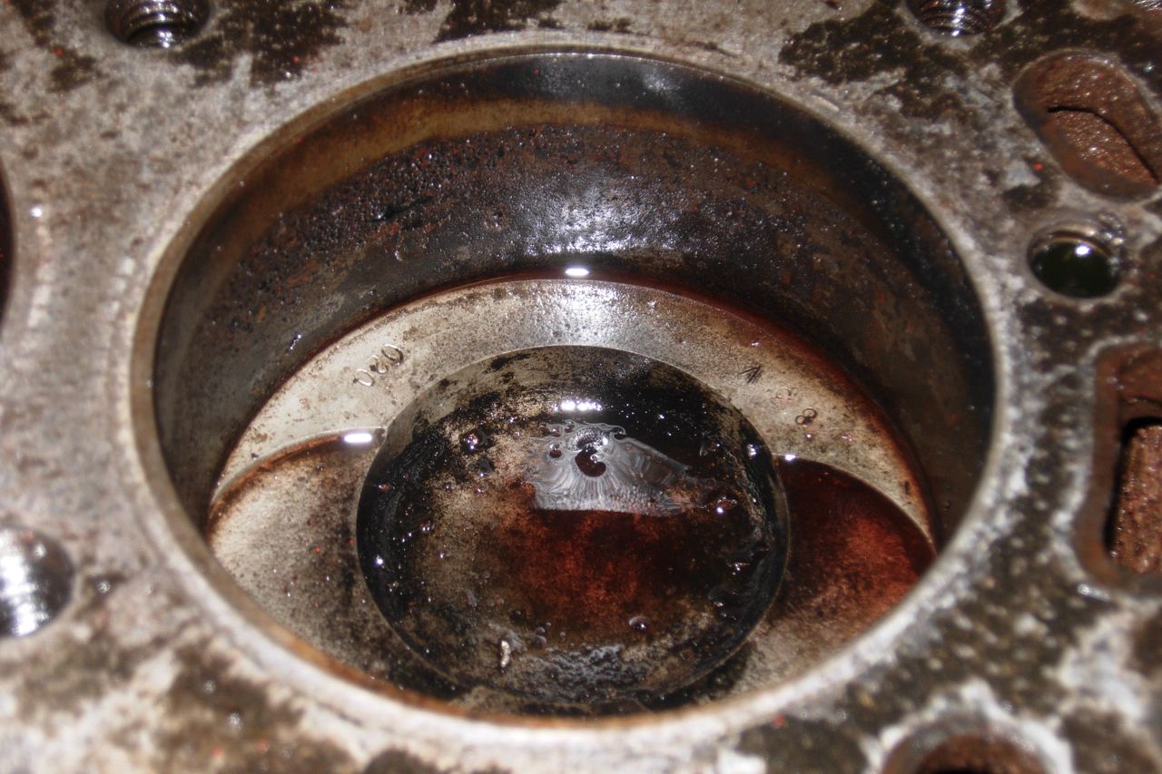

After piston and gasket removal. There still some work to be done on the cylinders, including honing. Interestingly, the camera flash really highlights some cyl wear that isn't obvious to the naked eye.

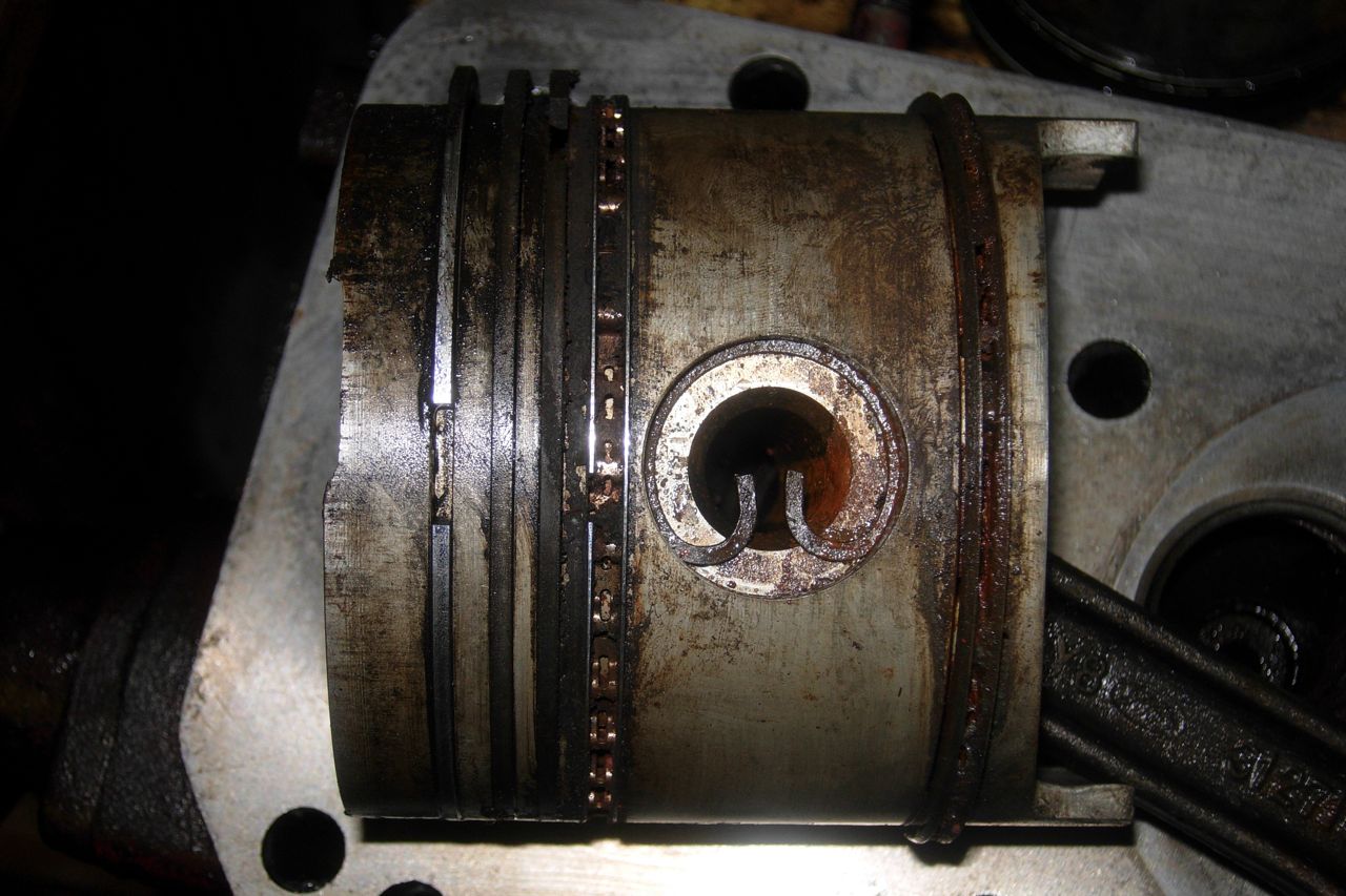

Now an example of one of the pistons. Lots of buildup on the oilers (??). Rings will clearly have to be replaced since I broke several freeing pistons from the block.

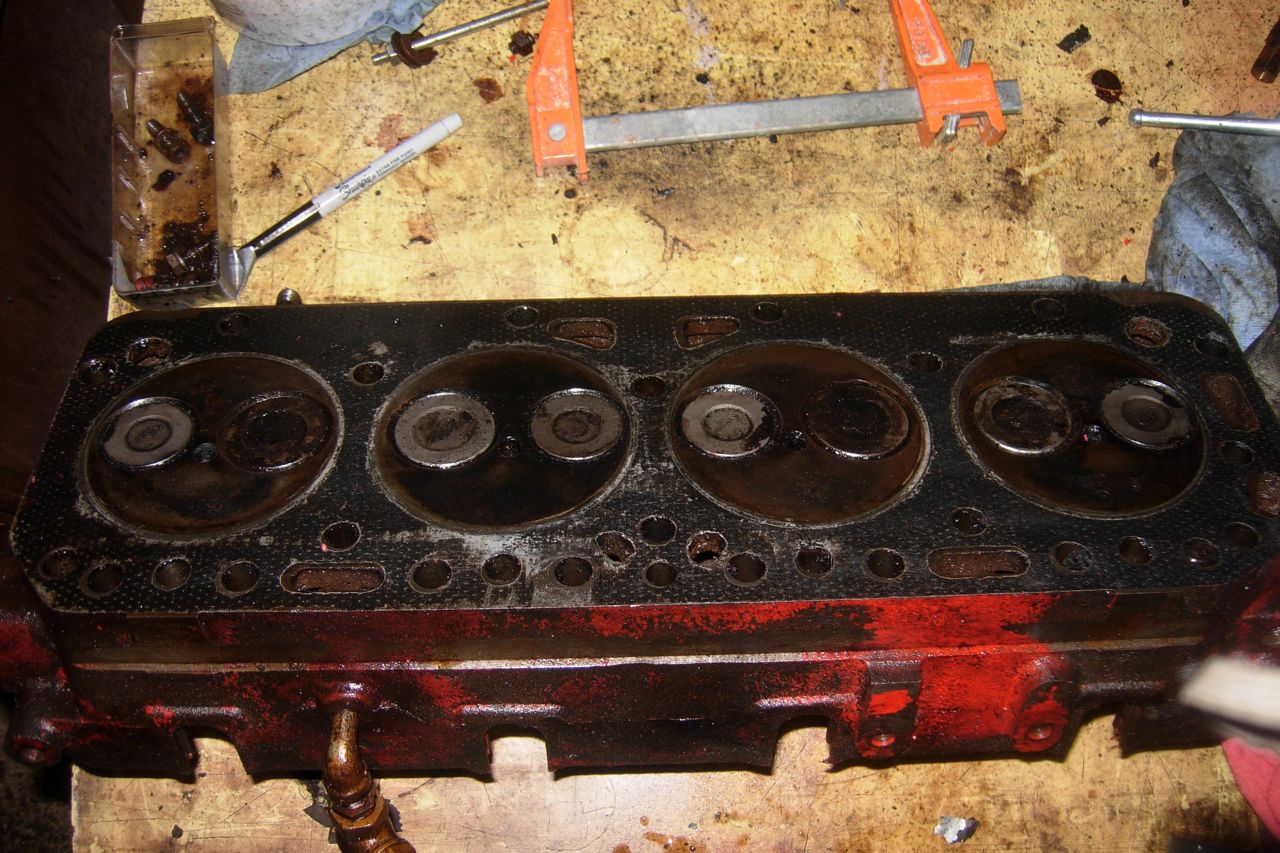

Now the Cyl head shotly after removal (valves still in place)

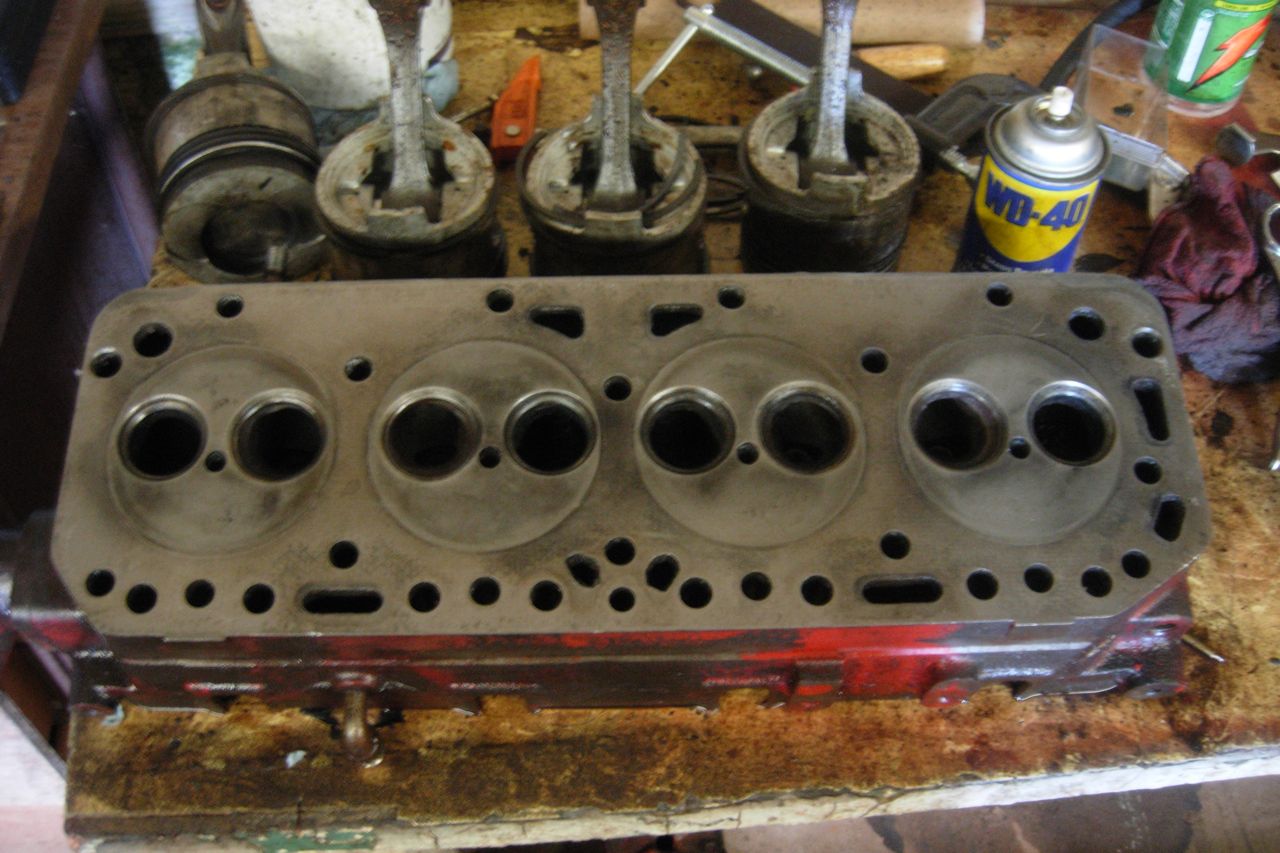

And after gasket removal (seems to be hiding as an attachment below, sorry). I probably have another hour of work to get the head clean and shiny. The valves are another problem.Here's a close up of the head with valves removed.
And the valves. Nasty looking. I haven't tried to clean these up just yet, but might give electrolysis a try.
So this is where I'm at. Any thoughts on the condition of the cylinders? Piston? Valves? I still believe that I should be able to hone the cylinders, clean up the pistons and re-ring, and then clean and lap the valves with the head. Thoughts?

You will want to rent a "SUNNEN" cylinder hone to clean up the cylinders with. When you are through honing and generally cleaning up the block. Wash the cylinders out with hot soapy water several times. You want a clean white paper towel to come out just as clean as it went into the cylinder. Any grit at all will fry a ring set asap.

Thanks for the suggestion. I had a quick look around the internet for Sunnen hone rental in Oregon, but I'm not finding much. Looks like I'll be making a few calls to machine and engine rebuild shops. Just for clarification, why not the 3-stone hone? Something catch your eye from the pics?

Valves and seats will need to be ground not just lapped. One little pit will allow leakage, a hot valve, and a burnt valve failure. Put the valves on the wire wheel before taking them to the machine shop.

A plain 3 stone hone will not straighten up the cylinder wall.
