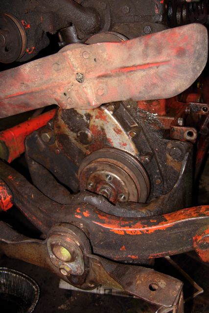

Can anyone tell me what I'm looking at? This is the front end of a Ford 881D that has a seized engine. I'm trying to bar her over. At first I was placing a large wrench over an odd shaped piece of steel bolted over the pulley. The inside of this piece clearly is the female receiver for a hand crank of some sort.

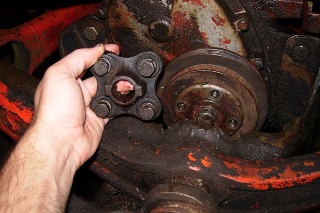

After pulling on this for several days I didn't like that it was doing some damage, so I decided to just remove it - hoping to find the legendary "pulley nut". Well there's a 15/16th nut for sure, but is this the pulley nut?
if I crank to the left it comes off - and with an easy tug so does the pulley it holds in place (gunked in with white silicone mind you). This exposes the front end of the crankshaft that has a 16 tooth or so splined end. I really don't like the feel when I try to bar her over by tightening this nut down on the pulley. What am I doing wrong here? Should I be baring over using the piece attached to the pulley?

The piece in your hand is a flex coupling (universal joint) for a front mounted hydraulic pump. Live hydraulics for FEL. MikeD74T

Interesting. So should I try to bar the engine over by placing a wrench over this flex coupling or focus on the nut that hidden beneath? Either way I'm probably going to pull the head this weekend, but for future consideration - what should I attach to in order to bar an engine?

Put the gizmo back on the crank snout and bar it over with that. I use a cats paw pry bar that is pretty long and put a cheater on it. If you use the crank snout bolt, you will over tighten it and very very very likely break it off and that will make you cry!
The tranny is not your stuck issue. The SOS does not give any back pressure to cranking like a gear trans would. You are just spinning the pump and that isn't stopping it.
I would keep putting ATF & diesel or the kroil in each cylinder. If you have a helper (or rig up a hanging weight on the end of the cheater bar), put a hundred pounds or more on the end of the cheater and tap on the piston tops with the handle of a 3 lb hand maul. Us the motion to set a new head on a handle. I put a thick wad of rags on top of the pistons and rap each one. As you have 2 loose, you can just play the bongo drums with the other two~! Should work. Just don't go whacko while whacking it. Harder is not better. You just want some shock to start the motion so the hanging weight (or kid or wife or helper) will rotate the crank.
