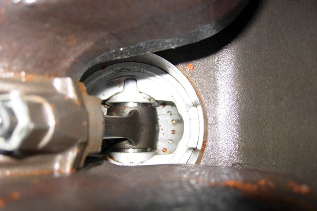

Okay, we're clearly well-past "what am I looking at?". But, I do have pictures of the ongoing rebuild of the 881D that I'm using to document that condition of the engine, etc.

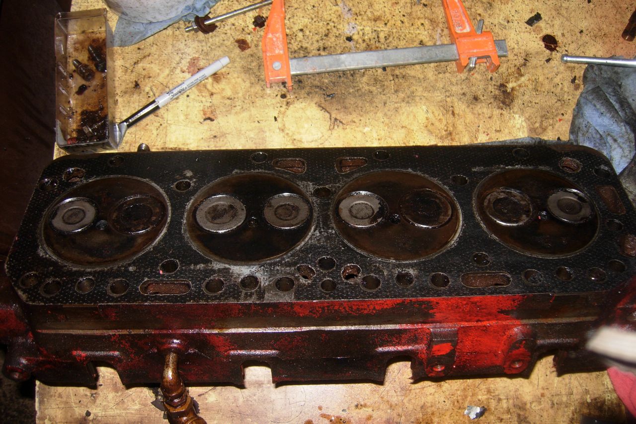

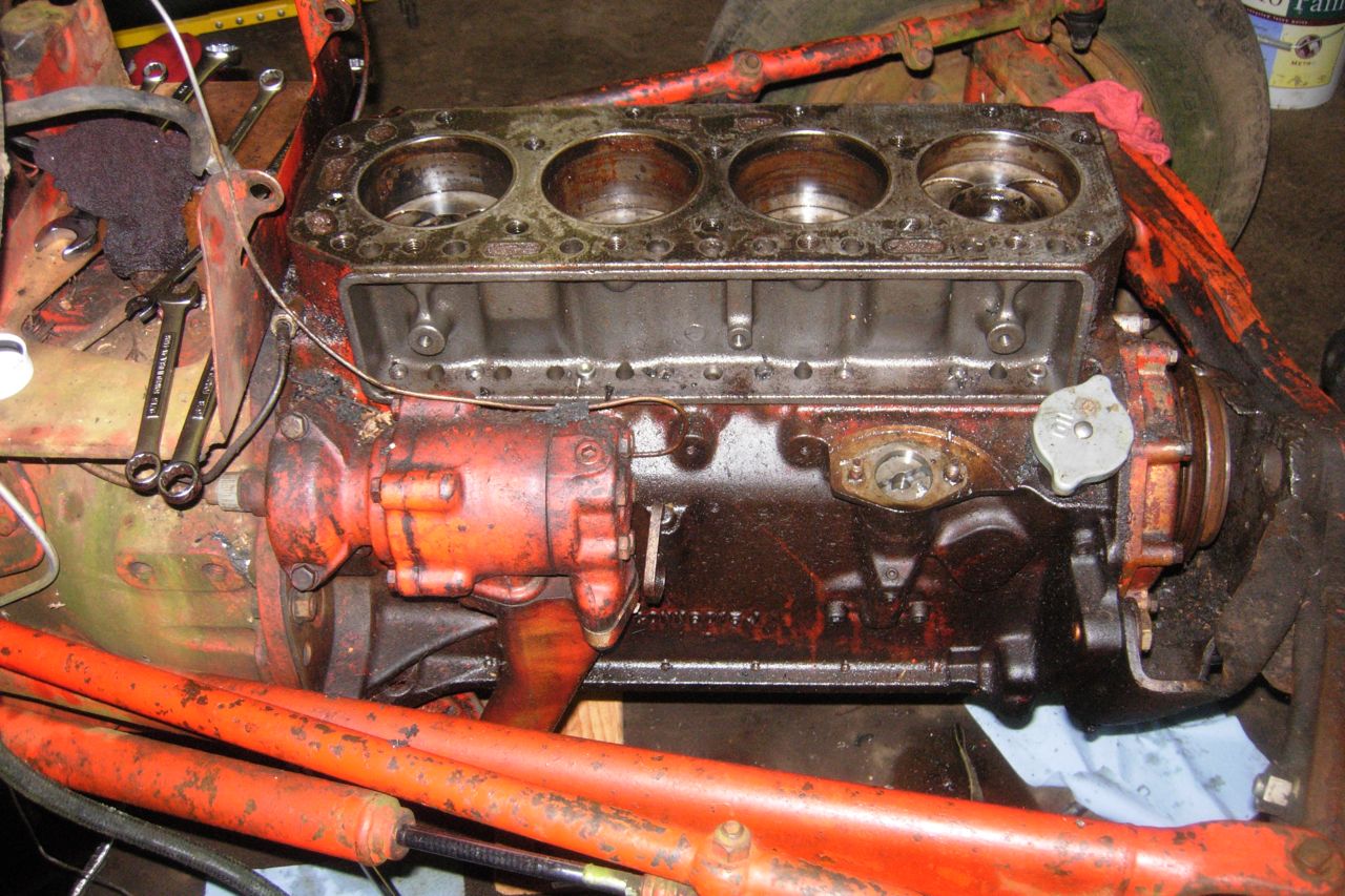

Here's the block - head removed.
Now the Head showing the valves (gasket still needs to be scrapped and things aren't a dark and dreary as this picture suggests.)

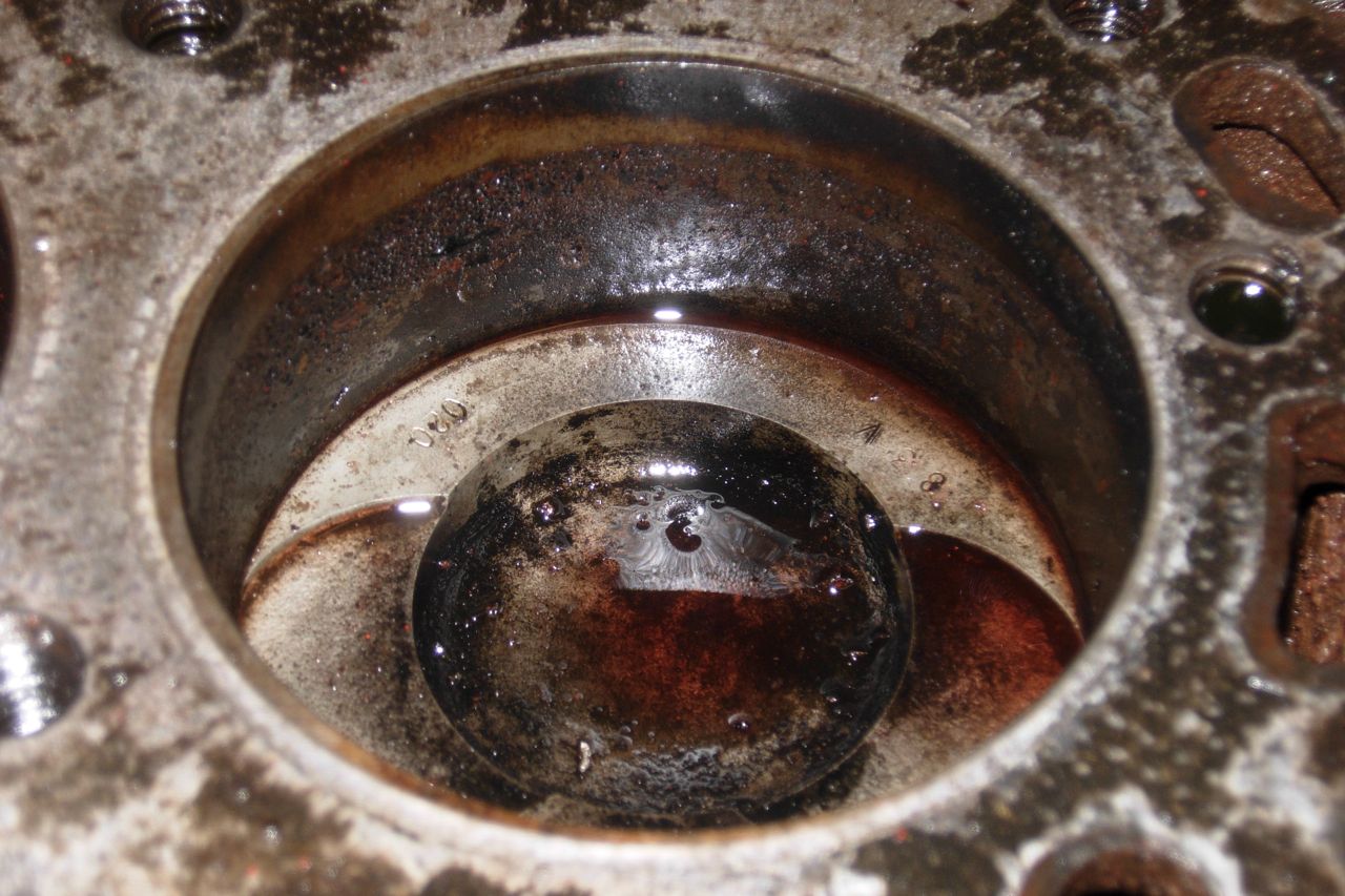

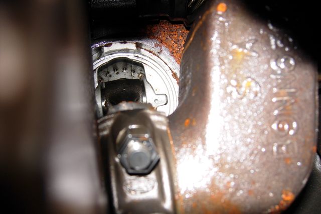

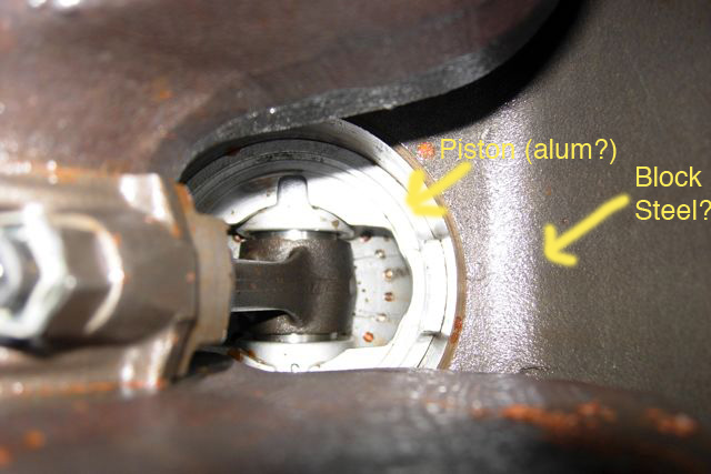

Here's Cyl1 (counting back to front) from above and below. Note the heavy carbon build-up/rust? above the piston, and some rust that was visible from underneat before I was able to free the piston.
/ What am I looking at?
#22

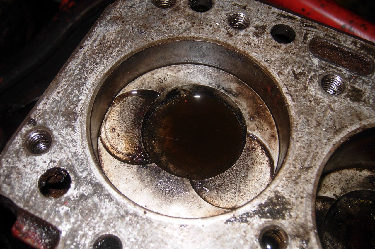

For comparison, here's cyl #4 (also free) from above and below.

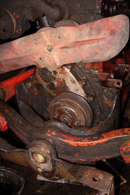

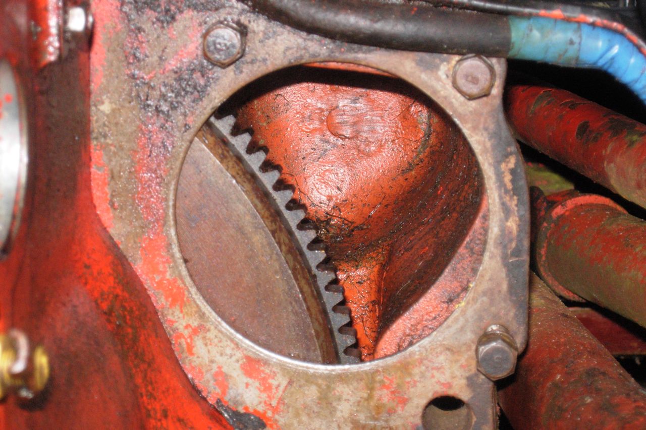

Finally, here's a shot of the ringgear (starter removed). Looks pretty decent - teeth intact and not real worn.

You've got some pretty good rust in that #1 cylinder. In addition, your engine has been rebuilt at least once already, and the pistons are 0.020 oversized. I'm guessing that the #1 cylinder may be pitted enough to require it to be rebored (doesn't look like this block has sleeves). I don't know what the maximum overbore is on that block, but hopefully the rust isn't too deep.

You can estimate that by just looking at the pics? Impressive :cool:. Can I ask how you can tell? Anyway, according to the I&T shop manual the later hundred series tractors didn't have sleeves. Of course the good news is that if I was willing to have the cylinders rebored, I should be able to either find a set of oversize pistons or I could drop in a set of sleeves with matching pistons. Engine rebuild kits of this type seem pretty standard for the 172 Diesel engine.
Thanks by the way. This is definitely the kind of advice I'm going to need. At some point I have to decide whether it's worth it at this point to attempt an overhaul. Obviously, if this block has had it - then that's probably the end of the road for this tractor. . . . :(

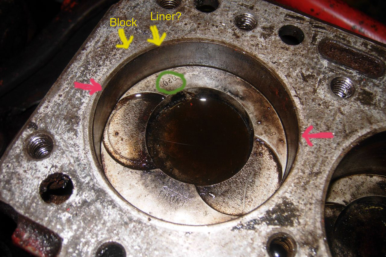

Question: ytmag sells rebore kits for 172 diesels.
Rebore Kit, 172 Diesel - For Models: 800, 900, 4000. All with 172 diesel engine, non sleeved. Available in std., .020, .030, .040. (Part No: RK172D)
Does this mean that it would be possible, depending on how deep the pitting might be to rebore up to 0.40? I know little to nothing about the specifics of this process. Also, what would you recommend for cleaning up the cylinders? Is this typically done with an acid bath, or are their semi-abrasive cleaners? :confused:

The cylinder walls would be cleaned up with a hone, and if there is not pitting, you could get by with that. I can't really tell from the photos, but to me it doesn't look all that bad.

Look closely at the #1 cylinder picture. I think water set in this cylinder for some time. See the dimpling in the reflection from the flash just above the piston? This should be nice and smooth, and this will be hard if not impossible to hone out. Also, there appears to be a rust pit just to the left of the shiny dimpled spot on the cylinder wall, as well as in that band about 1/2" wide about an inch above the piston where the piston rings had previously polished the wall. This looks like substantially more than surface rust to me. It's hard to tell, but it looks like the rust may be worse further to the right on the wall, but this isn't real clear.
Maybe you will get lucky and it mostly surface rust. However, as I stated, the wall looks dimpled from rust, instead of being nice and smooth.

Here's your next thing to try.
Get a straight edge razor blade and scrape the edges of the cylinder to get rid of the gunk and rust. Then get 2 electric heaters and have them about 1foot away from the engine on each side. You want to heat up the block to about operating temperatures, 200F. You want it to be at that temp for 30 minutes! Then try to torque it over. The heating will expand the bores the same way hot water expands the lid on a stuck jar.
Are you keeping the steady pressure on the crank with the jack? You should! Especially when heating it up. Then come by and give a whack with that wooden hammer handle. I wasn't kidding with the 3 pound hand maul either. A 16 oz framing hammer won't provide the oomph to get it rocking. You do need to put some rubber hose on the connecting rod bolts if you have some free. You don't want to nick the crank with the rod bolts!!
If $$$ is more precious than labor time, you can just hone the cylinders out (even with pock marks) and reassemble. It will at least run, even if it has some blow by. Then you can plan out a rebuild with larger pistons. I like to go overbore, but if you plan on keeping it for ever you may want to put in the sleeves. It's about the same kit price either way. Just don't get discouraged or impatient, both can lead to bad things.

I think I'm following you around TBN danno1. Good question about the block. I know that these blocks did not have "liners" per se and were directly bored, however there does appear to be two different metals (based on color) that comprise the "block" and the "cylinder" (see pic). My engine was clearly rebored larger by 0.02 (stamped on the pistons; green), but the bores seem to stay within the original cylinder, but rebore was not quite centered (red arrow), likely intentional.
If you look at the underneath pic I've highlighted in yellow the piston and block. To me the pistons look like bright shiny aluminum; block looks like steel.
I suppose this really doesn't matter for using heat to induce metal expansion, but it's an interesting thought exercise based on several assumptions (never a good mix). Nevertheless, unless I'm mistaken, if you were to heat the pistons directly, being aluminum they would swell up more so than the cylinders and it would be even harder to get them out.
