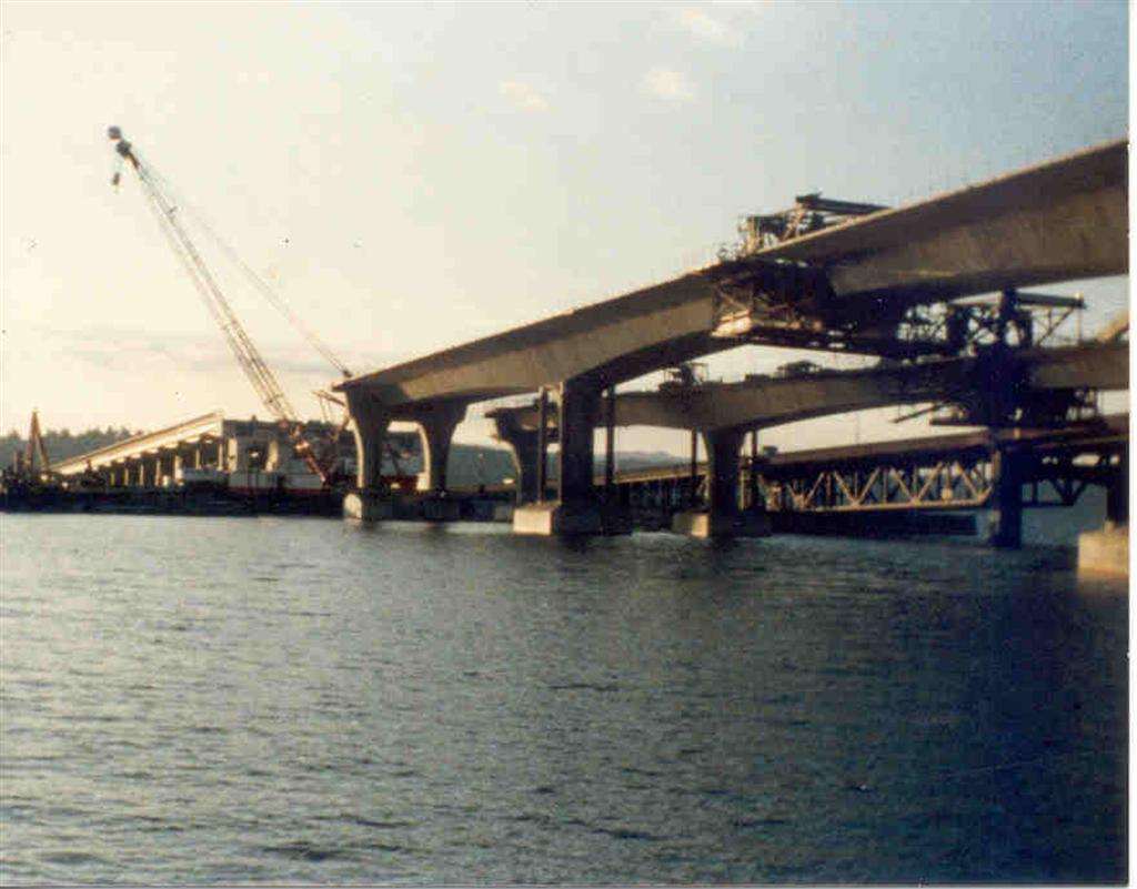

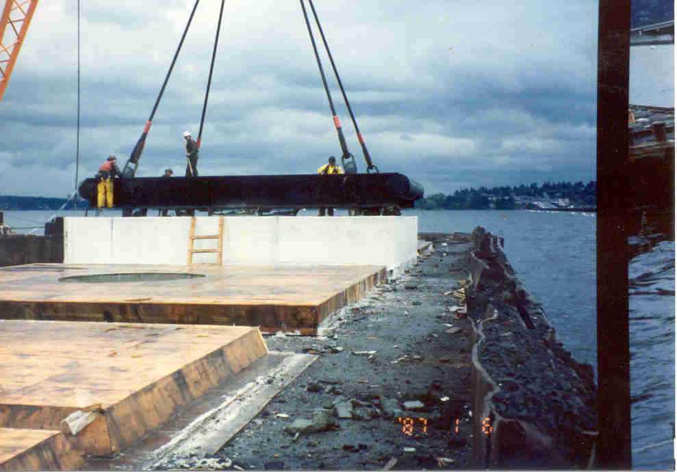

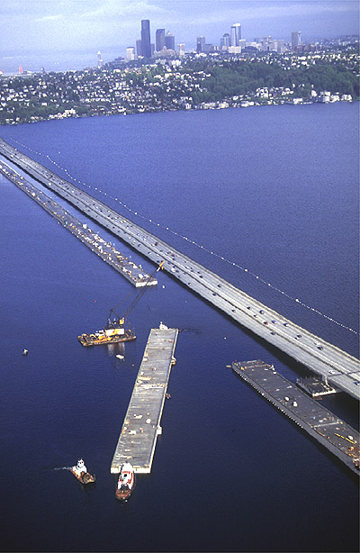

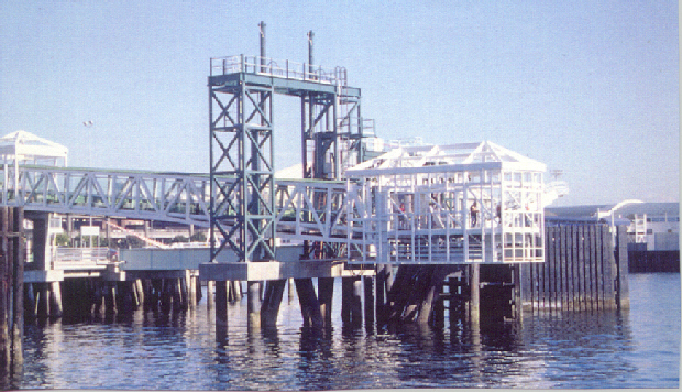

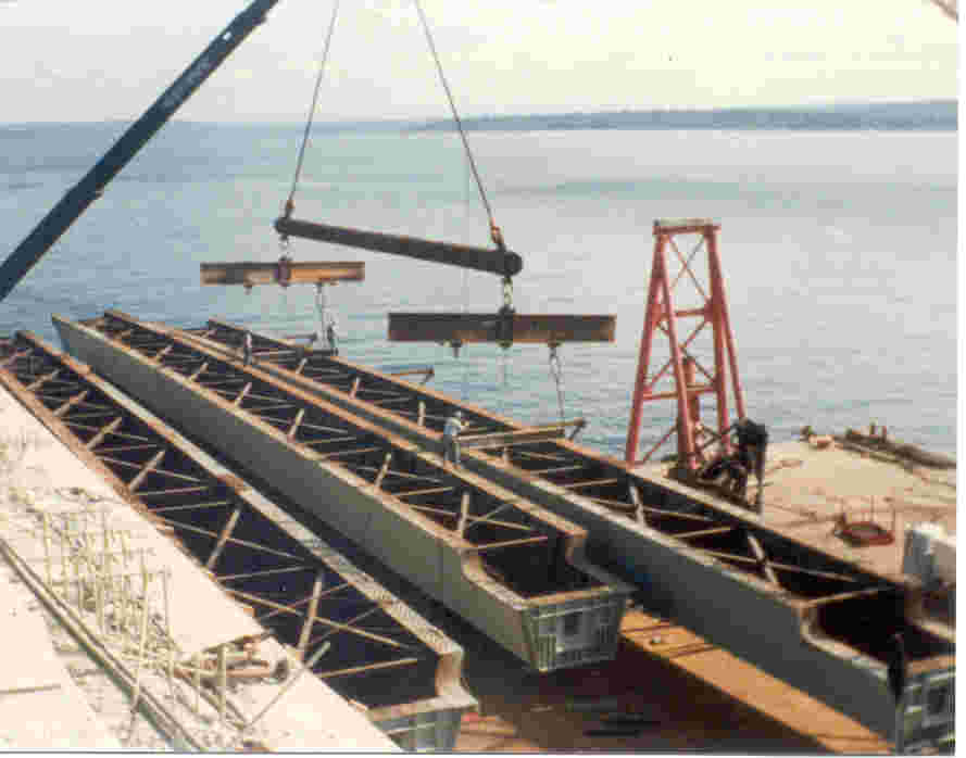

I do have some pictures from when I was working, but I didn't take them. Engineers always seem to have more time for that kind of thing. :laughing:

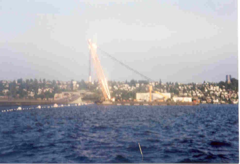

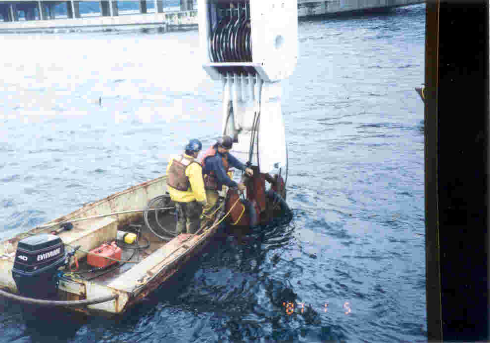

I liked building land marks.;) This one was fun, stacking 300-ton chunks of concrete five high 200-feet underwater.:cool:
