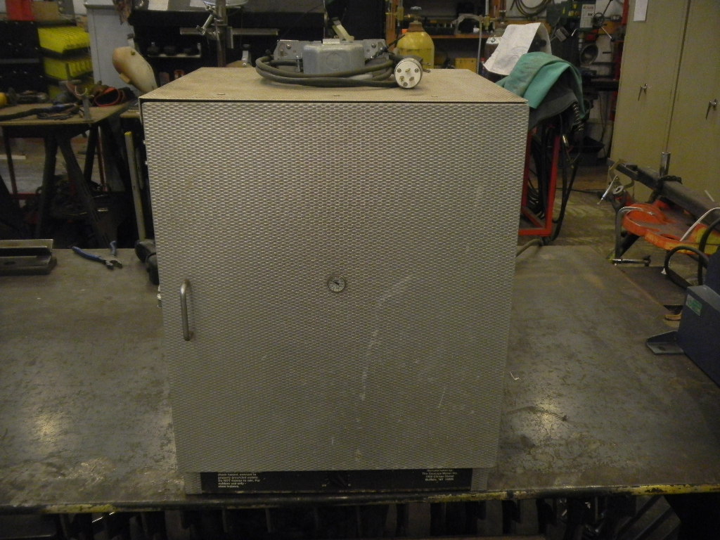

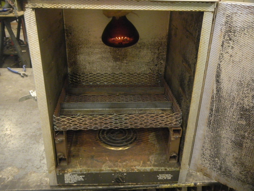

I have tried that and it doesn't work. If you don't have a rod oven, try the kitchen oven if it is electric or if you have a small toaster oven, they should fit fine in one of those and could do about 5 pounds at a time. A couple of hours of baking in oven at 350-450F should be sufficient for average shop use. It may take a bit longer than that if you do a lot of them at once, they need to all reach baking temps then a 2 hour soak time.

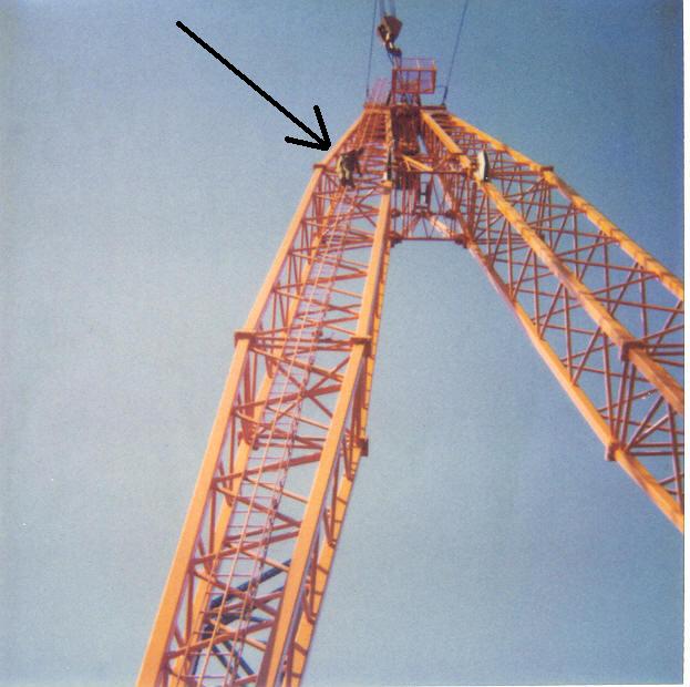

If I remember correctly, (realize how many cranes I've dealt with since then) it was 1 1/4-inch wire rope, 8,000-feet long, 28-parts. The boom wire was the same. I forget all the details about the boom, after that job I never seen it again. Here is about the only picture I have of the boom. This is when we were placing it on the barge. I went up to disconnect the crane we used to set the boom.

When we finished setting all the anchors on the south side, we had to take the derrick back around to the north side of the bridge. We had to go under the East Channel Bridge. The state required I go up and stay in the crow's nest at the top of the boom to insure the boom was down low enough not to hit the bottom of the East Channel Bridge. With cranes that size all crane signals are done with radios. Very good friend of mine was the crane operator. As we were approaching the East Channel Bridge it didn't look like the boom was low enough, soon as I pushed the button on the radio Mic I got a series of beeps, battery went dead!:eek: I couldn't talk to the crane operator or the skipper in the tug! The East Channel Bridge has a slope to it, the north side being lower than the south side. The boom cleared the south side but it really looked iffy to clear the north side. I didn't know to jump, sheet or go blind! So I stuck it out, the boom clipped the navigation light hanging down on the north side, peeled the bottom of the light off!:eek:

I hate to say it, but my shop stays damp all the time. The roof leaks and needs to be replaced. I dont own a rod oven and store my rods in one of those plastic cans. When ever I know I have a bunch of welding to do, I take my rods and lay them on top of the wood stove. I usually have several laying on the stove at any given time. The stove top will reach close to 500degrees if I crank it up. Anyways, even moldy looking rods will dry out and burn just fine for me. Now if the flux has started to turn loose, thats a whole new ballgame. My biggest problem is with the mig, rusty wire there aint much you can do for that.
/ Wet 7018. #52
one question about rod ovens, if you store rods in just a regular container most of the time, then in a rod oven maybe a day before you use them does it give you any benefeit? Do you need to keep them in the oven since the first time you open them? I don't weld a lot, but enough to buy a decent amount at a time and don't want to store it for months in an oven if I am not using it.
Per AWS, reconditioning rods requires higher temperature than a rod oven is designed to produce. Rod ovens may stay at around 200 degrees. The goal here is to keep a dry environment, to keep moisture from coming into contact with the flux. When moisture comes into contact with the flux, it's said that chemical changes occur in the flux, which require much higher temperatures to reverse. This is reconditioning, which requires something like 2 hours at something like 800 degrees.

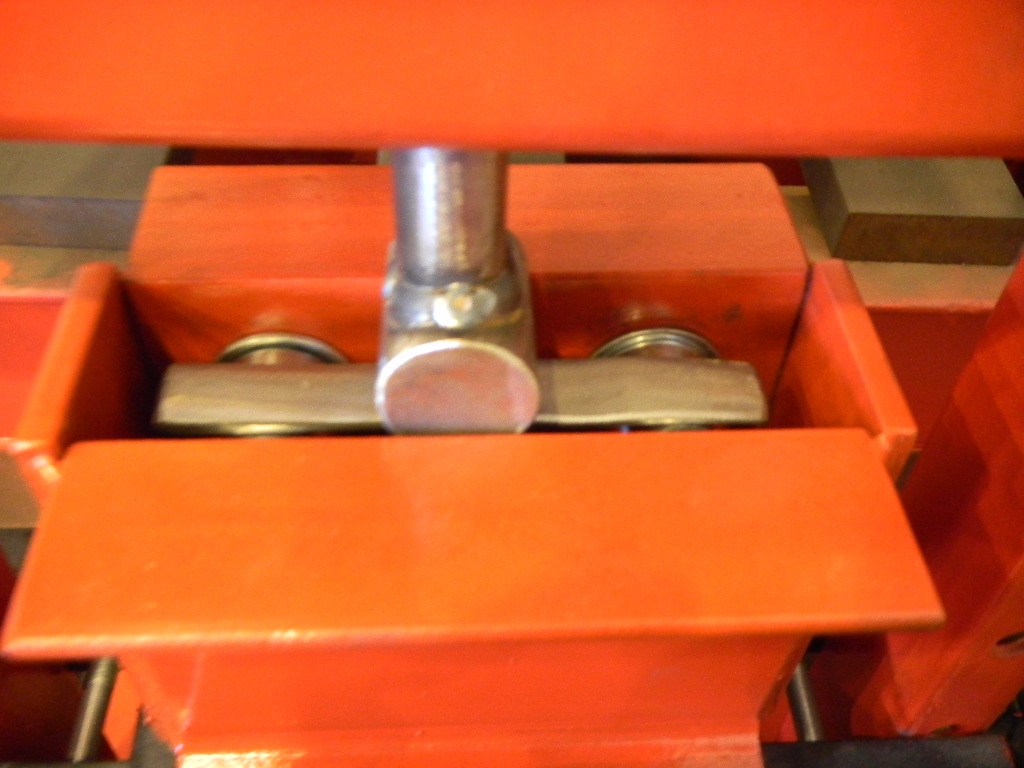

Depending on how far you want to take your learning of welding. In my opinion if you really want to build confidence in your welding you should build a tester! I'm sure you have the majority of the material laying around. You can even borrow the hydraulic jack out of you pickup.
I had a small shop press, I just built an attachment for it, and built a coupon roller.
Model BT1B Weld Bend Tester - YouTube
