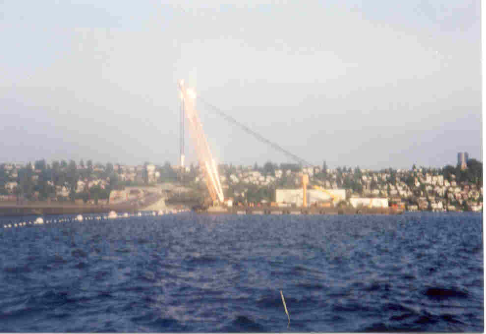

#38
I don't miss my bridge building days hahaha.
I liked building land marks.;) This one was fun, stacking 300-ton chunks of concrete five high 200-feet underwater.:cool:
