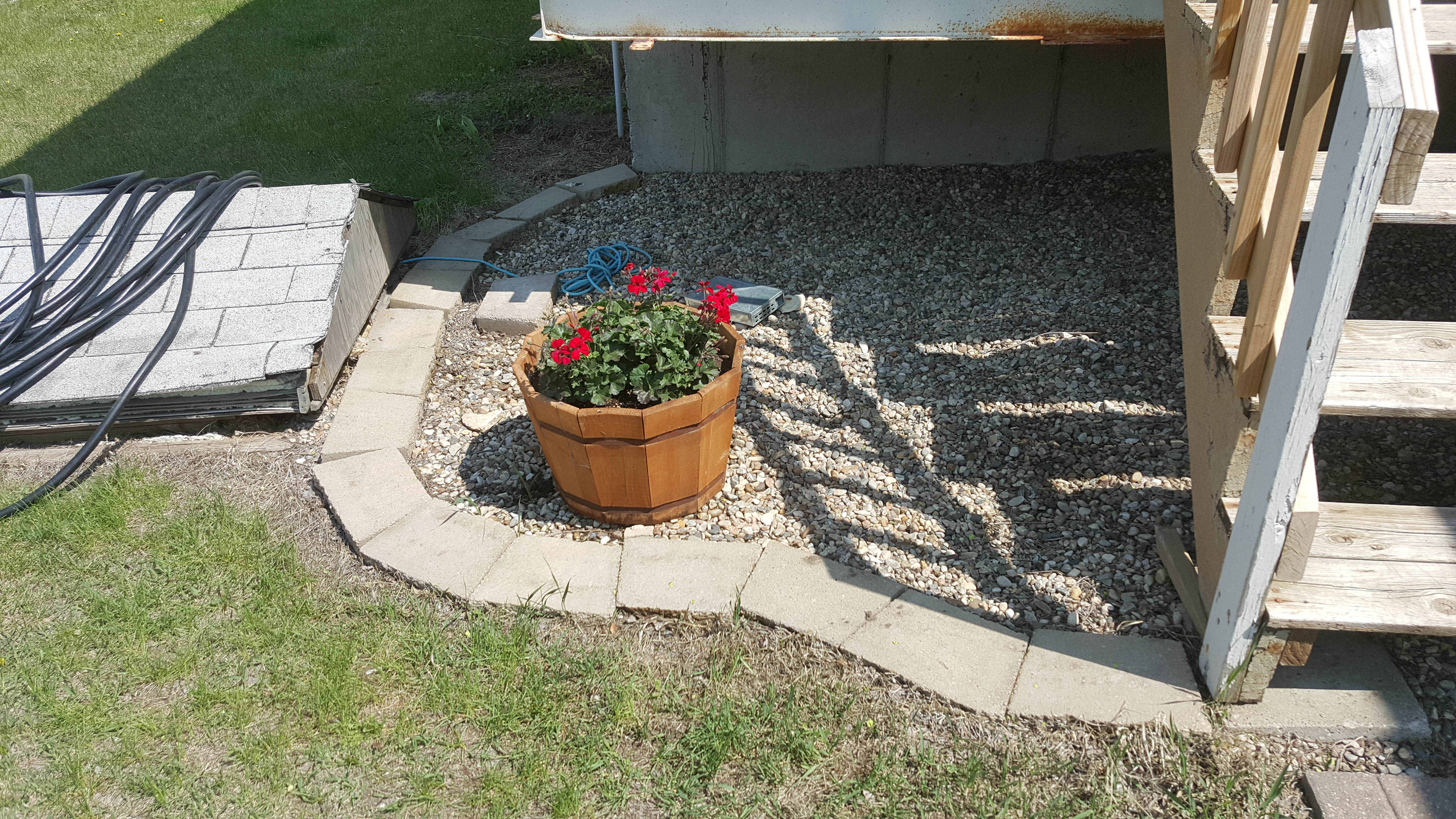

Depends on how fancy you want to get. Ours is just a lift off cover that has a shingled "roof" and is insulated. Nothing fancy, but you can lift off the entire thing if needed.
This is about the best pic of it that I can find (left side of pic-obviously).

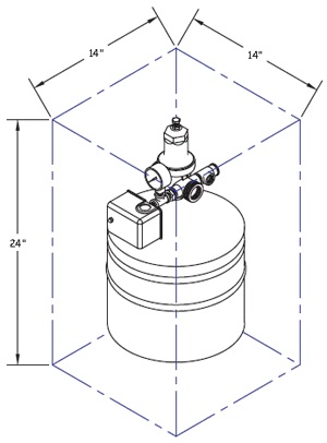

With a good pump control like a CSV, you won't need a very large well house. This system only needs a 4.5 gallon size tank, so everything will fit inside a 14X14X24 area. You can just put a wishing well, an igloo dog house, or a fake rock over the well and all controls.
