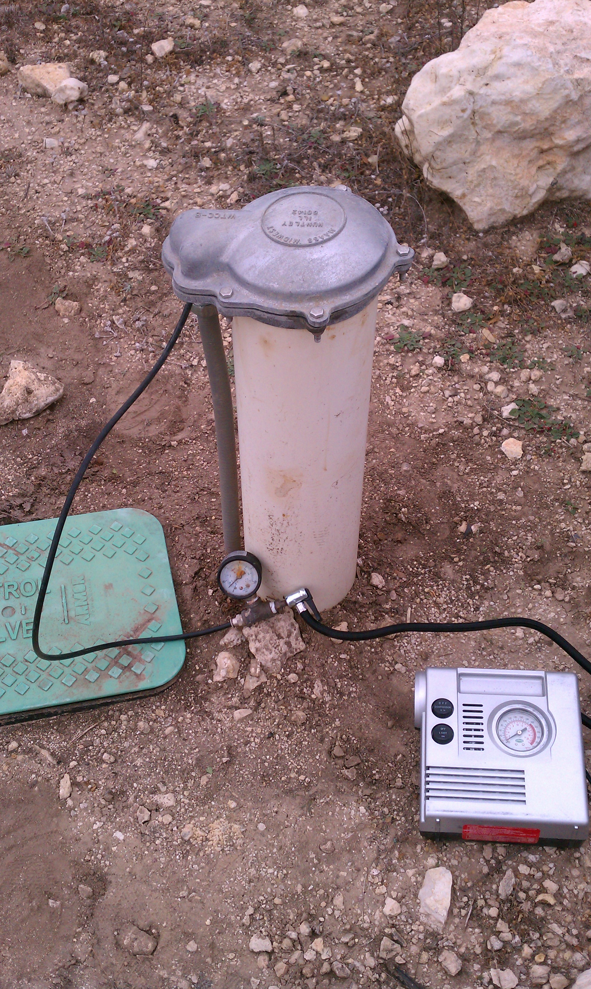

Blowing the well with air can give you a good estimate on how much the well will produce, but you can't really tell the pumping level of the water. Only a pump test can do that. You can blow a well from 470' and get 20 GPM. But when you use a pump, you many get 20 GPM without pulling the well down very far. So when pumping 20 GPM, if the water level only pulls done to say 300', then 300' is all the pump will see, which means you could use a much smaller pump than when pumping from 470'.
The air line I was talking about it just to check the water level while you are pumping 20 GPM. A small tube, open ended at the 470' mark, and attached up top to a tee with a pressure gauge and a Schrader valve to hook to a compressor, can give you an accurate pumping level. A small compressor blows the air out of the tube. Then for ever PSI shown on the gauge, you have 2.31' of water above the 470' mark. So an air pressure gauge reading of 50 PSI would mean a water level of 355'. See this picture.

The air line is for testing water depth via air pressure in the line. It is not for adding air.
Bubbler.
