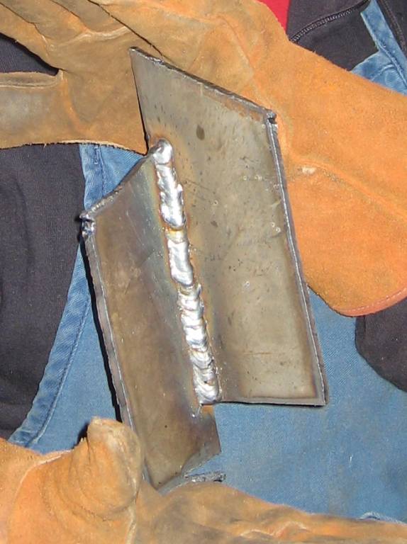

Well since this is turning into a stick vs wire welding rant I guess I will throw in my humble opinion. TEACH, get as much MIG welder as you can afford. Get a gas setup right away if you can afford it. Forget about a stick welder they are just too hard to use. I have had a Dayton 230 AC/180 DC welder for about 25 years maybe 30. I have patched and fabricated many things with it and my welds never break even though they are ugly but it is just too hard to use. I don't weld often enough to stay in practice. Usually at the end of the project I will start laying down some decent welds.
So I was reworking my FEL bucket and I got fed up with my stick welder and went out and bought a Miller 251 with a 75/25% CO2 Argon gas setup. I figured that after 25 years it was time for an upgrade. I couldn't believe how easy it was to use. No more scratching, no more stuck welding rods, no more trapped pools of slag, no chipping and a 33 pound spool of wire seems to last forever. After 15 minutes of practice I was laying down the best welds of my life. I may never use my stick welder again and I have about 50 pounds of rods left. To illustrate how easy it is to learn to weld with a MIG I am going to attach 4 pictures of my daughters first welds with the Miller 251. She had never welded or done any metal work before and she only had about 20 minutes of lessons before she did these welds.
Marshall
P.S. About a day after I bought my MIG I went to the local scrap yard to look for welding project fodder and I found a whole pallet of welding wire. It had been scrapped by a local welding shop for some reason but it looked usable. I bought about 330 pounds for 18 cents a pound. All of the wire is for mild steel. The wire is .035 and .045. Some is bare wire and some is dual shield wire. Unfortunately there wasn't any flux core wire that I could run without gas.
When my kids clean out my shop after I die they will wonder why I bought so much welding wire because I don't think that I will ever use it all. I have only used about 10 pounds so far.

Hey,that ain't bad at all,and the welds don't look all that bad either!!
JUST KIDDING YOU!
you oughta have her make a tee,[fillit weld],and turn it over and hit it with a hammer,,if it just bends than you are doing a good job,,[or she is],,,
yeah,no argument stick is a higher skill level,,and no argument that you can't make a good weld with a mig.
Just think what that girl could do if she took a couple welding classes! thingy
