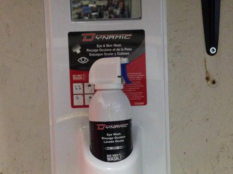

Brandi
I like this for an eye wash station: aerosol saline. Also for flushing wounds. No security seals to deal with. Always ready to go.
