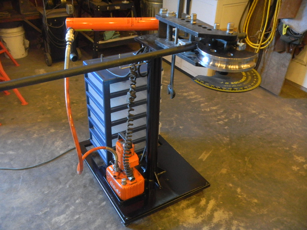

/ Welding Table Casters #12
NOTV8 where did you get that blue cabinet? I could use something like that for my pipe bender, before my wife discovers I stole her's out of her sewing room.:eek:
Shiled, that is just a regular steel cabinet that I got from work that we are throwing away... paint it with rattle can from home depot and close enough to match my miller 252 :laughing: I put the welding helmet on the bottom, gloves, crayon, markers, etc on top and assortments of discs on the middle.... I have different sizes of steel cabinets that I took home from work and nothing wrong with it just no keys :eek:
/ Welding Table Casters #16
Thanks NOTV8, it looks great! I need to keep my eye out for a replacement cabinet before my wife goes in the shop. Trust me the sheet will hit the fan! :laughing:
