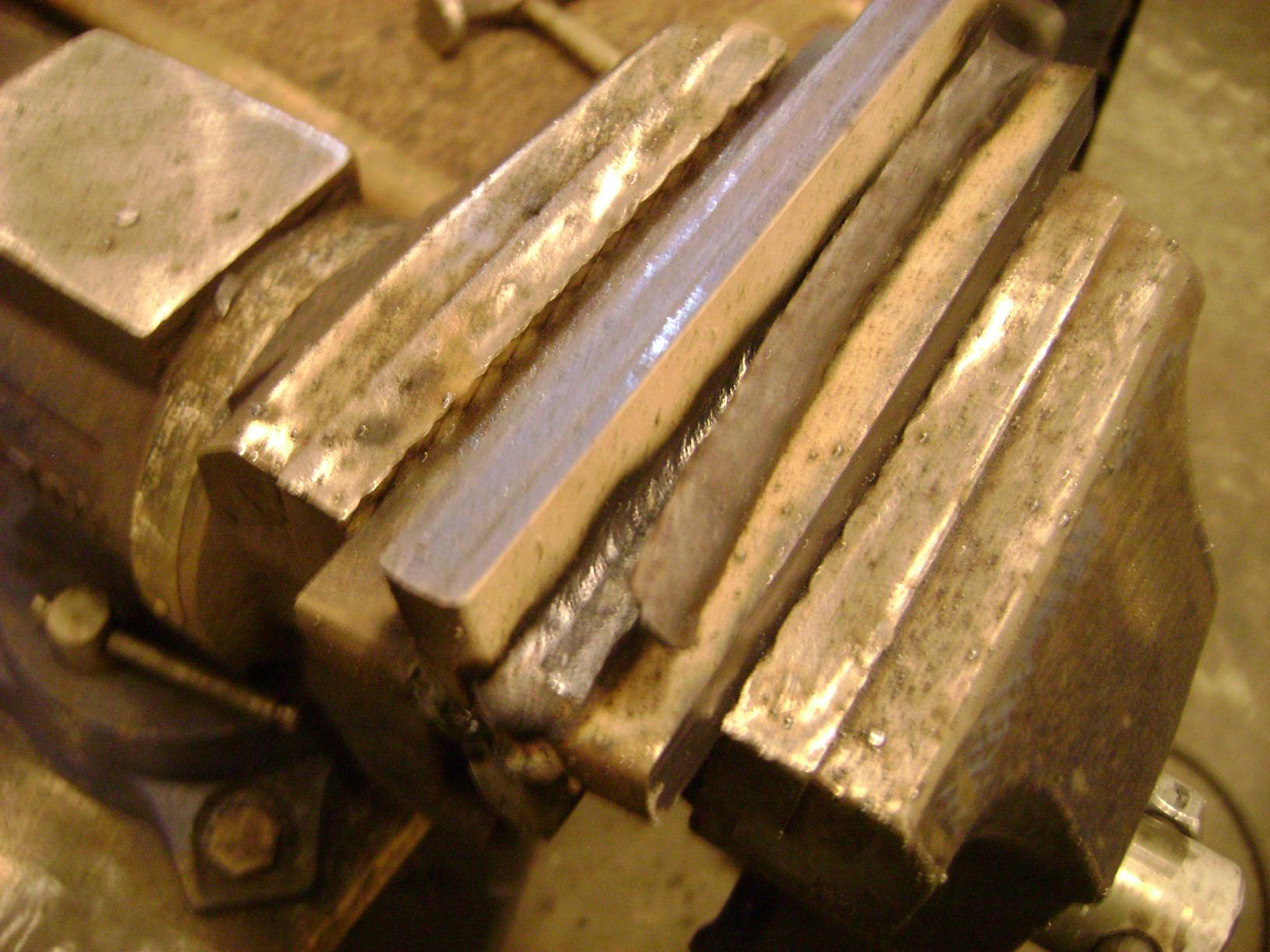

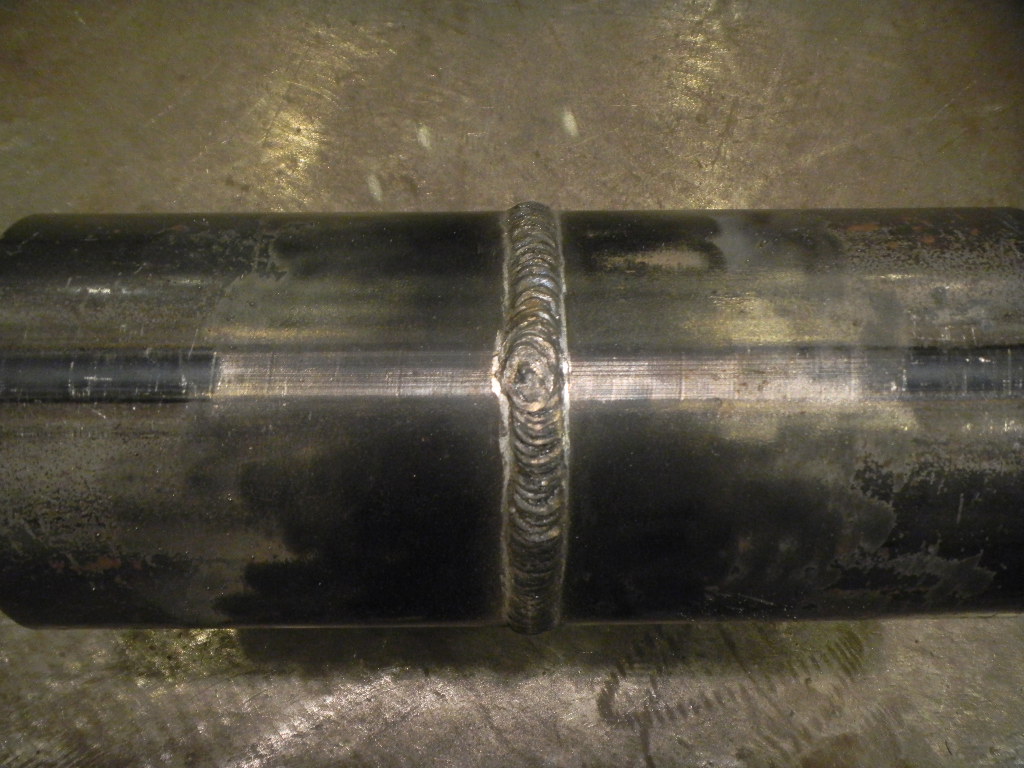

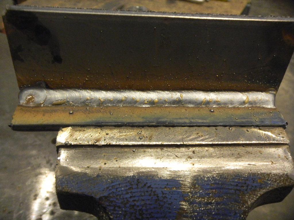

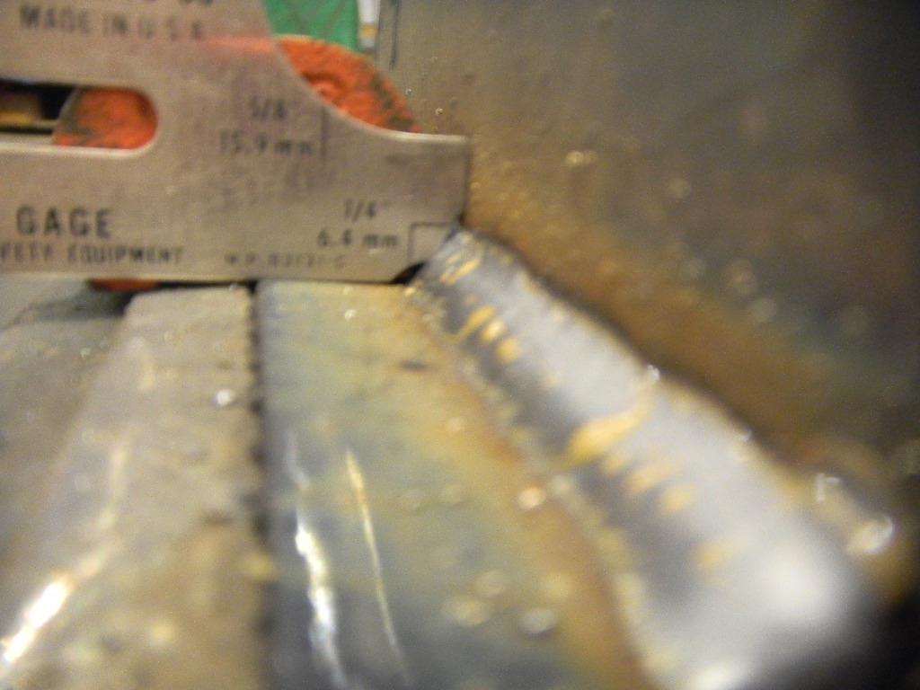

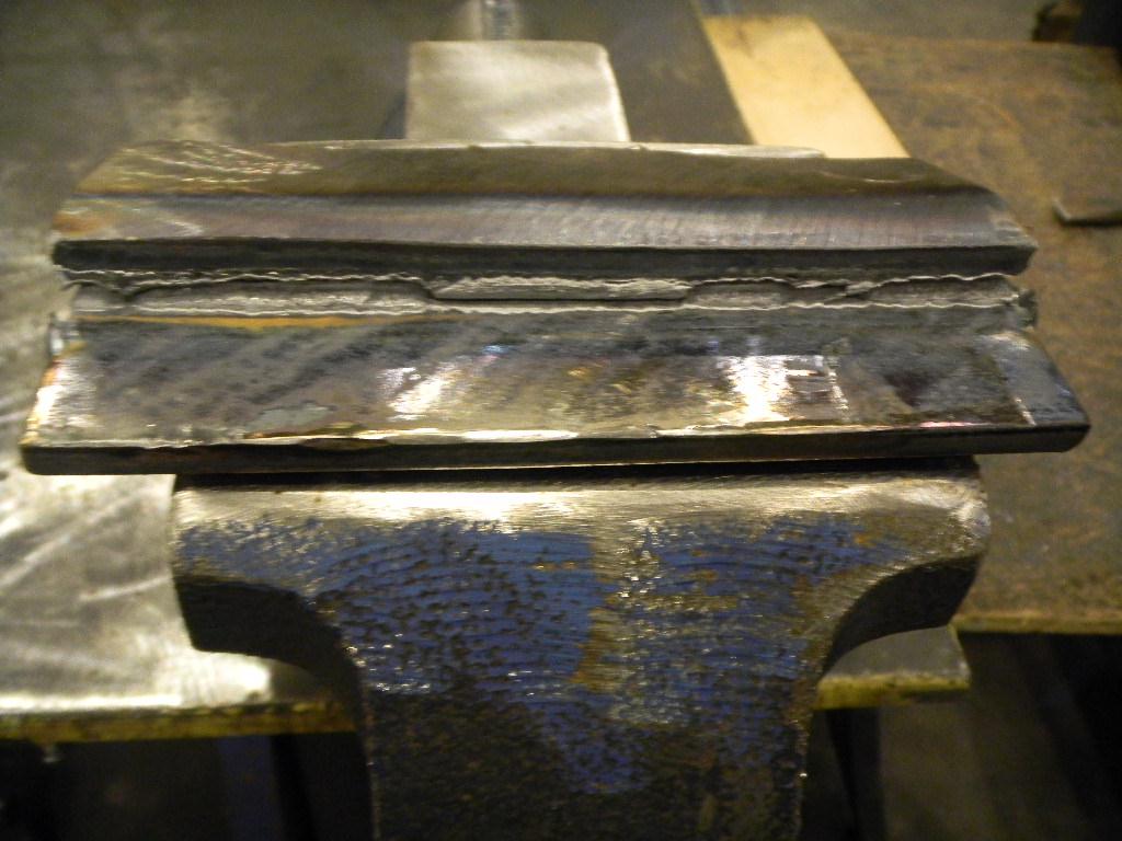

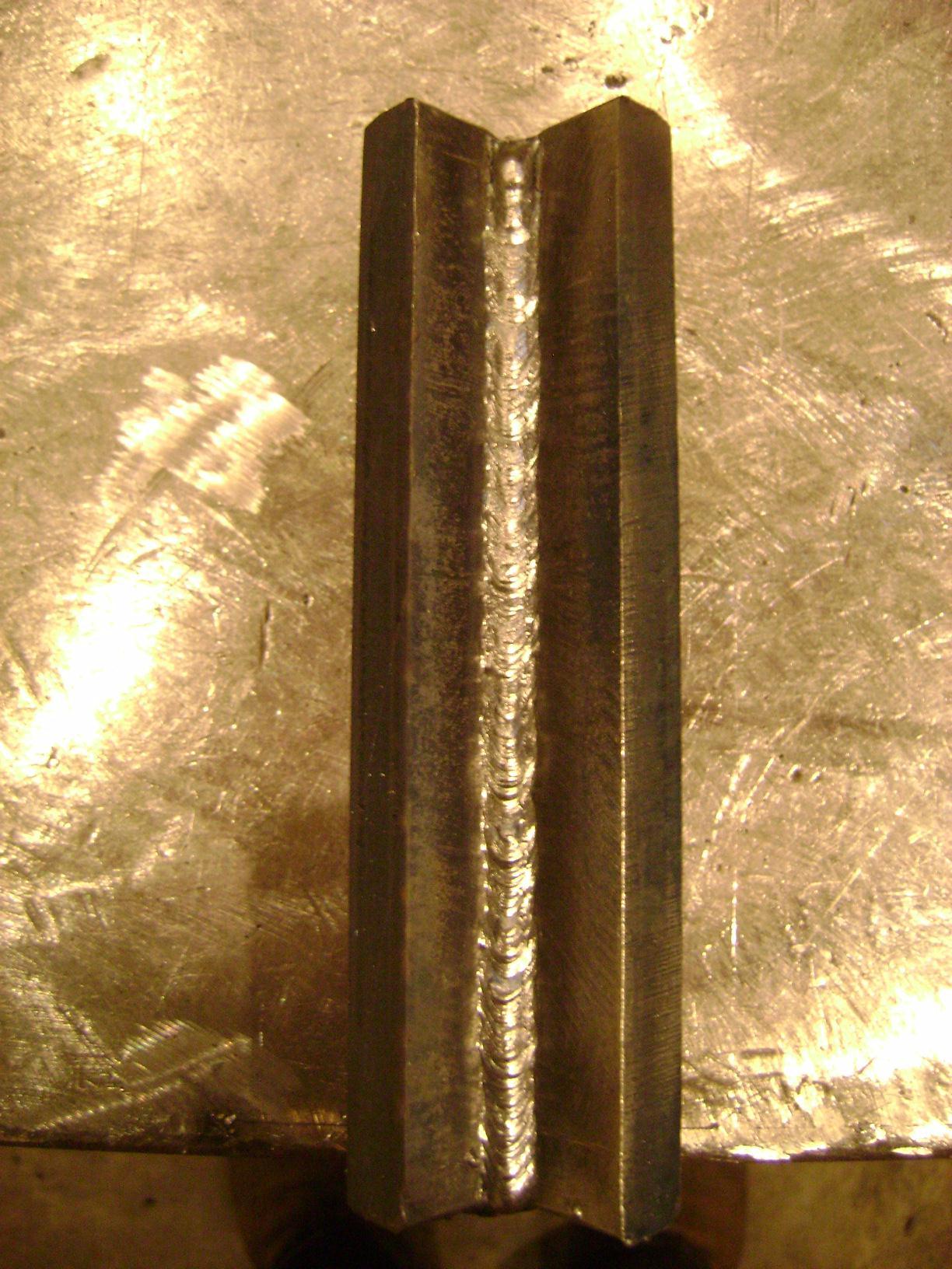

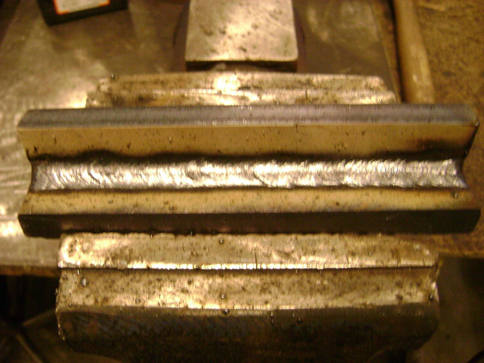

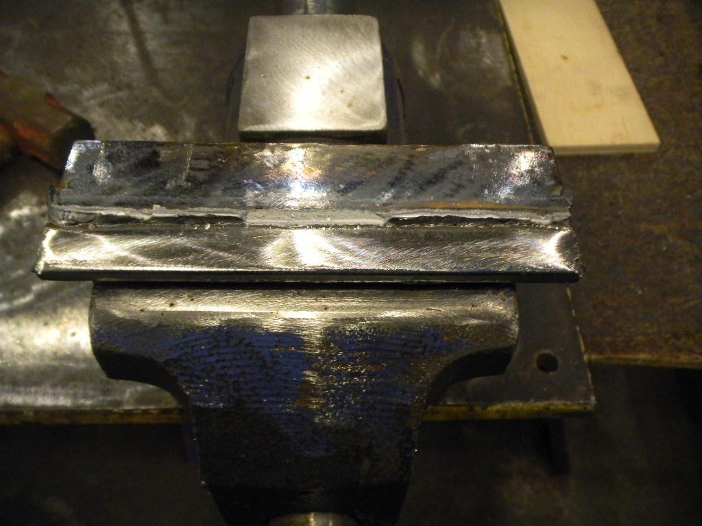

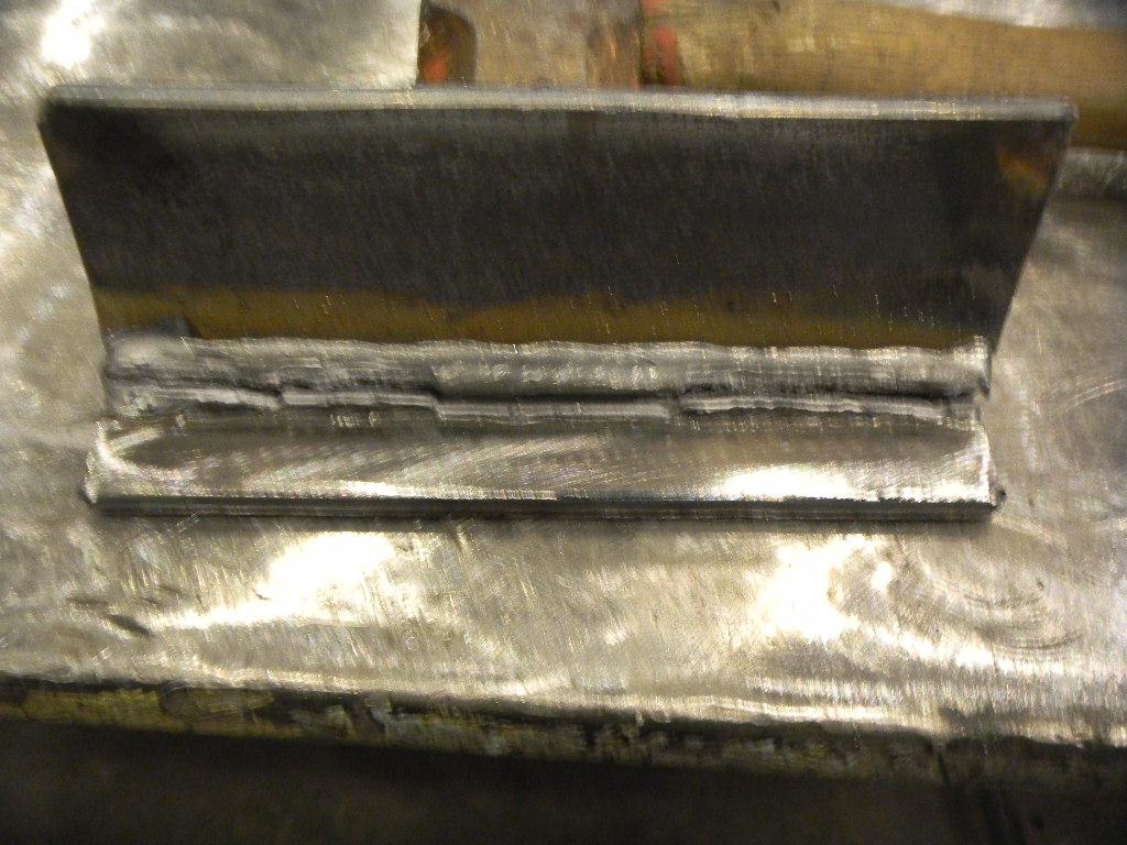

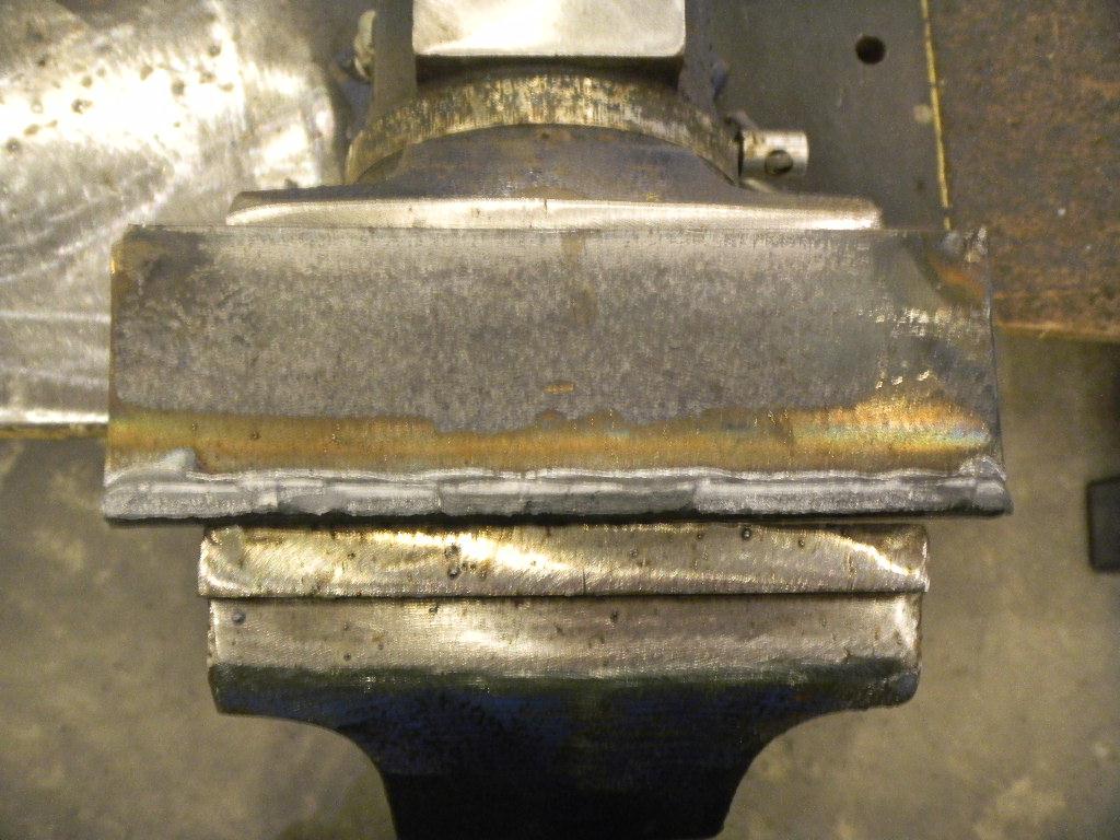

If I remember correctly, the "cold" 7018 rods were actually used right out of an opened box that had been left open for a good while, and still took 18 blows to break it.
And seems like you said that the weld with "hot" 7018 rods were beat down flat with 23 blows, and still didn't break completely. And you had to beat it back the other way to get it to come apart. :eek:
All true! But the one test that just floored me. Lincoln's L-56 Mig wire, 29-blows!:shocked:
