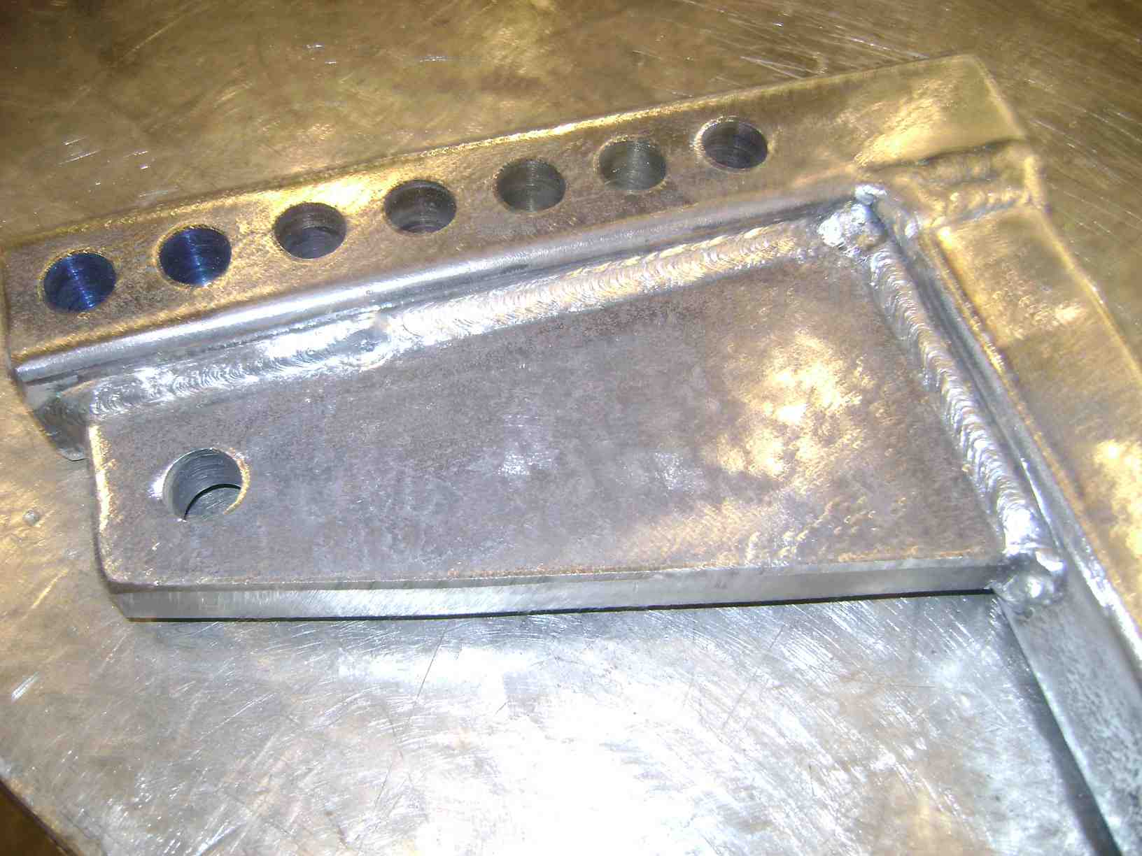

Oh no you wouldn't need to learn anything. DC is just so much more smoother, the weld flows more.
First picture 7018 run on AC. Second picture 7018 run on DC.

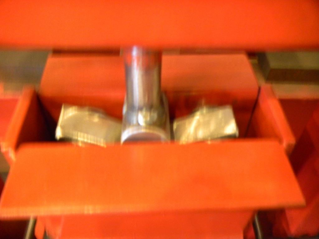

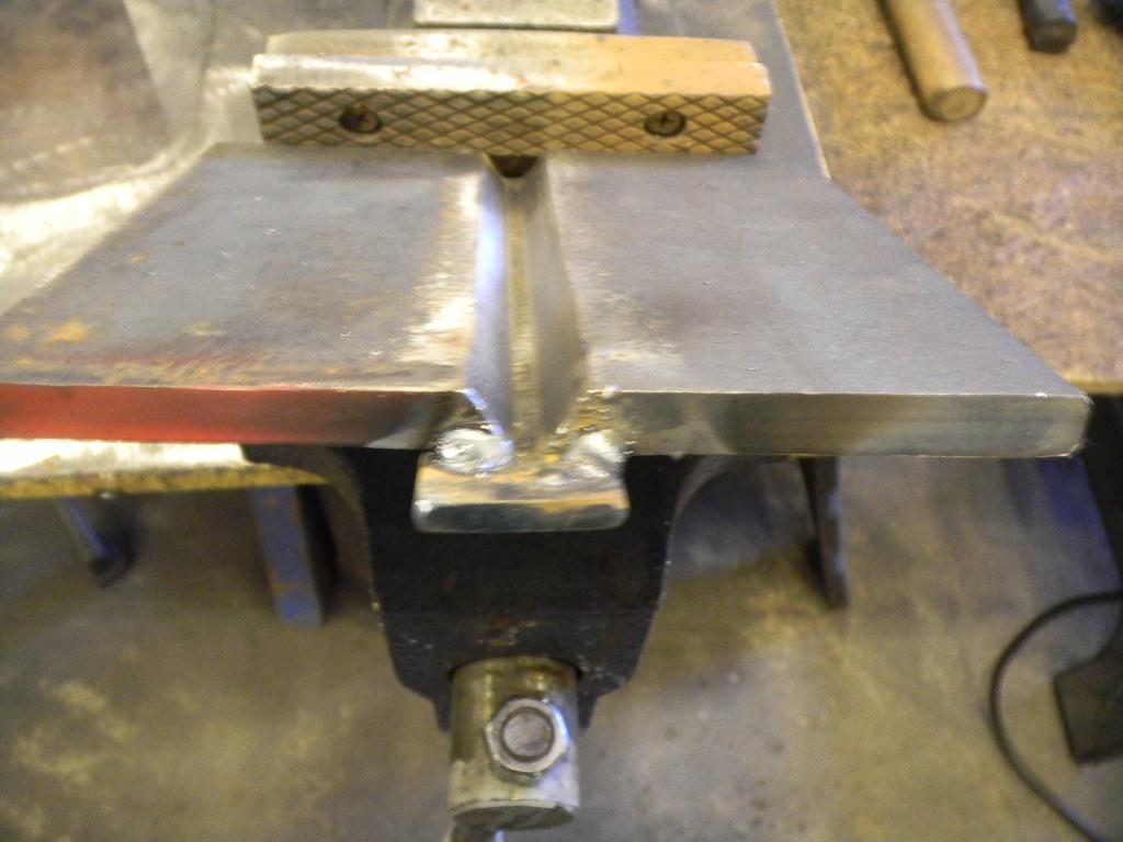

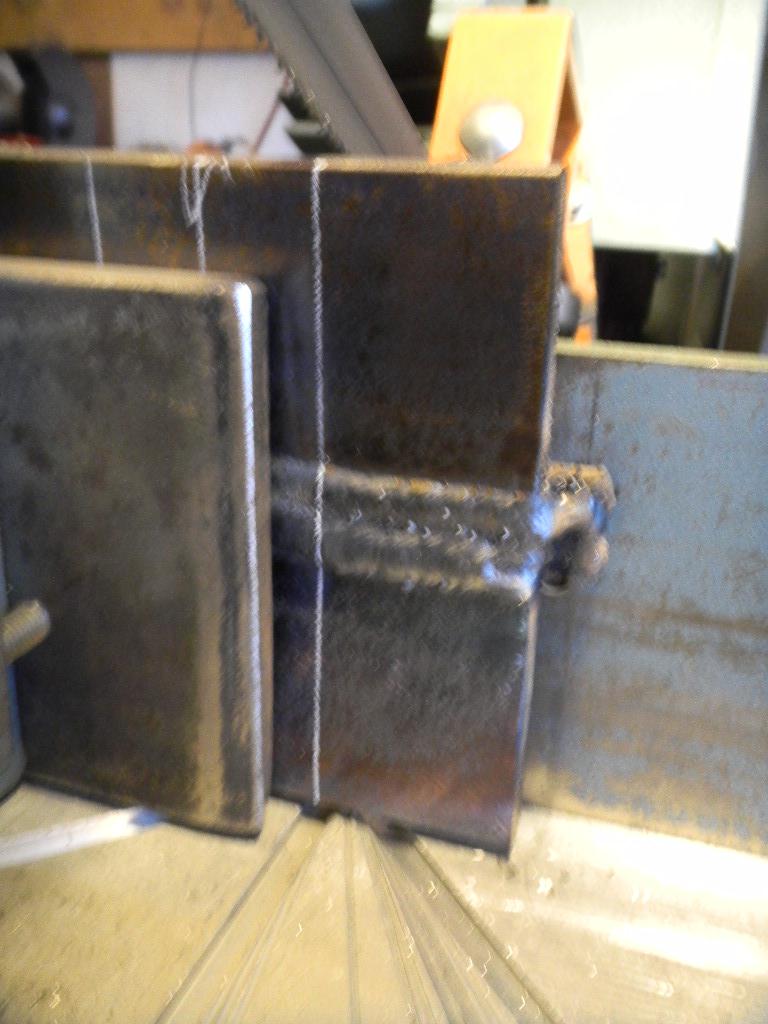

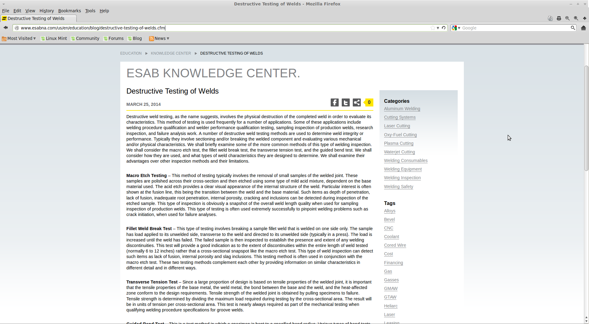

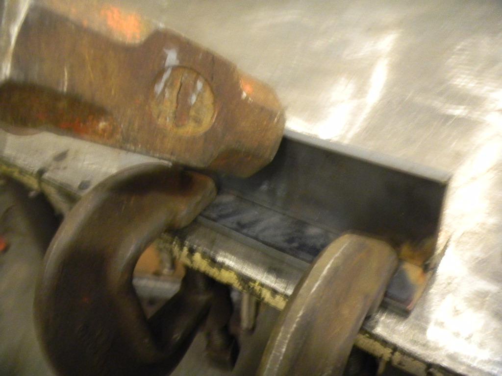

Few years ago I did some fillet weld break tests.
Here are the results.
6013 = 3-blows
6011 = 8-blows
7014 = 10-blows
6010 5P-Plus = 10-blows
7018 (cold) = 18-blows
7018 (hot) = 23- blows

/ welding rod question #37
6013 is indeed easy to worm hole or get slag inclusions which is one of the reasons I try not to use it anywhere strength is important. Some brands of rods are much worse than others too for doing it. So far I like Messer (Us Forge) the best of any 6013 that I have personally ran. (Note while I like Messer 6013, I absolutely hate Messer 6011 and will stay with Hobart 335A for my 6011).
That said, 6013 does have its uses especially for thin metal when no wire feeder is available. Now if you expect it to be a beautiful weld on really thin metal then you just might be expecting a tad too much out of it. But for a repair and appearance is not so important then 6013 can work good enough to do the job.

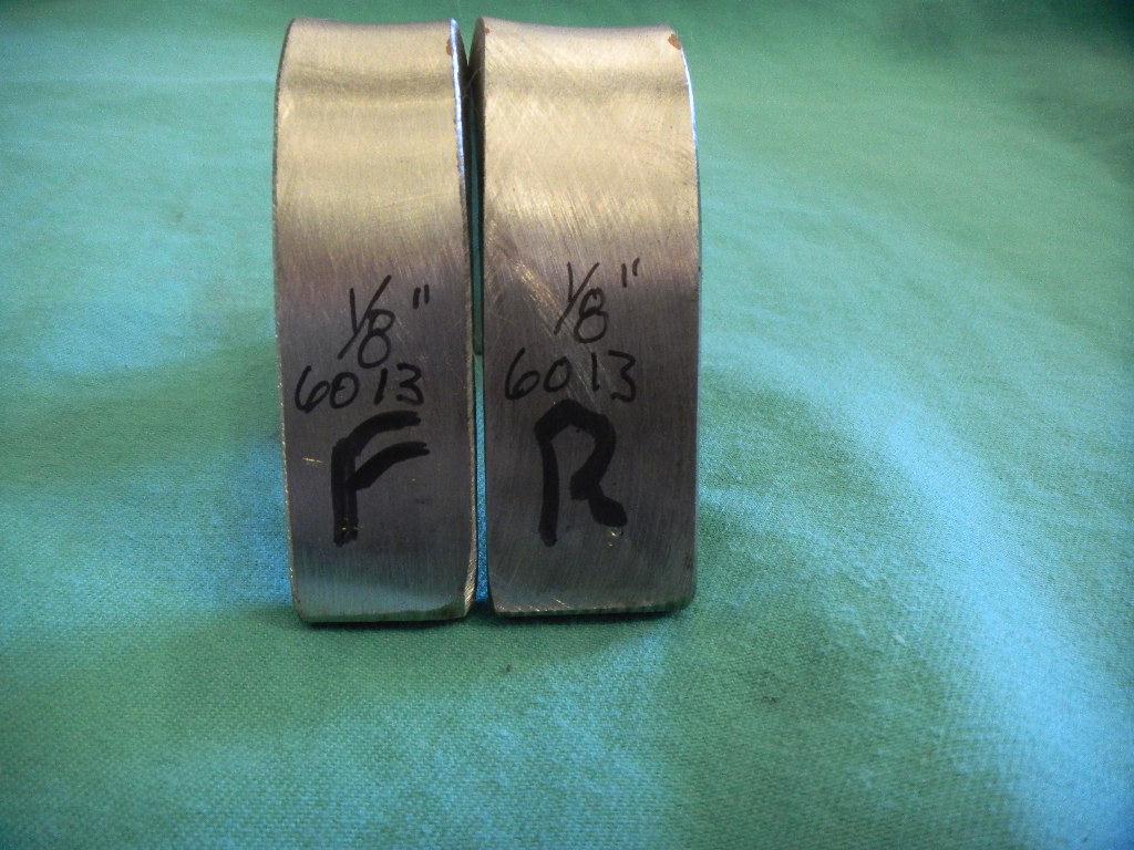

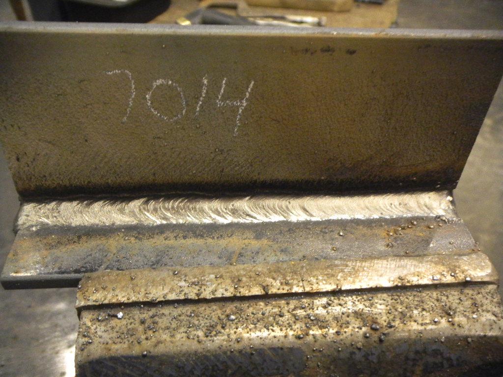

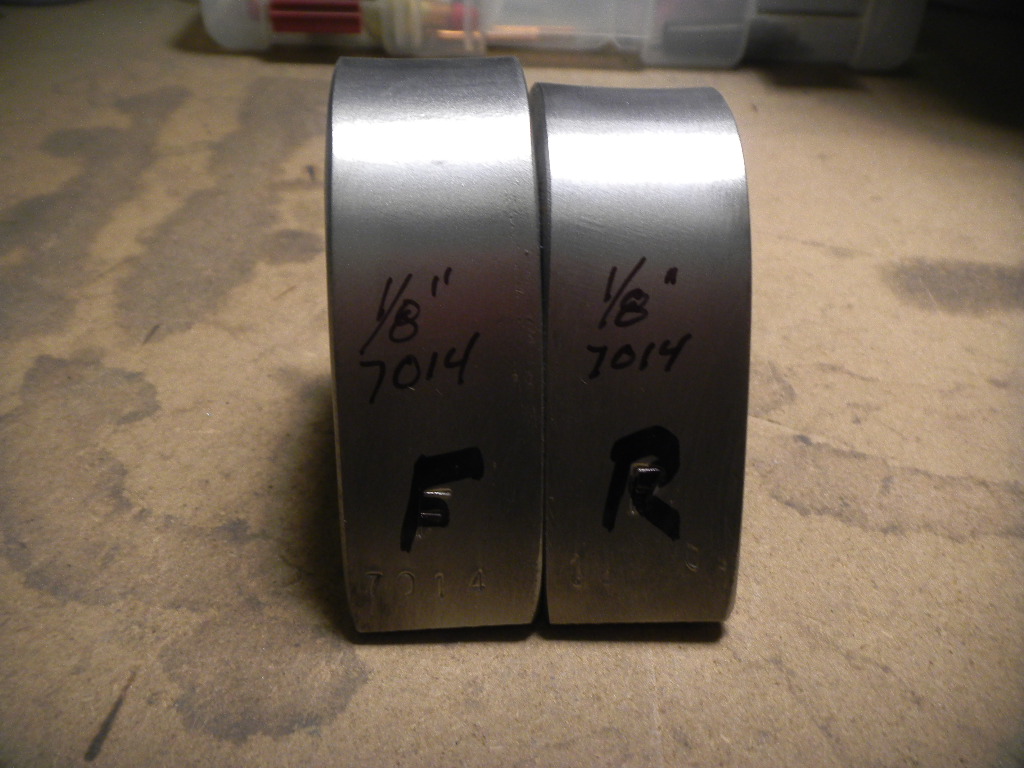

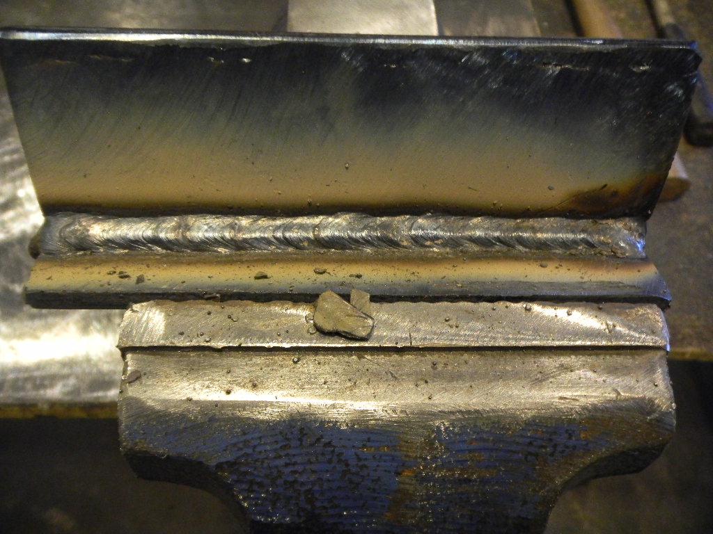

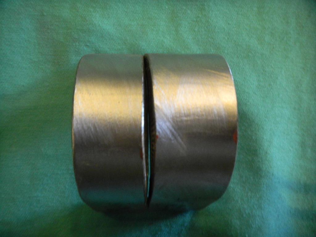

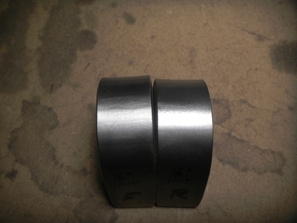

6013, and 7014 are strange rods to me:confused2:. The impact properties are low, but they still bend just fine.
6013 = 3-blows
6011 = 8-blows
7014 = 10-blows
Thanks for posting this, ShieldArc. I've often thought about these tests you made along with your notes, and always meant to go back and copy them for future reference. :thumbsup:
Among other things, your tests show how much better the 7018 rods are for strength over the other common rods. And the tests put all commonly used rods in perspective while answering several questions that had been brought up (particularly about 6013 and 7014).
If I remember correctly, the "cold" 7018 rods were actually used right out of an opened box that had been left open for a good while, and still took 18 blows to break it.
And seems like you said that the weld with "hot" 7018 rods were beat down flat with 23 blows, and still didn't break completely. And you had to beat it back the other way to get it to come apart. :eek:
That was a good read and an outstanding job you did, and much appreciated by everyone. :drink:
