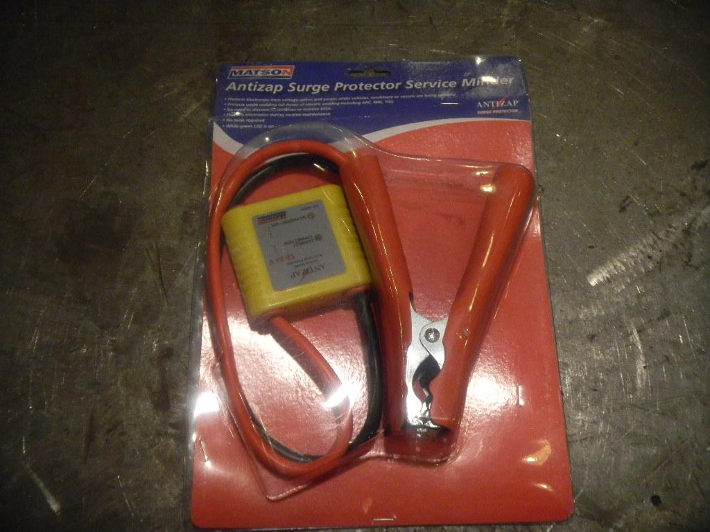

I bought one of these Antizap Surge Protectors, but haven't used it yet. Some of the guys over on Welding Web swear by them.
How Does That work ?? Never seen one before . As always , You teach the rest of Us Something New :thumbsup:
I second the disconnect Battery . Some Don't but what is a couple of minutes for the added security .
Don't know, haven't used it yet. Electronics are way above my pay grade!:laughing:
