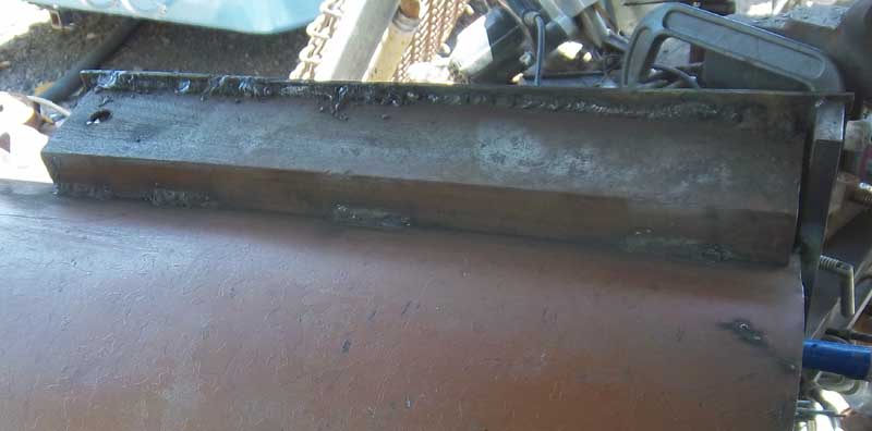

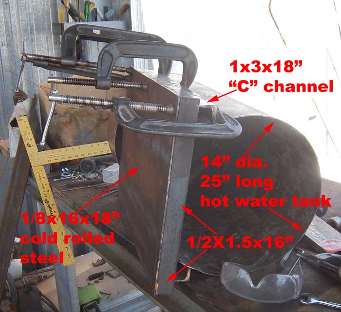

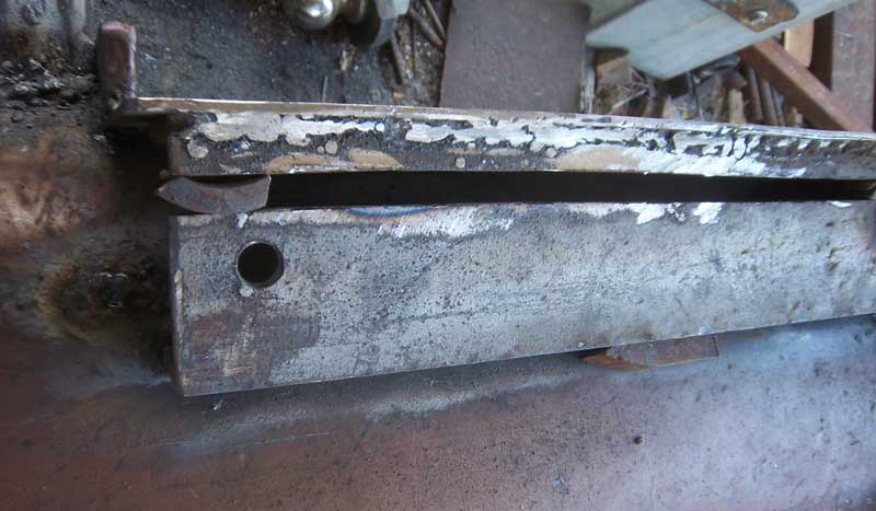

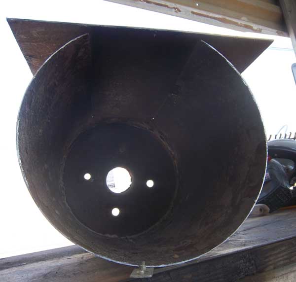

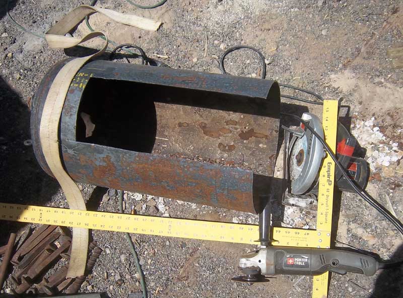

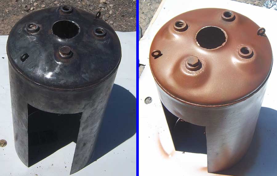

What I thought was a simple change to the wood stoves that I build, sure created a problem. To go from just a heat stove to more of a cook stove a 7 to 8" section of the tank was removed, so that the top plate gets direct heat.

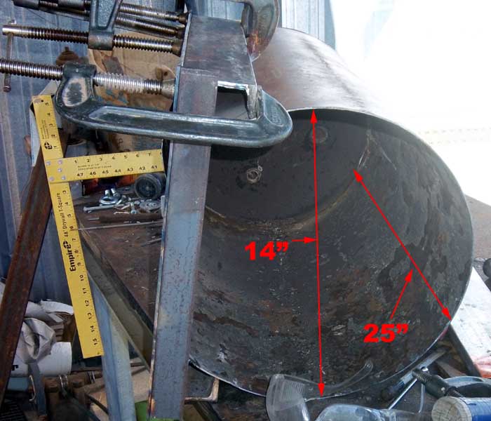

Welding 18" inside a 14" tube turned out to be a real pain. Plan was to tack it down in several places then come back & weld solid. #1 Problem was this tank was thinner than most of the other tanks that I have used. Under 1/8", about .0100. #2 The 18" cuts were not perfect, very close but some small gaps. Using 1/8" #6011 I started a 100 amps. Way to hot so I worked my way down all the way to 40 amps. A little hard to light & maintain an arc. But it was a lot better and less burn through on the water tank. Used some 3/32 rod, no real gain and less fill. Using "splash & dance" ( weld on top plate up close to tank, quickly dance onto the tank.) Managed to get most of the burn through filled. Even with welding a little here and there the top plate warped real bad.
Most of the problems are probably the welder, but I can't replace him.:laughing:
I think 1 answer to the problem would be a wire feed welder, but at this point that is not an option. I had a 50"# box of Murex 1/8" 6011 and really liked it. Had get some new rod, picked up a little box of 6011 at HF. Turned out to be great rod, it would run at 40 amps with almost no slag. Picked up a 5# box of Lincoln Weld, thinking how much better it would be than the HF rod. Wrong, wouldn't run at 75, or 90. At 110 it would barely run. To get any kind of a decent bead I'm up to 145 amps, lots & lots of slag.
Had some Lincoln Weld 3/32 6013. It welds pretty good at 40 amps, much better at 60 or 75. Does not burn through like the 6011. Will use it on the next stove.
Suggestions Please. Other than "replace the welder" and a wire feed welder. :):)

Take this for what it is worth, because I aint a real welder, nor do I play one on TV, BUT, I think you have already answered your own question. the 6013 is a low penetration rod, and of course you need smaller rod, 3/32 or maybe even go down to 1/16 6013, which is available at you "box store" Lowes. who knows what the real amp setting of your welder is, they all vary, you just have to keep adjusting until you get it right, but 6011 is a deep penetration rod and 1/8 is big for 1/8 inch material. I would probably try 3/32 7018 first if it was me, at about 60-65 amps, just because I really like 7018, but the 6013 can work well, just get some small rod, keep turning down the welder until you get good results. There 2 cents from a guy that wouldn't make a pimple on a good welders.....

Welding inside a 14" tube does not give much room, not enough for 2 hands and any vision at at all. What I call splash & dance is a quick pass, about like a tack weld. I was moving from place to place to avoid heat build up in one spot.

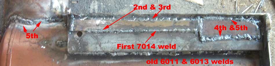

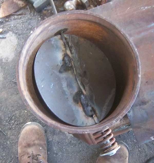

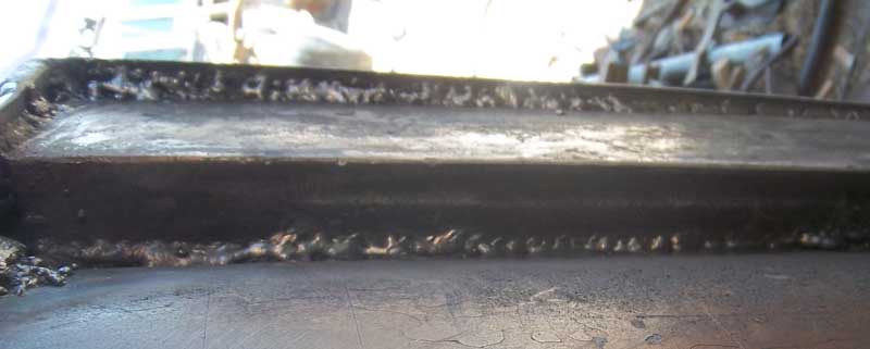

I found some problems with the welding machine. Ground clamp was dirty & rusty. Cable to clamp connection was bad & cable was heating up. Got all that fixed. Rod would wiggle around in the clamp. Filed out the "V" and cured that problem. Things got a little better, but not real good.
Last weld in the tunnel is complete, baffle is welded in. Went pretty well, one small blow hole.
Went to 3 stores got some 1/8 7014 rod. No 1 had 3/32 or 1/16Th. New welds on outside of stove got a little better. Still have the problem of a shaky welder that don't see so well.
7014 Welds pretty good, but does lack penetration. OK for a job like this one. Will run it hotter on something that needs strength and more penetration.
Tank material is only about .085 thick. But think it has other problems as well. Crappy Metal? Sort of like fence "T" posts, just run away from a weld. Tank coating or minerals inside it?? Edge welding a real pain, quick welds on the outside away from a edge goes pretty well.
Damper is welded in. Split cut in "C" iron to flatten top of stove is welded up. Some early crappy welds were ground out and re-welded.

This week at Fastenal I picked up the 7014 1/8" rod. Wanted some smaller but that was all they had. May have them order some smaller and 6013 as well.
I'm starting to get a grip on the new (to me) 7014, 1/8" runs & penetrates at 110 amps. Runs at lower amps but very little penetration.
