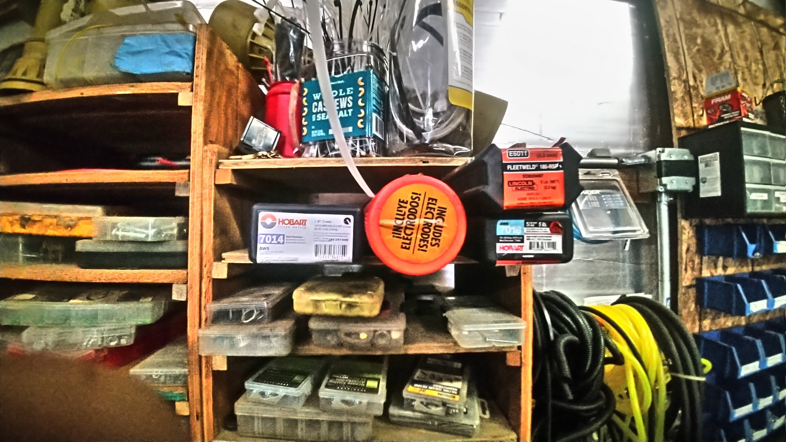

I use 7018, 7014 for old steel, 6011 Hobart and Lincoln mostly. Had a bad experience using HF flux core wire in my old Lincoln weldpak 100 amp, wire kept breaking and tangling up. I'll gladly pay the extra few bucks for the name and consistent quality. only welds that have ever failed me were flux core using a lower amp machine btw.

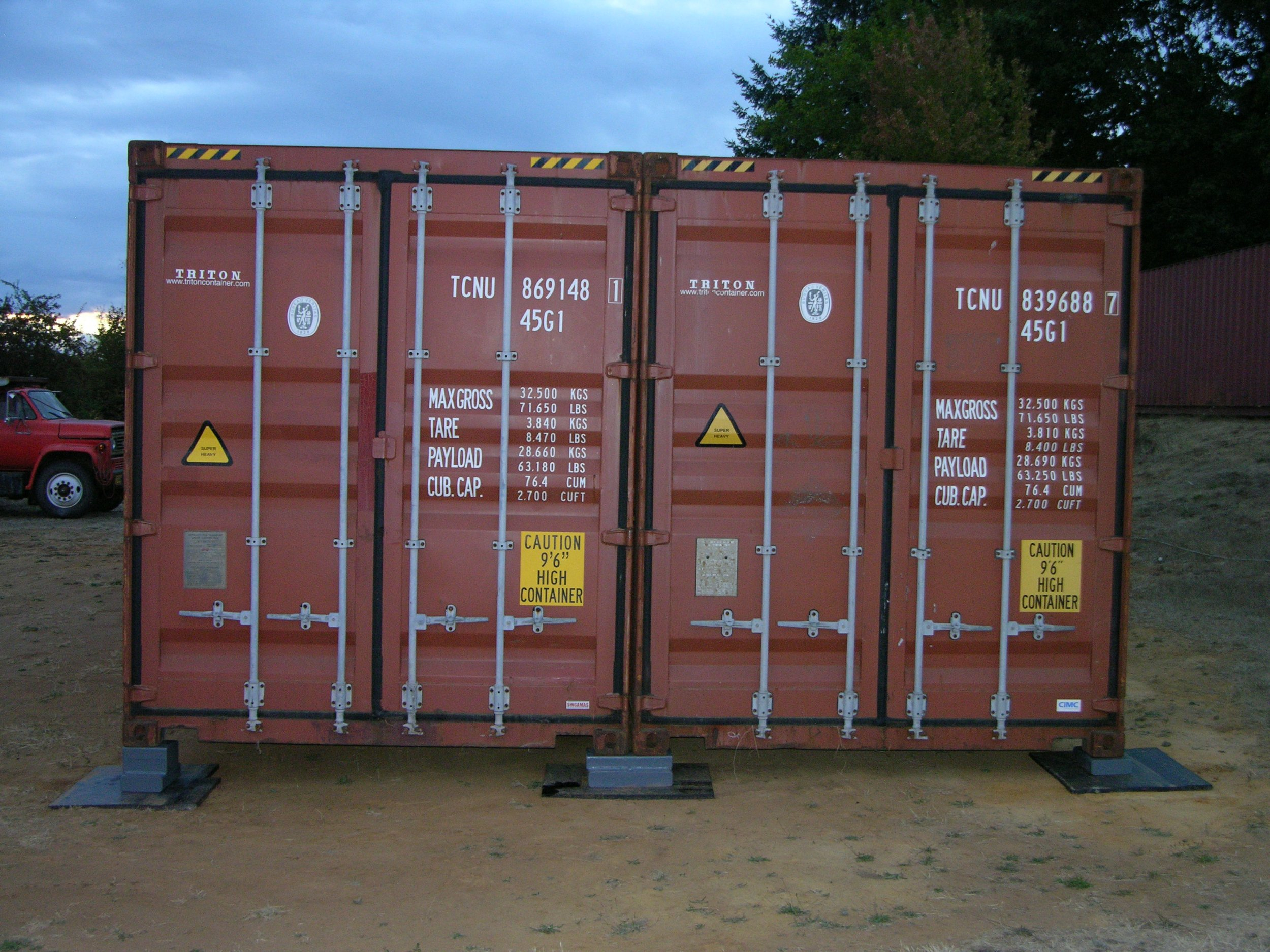

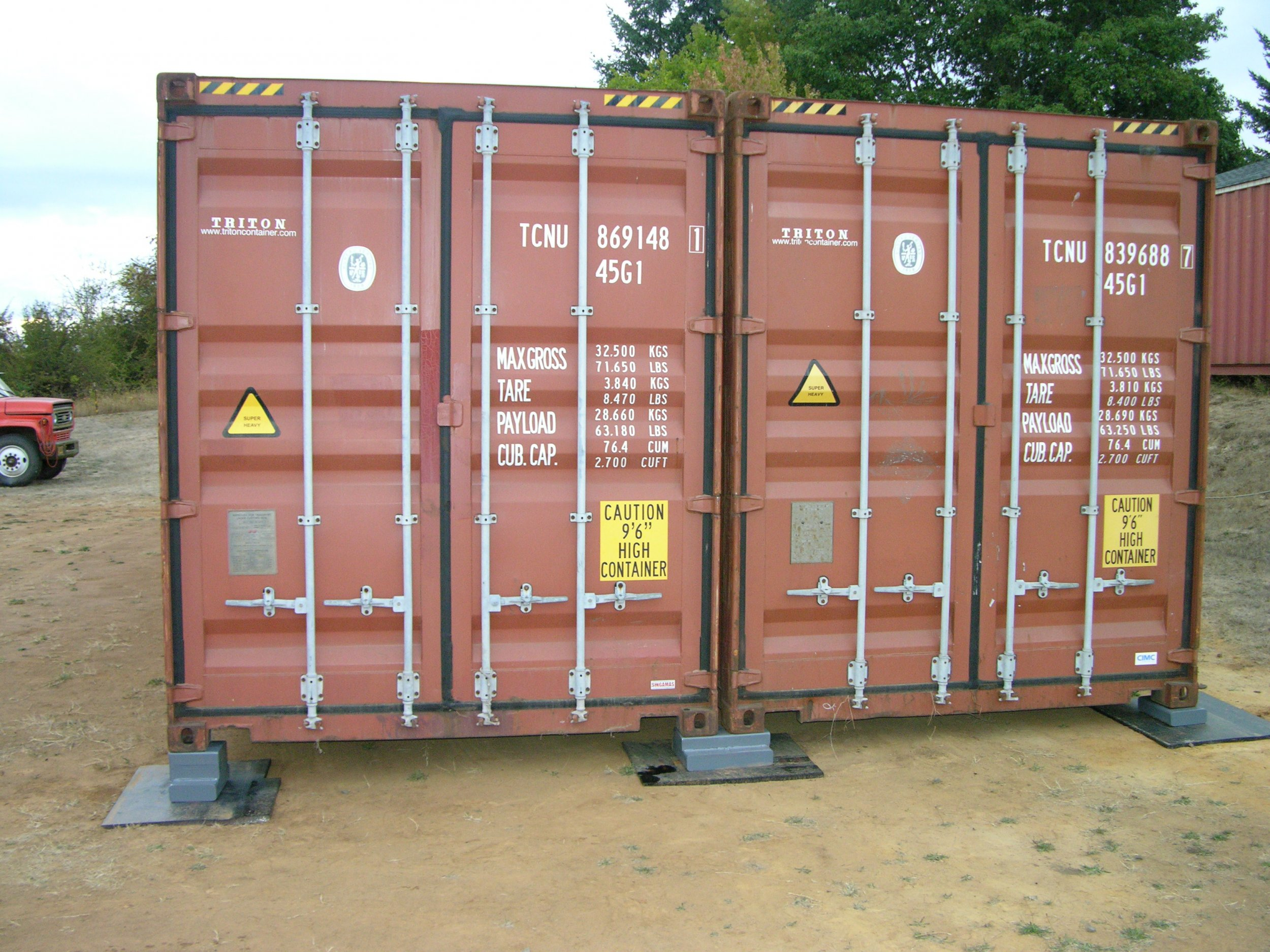

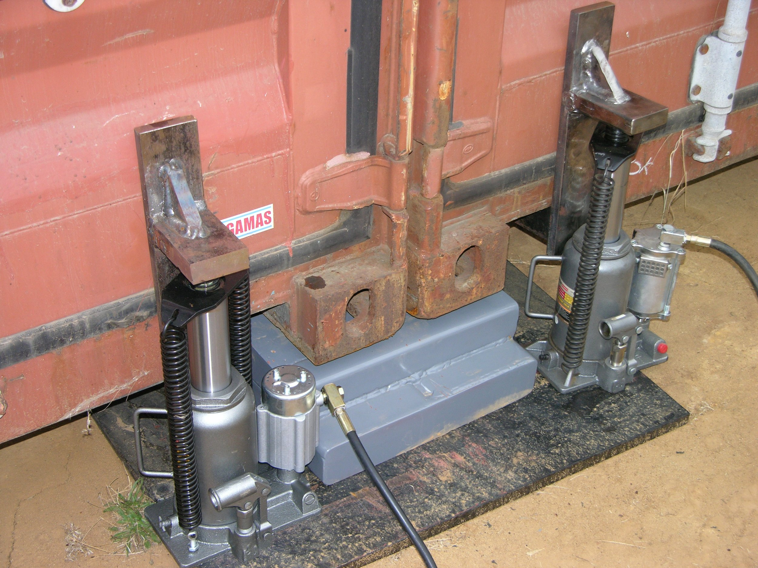

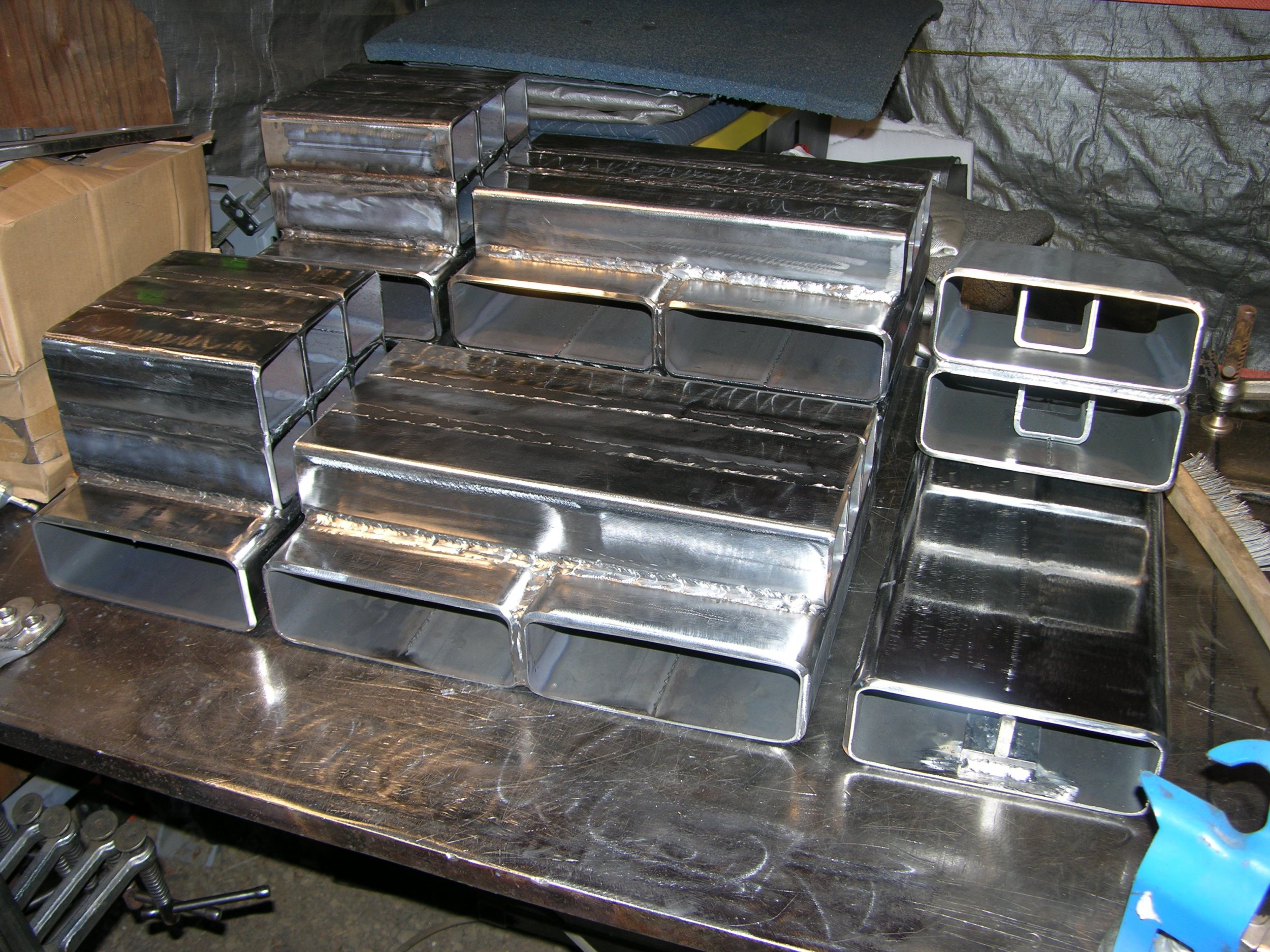

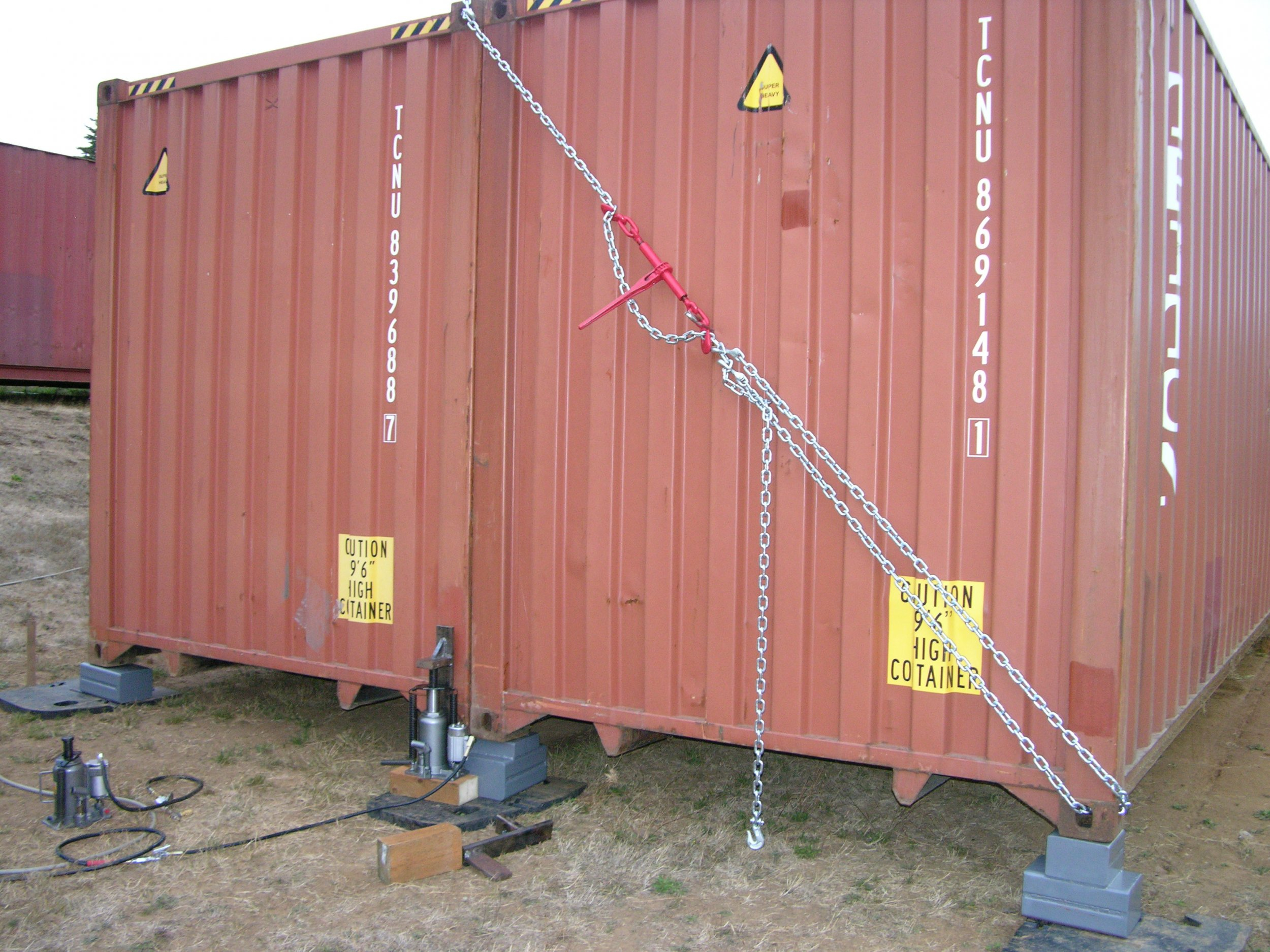

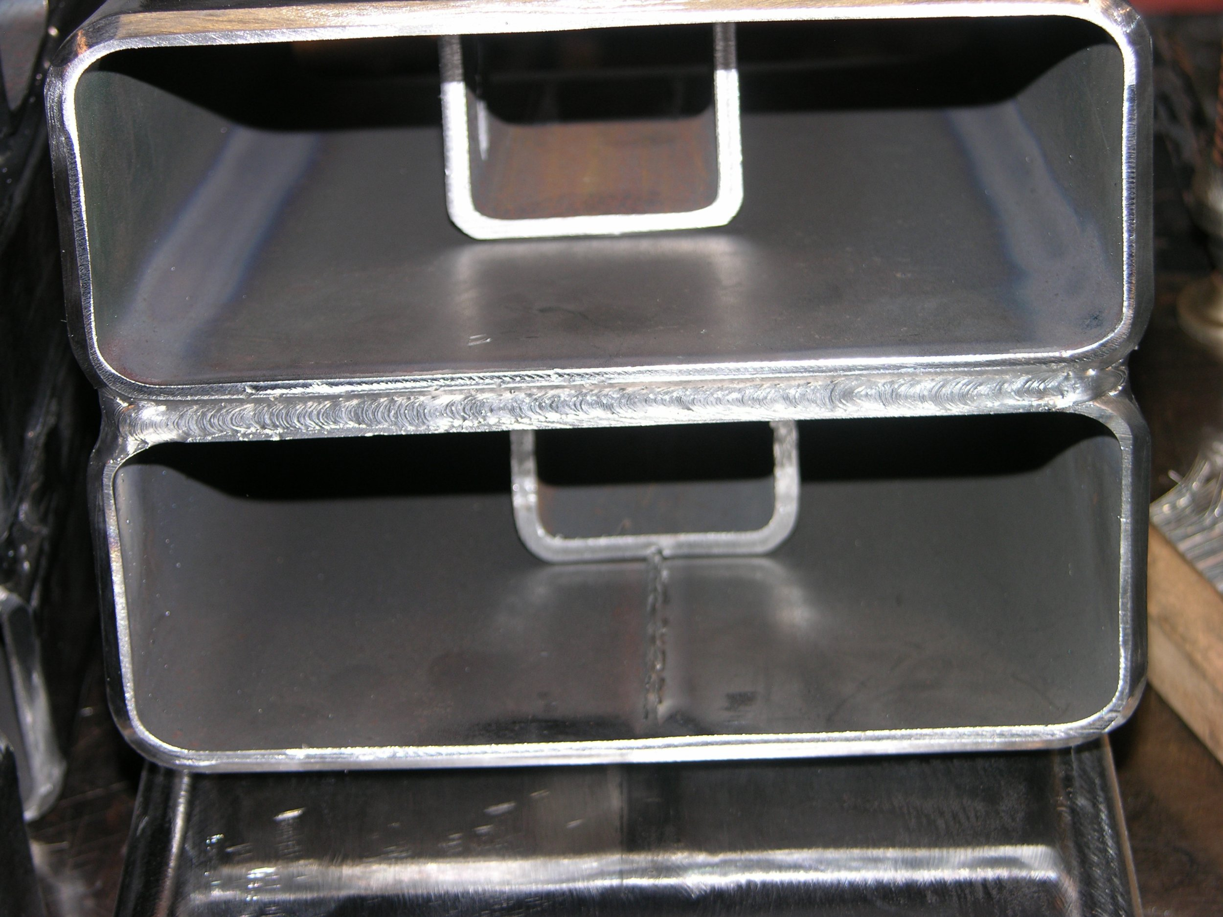

I have this Everlast unit
It runs every kind of stick I throw at it, BETTER than my old Solar 250 ac/dc copper wound stick welder. I typically set it for about 20% hot start and 15-20% "Arc force" (aka "dig") - no problems at all running 20 yr old 6011, 6013, 7014, 7018 (dry but NOT stored in a rod oven)
About half of these welds were done with the Everlast using mostly 7014, other half with the MM252/lincoln L56 .035 wire - I needed 6 different height pylons to level a pair of containers til I finally get enough $$$ to get a 48x60 slab done... Steve
