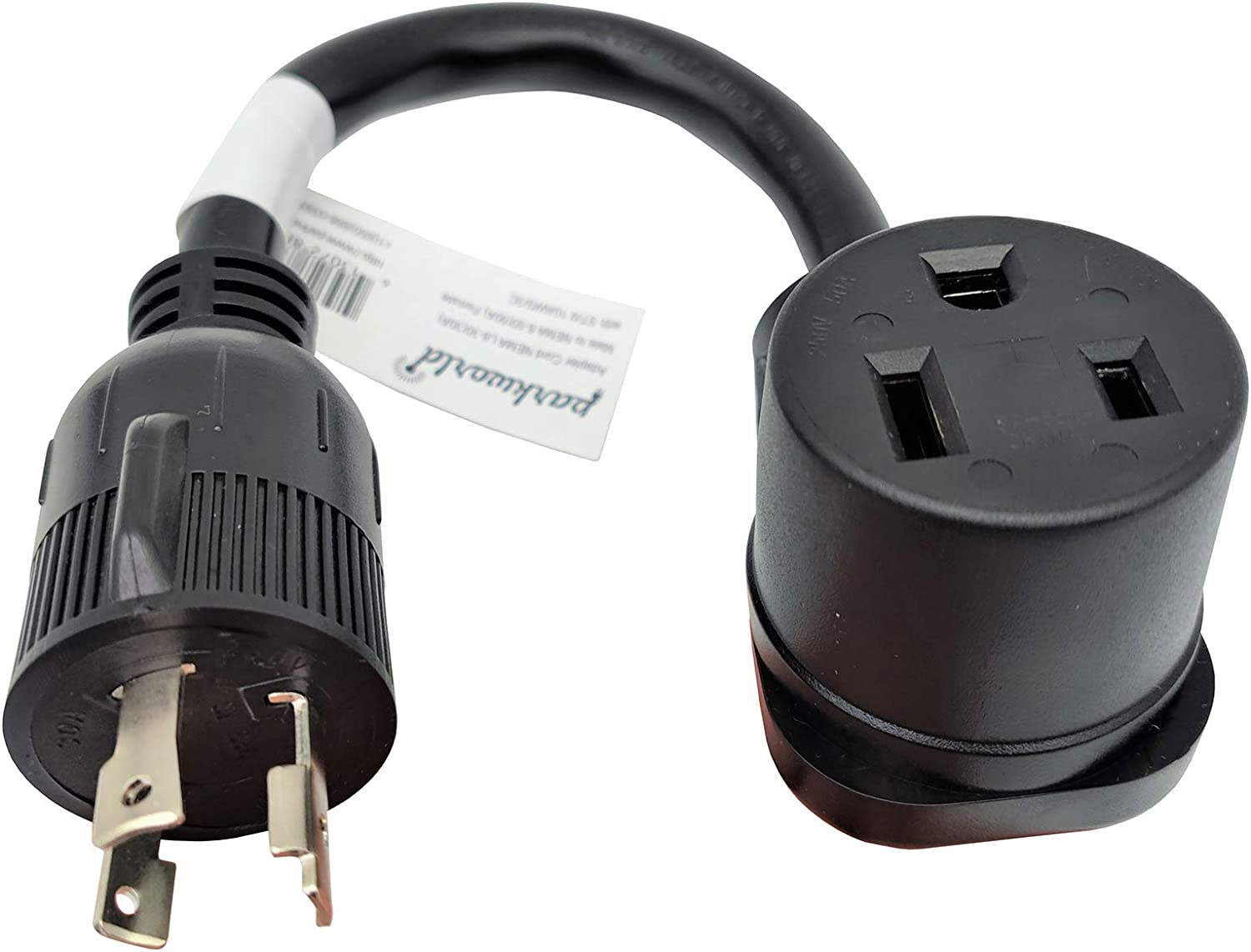

What you really need to understand is outlet rating on generator.... MY 6500 watt generator has two 120v 20 amp outlets (NEMA 5-20R) and one 30 amp 120v (three prong twist lock NEMA L15-30R) outlet and one 120/240V 30 amp outlet (4 prong twist lock NEMA 14-30R) but in many cases the Neutral is not used for 240 V operation just L1&L2 and Ground....
What you really need to understand is what output generator is capable of and how to wire it correctly just flopping around and trying to buy adapters and such by guess work is not really going to help you much.....
I personally run my Hobart Handler 140 MIG on the 120V 30 amp (NEMA 15-30R) outlet with DIY adapter cable to a NEMA L15-30R receptacle...

If you have 240V 30A outlet on generator (NEMA L14-30) yes this is probably adapter you need if your welder is 240V (NEMA 6-50P)....
The round plug on generator says 120/240 volts, Will it be stronger considering its only a 4000watt generator? If i can't weld 3/32 rods its not worth it to me to buy adapter

Heres specs of my welder, The generator is a champion 3000. peak 4000 I welded 5/64 rods nice penetration at 75 amps, it would bog when starting to weld then smooth off nice, Generator 4000 starting watts then runs at 3000

According to that, I would get as much as you can for your two (actually 3000 watt) generators (if still possible, send the new in box one back) and find a genny that puts out 6000 watts CONTINUOUS (it'll probably be around 7500 PEAK) - I just looked at Northern's offerings, apparently that size range is pretty rare - then....
I found this model elsewhere, it's EXACTLY what I'd recommend for what you're trying to do and you will NEVER find a better price. It's also spec'd at under 5% THD. This is NOT an inverter welder, that size in inverter would run over $2000. Running on this generator your welder should run any rod the mfg claims it can -
Disclaimer - I've NEVER dealt with that company, but if I were in your situation I'd grab one before they add the other $500 or so to the price... Steve
