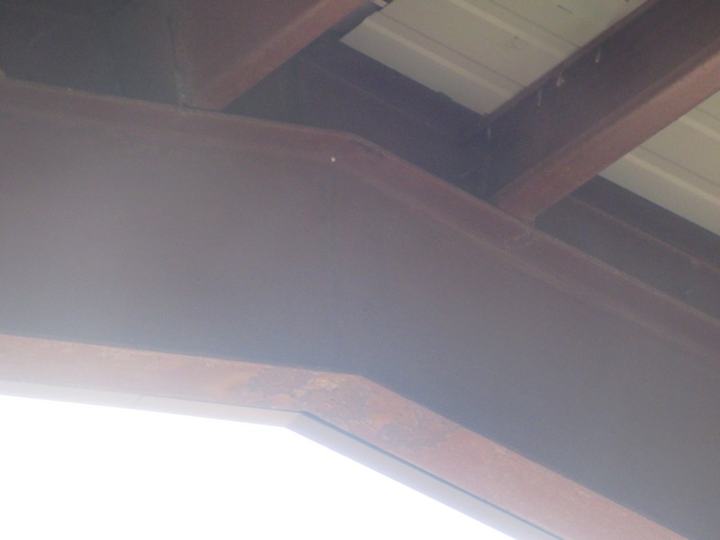

FWIW: My barn is built with trusses that are done the same way and is a 40' span spaced 20' apart. Also 12" beams although I don't know the weight. - and no reinforcing plates. I'll see if I can get a picture tomorrow.
Not a very good picture, but it's the only beam visible and a lot of sky background washes out the detail. It looks like the web and the flanges are welded and that's pretty much it.

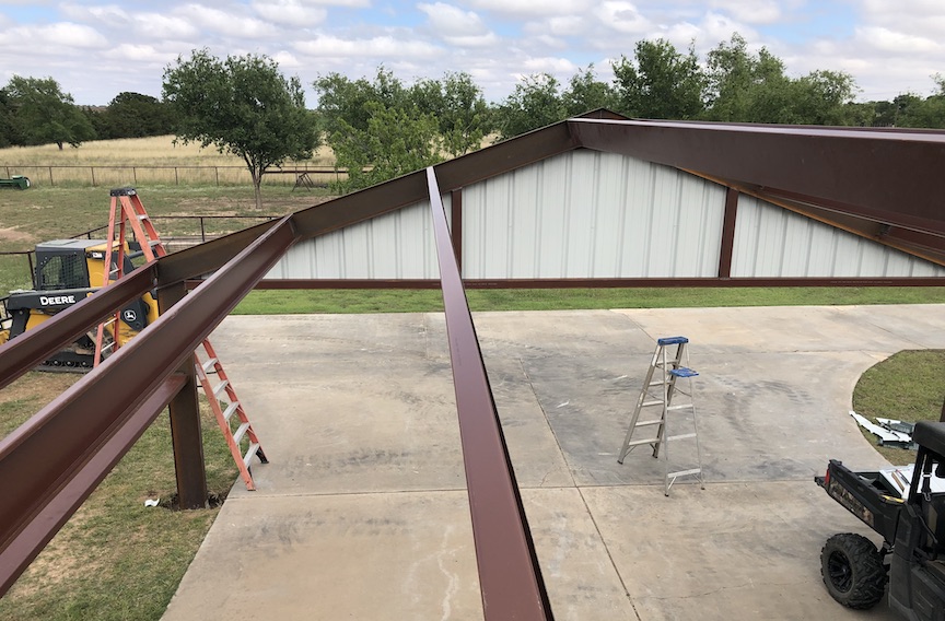

Finished up the purlins today.
I am going to close in the gables and maybe about 4 of the sides. The tin won稚 be in until Thursday.

Bdog
The connection between columns and the beam does not have a good path for stress. Consider welding plate on end of beam
/ Welding I-beams together #26
Bdog
^^^^^^What he said!

I was watching NOVA great cathedrals and thought of your building. All your stress will be where wall meets truss, a combination of downward and rotational. See arrow in pic
/ Welding I-beams together #31
Royking, your picture shows what I was concerned with in my comments

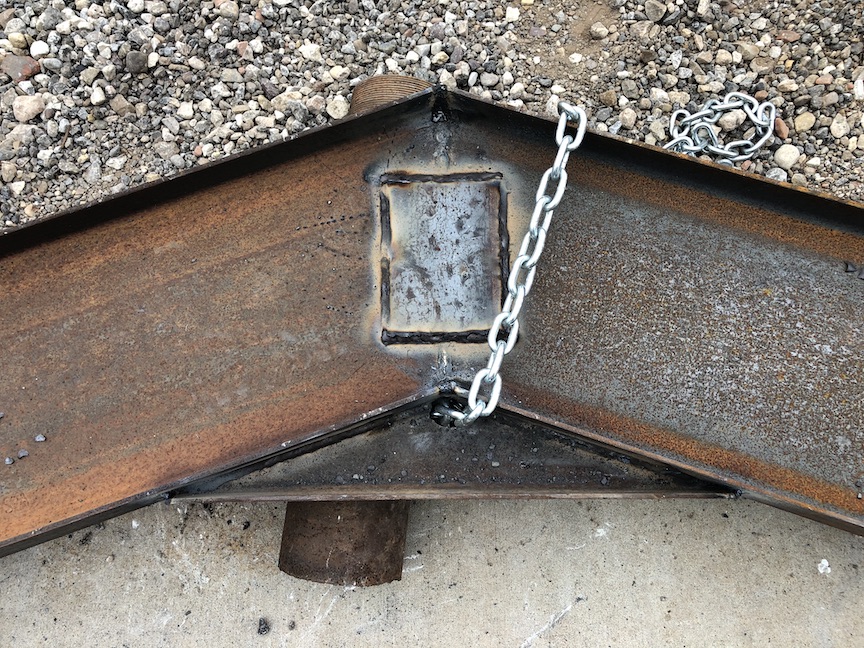

/ Welding I-beams together #33
You have probably got some 12 beam left I cut a piece to fit where joist meets post see pic
#34
That is a good idea. Unfortunately I don't. I bought four 30' beams and cut them 17' & 13'. 13' went in the ground and and 17' up top. After I trimmed them to size I had no piece over 6" long.
I did Add some more material to it though.

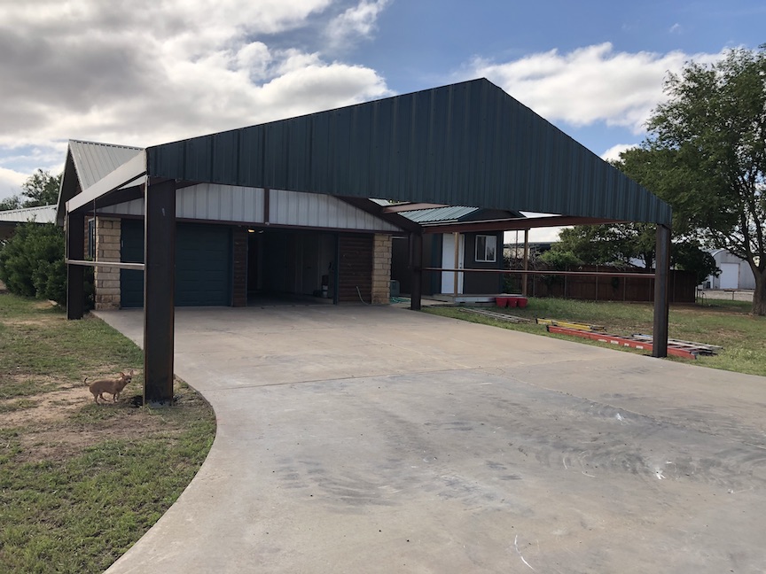

We got the tin on the ends today. Tomorrow if the weather cooperates we will do the roof.
/ Welding I-beams together #35
Looks really nice bdog! Is that a Chihuahua getting prepared to christen your carport?
#38
Thanks guys. Now I can sleep better knowing not everyone thinks it is going to collapse.
Yes that is our Chihuahua or our little sewer rat as we like to call her.
