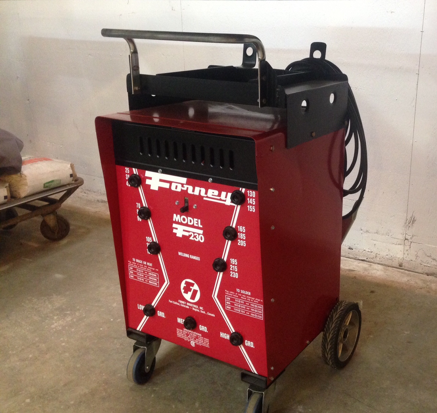

/ Welding Hardened Steel #12
You'll be fine using 6013 with your Lincoln AC.
That's all I ever used on the farm with my buzzbox. Back then I didn't even KNOW about DC welders.
Bought it new for $220 in 1965 off the Snap On truck. Still have it...
Terry
And still in good condition Terry. Very cool that it has settings for Soldering and Brazing/Heating as well as welding. Do you have the necessary attachments?
/ Welding Hardened Steel #13
Spanner. It came with a carbon arc torch, a couple boxes of carbons and a plug-in soldering iron. Regretfully, over the years these items were 'disposed of'.
A couple of years ago I took the dents out, repainted the sheet metal and had the front panel info digitally reproduced and 'wrapped'. Also reworked the undercarriage to make it more user friendly and added 'cable management'.
It's probably in the best shape it's ever been and I never use it anymore.
Terry
