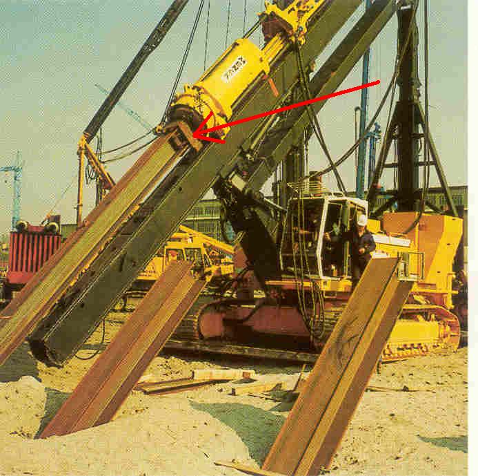

We used Super Missile Weld for quite some time, trying to keep cast steel pile driving equipment together. Then we switched to 312 stainless steel.
