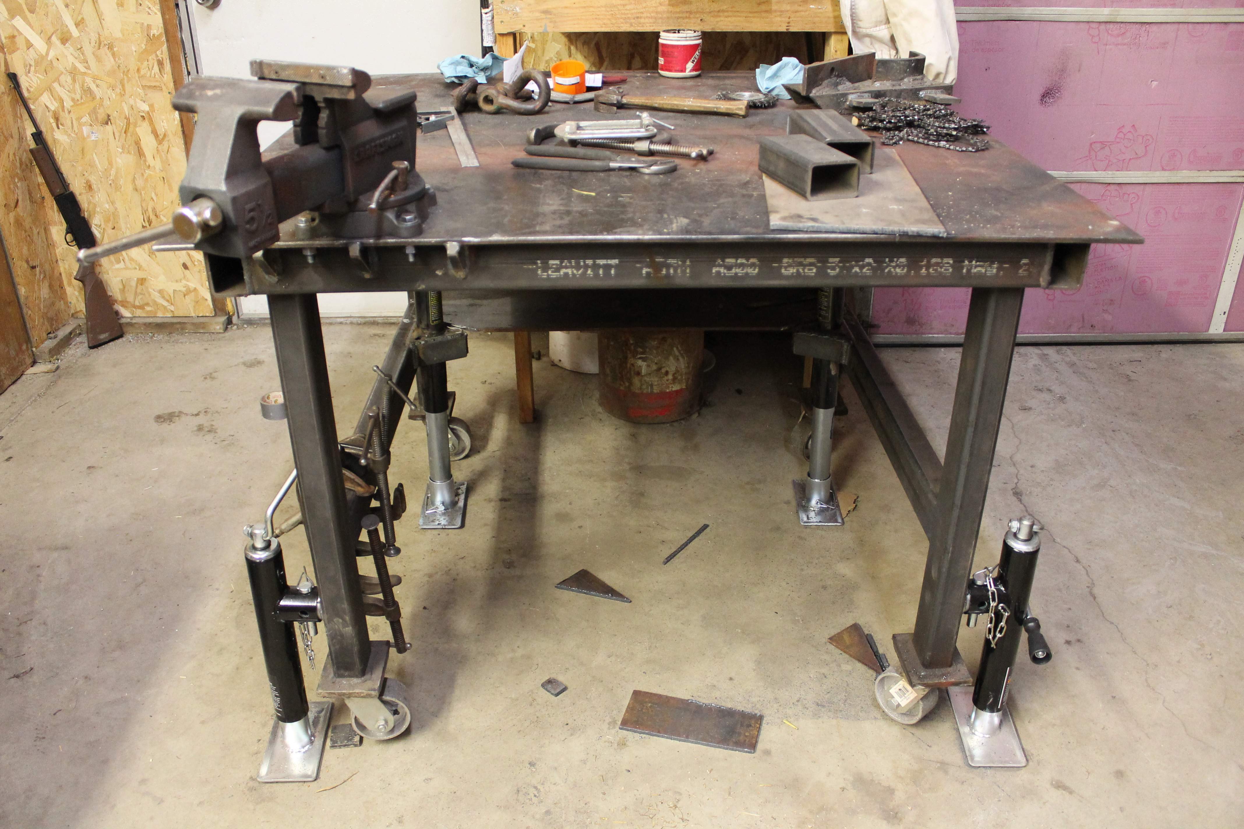

don't get here often and have to request for new password :p. I posted this before and here's what I did.... a newbie job ;) 1/2" plate and all 1/4" tubes and angles plus 1000 lbs. each wheels...
Very nice. How do the stabilizers lower? Are the wheels off the ground when the stabilizers are down?

more than nice, wow. And the world's largest vice...seriously nice setup.

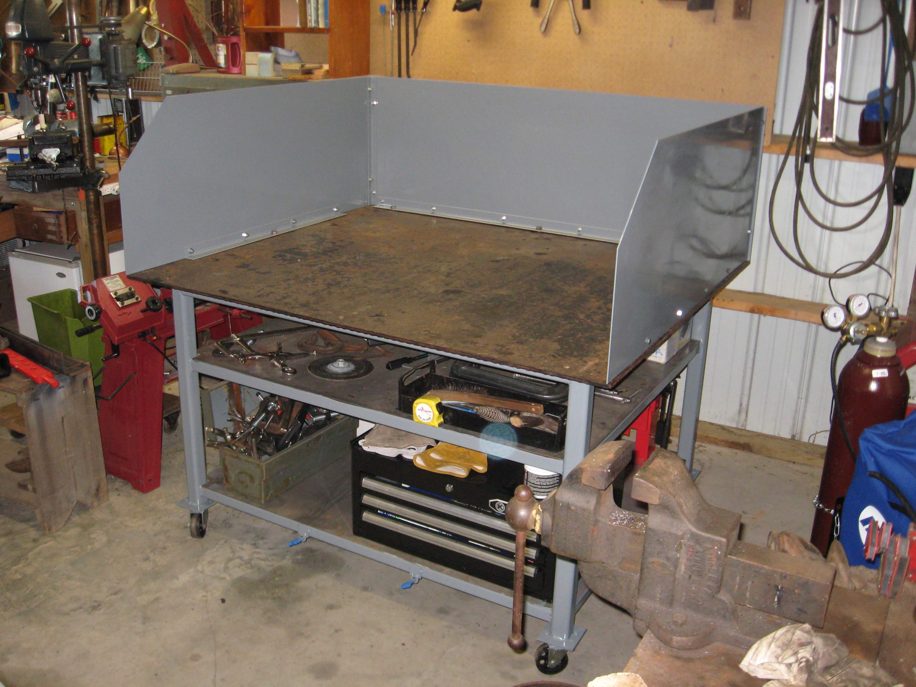

Here are some pics of my table, which I just (mostly) finished today. I still need to put casters on and clean the top, but you get the idea. Here are some ideas I incorporated into the table: Stinger holder on the front left side (I'm left handed) made from an old U-bolt that I cut off. Hooks for looping the cord for the electrical outlets--also made from an old U-bolt, cut in half. Four built-in electrical outlets. I found some "tamper-resistant" ones at the store that have a gate in front of the hot and neutral holes. I thought this might be a good idea for keeping dust and dirt out of the receptacle. I also went with a GFI, just in case.
The piece of 1" square stock on the left-hand side is for clamps.
