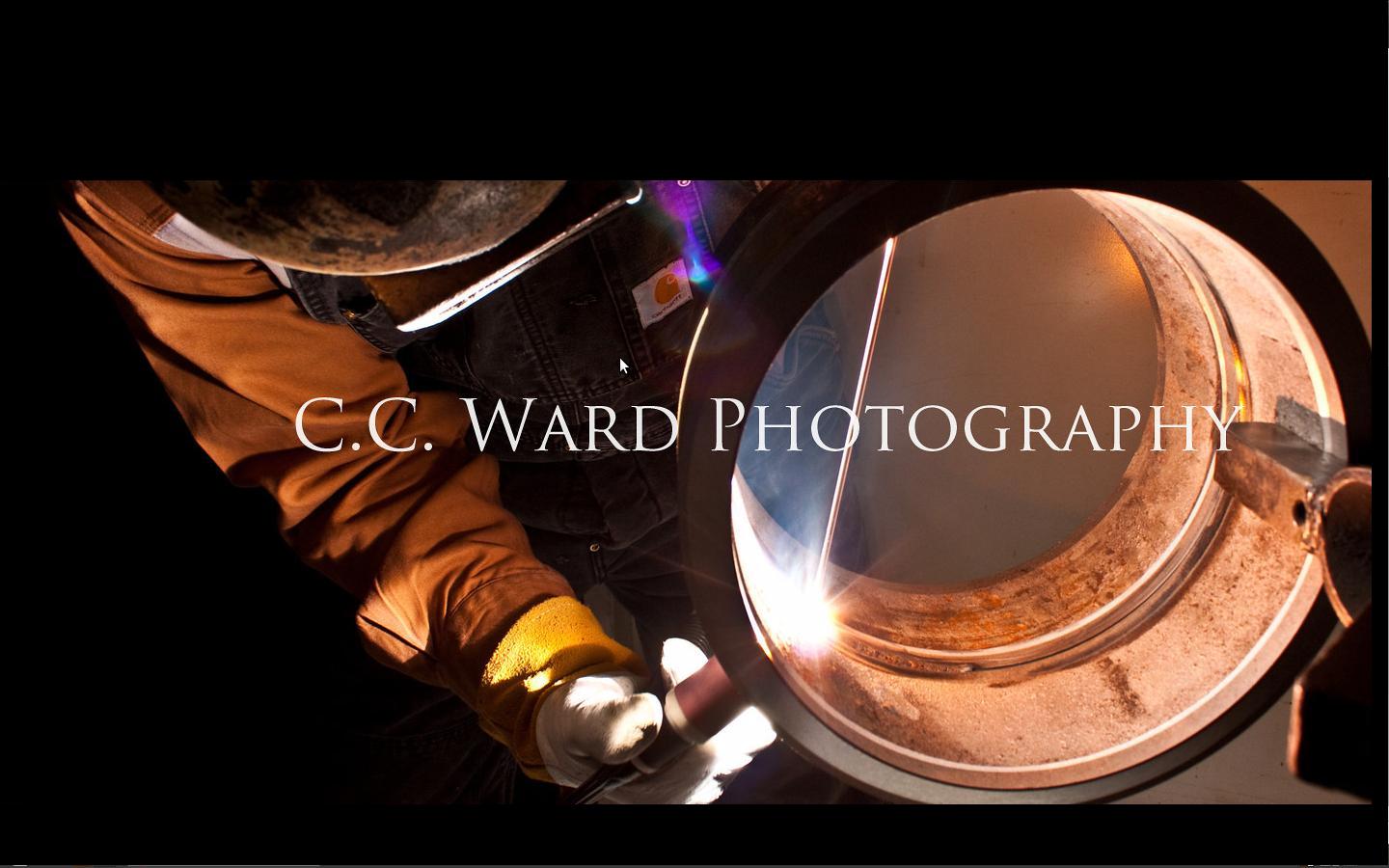

I have even welded pipe from the inside out when the back side was not reachable. Cut a window in the front and beveled on the inside for the hidden area. I can still tell what is happening by the feel of the stinger and the sound of the arc.
I wish I could see well enough, and be good enough Tig welder to weld like this. I understand the pipe welders at PSNS, and Bangor do this all the time. :cool2:
