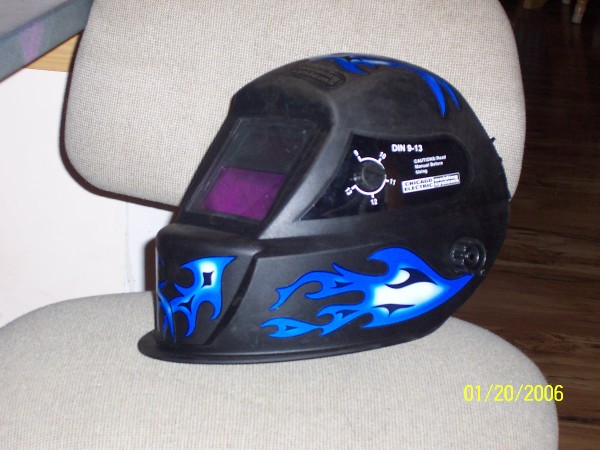

TO ALL you guys who,fabricate,weld ...check out this helmet wify bought me for xmas.AUTO DARKENING it is awesome!!!!!Great visibility,great adjustment strap devices,lightweight,comfortable awsome.HARBOR FREIGHT 49 BUCKS!!!! I used it all day,my eyes aint even stuck togeather /forums/images/graemlins/grin.gif /forums/images/graemlins/grin.gif /forums/images/graemlins/grin.gif Gonna get another to keep in my box at work

I got one of them about four months ago, still working fine.... /forums/images/graemlins/laugh.gif
/ WELDERS HELMET #3
Re: WELDERS HELMET
I'm using a Harbor Freight helmet also. Mine doesn't have the jazzy paint job like yours though. Yours is cool /forums/images/graemlins/cool.gif
