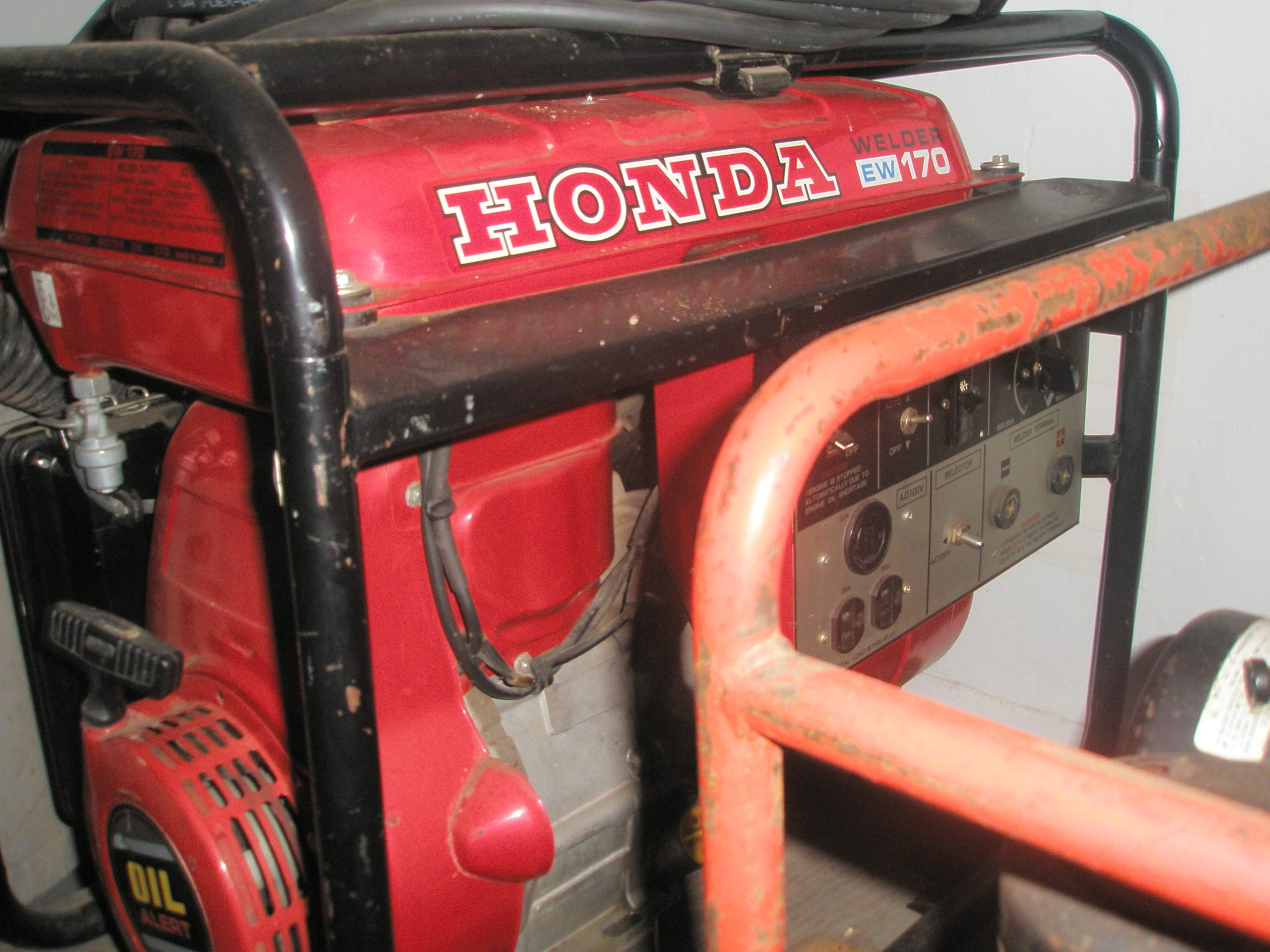

I've got a portable Honda powered 170 Amp DC stick welder, everyone said they were the easiest to use but I have struggled with it, just as much as any other welder I have. (Hobart 135 amp mig and a AC buzz box)
What are you guys using for rods and what polarity? I heard electrode negative, (which I think is called straight polarity, even though it sounds backwards?) was the way to go but have not seen any great improvement.
I'm talking repair and light fabrication up to 1/2" flat and some vertical, (forget about overhead).
Thanks, JB.
/ Welder - Should I Upgrade?? #14
JB4130,
For most DC SMAW (stick) welding, you should be running DCRP (DC Reverse Polarity, ie. electrode Positive).
As for rods, it all depends on what you're doing... here's a rundown of the more common rods you'll see.
  • 6010/6011= good for very dirty metal... very aggressive, lots of dig, very deep penetration. Does not leave very pretty beads behind. Just the characteristics of this rod. 6010 is a DC only rod, and 6011 is the AC/DC version of 6010. A rather difficult rod to run compared to all the others. All position.
  • 6013= Good general purpose rod, good for general repairs on mild steel. Mild to moderate penetration. Often called "the farmer's rod". Not my favorite, but it's not bad. All position.
  • 7014= Another good general purpose rod, good for general repairs on mild steel. Iron powder in the coating for high deposition rates. Mild to moderate penetration. All position. I like 7014 better than 6013, but for the welding we're doing, it's basically just personal preference.
  • 7018= "Low Hydrogen". Intended for use in situations where the weld is critical and must meet "x-ray" quality standards. Requires special storage procedures to retain this "low hydrogen" characteristic. Mild penetration, very high strength. 7018 is generally my go-to rod, even though I don't have the equipment to store it "properly". It's a great general purpose rod, even stored "improperly". 7018 is a DC only rod, however there is also 7018AC available, which is designed to run on an AC only machine. All position.
I've got all of these rods on hand... but if I had to limit my choices, I'd just keep 1/8" 6010/6011 for the really dirty stuff, and 1/8" 7018 for everything else. 7014 would be my #2 choice after 7018, then 6013.

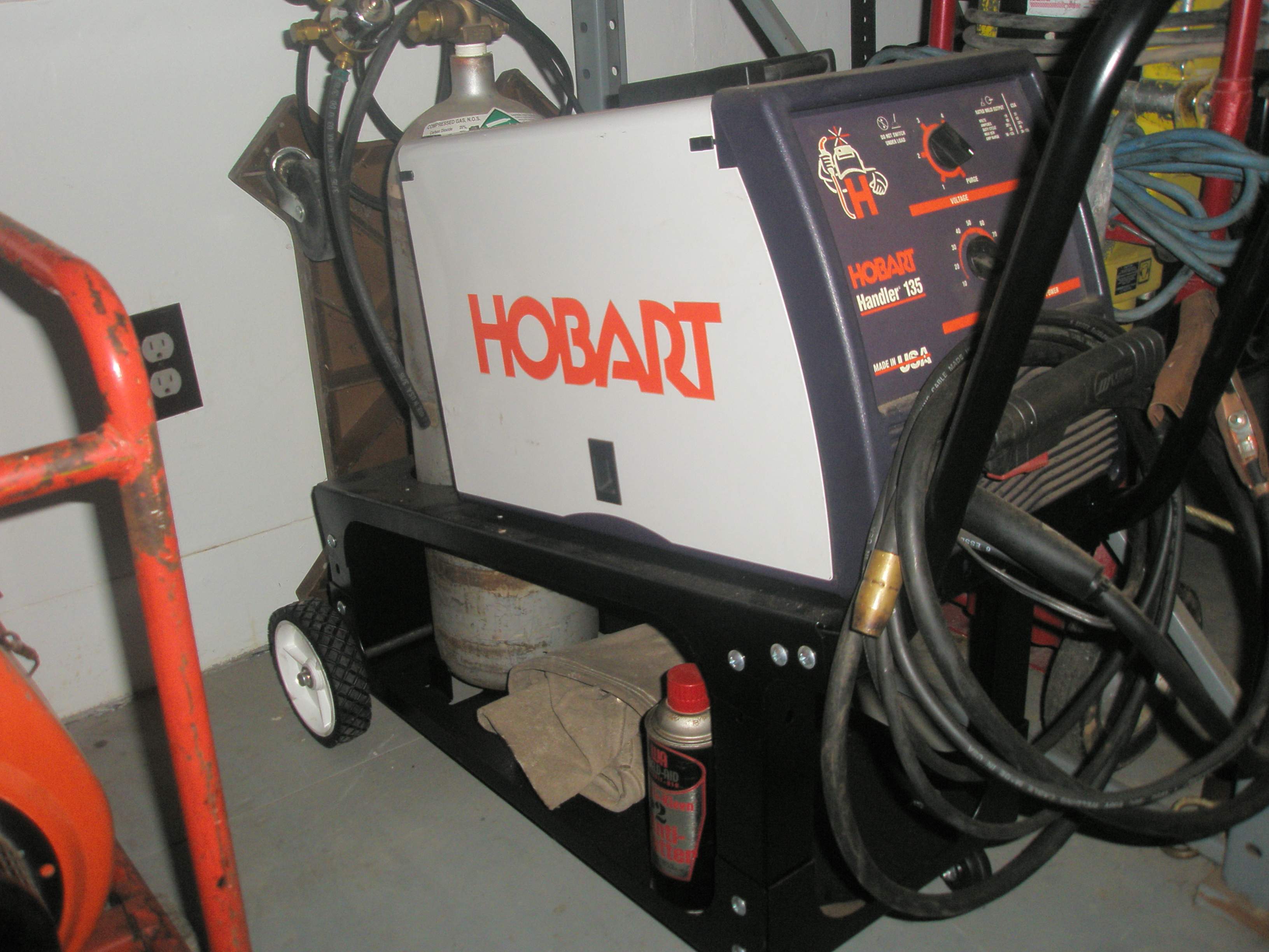

I would say if you like the 110 mig you will be very happy with the 220, I've never used the 220 but everyone swears by them, I've got a Hobart Handler 135 amp 110 volt mig I use with the gas but it is very limited, not good in my opinion for general repairs. more suited to cleaner lighter work.

I have very little experience with the DC, so I'll get some 6010. Is the 6013 and 7014 also good for DC? and when is Electrode neg used with DC? I thought that option was what made the DC easy to use.
This is my go to machine :) (the AC buzz box) I literally found this on the side of the road 30 years ago! scavenged some leads and have been using it ever since. Also pics of the other 2.
JB.
