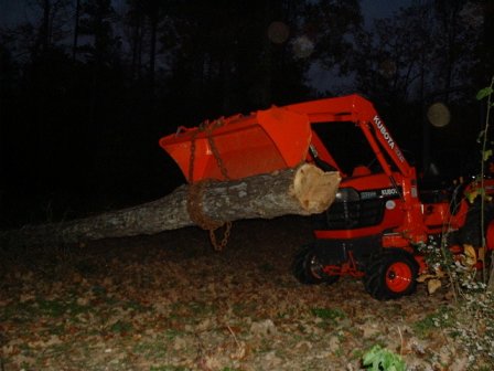

Welded some hooks on my FEL
   / Welded some hooks on my FEL #11
Make sure you have a lot of weight on the back of your BX before you try to do that lifting! And wear safety glasses in case those hooks snap...
   / Welded some hooks on my FEL #12
I know he only has a bx. but when it comes to safety sometimes you do not get a second chance. so why take the chance. If my first post seemed to harsh, I apologize. Just do not want to read about someone getting hurt if it could have been prevented.
#13
The hooks held!!! /w3tcompact/icons/grin.gif This tree was the heaviest thing I could find. I think is was a good test.

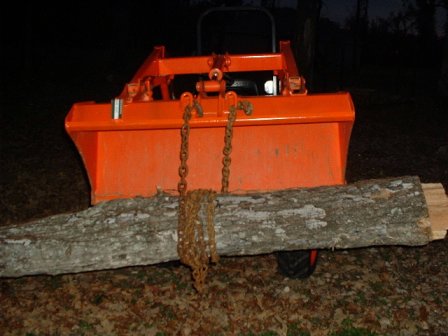

#14
Here is another photo...
   / Welded some hooks on my FEL #15
<font color=blue>...when it comes to safety sometimes you do not get a second chance. so why take the chance...</font color=blue>
Amen to that...
I agree, Safety should have the priority...
   / Welded some hooks on my FEL #16
Looks good.
Please always use both hooks whenever possible!!
I have 3 hooks welded to my bucket and I alwys use all 3 when lifting heavy loads. I believe this " spreads the load" between the hooks and does not stress the bucket as much.

Boy: I would be very careful with that style hook, I also think they will bend easily and also subject to break-Good luck and please be careful.The 6012 and 6014 are also good rod, give them a try !!
   / Welded some hooks on my FEL #18
Hi,
I would also still try the <font color=red>vicegrip test </font color=red>that was suggested above [can't see by who now.../w3tcompact/icons/frown.gif]
IF you can bend them with visegrips, then you are taking a chance. They may hold fine now but give out later when you least expect it.
It never hurts to be too safe.

   / Welded some hooks on my FEL #19
Welded or bolt?
This brings up a question. Isn't it adviseable to bolt hooks on as opposed to welding them?
I know offroad enthusiasts always stress bolting hooks on and never welding them. I guess that is in reference to hooks with bolt holes. I never saw these weldable hooks, but I guess they are designed to be welded. Did I just answer my own question?
Do most of you weld or bolt hooks to your buckets?
- Gerald
   / Welded some hooks on my FEL #20
Re: Welded or bolt?
I had the dealer weld them on my FEL and on on the BH bucket prior to taking delivery. It seems to be the standard way of attaching them.
