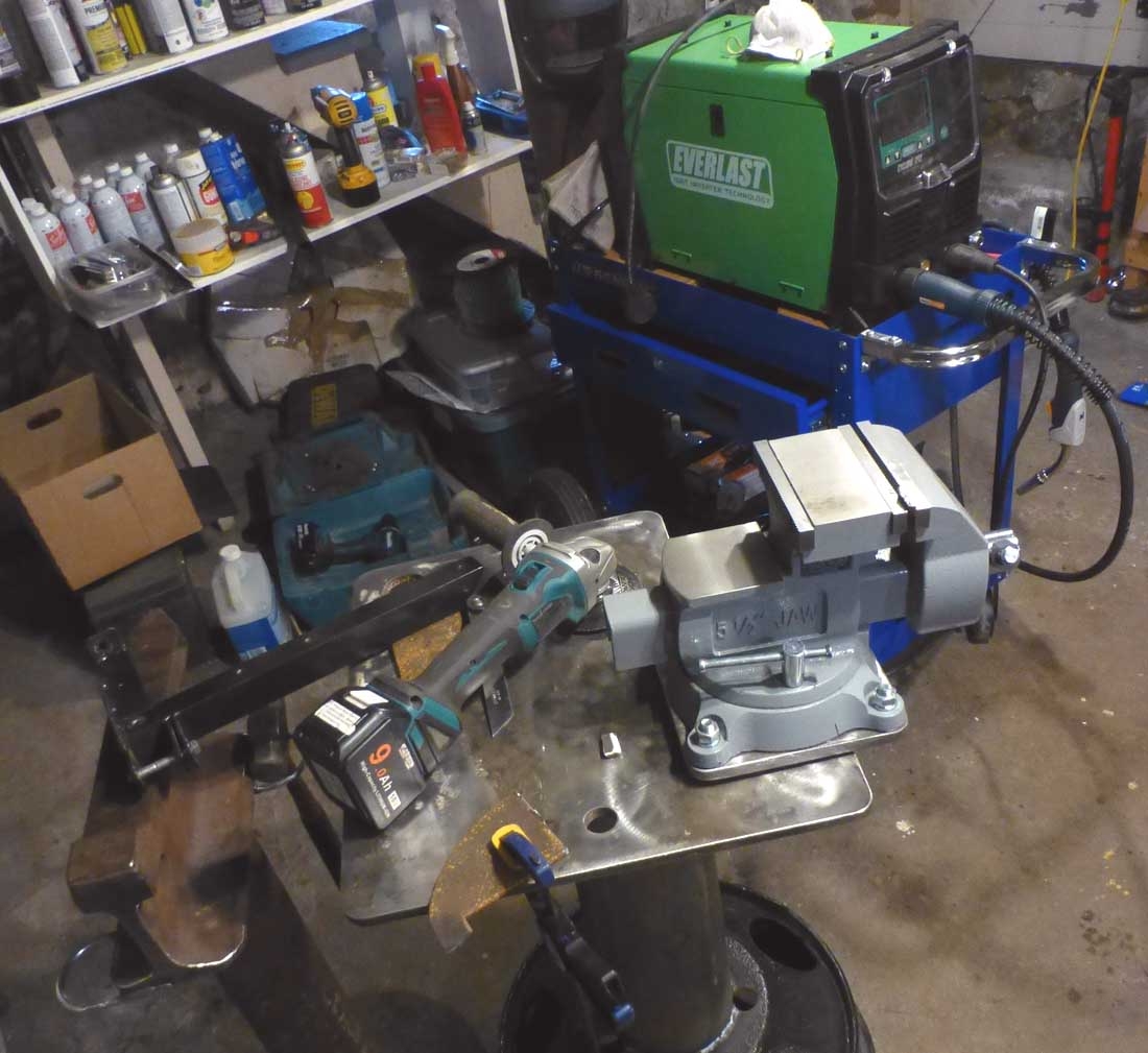

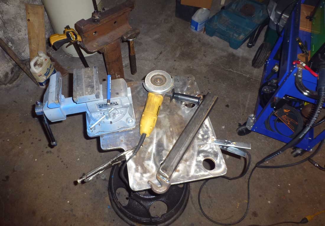

I built a weld work table this fall and loving it. Did a few project on it already and now I'm adding tools to it. What are you favorite tools and accessories do you have with ours? Do post pics.

Like you, I love using the flap wheel on the grinder to smooth all the sharp edges away. I also see in the next picture that you have another grinder with the thin cutting disc. I wish I had 2 grinders so I wouldn't have to constantly switch the discs from cut to sand.
So using the .035 mig to weld thick metal, do you get good penetration/weld build up? Or do you have to make multiple passes, or lay it on extra thick with lots of swirling in one place then moving along?

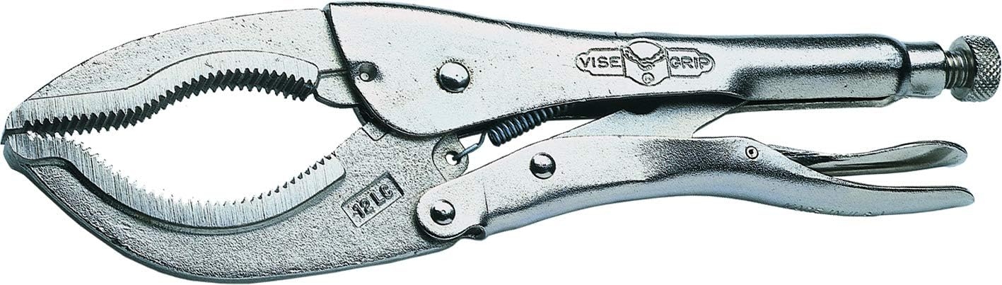

I have 2 grinders with a course wheel, a fine wheel, a wire wheel, and a flap sander... and a 4 " belt sander with a 6" disc all mounted on a bench... then I also have a pair of handheld 4" disc grinders plugged in kept on a shelf under the Vise end of the workbench. A drawer filled with a variety of vice grips is handy.

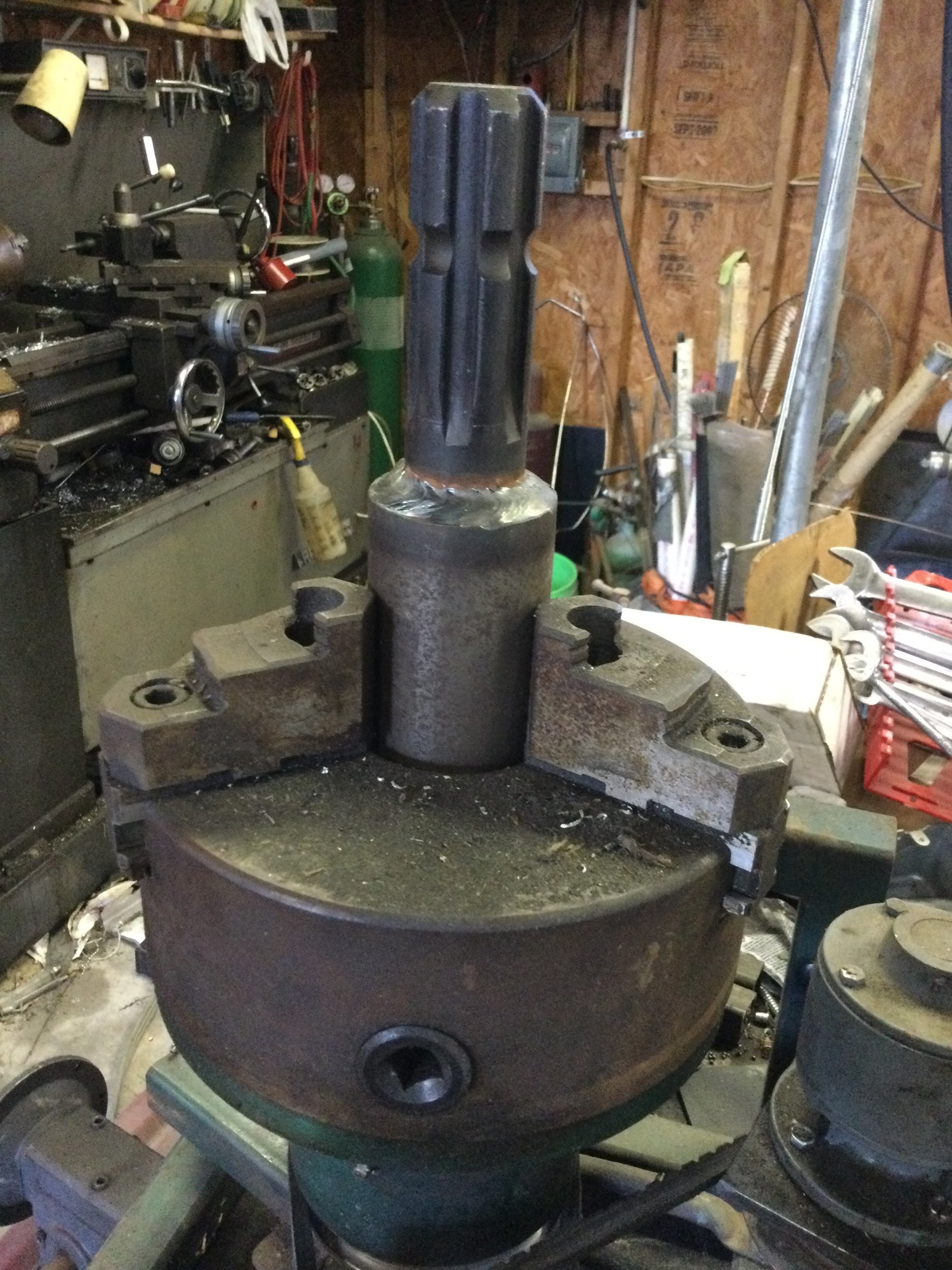

I find a rotary positioner to be pretty handy for making nice welds around things
Kinda of what I use, sort of. I had an old Bison 3 jaw chuck (threaded) that I made a positioner out of. I turned and threaded a dummy spindle and mounted it on a variable speed drive that I can clamp to the welding table so it rotates at whatever speed I require to weld at, which is usually MIG but I do mostly TIG anyway.

In welding the 3/8, I just ran it slow and slightly down hill, pulling the puddle. The forged hook was Ved out. Seemed to weld fine.

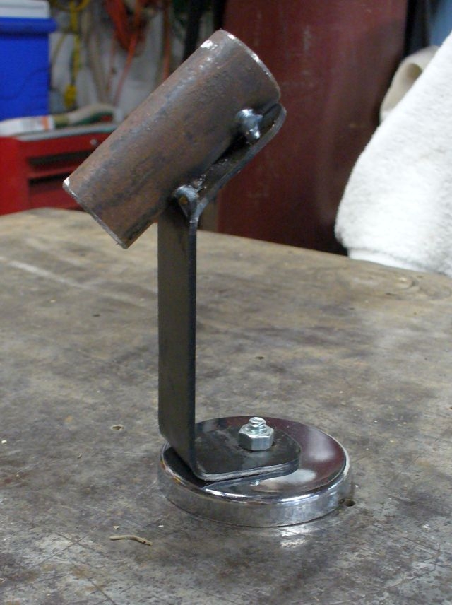

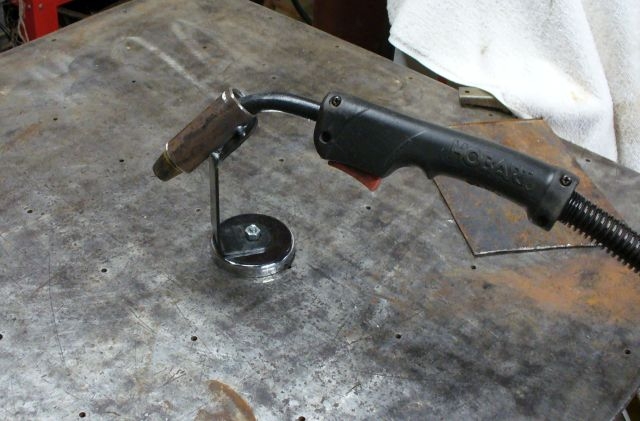

My new favorite tool is this simple MIG gun holder.... Got so tired when laying MIG gun down and reeling off a bunch of wire I finally had to make one.... Since there is no hardware/welding supply store locally that has one, yes I made it... Found magnet for $7.99 at local hardware and then a little flat stock and a bit of 3/4 inch "gas" pipe... Yes welds are just "tack's" for now but soon I might finish welding it if I find I like this creation...

I really like your idea. I'm gonna make one for myself. I keep using different methods, hanging my TIG torch or MIG gun off of whatever is convenient. I hate it when the trigger on the MIG gun gets pressed and there is wire all over the floor. Your idea is great. Thanks for the pictures. BTW, I have been TIG welding for over 30 years, MIG welding for over 20 years. You'd think I'd get a clue.

I have 2 of these HF magnetic Mig torch holders and I think they work good.
I leave one on top of the welder and the other one on the welding table.

I like your holder idea as well. Will get one. We've got snow here which make us rather busy but I'll post photos and comments later. I have three 4.5" grinders all with different wheels in them.

I made one just about like yours a while back.
