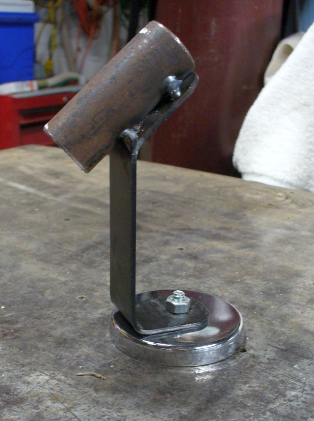

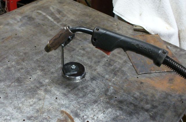

My new favorite tool is this simple MIG gun holder.... Got so tired when laying MIG gun down and reeling off a bunch of wire I finally had to make one.... Since there is no hardware/welding supply store locally that has one, yes I made it... Found magnet for $7.99 at local hardware and then a little flat stock and a bit of 3/4 inch "gas" pipe... Yes welds are just "tack's" for now but soon I might finish welding it if I find I like this creation...
View attachment 846550 View attachment 846551
Another nice thing about the welding table with all the holes, I just use any open hole nearby to hold the MIG gun.

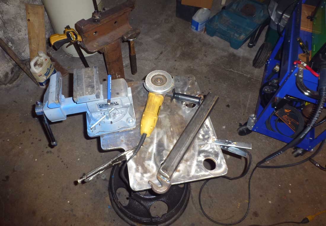

Table was made from "scraps" at work. What's already mentioned for tools plus assorted Magswitch holders. Added HD casters and a couple brakes. Have a pair of DeWalt 20V grinders and an old corded B&D that comes out occasionally, all 4-1/2". They wear cutoff, flap and grinding wheels. Usually have one of the 1/4" impacts with a wire brush. The heavy old vise is something I wouldn't want to do without. Picked up a Diablo Cermet 7-1/4" circular saw blade. Have only made a few cuts so far, but I like it. Added a 200A Everlast inverter stick welder a while back, so now I can go MIG, fluxcore or stick.

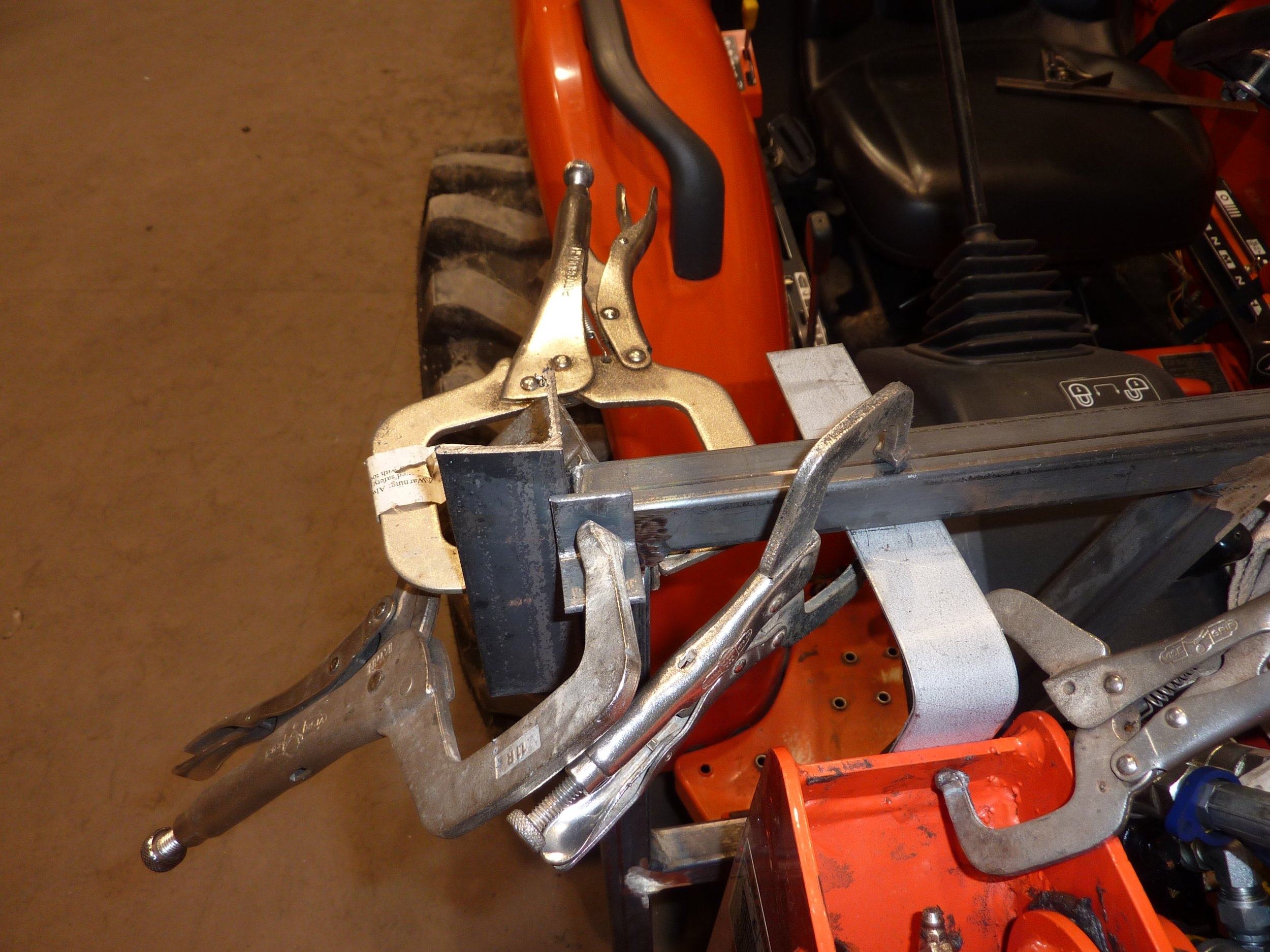

Right angle and pipe clamps?

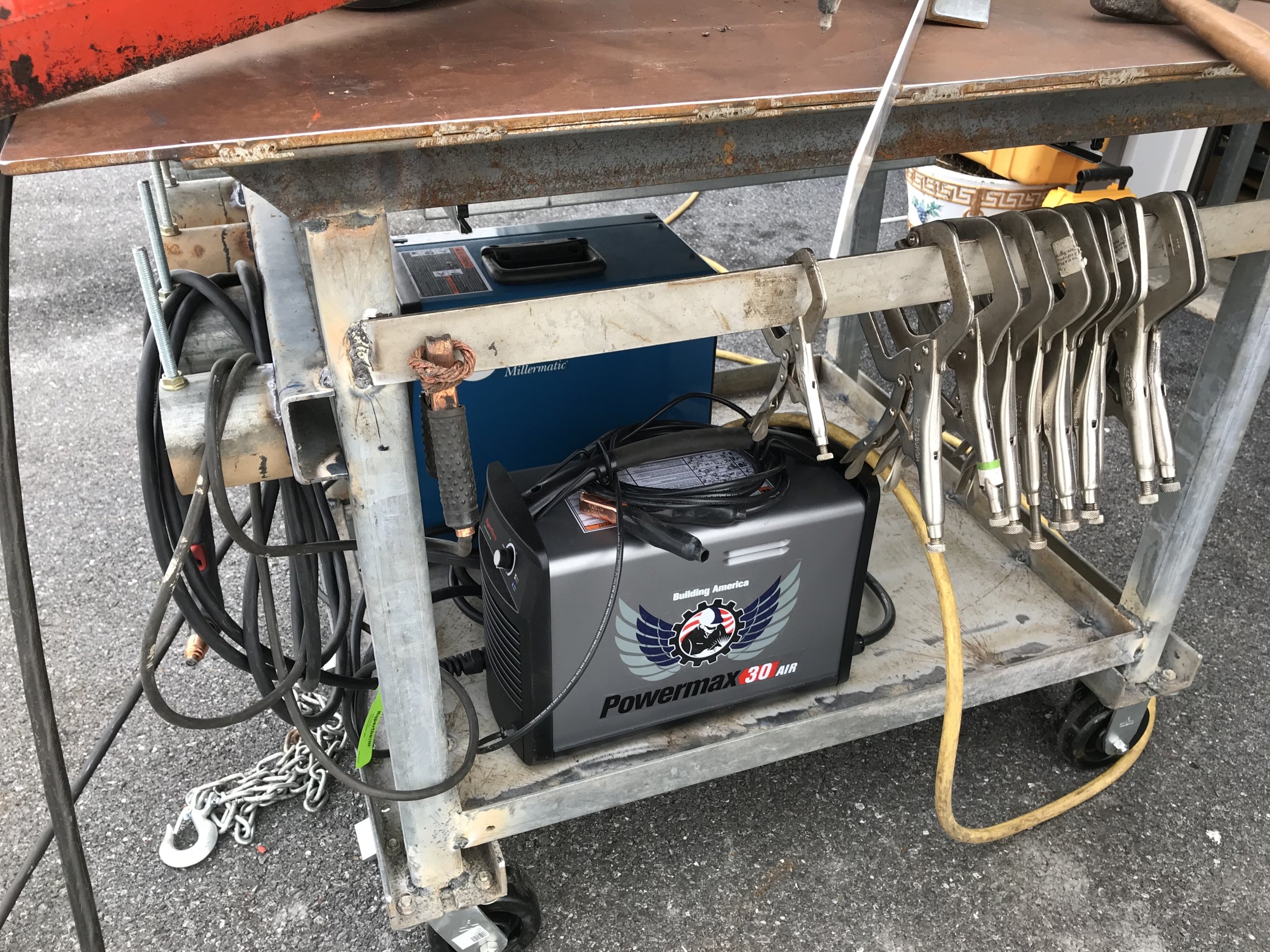

Lots of magnets and clamps. And mini-split so I can work whenever.
Love having a lots of magnet clamps, need more though :cool:
