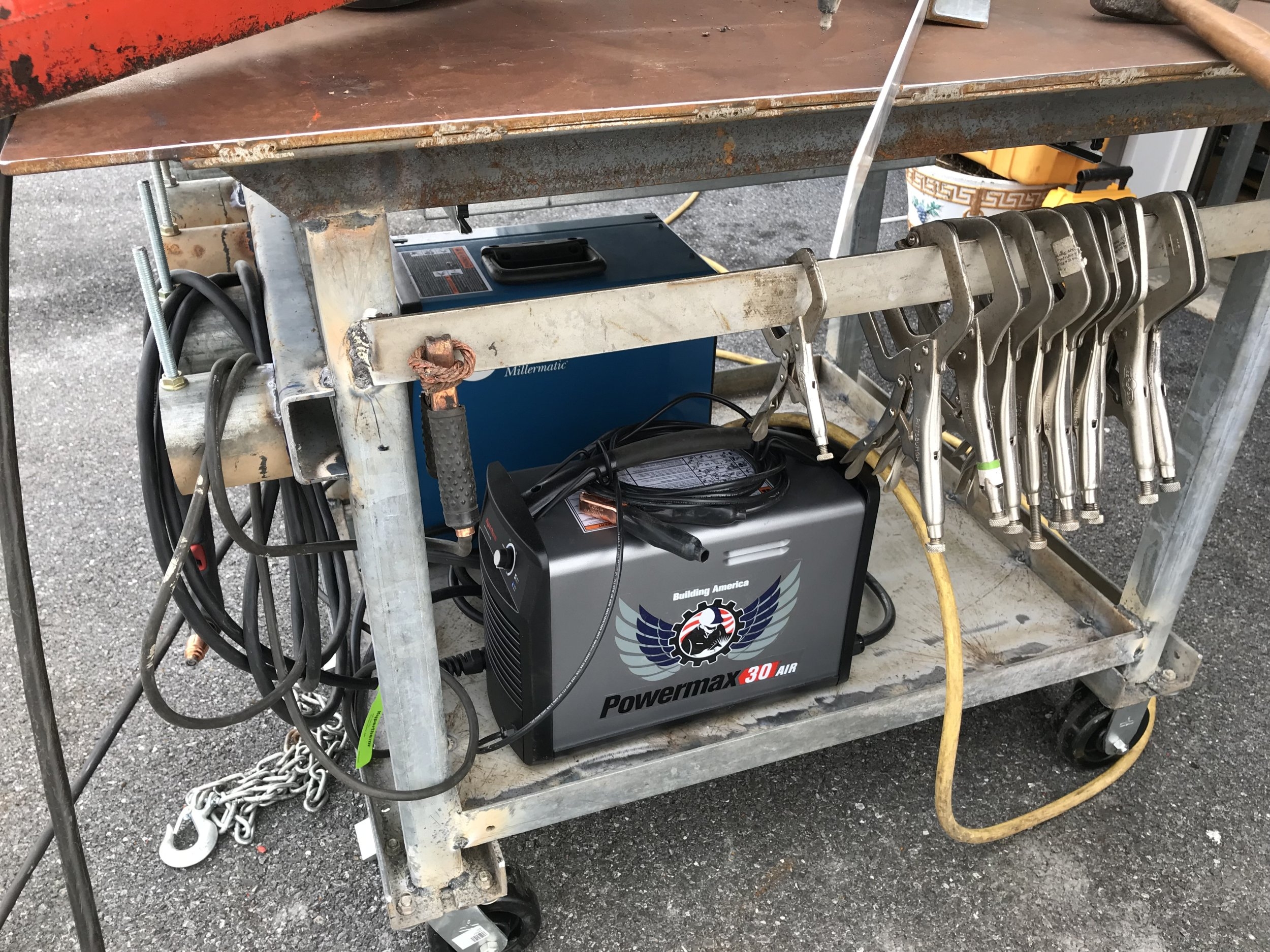

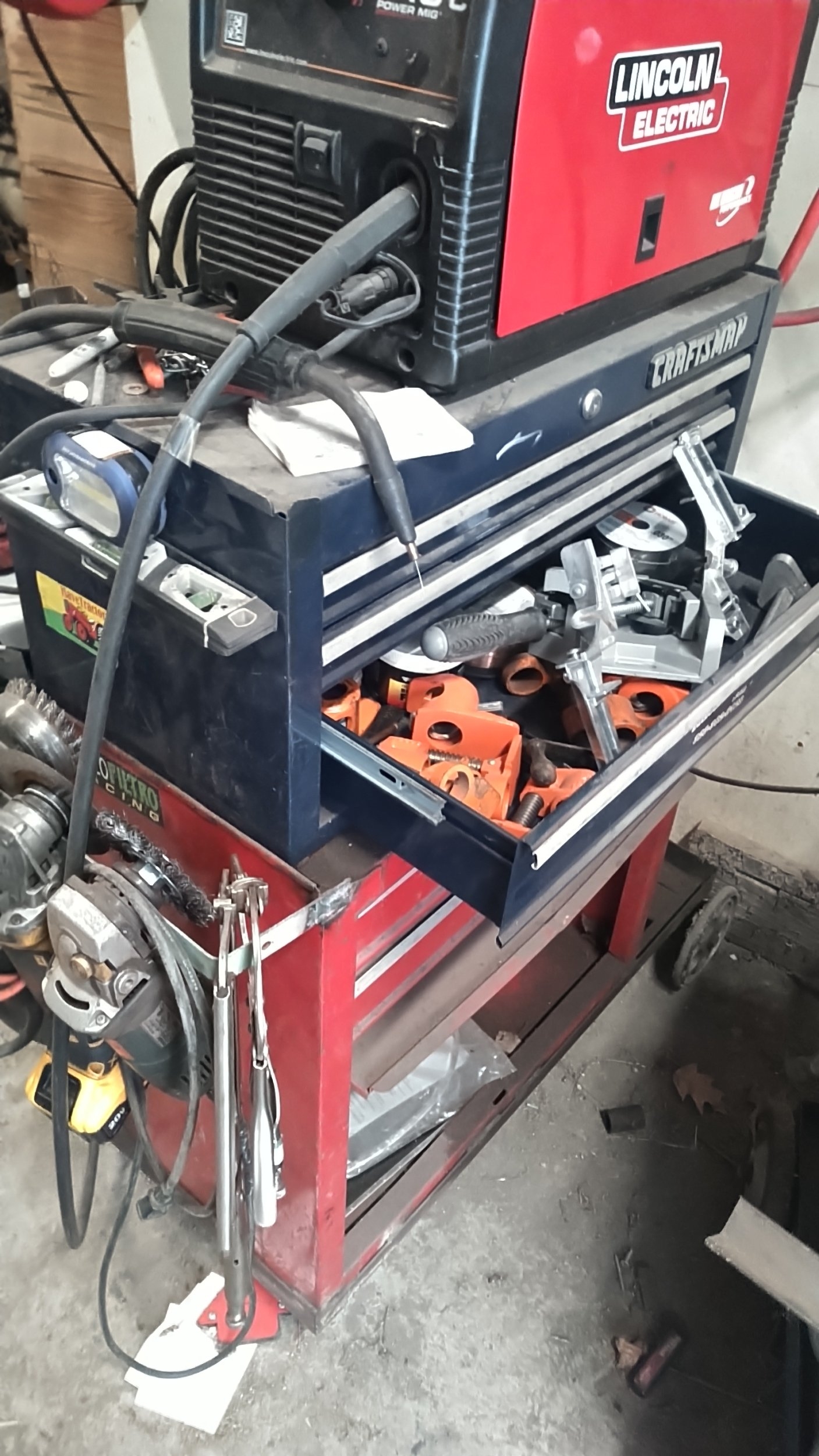

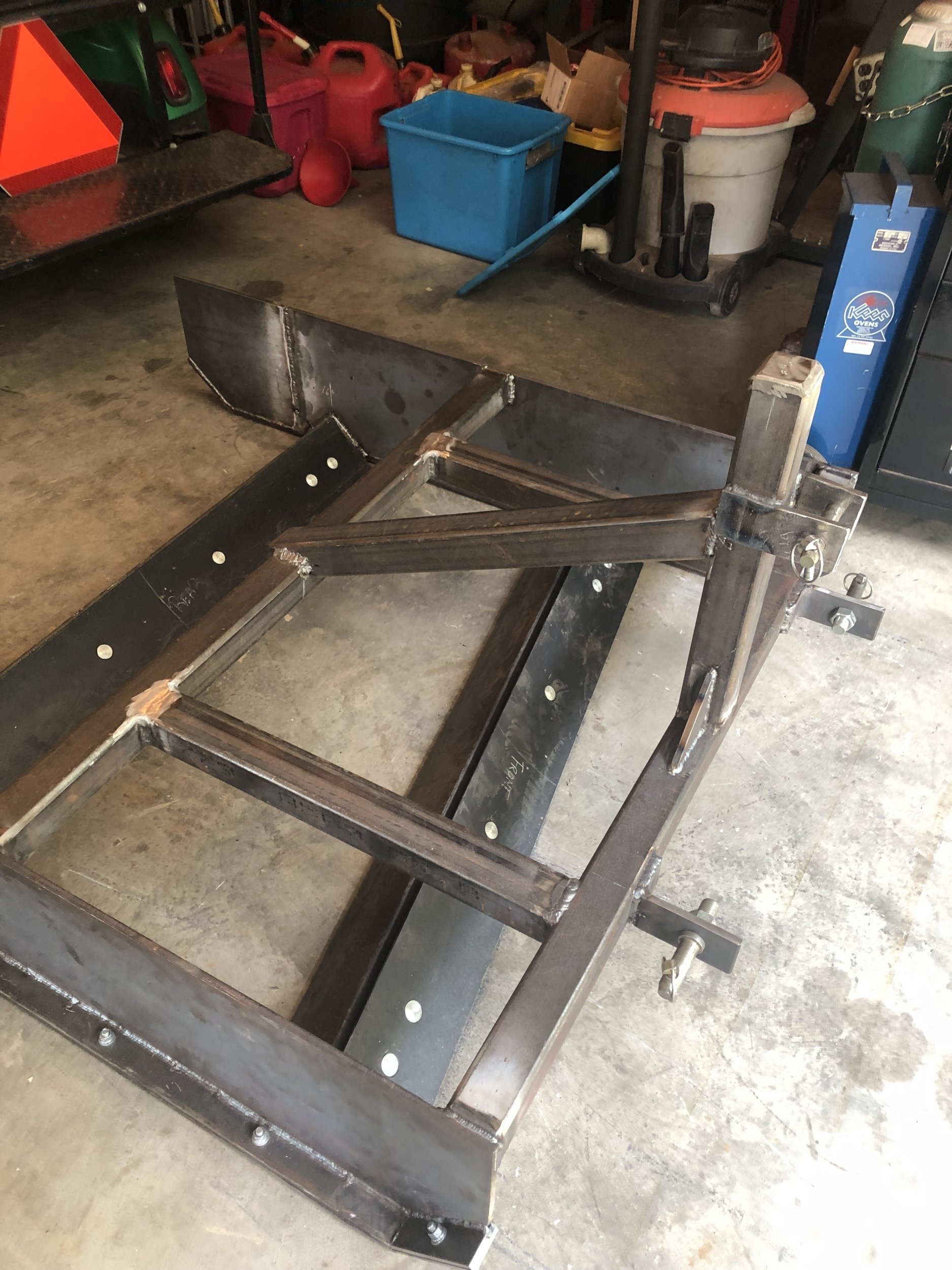

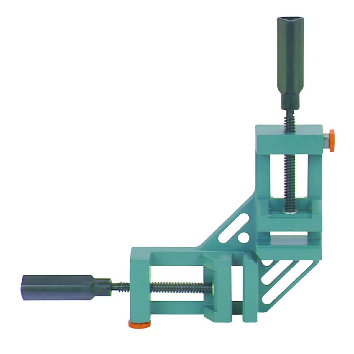

I added four 4” capacity corner clamps to my welding tool inventory. It makes set up much easier. I have twelve C clamps with throats ranging for 6” to 15” and run three Mikita grinders: one with a flap wheel, one with a grinder disc and one with a cutoff wheel. I use a five foot length of catwalk deck as my cut off/plasma table. Most recent project picture.

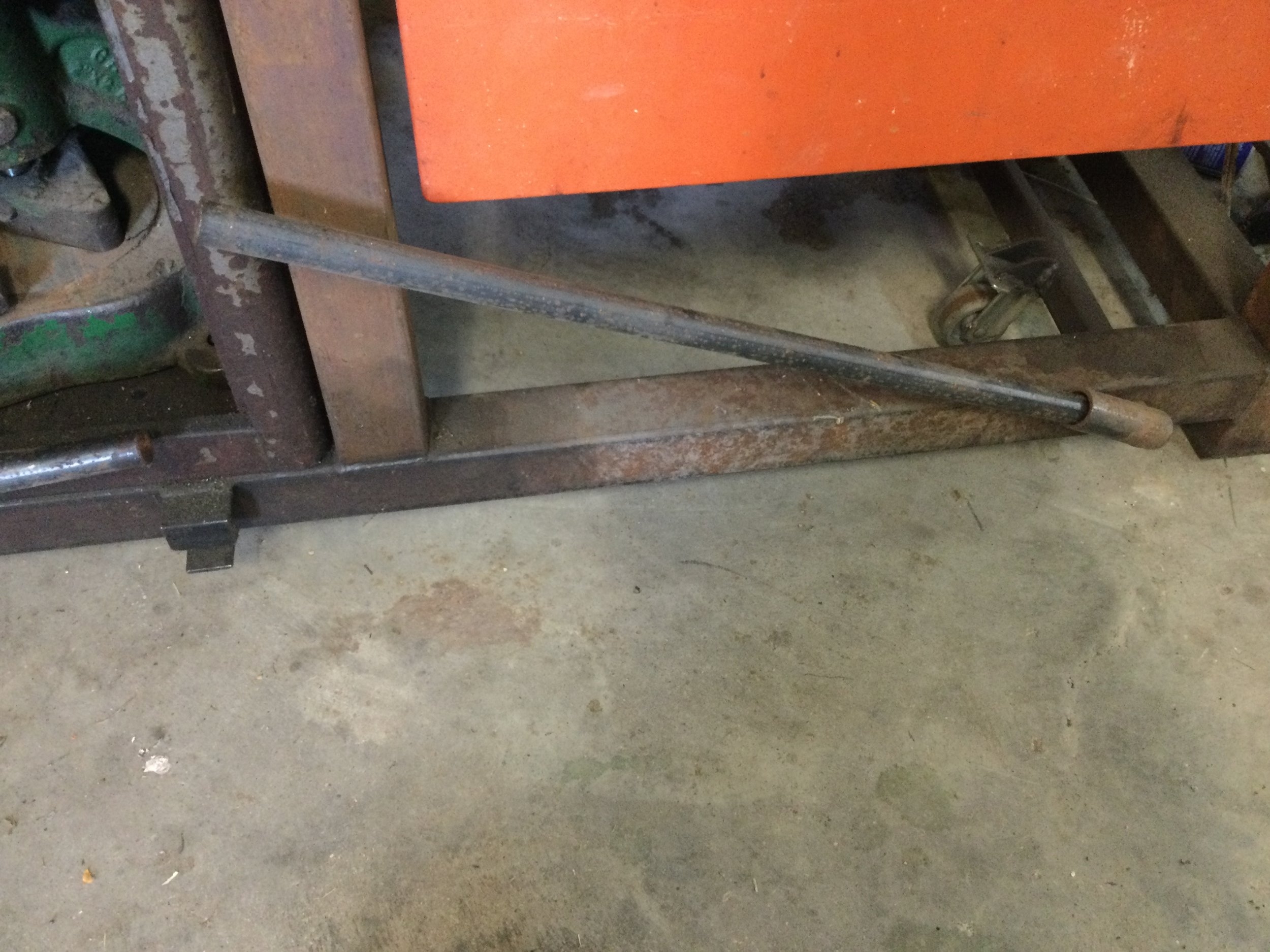

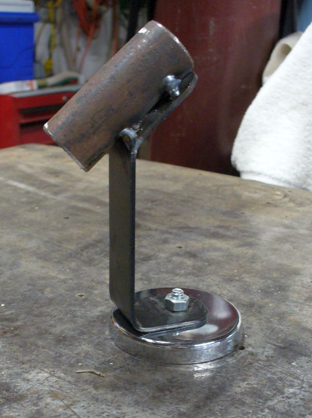

I really like this clamp that smokeydog made. Itis on my todo list.
gg

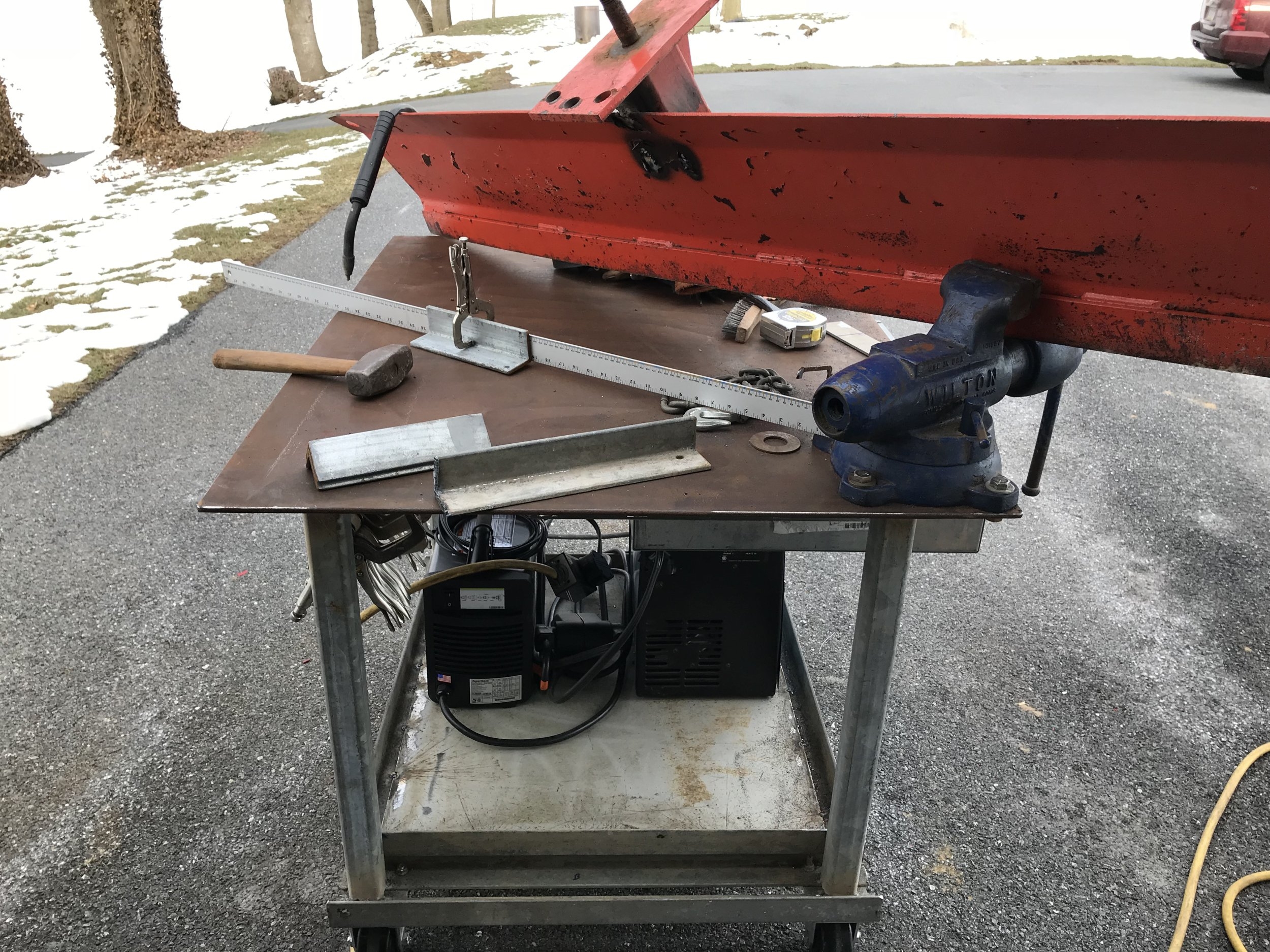

Magswitch welding magnets can be turned on and off like magic. They are pretty strong, and can be turned on after getting them into place. That's a nice feature. Also, when turned off, any metal filings / weld boogies drop off. I keep a piece of paracord on one so it can be dangled as a small magnetic broom when drilling where chips can be a problem. It is also useful to stick one on the steel next to the drill bit to catch most of them before they escape:)
"Gumby" as the tinknockers called it (aka Butyl Duct Gasket Tape) is a very handy material to keep around. One use is cleaning the metal filings from nutsetters. I keep a piece with my bits. A small piece jammed into the nutsetter grabs the filings so the nutsetter holds the screws again. That roll in the background is about 6X lifetime supply.

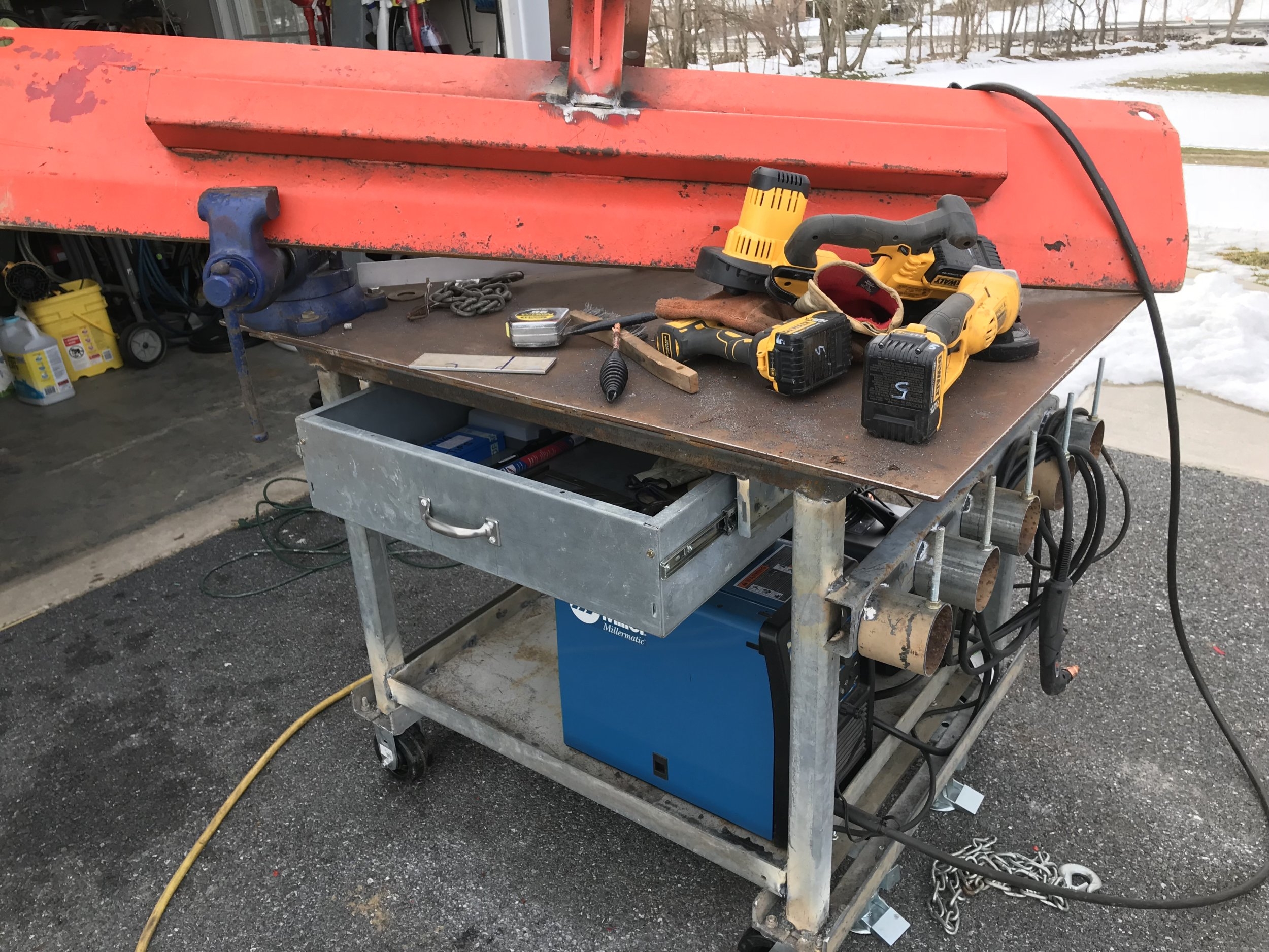

I don't have a picture at the moment but I zip tied cheap metal rings about 1" to the cords of my grinders. I welded a few hooks around the sides of my table and I can just hang the grinders on the hooks.

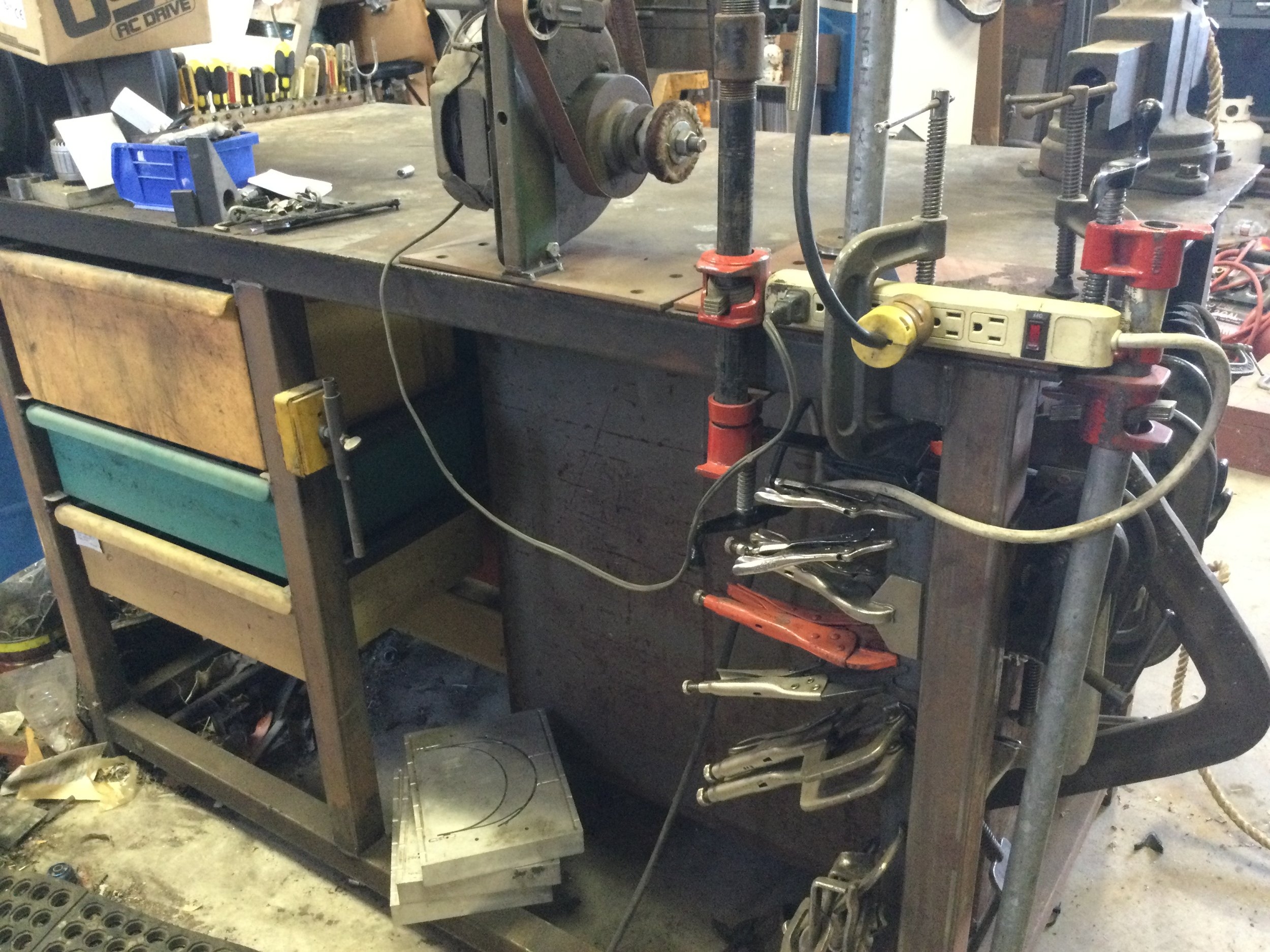

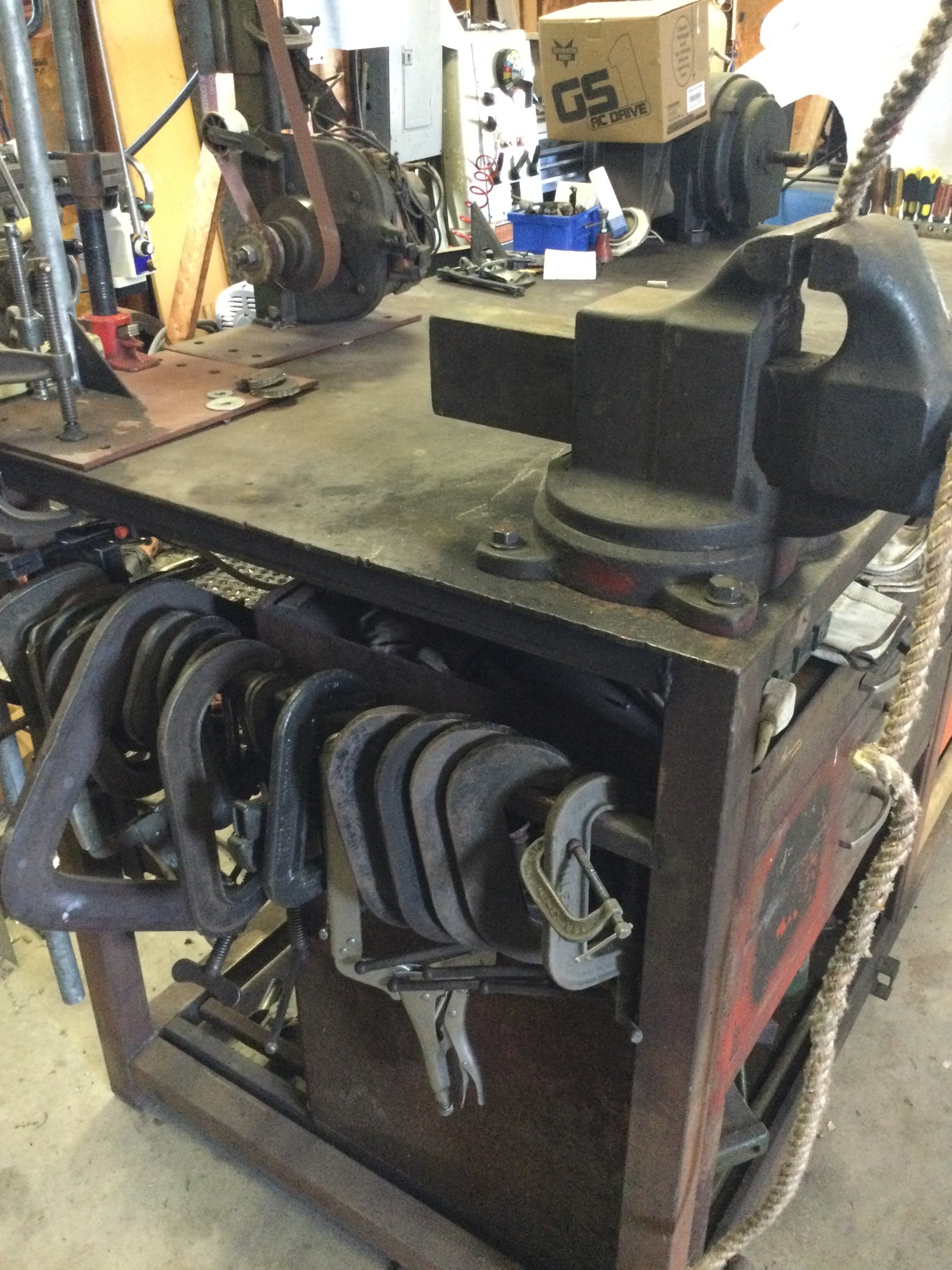

I got really tired of digging for clamps so I made this roll-around clamp rack. The base is just a Harbor Freight steel cart. The actual clamp rack is frame made of 1.25 in tubing with 3/8 rebar arms. Also found a use for some wire racks that originally were made to hang in peg board. These are GREAT for storing vise-grip type tools. Opposite side has rebar arms to hold grinder wheels and the grinders hang on piece of bed rail welded to the side of the frame.
I also like the Harbor Freight corner clamps for building tube frames. Not heavy duty but they are cheap enough you can buy a bunch of them without breaking the bank and they get the job done.
Finally, I like using the cheap Harbor Freight drill press vise for holding work pieces vertical while welding on them.
Maybe this post would be better in the "HF Tools That Don't Suck" thread....
