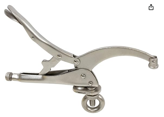

My welding table already had several holes drilled in it, so I picked up some drill press clamps from Harbor Freight to use as poor-man's Stronghand clamps.

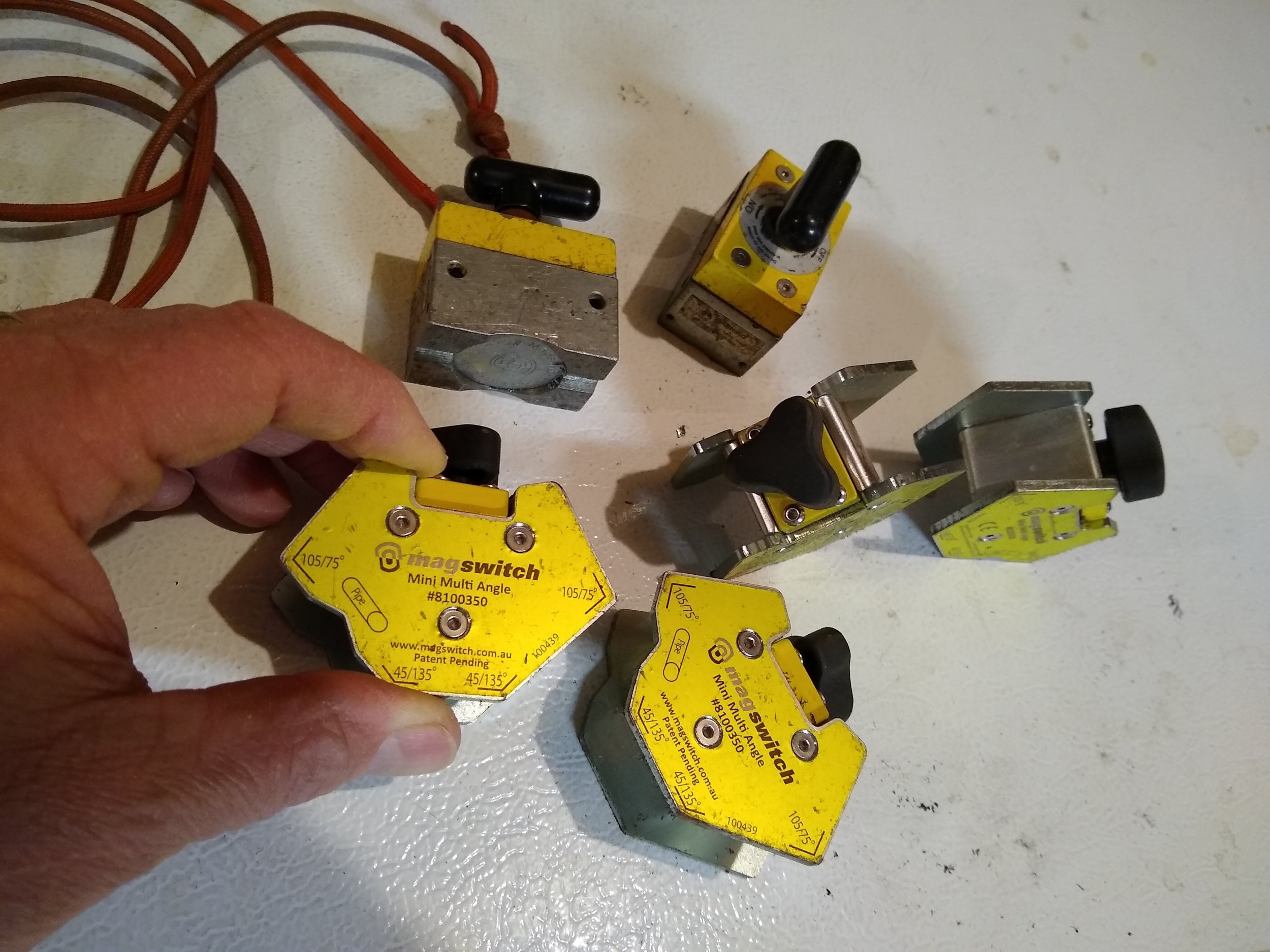

No biggie, but handy:
Magswitch welding magnets can be turned on and off like magic. They are pretty strong, and can be turned on after getting them into place. That's a nice feature. Also, when turned off, any metal filings / weld boogies drop off. I keep a piece of paracord on one so it can be dangled as a small magnetic broom when drilling where chips can be a problem. It is also useful to stick one on the steel next to the drill bit to catch most of them before they escape:)

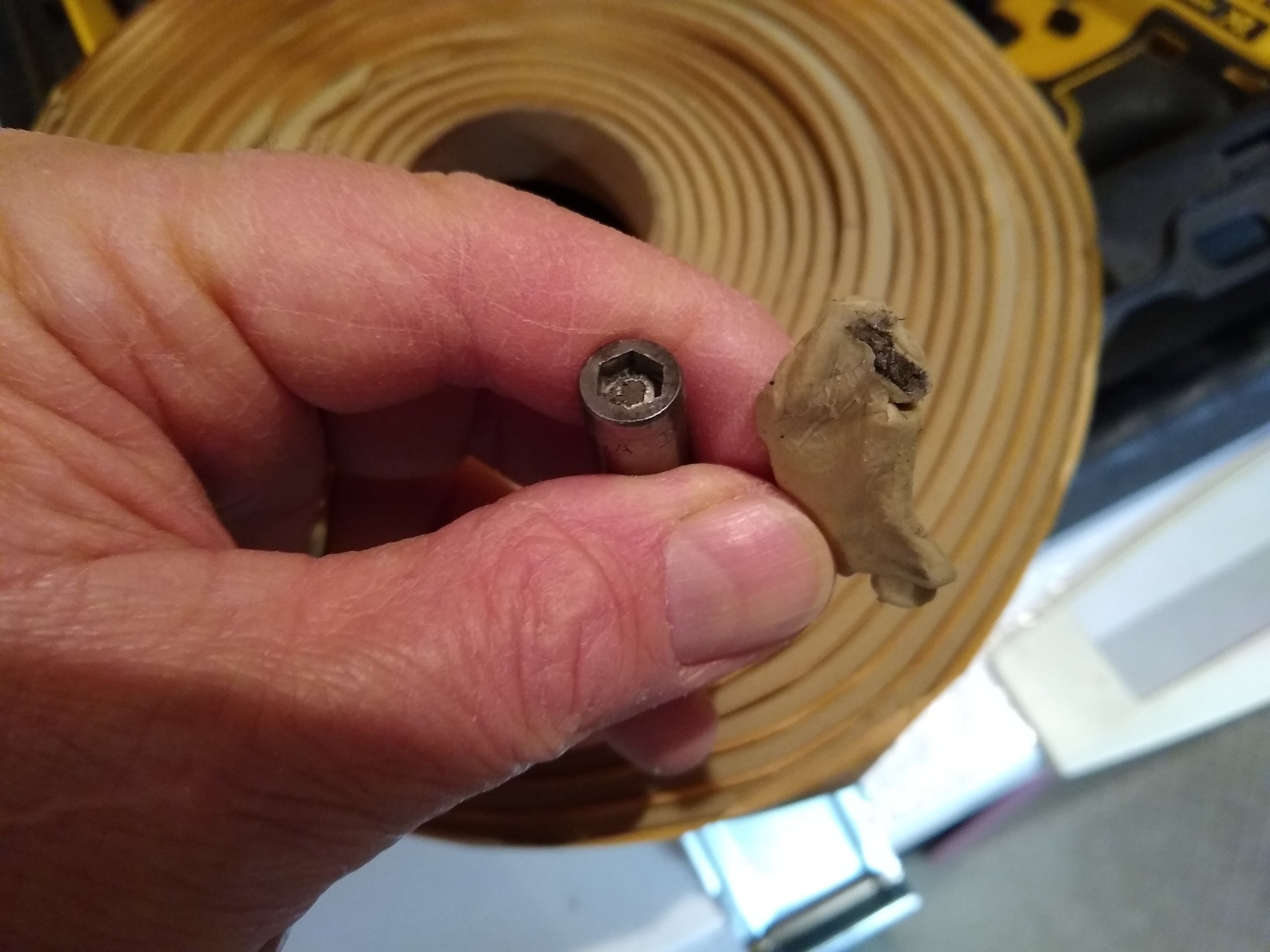

"Gumby" as the tinknockers called it (aka Butyl Duct Gasket Tape) is a very handy material to keep around. One use is cleaning the metal filings from nutsetters. I keep a piece with my bits. A small piece jammed into the nutsetter grabs the filings so the nutsetter holds the screws again. That roll in the background is about 6X lifetime supply.
