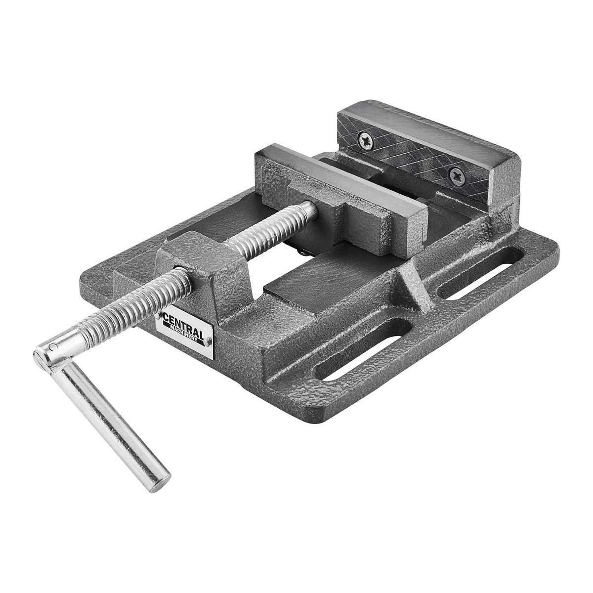

I got really tired of digging for clamps so I made this roll-around clamp rack. The base is just a Harbor Freight steel cart. The actual clamp rack is frame made of 1.25 in tubing with 3/8 rebar arms. Also found a use for some wire racks that originally were made to hang in peg board. These are GREAT for storing vise-grip type tools. Opposite side has rebar arms to hold grinder wheels and the grinders hang on piece of bed rail welded to the side of the frame.
I also like the Harbor Freight corner clamps for building tube frames. Not heavy duty but they are cheap enough you can buy a bunch of them without breaking the bank and they get the job done.
Finally, I like using the cheap Harbor Freight drill press vise for holding work pieces vertical while welding on them.
