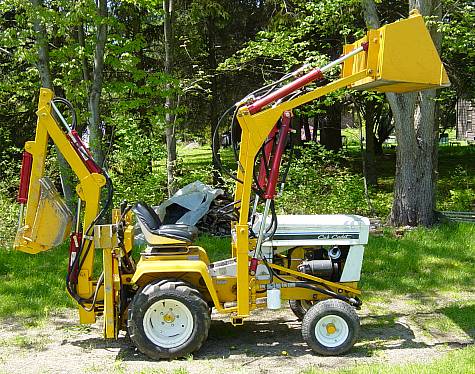

Brett, i used my lincoln sp-100-t exclusively on my loader and backhoe projects and i've yet to break a weld. check out the "heavy" equipment i built at my site... P.F. Engineering
