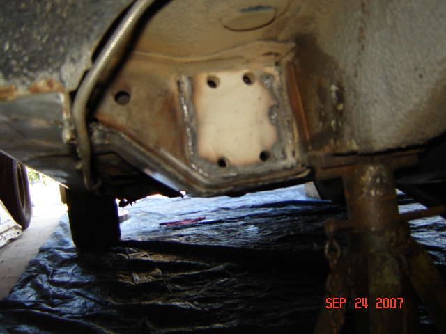

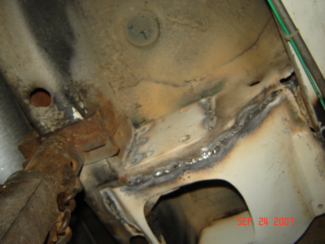

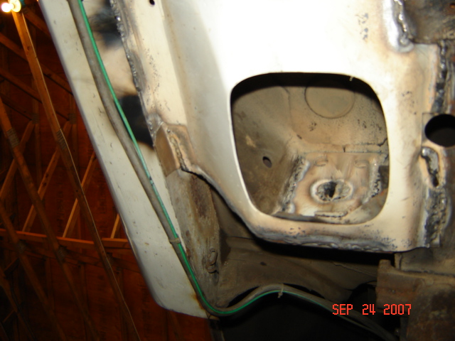

Here's a few shots of the "torque boxes" I installed last week on my brother's 69 Coronet 500 wagon. They reinforce the front leaf spring mount area, tying the mount into the frame rail & rocker pinch weld. Weld was made with a Lincoln Pac-10 110v wire feed with flux core wire.

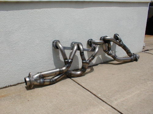

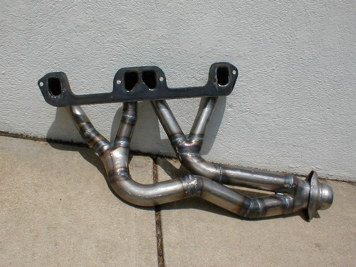

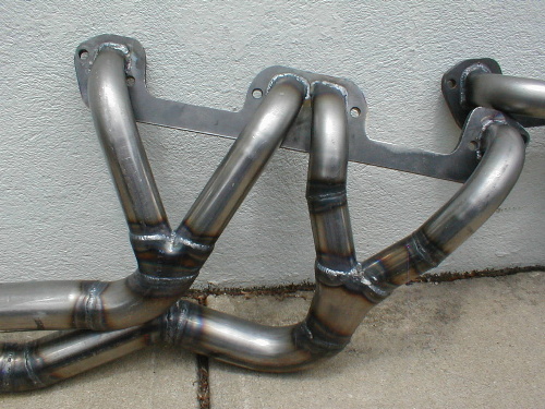

The ultimate "kinky weld p0rn": Home made headers. Again, tig welded.
