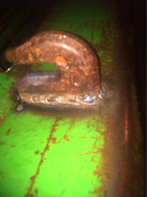

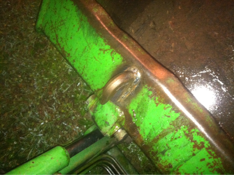

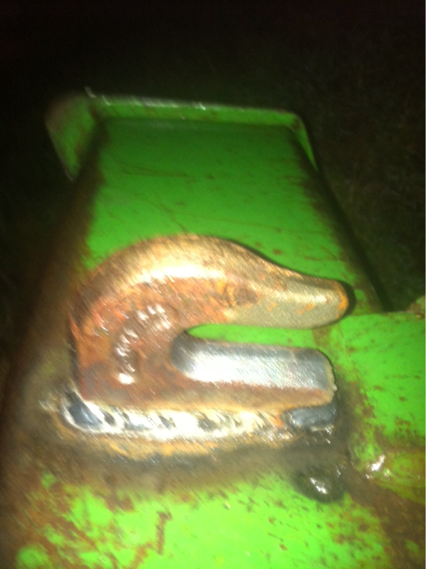

In finally got around to welding on my bucket hooks. It's been a while since I've mig welded, so excuse the welds. Also the hooks have been in my basement, that's the reason for the rust. LUTT

lutt,
Looks like a pretty good job to me ! ! :2cents: I used the same type hooks on my BX2350 loader, and there has never been a failure to date. I'm sure you will get LOTS of use from them.

I think those welds look pretty good and suspect they'll stay put for a good long time. :thumbsup:
Grab a wire brush then a bit of sanding and paint if you want them to look factory installed!! :thumbsup:

that is on the radar I've for some other work to do to the bucket, but I am gonna paint them. Thanks LUTT

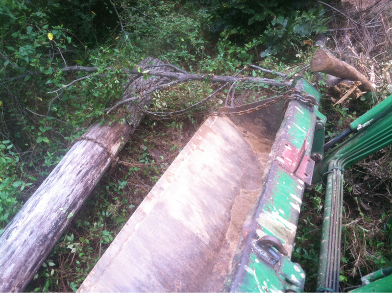

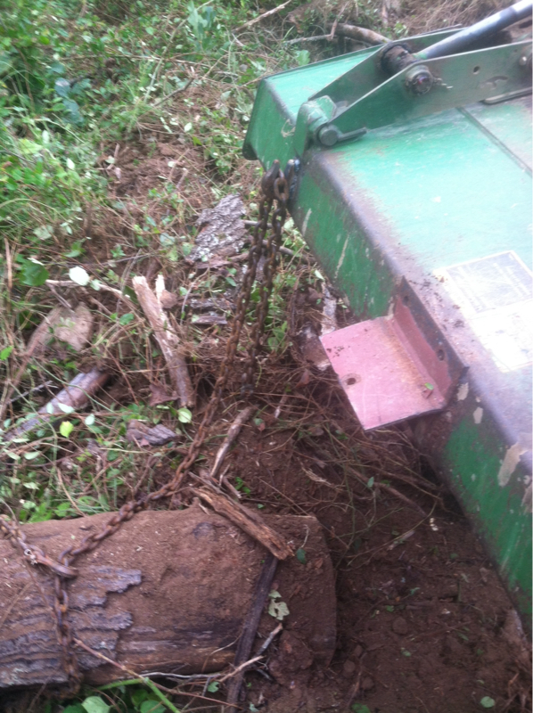

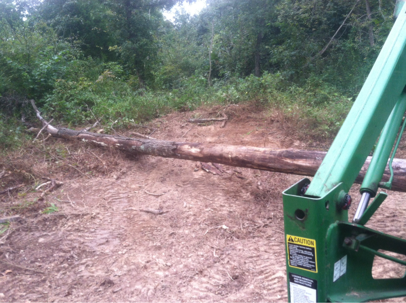

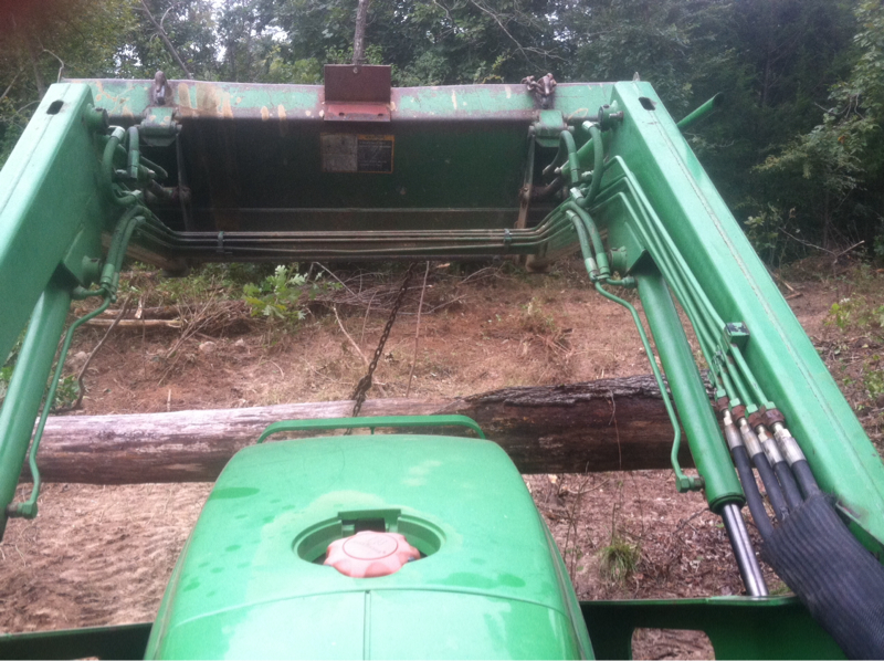

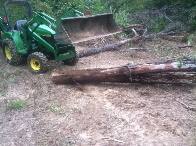

Got to use them this evening, worked well! Had to drag some logs in the clear to buck. LUTT

Lutt, be careful with using only one hook. Applying weight to only one side of the bucket especially on uneven ground could tip the tractor on its side...Just a heads-up is all....

Thanks night force, I was, mostly just testing strength, but ur right. Sometimes we need a reminder. Specially since posting pics can affect first timers. Thanks LUTT

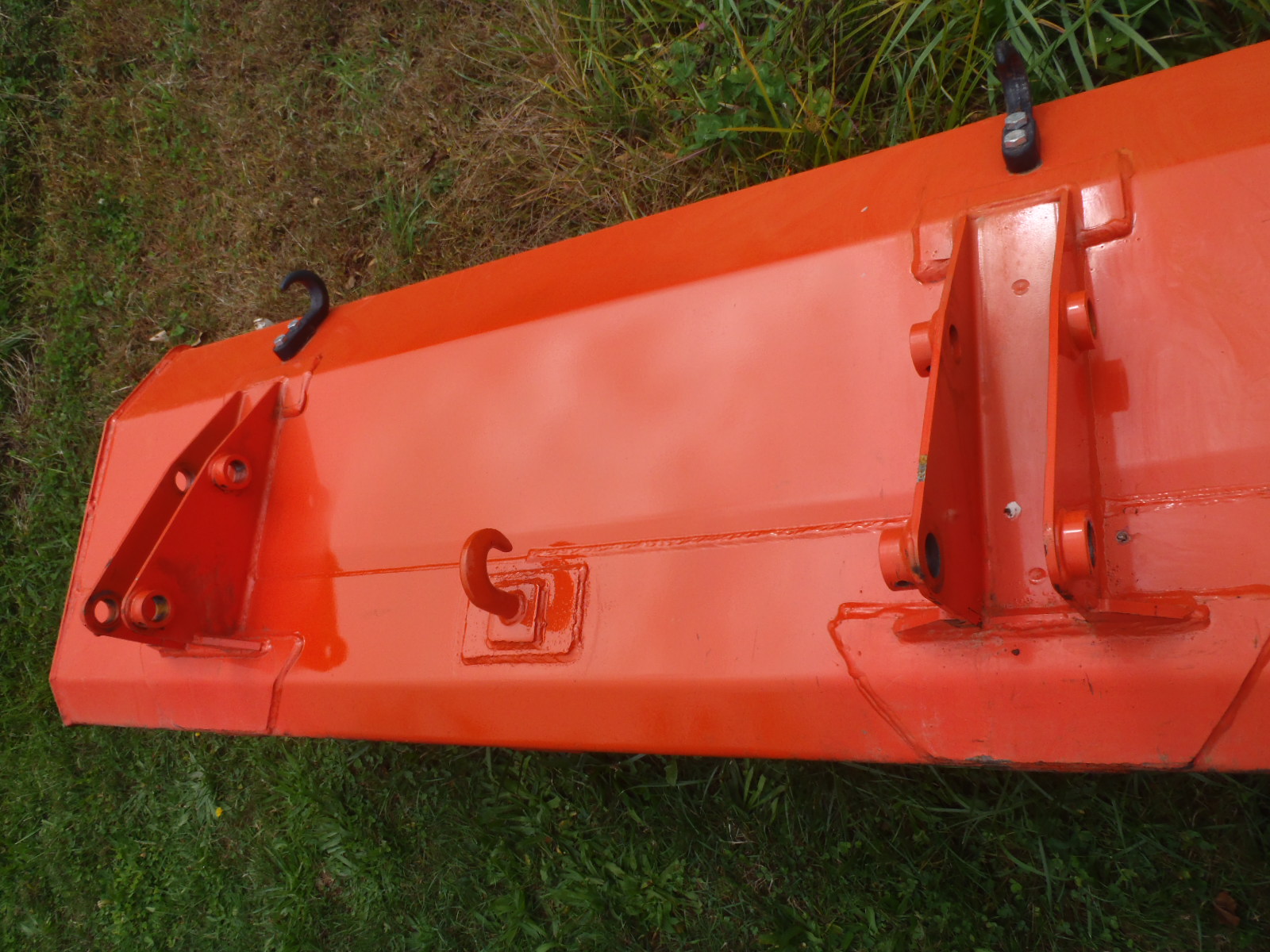

For one hook pulling, one mounted low, on the back of the bucket is handy ...

Hooks are good and was thinking a 2x2 recvr in the middle.
Thinking bolt on with support plate underneath.

Low and to the back would be nice. I'm thinking about putting a receiver in on mine also. May do that this weekend. LUTT
This is a very close design my dad has on his backhoe loader. His 2 outside hooks are regular chain hooks Then the one in the center is a slip hook. It's not as far back as the one pictured, maybe only 4"s or so. All have worked well

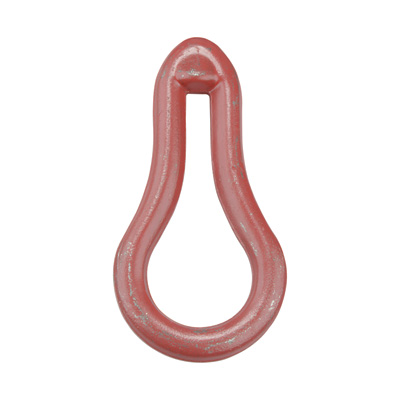

I used slip hooks in all 3 locations because I prefer to use rope or straps instead of chain, whenever it makes sense.
5/8" polyester double braid is very strong, not too stretchy, somewhat abrasion resistant and a fraction of the weight of an equal length of chain.
If the job dictates that I really need chain, then I use these on the slip hooks:
