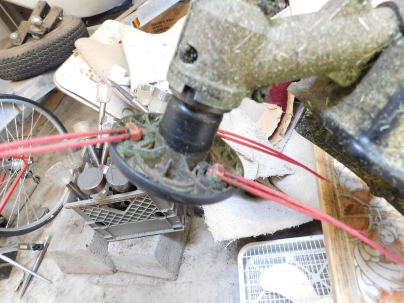

Technique can help minimize grass wrapping on the blade.
In high grass, someone mentioned cutting from the top down, which helps cut long grass into pieces as you work towards the ground rather than trying to start cutting at the base of the long grass.
One additional adjustment when clearing areas of grass is rather than holding the head parallel with the ground as you swing it side to side, try to cant the head about 30 degrees as you swing it. It's pretty easy with the bicycle handlebars on larger weedeaters to hold your left handle up and right handle down as you swing side to side.
Changing the angle of attack as you cut results in long grass being cut into smaller pieces before it gets a chance to wrap-up around the head. It's not 100% fool proof, but it goes a long way towards minimizing grass wrap!
