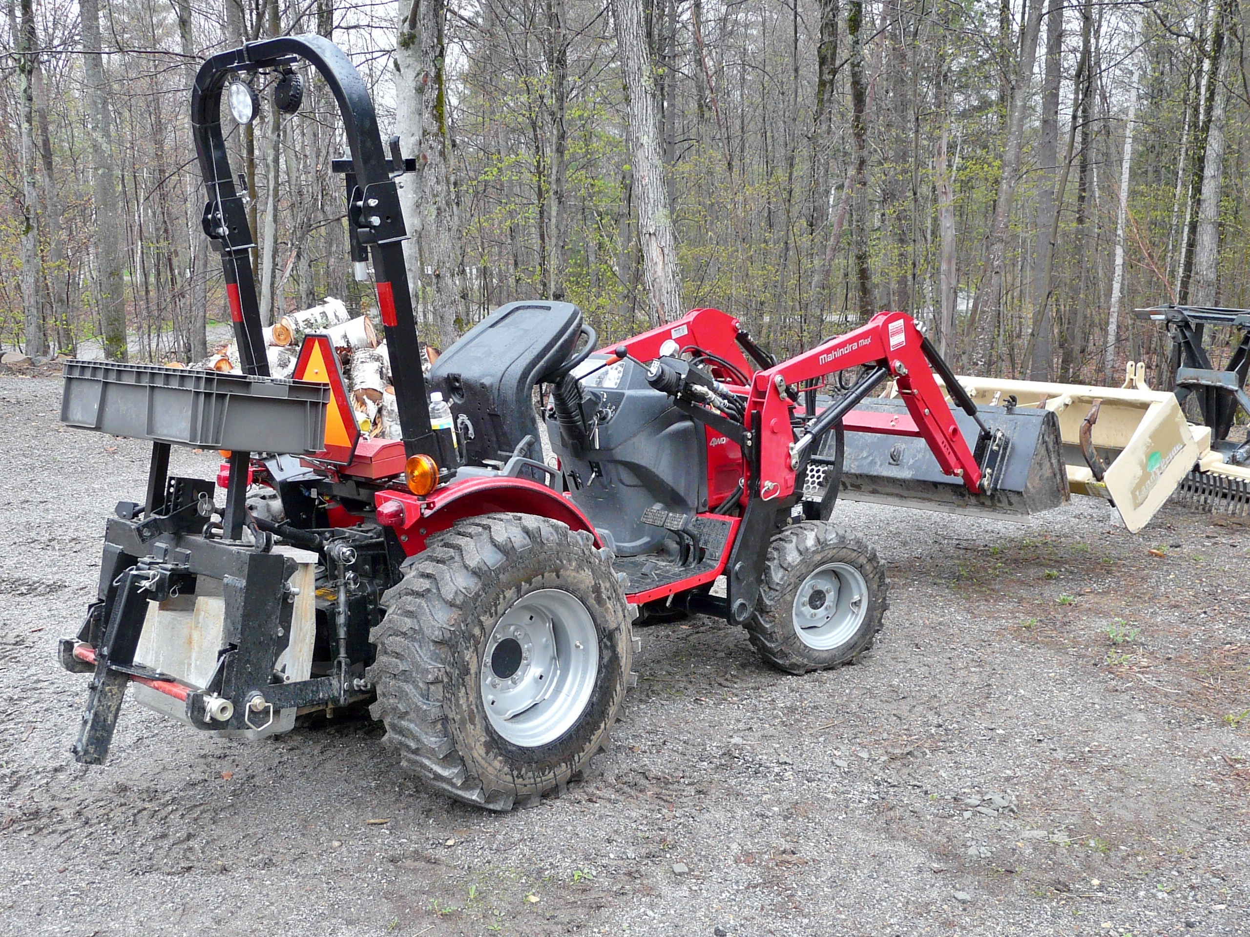

Getting some 3' x' 3 X 8' compressed hay bales to feed out the the cows.
I checked to see if The Max28 could lift one of these 700-800 lbs big square before my wife bought them.
I was using my clamp on pallet forks.
If the bales were another 100 lbs or so, I doubt the Max could lift them so We better keep them dry.
I'm also glad I have 750 Lbs Counter weight on the 3 Pt Hitch.

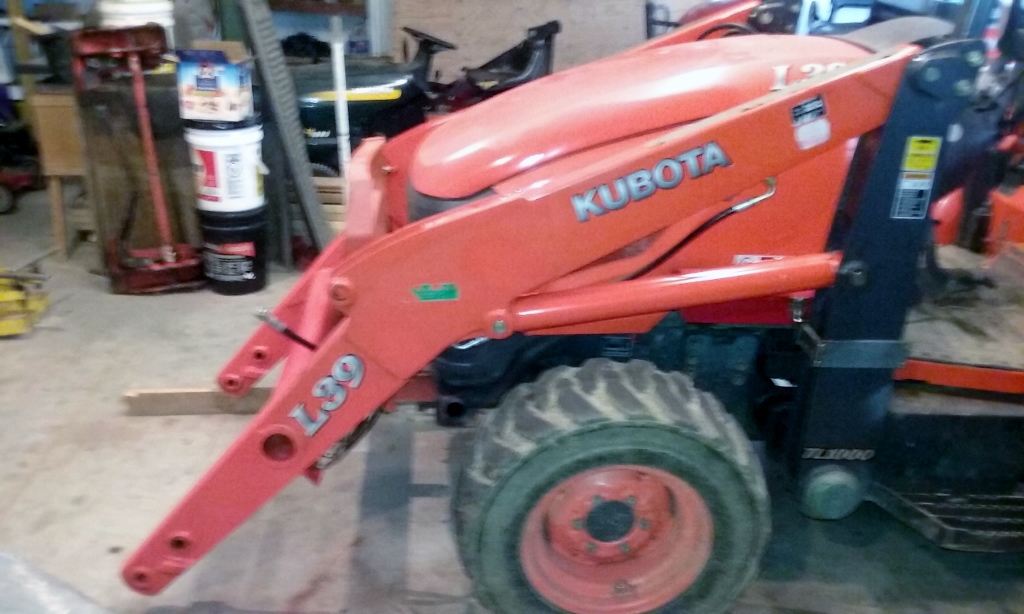

I got some of the cylinders back for the L39.
Until I get the L39 put back together, The Max will have to do.

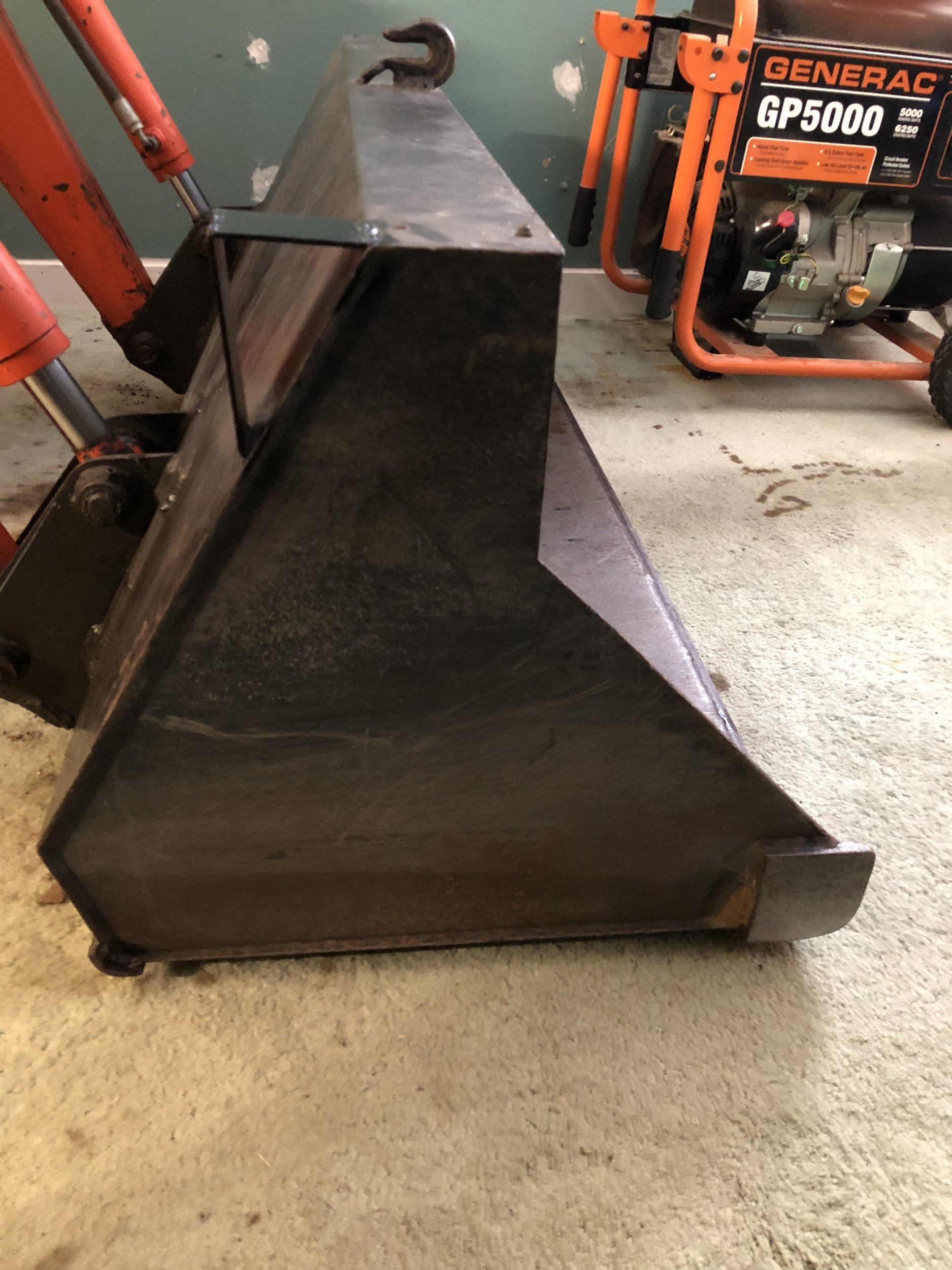

Picture an 8' Box of Kleenex Tissue and your have an idea what these big rectangular bales look like.

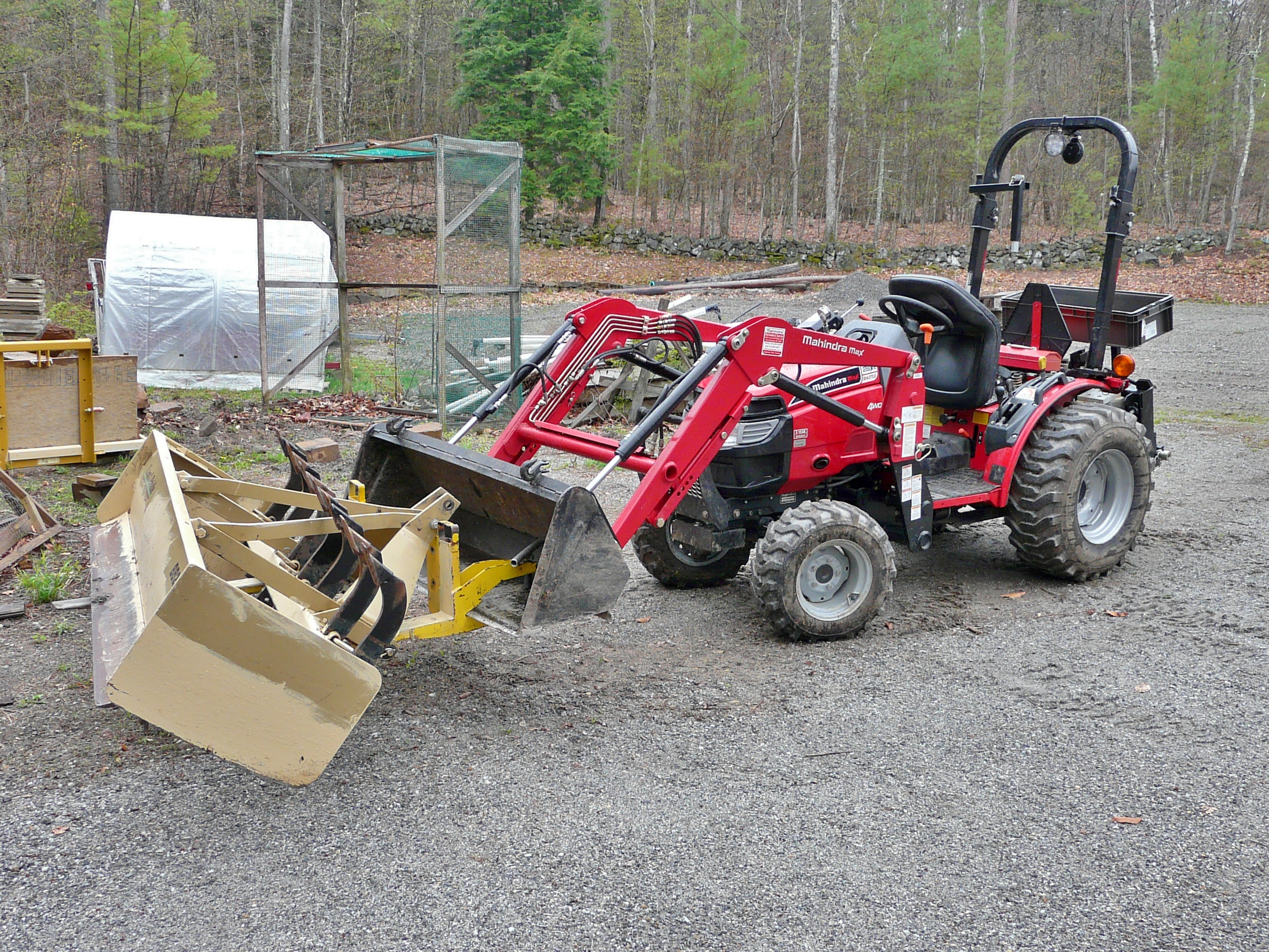

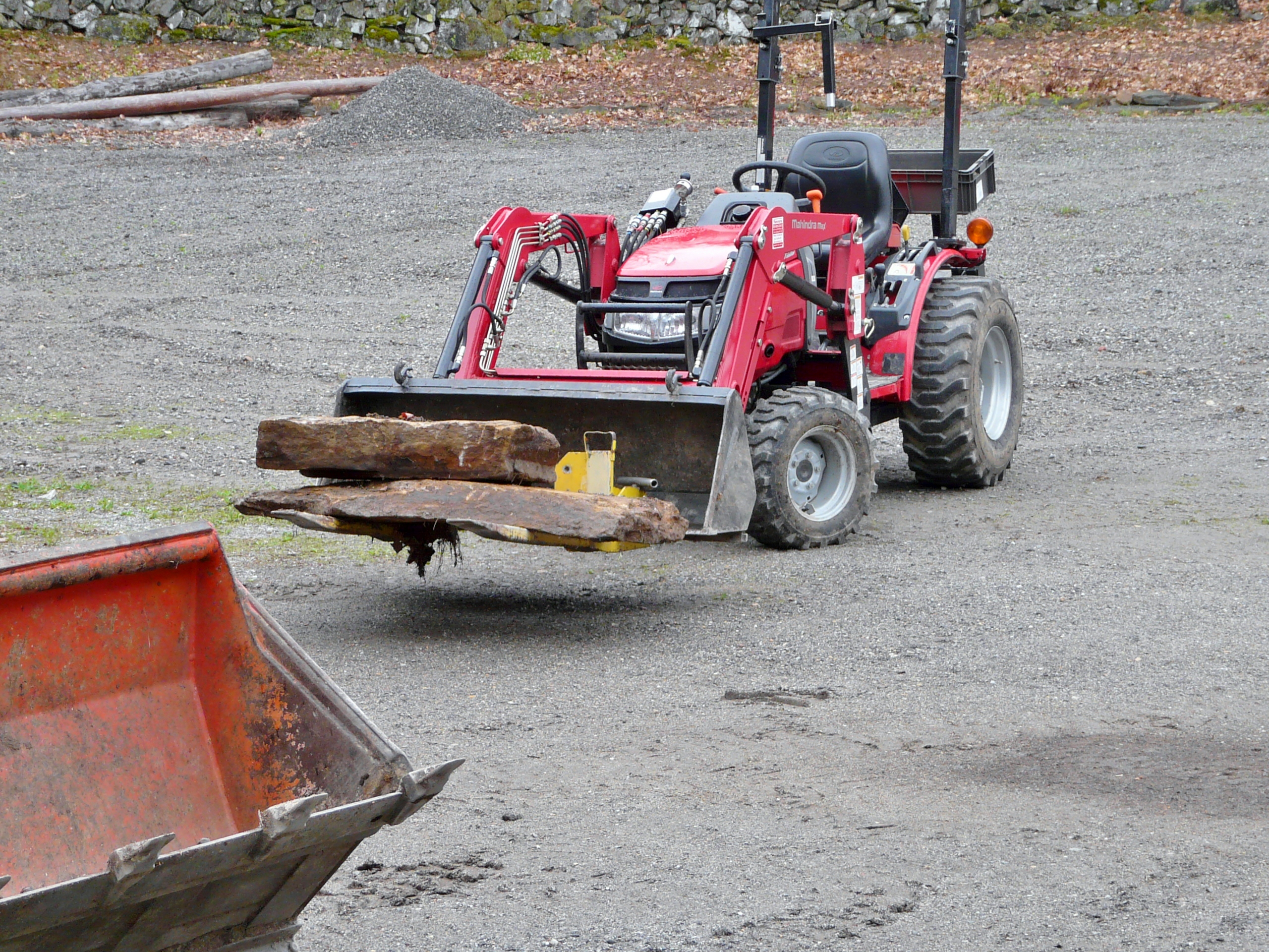

Better yet, I'll have to post a picture with the Max 28 with the bucket forks.
Sunday I welded (crappy welds I that make) a pair of plates to the bottom of the max bucket so the bucket forks that were made for the L39 do no keep slipping off.
The L39 Needs to get finished by September, I need it back.

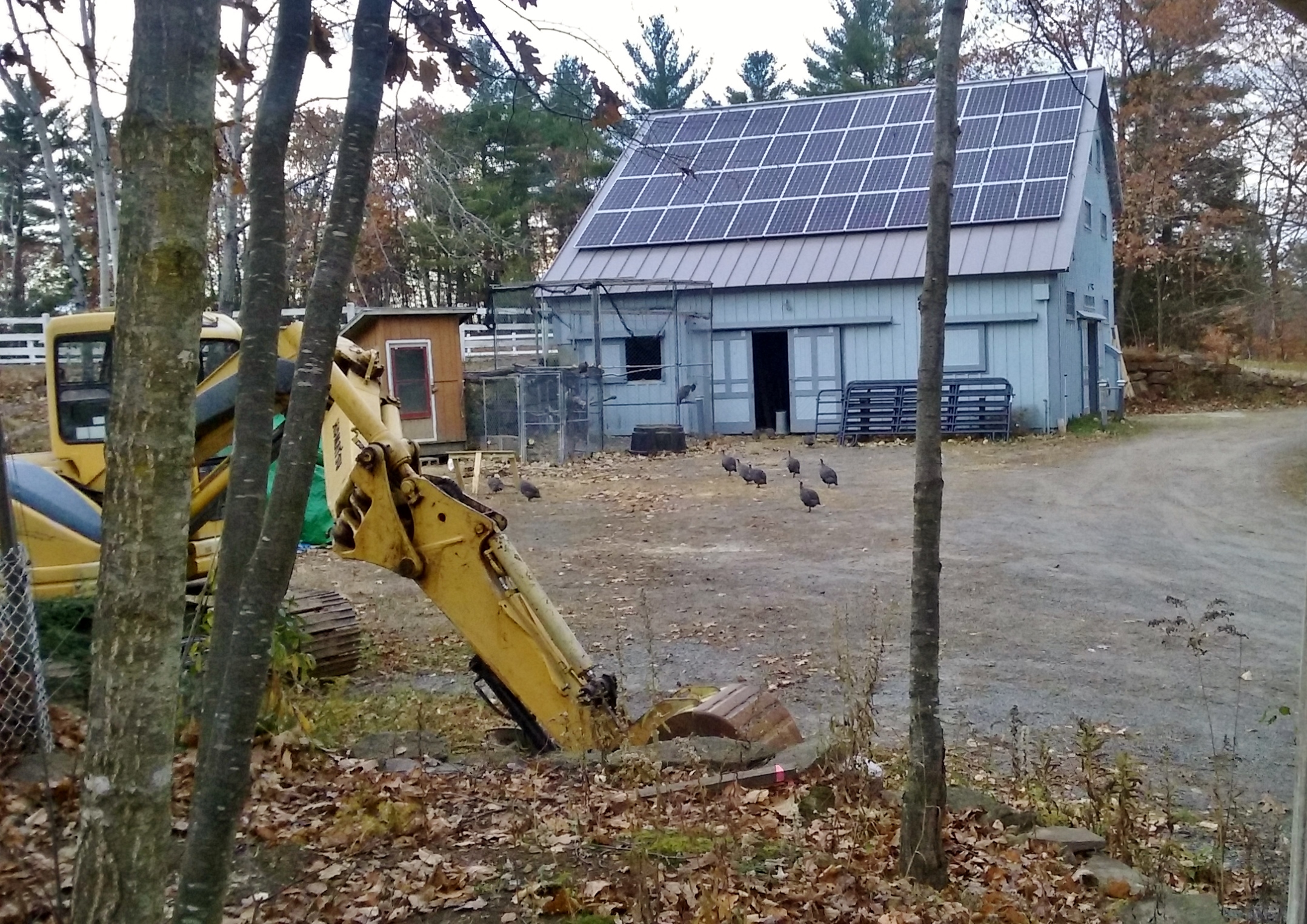

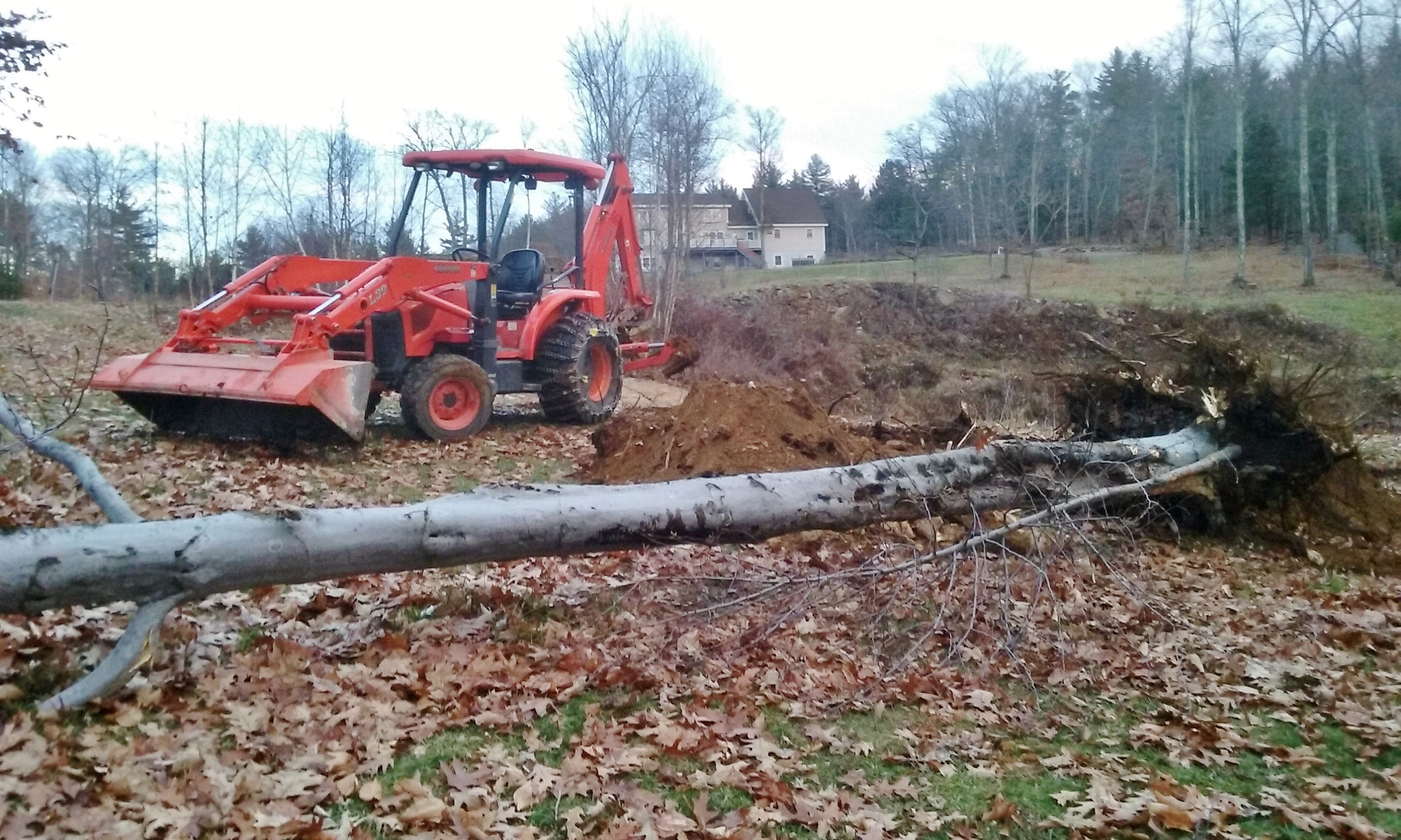

So I did not have to walk my excavator and take down electric fence, my neighbor who is renting a SV90 CTL moved a big old stump out of my road path that I pulled a few years ago.
CTL's really scoot, in close quarters way faster than a tractor. (Or Excavator)
I suspect the Max may have been able to push it, but why take the chance of breaking it?
Unless they are rotten the Max is pretty useless trying to take even small stumps out with the bucket, so I do not try.

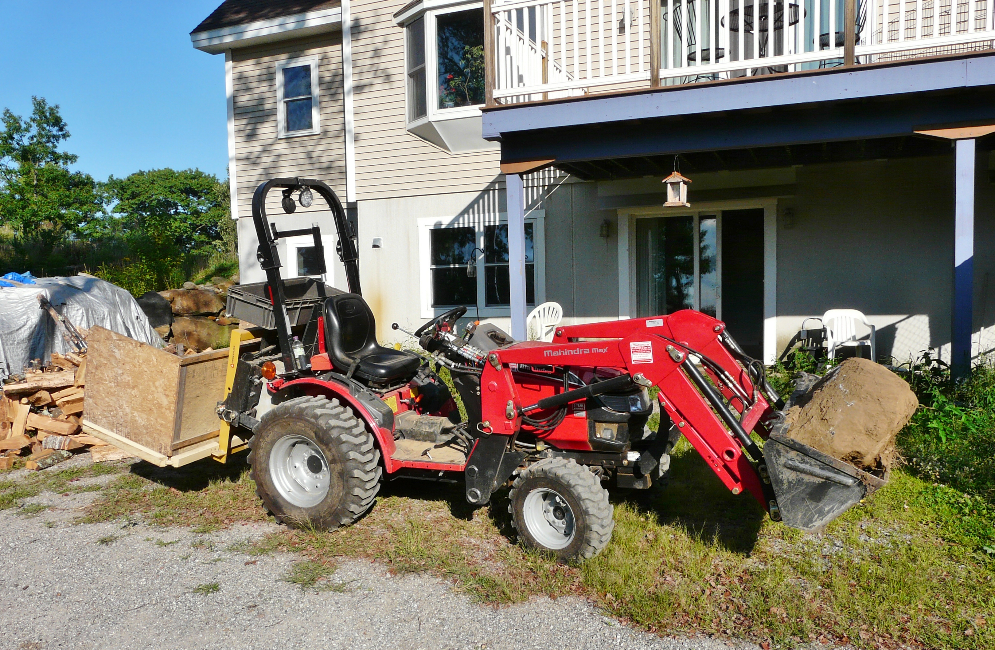

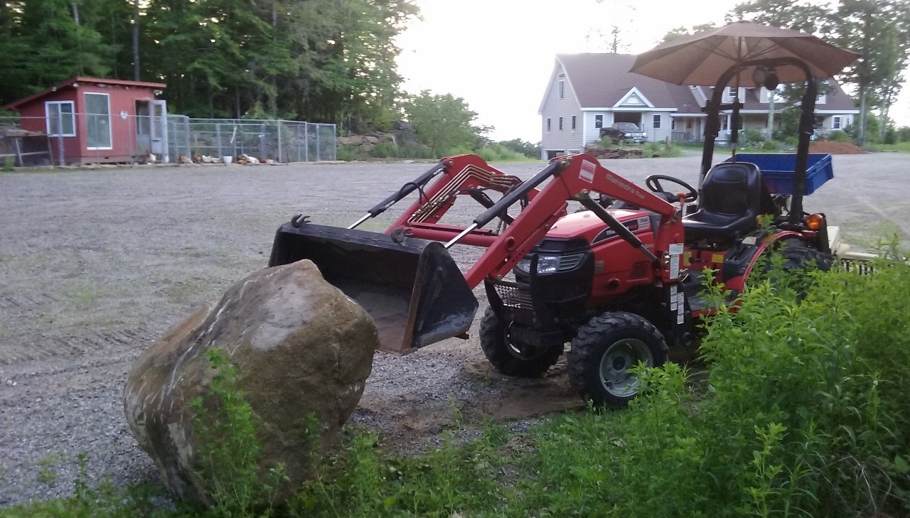

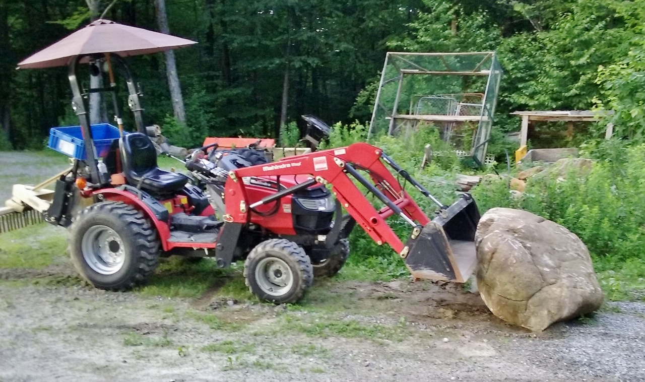

Working hard at 162 hours.
Moving dirt, rocks and firewood, Hay, and all sorts of stuff with the carry all.
I have built over 150' of road thru a gully, it is slow work with a little tractor.
The town has dropped off 10 or so loads of fill.
I've been picking the rocks, roots, stumps and sticks out.
I'm too cheap to use a $1,000 worth of processed gravel, but will put down 2-3" of good gravel as a final top cover.

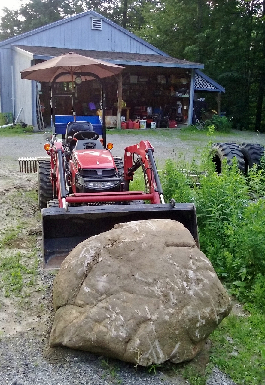

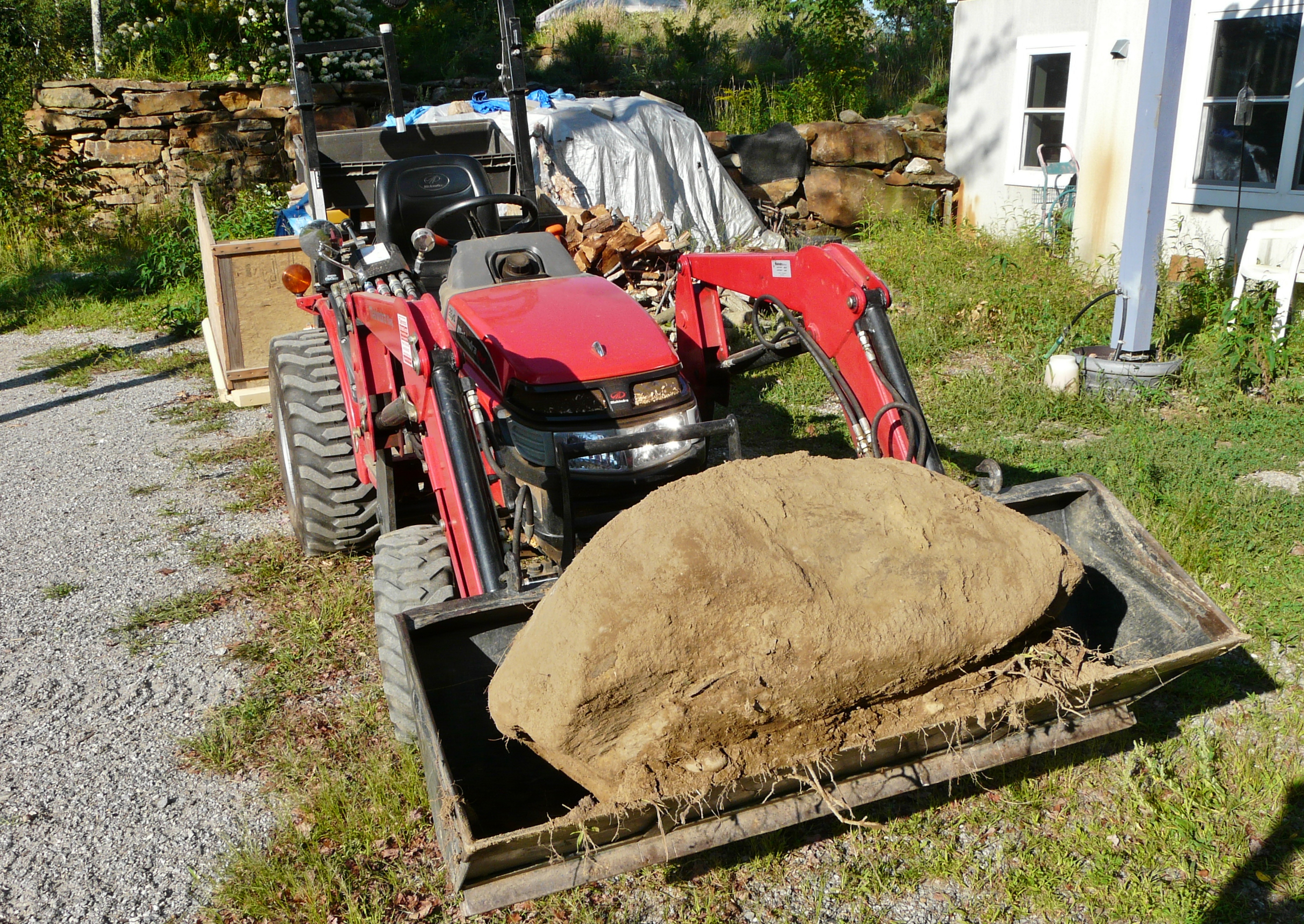

I found this little pebble in one of the loads.
With suitable counter weight, any Max26/28 should be able to lift a rock this size, but scooping it up out of the pile, the larger curl cylinders proved their worth.

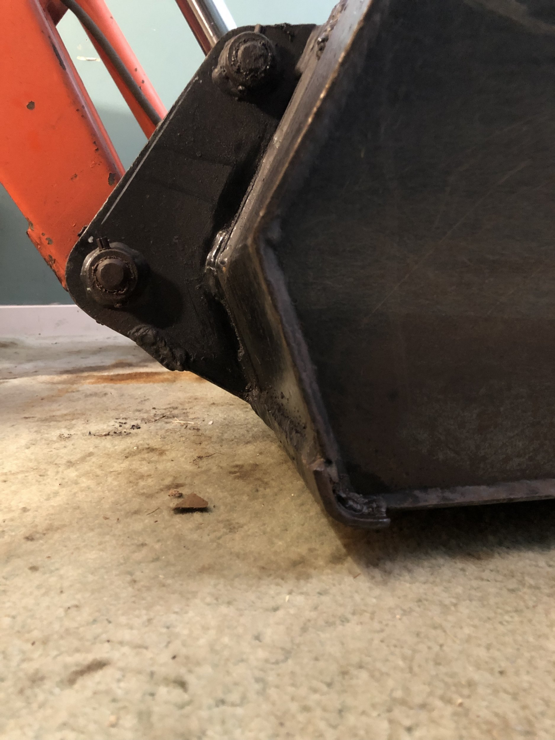

I'm also glad I reinforced the bucket.

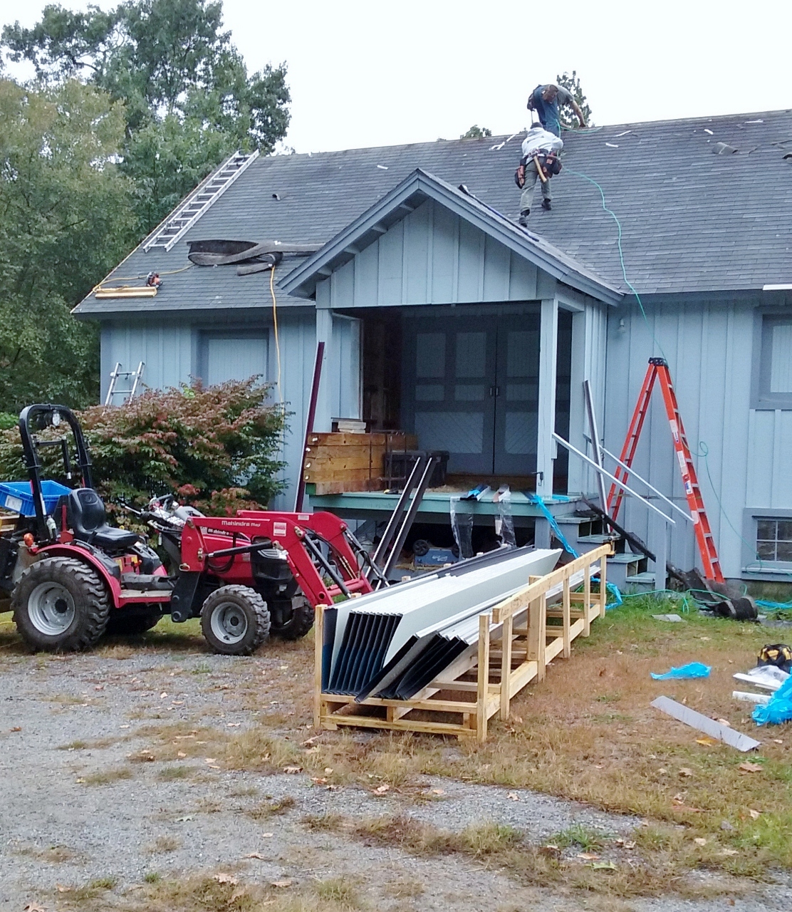

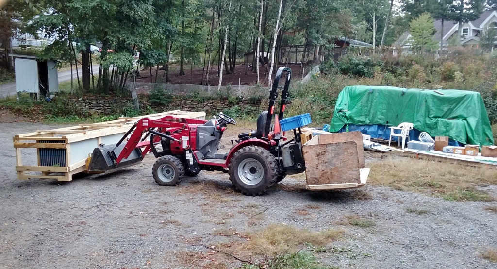

Max28 in better shape and working harder than me.
I Herniated my disc again, should not even been on the tractor.
Saturday after just a bit of work, I stiffened up so bad I can barely walk afterwards.

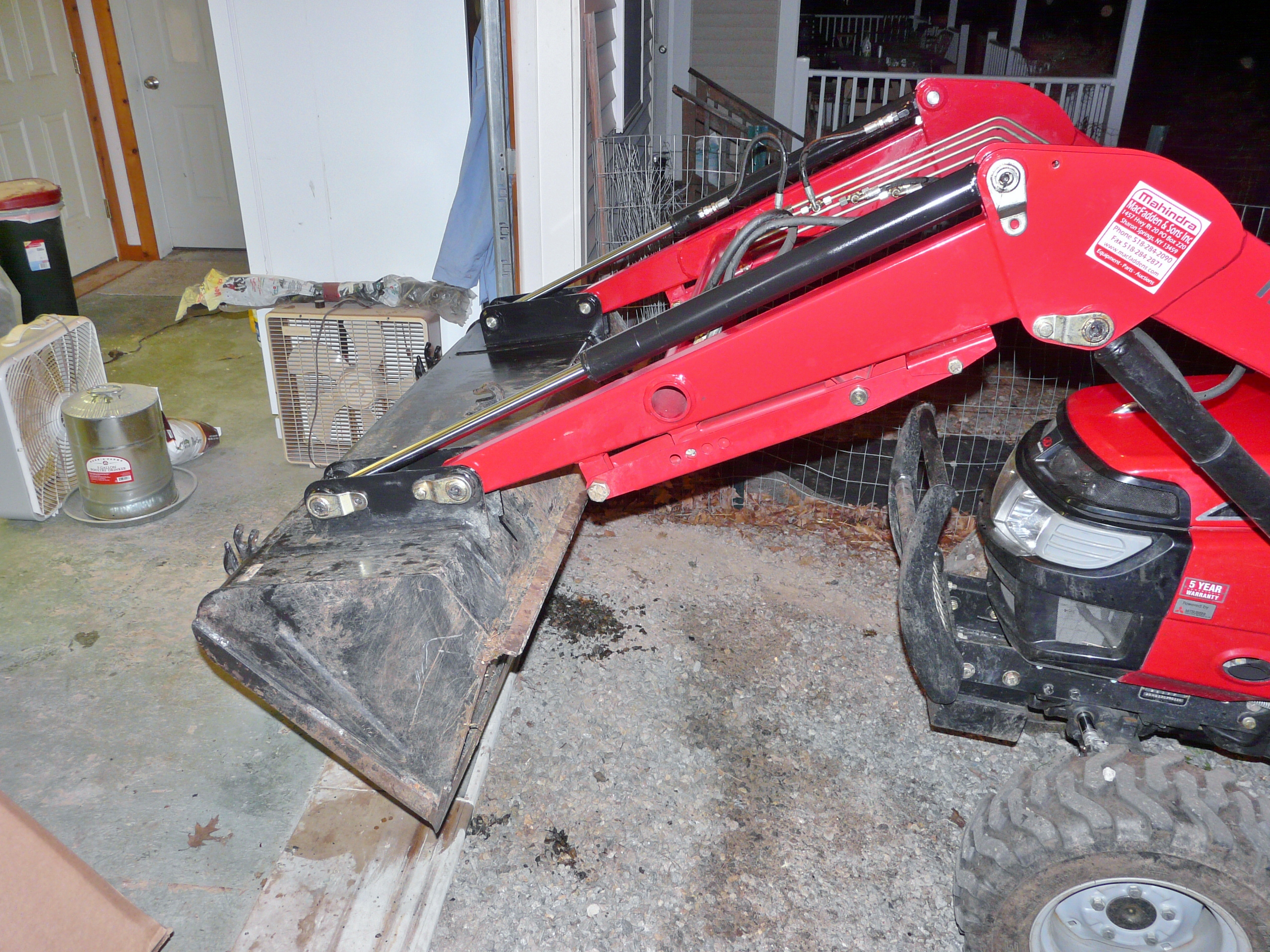

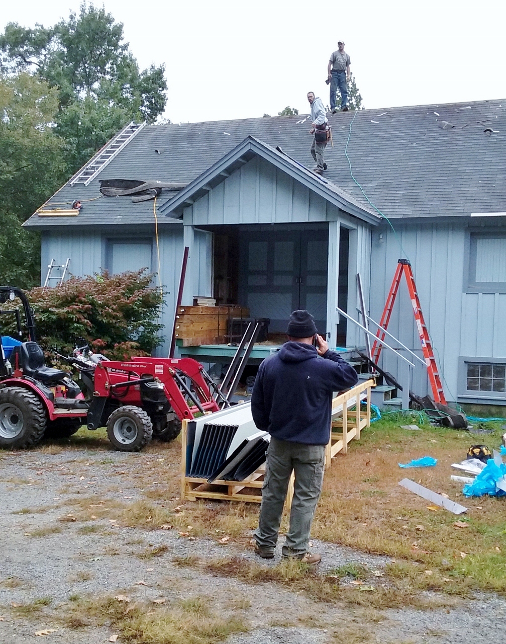

The roofing crew cam Saturday morning and was going to hand carry the sheets to the other side of the barn.
I did not want the roofing crew carrying the panels sheet by sheet to the other side of the barn, as they surely would have been scratched up in the process.
it was little Max28 to the rescue.
First I needed to move the +1,500 lb crate of the longer 28 foot panels to get at the 18 ft panels.
The Max could barely lift the ends, getting really light in the back, even with counterweight.
I calculated he weigh of he panels in the 18 crate to be a bit over 900 lbs, and the weight of my forks and the crate itself to be about 100 lbs, so the Max was able to carry 1,000, of load over 1 forward of the bucket edge.
I could not ask any more of the little guy.
My neighbor was kind enough to install the backhoe trunion swing cylinders on my L39, so a little more progress has been made on the L39 hydraulic rebuild. I still need to get the front bucket curl cylinders back from the hydraulic shop and weld new bushings on the worn 4 bar bucket linkage. The L39 rebuild is turning out be lot more involved than he upgrades I have made to my Max28.

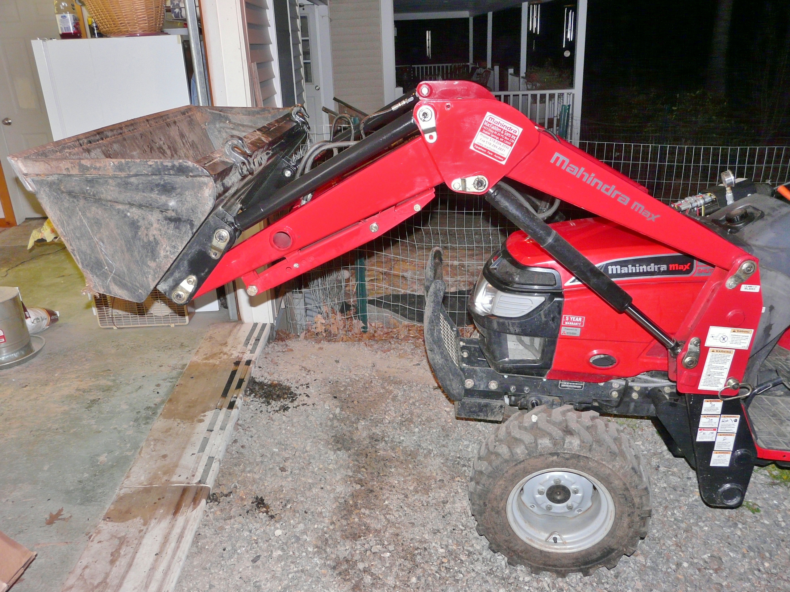

L39 is back together, stronger and better than ever.

The original asphalt shingles are still on roof. Roof was not leaking, and was 1 layer. Hi temp fabric and Bituthene® 4000 underlayment was used, and Roofer did a good job. 24 gage roof is a heavy roof. What He did still maintains warrantee on roof.
Final wiring on Solar not completed. It 's control system is wireless, relying on the internet.
So much for being a Prepper when the SHTF.

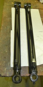

Re: Weak Loader Curl Possible Solution For the Max28 (Drawings attached)

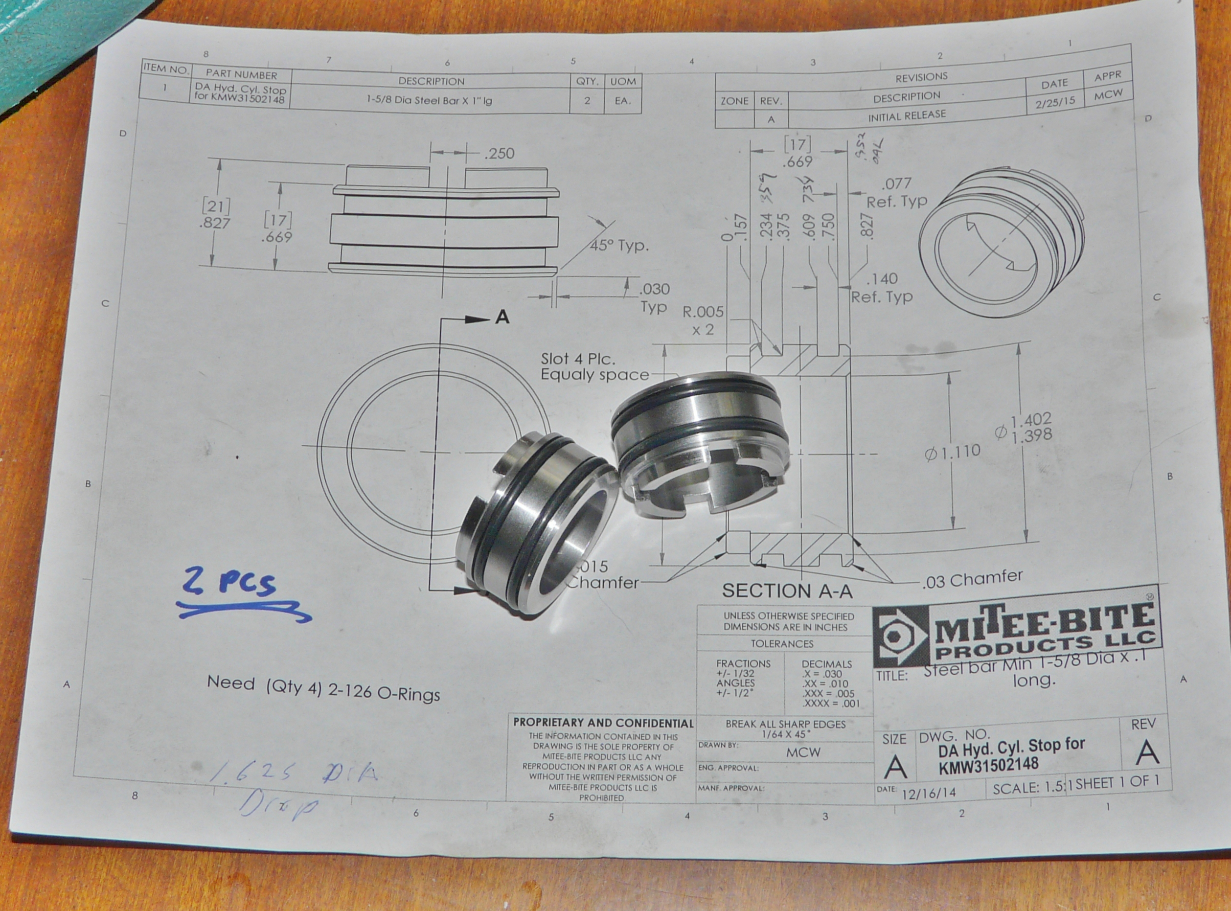

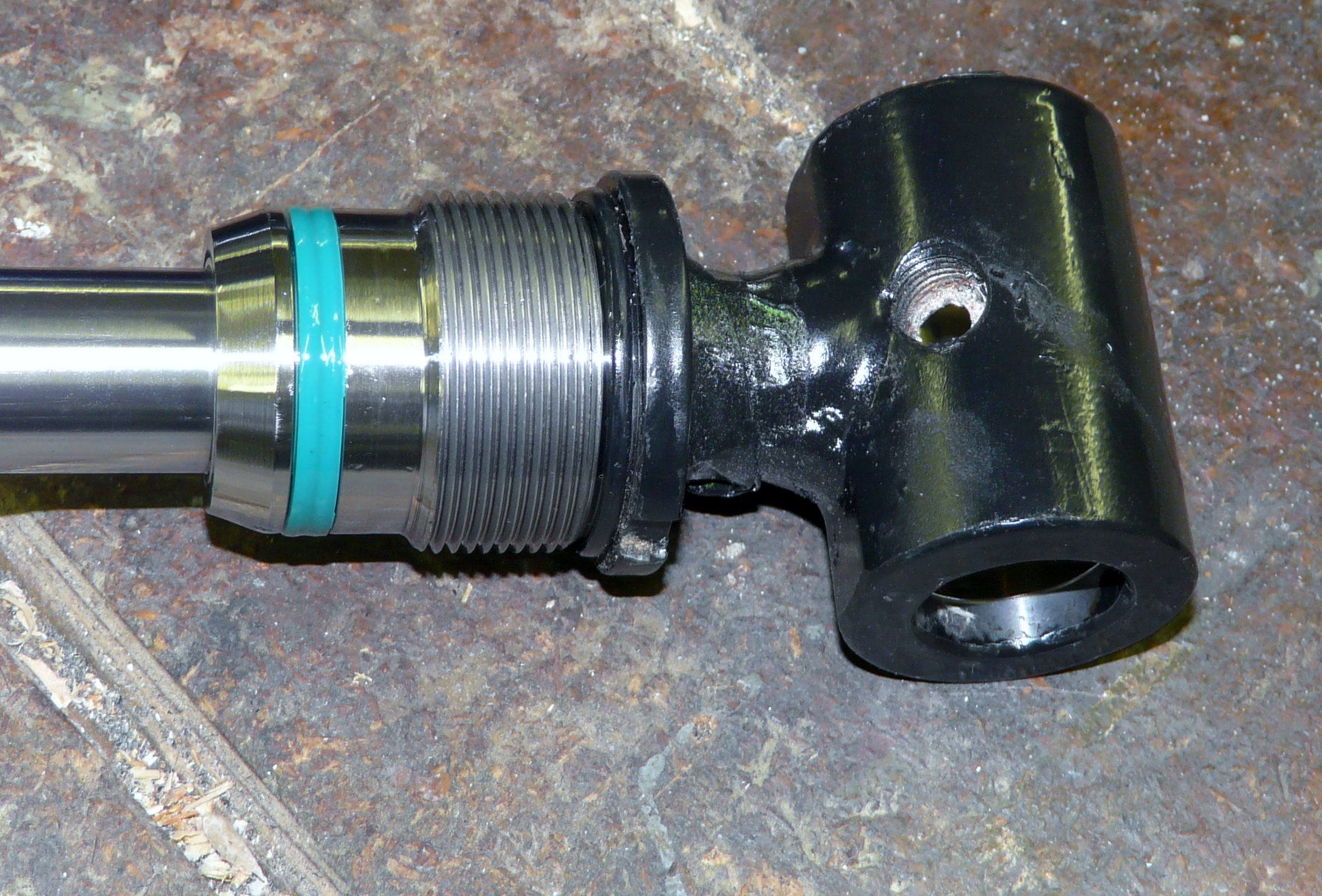

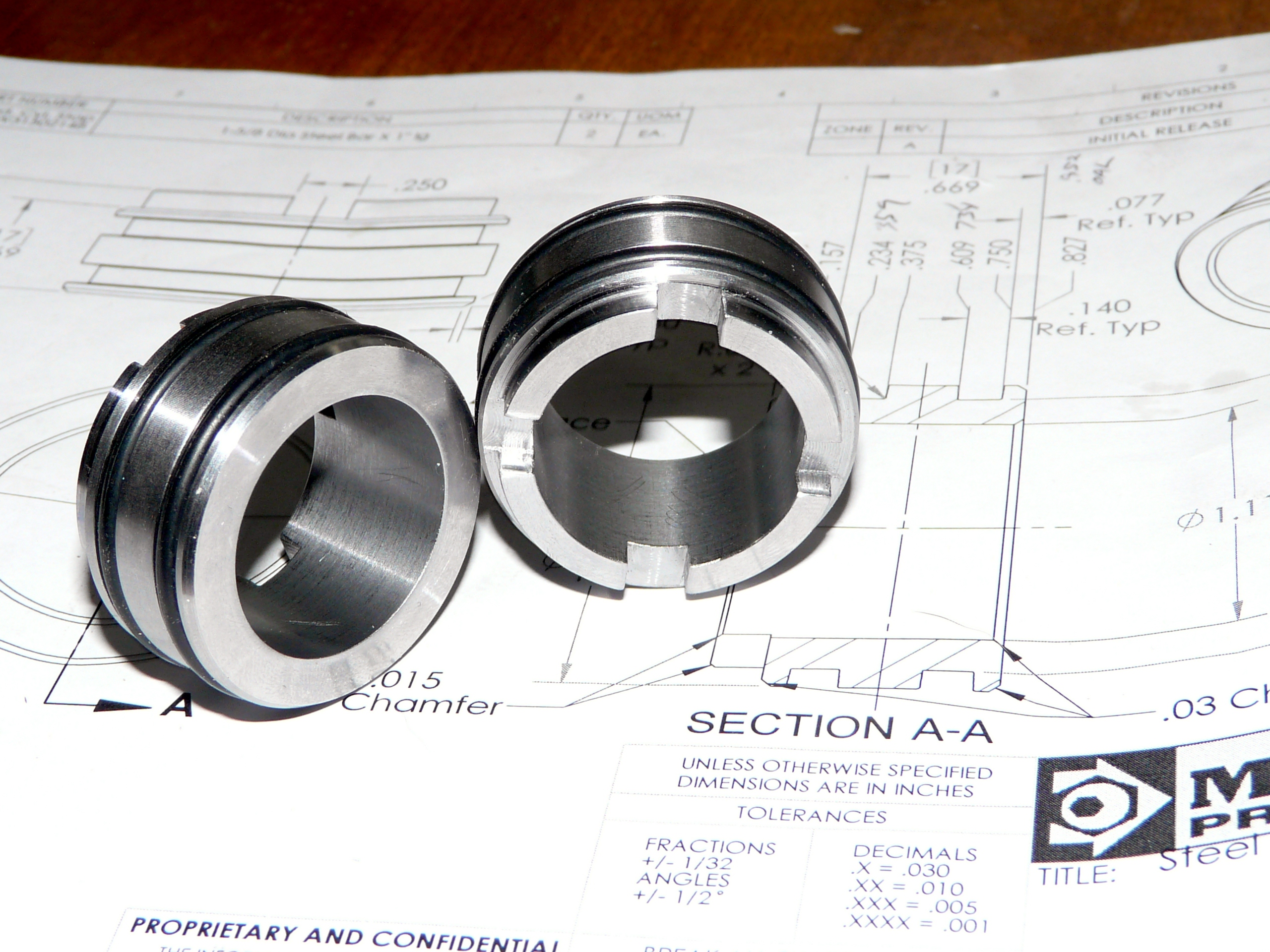

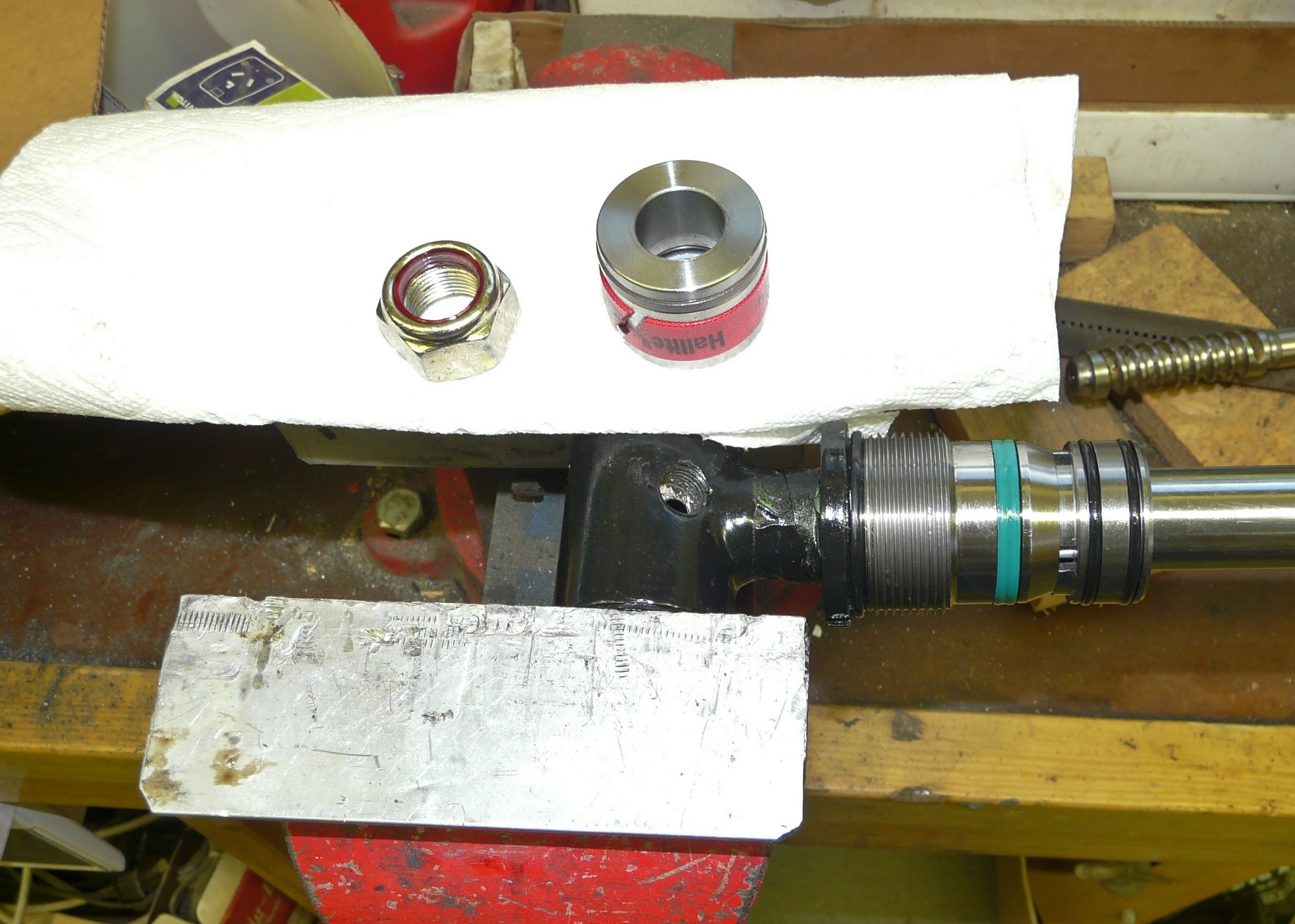

If anyone wants i can PM you a spreadshead to caculate how much changinging cylinder size will effect capacity.
I can consider haveing Cylinders for othe loaders done also.
Attached are some cylinder drawings for the upsized Max28 with Ml205 loader.

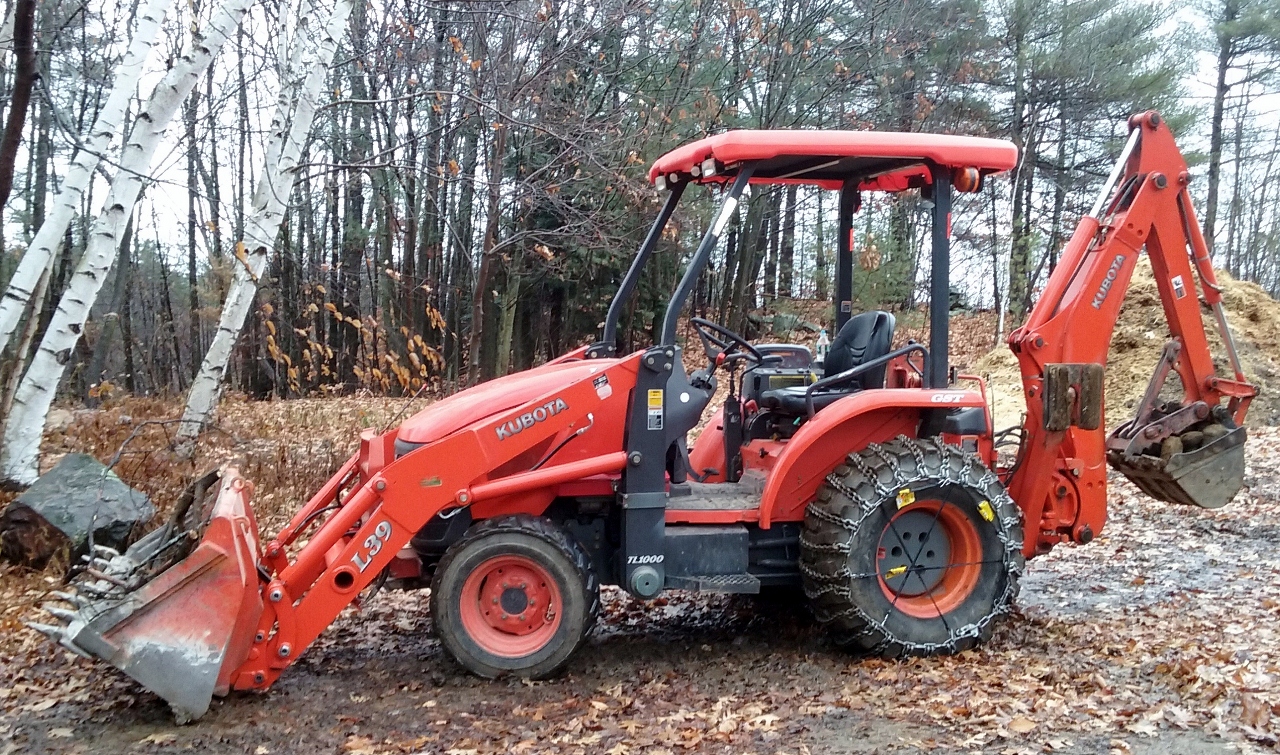

See the tread link below for a view of a rock my L39 could not carry. The L39's strong Backhoe struggled to get it out of the ground. I doubt an Mpower 85 could lift this rock.
See Post #50
http://www.tractorbynet.com/forums/...r-5.html?highlight=Do+you+have+enough+tractor
The Max28 was able to roll over these rocks my L39 did carry in the attached pictures below. Close to 3,000 lbs.
/ Weak Loader Curl Possible Solution For the Max28 #78
See Post #50
Mowing - Do you have enough tractor?
Max 26 handling round bales - YouTube
PS This is a little tractor with a flexy frame. It will not handle wet bales with the loader, especially on uneven ground.
The 3 Pt is a beast, so you could move bales with a spear on the rear. That is only safe way.
Kubota is a nice tractor, weaker but nice.
Mahindra vs. Kubota at Moe's Outdoor Equipment & Supplies! (217) - YouTube
First off , the salesman is a sales, has little understanding what he is talking about for some points. What he said about the mid point PTO is reversed, the Kubota runs at the higher RPM for same motor speed. Hp for HP, the Kubota is torquery. Although the Shuttle is slick, it is not fully synchronized, only the forward/reverser. Max26/28 has aluminum Gear case covers, etc. which the 3 point bolts to. Max is about 200 Lbs heavier, no big deal.
Hey mike I realize this is an old thread but it is an awesome writeup on some adjustments that can be made to tractors today that seem to lack in one way of another. Great job. I own an older 98ish Allmand 25k TLB and I am trying to design a quick attach. I was wondering if you would be able to take some measurements on your bucket ears for comparison. Your loader seems almost like a newer version of the loader on my tractor. I have 1” pins spaced at 7 5/8” on the loader bucket ears. 29 3/8” inside to inside of loader bucket ear bracket and 37 3/8” outside to outside of loader bucket ear bracket.
