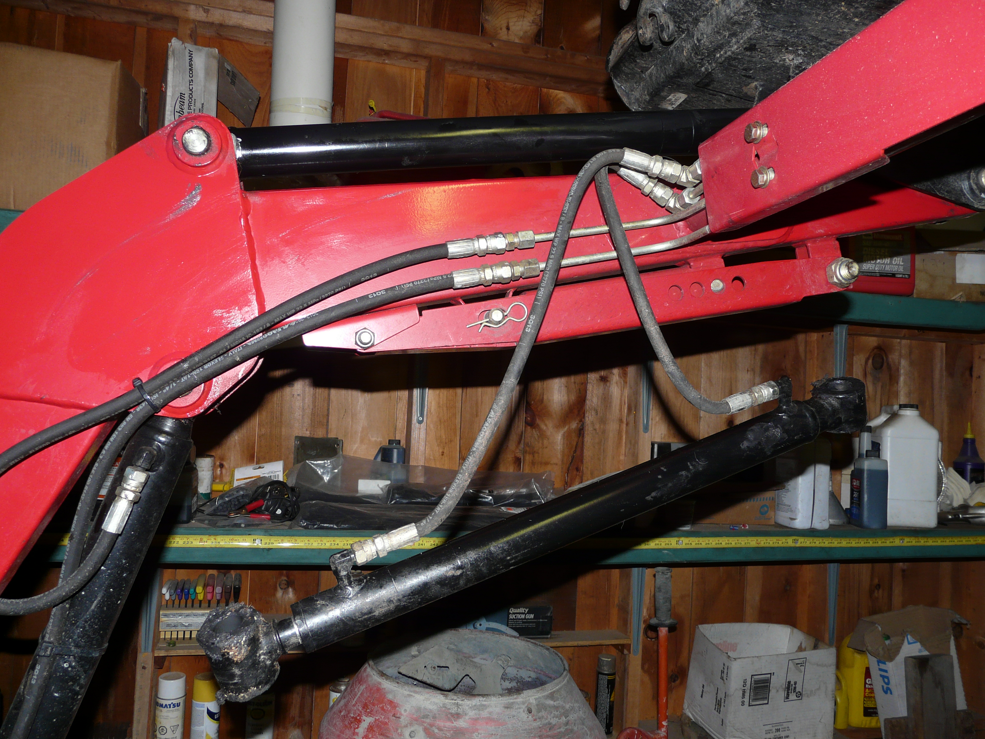

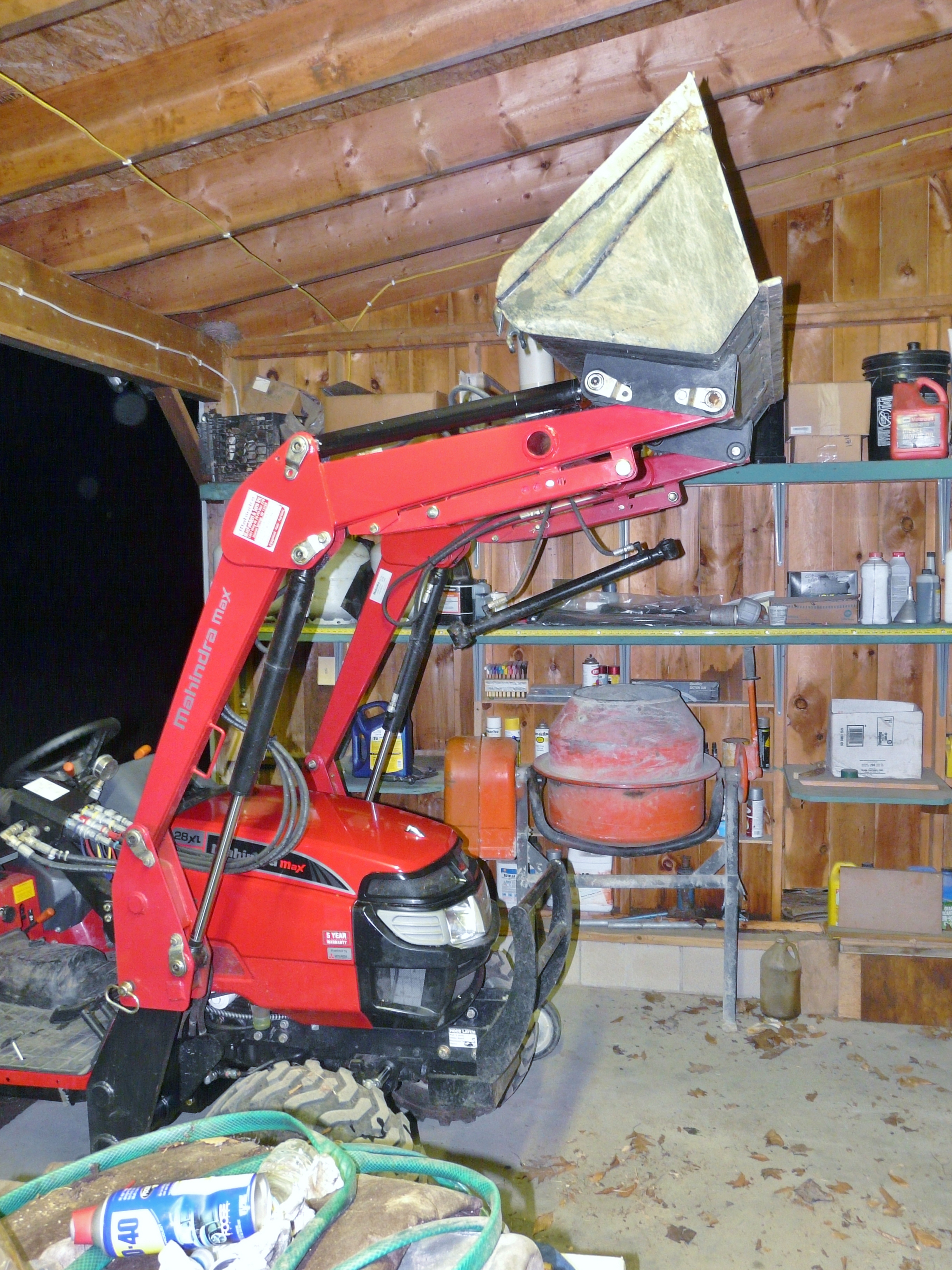

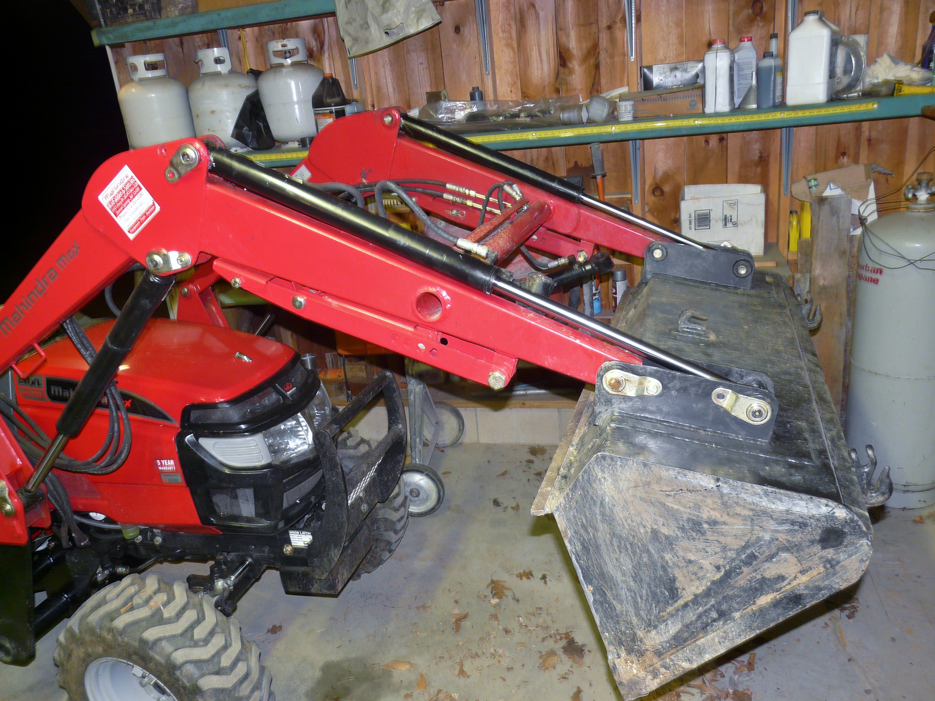

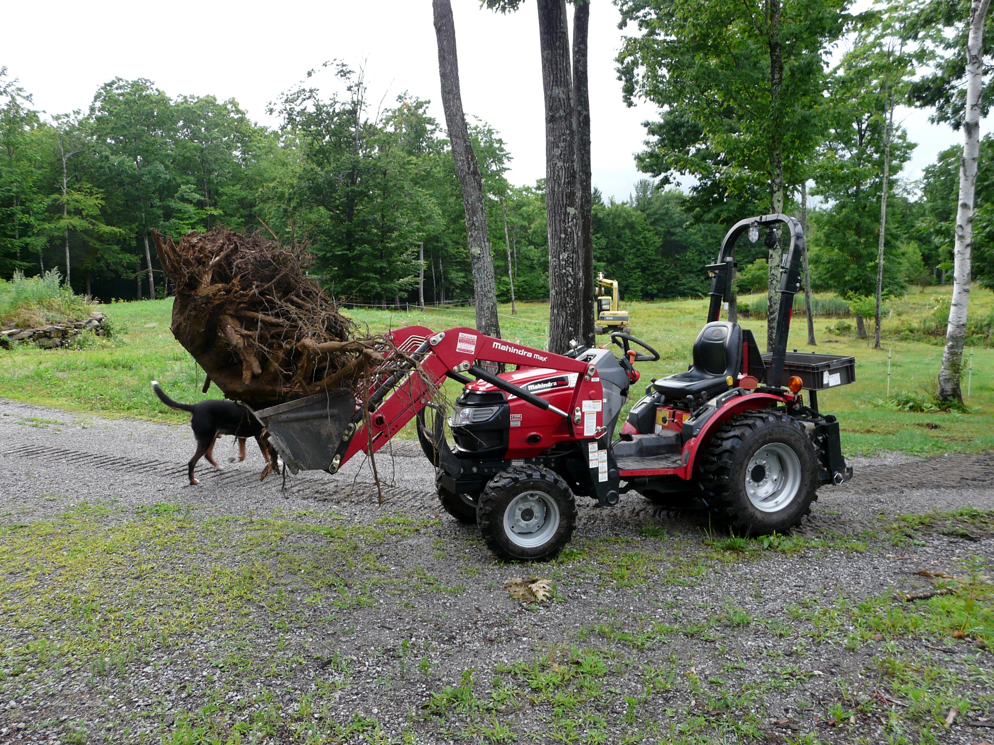

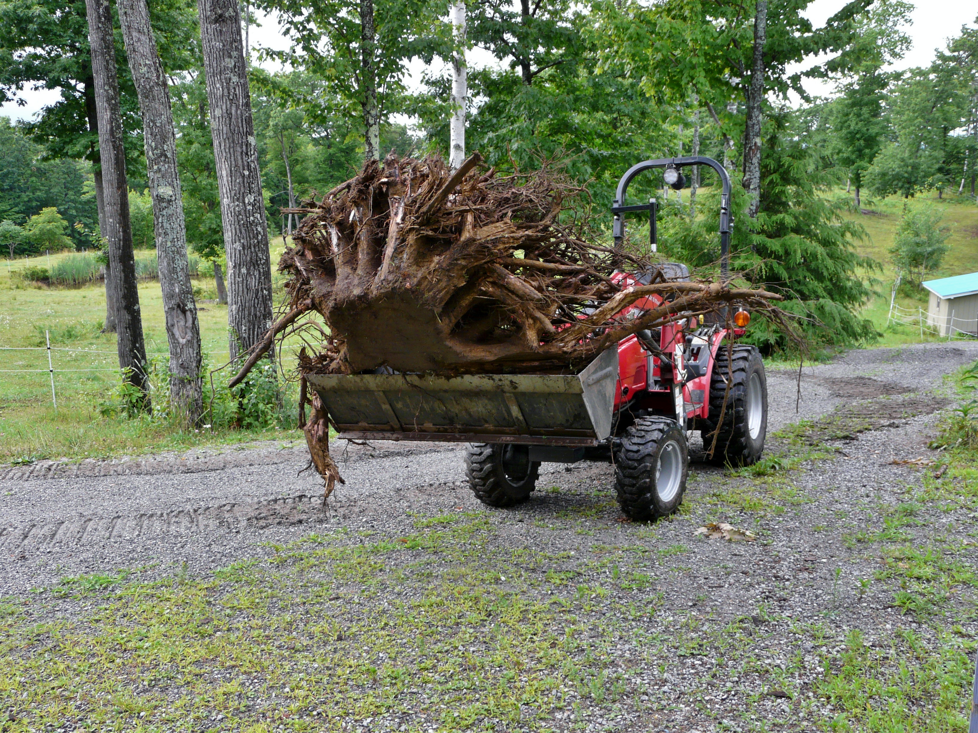

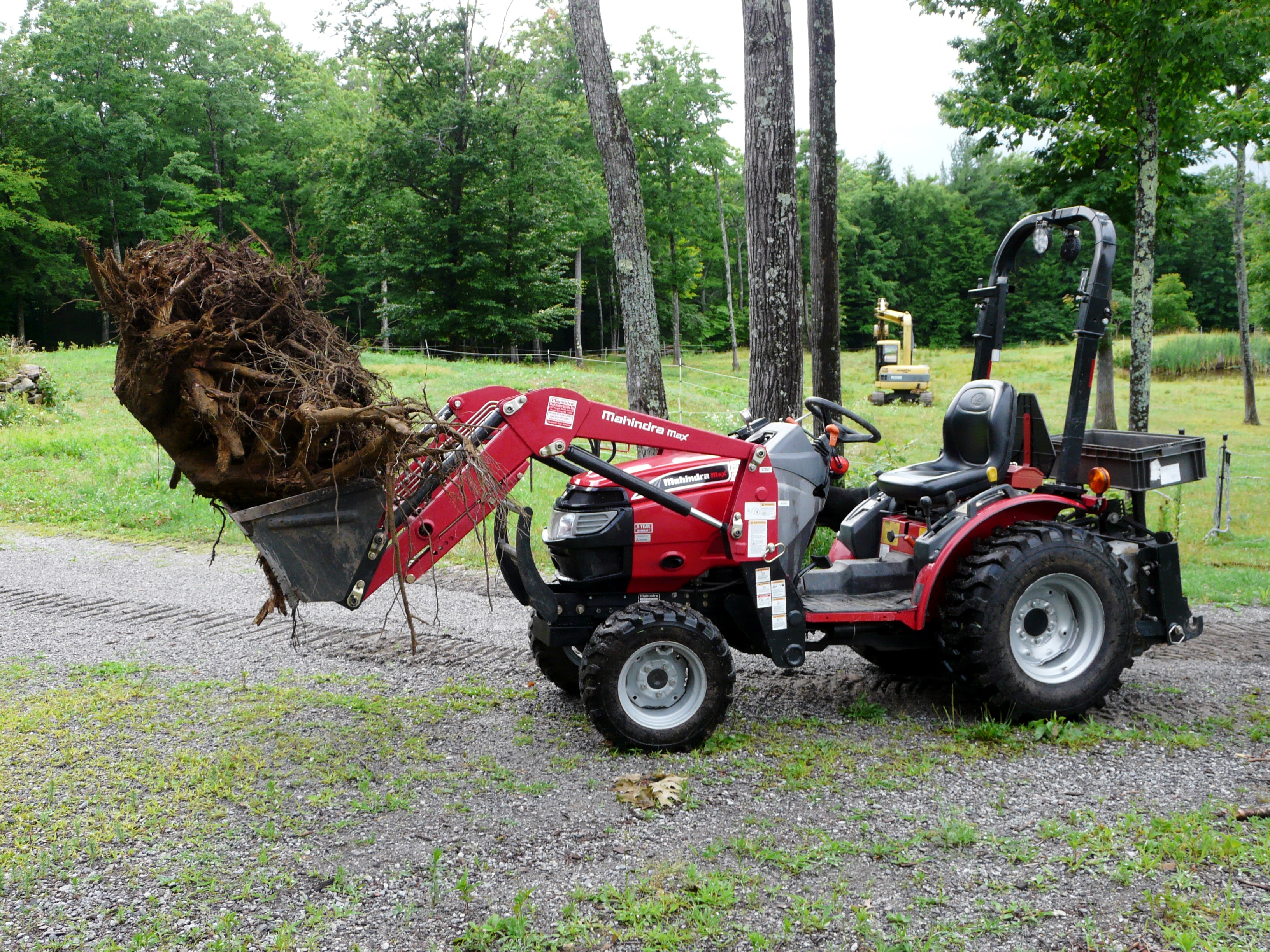

Just a test to see what it can do. I'm very happy the way this turned out. Now if I could figure out how to make that budget loader control valve have the fine sensitivity of a premium tractor...
/ Weak Loader Curl Possible Solution For the Max28
#43

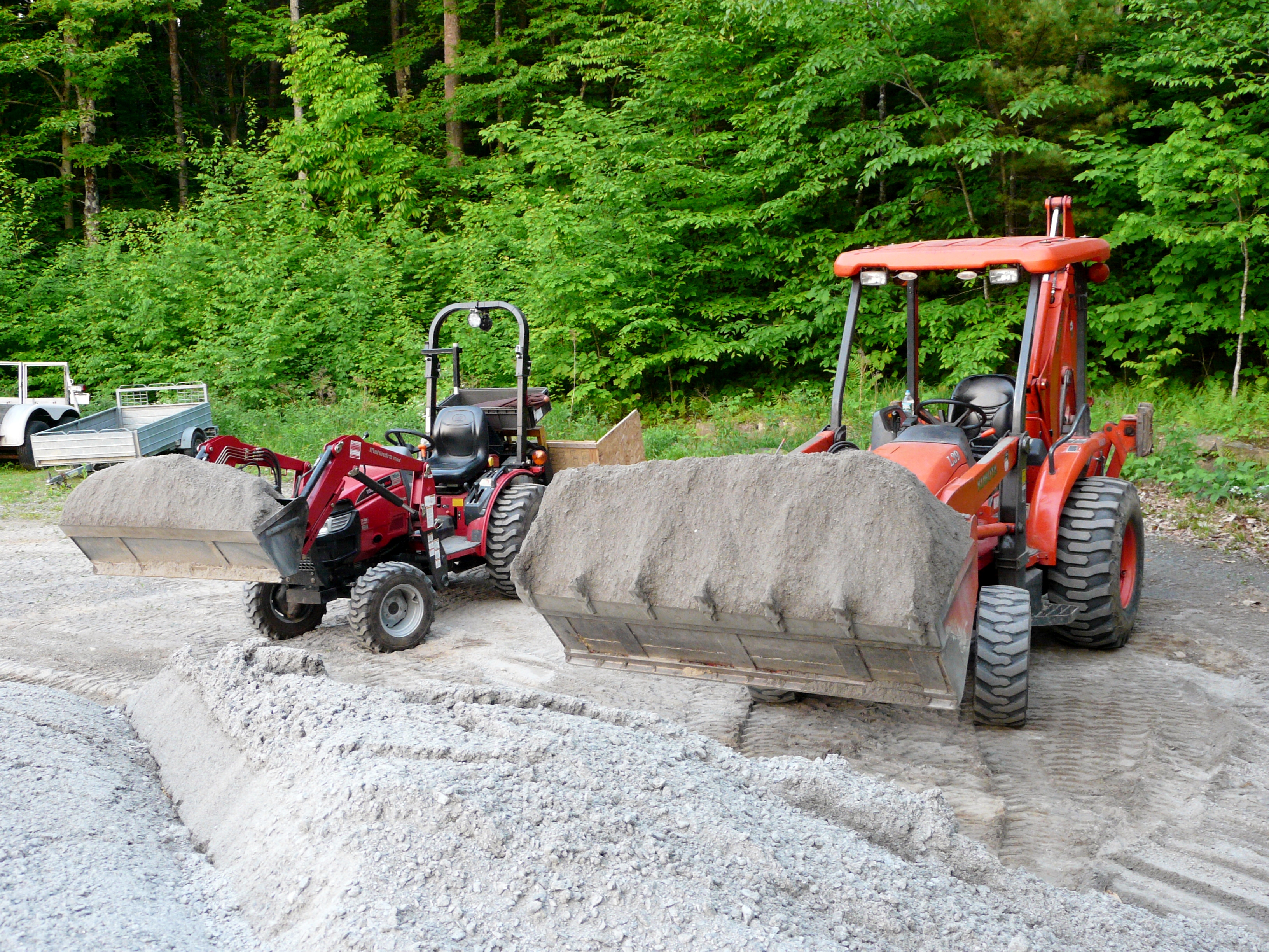

Why didn't i do this sooner?
In less than three weeks I put 11 hours on the Max28, 4 hours on the L39, and about 1-1/2 hours tops on the excavator.
That says something for the versatliity of the little Max.
4 top mods to my Max28, All of them rated essential.
1. Suspension Seat & cup holder
2. Worklights
3. Modified Quick hitch with Counter Weight Carry all, Adjustable trailer hitch, Plow, tow hooks, etc.
4. 40mm curl cylinders for the "Popeye" effect.
To move spoils, I drive into a pile in 1st gear low 2wd at 1500 rpm or less with 750 lbs. on the hitch for CW, wiggle and bury the bucket deep into the pile, while not touching the clutch, letting the rears spin just a bit. Then just shift into Hi range reverse while taking a more than bucket full for loosened up material out of the pile, and on my way to dump and spread. I moved and spread 34 tons of gravel in 4 hours to a spot that I could not maneuver my bigger L39. Quick, simple, no HST whine.
Today I moved about 10 tons of gravel down to the end of my woods road with he Max.
I could have used the L39, but it is not as easy to fit down the twisty, hilly, narrow road, and all to easy to scar trees or damage the tractor.
Then I took the dogs for a walk down the road but came back throught the pasture. I found 11 ticks on me tonight. I think I'll be staying out of the tall grass.

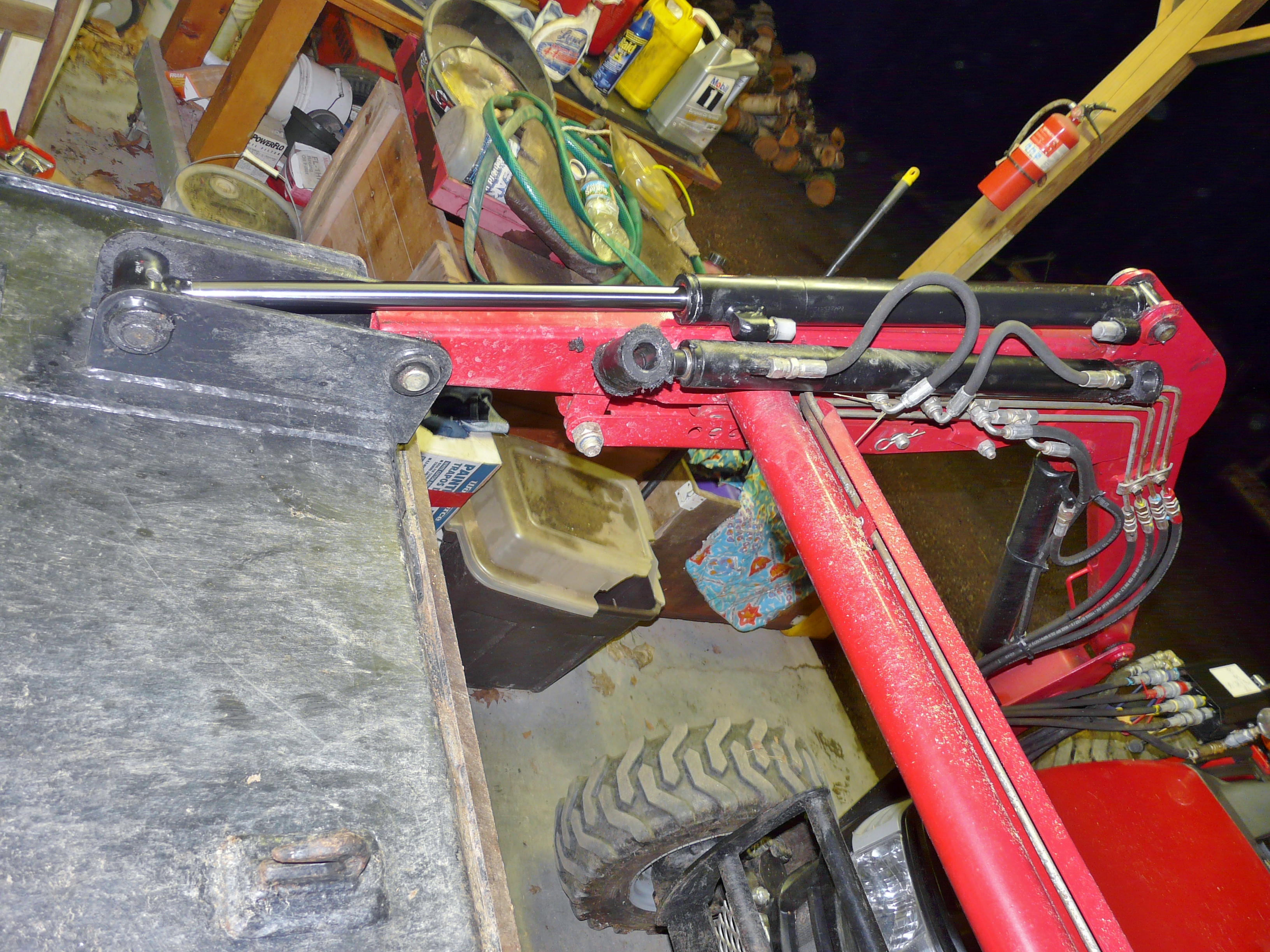

Weak Loader Curl Solution For the Max28
Just another picture
