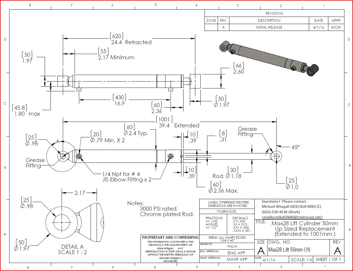

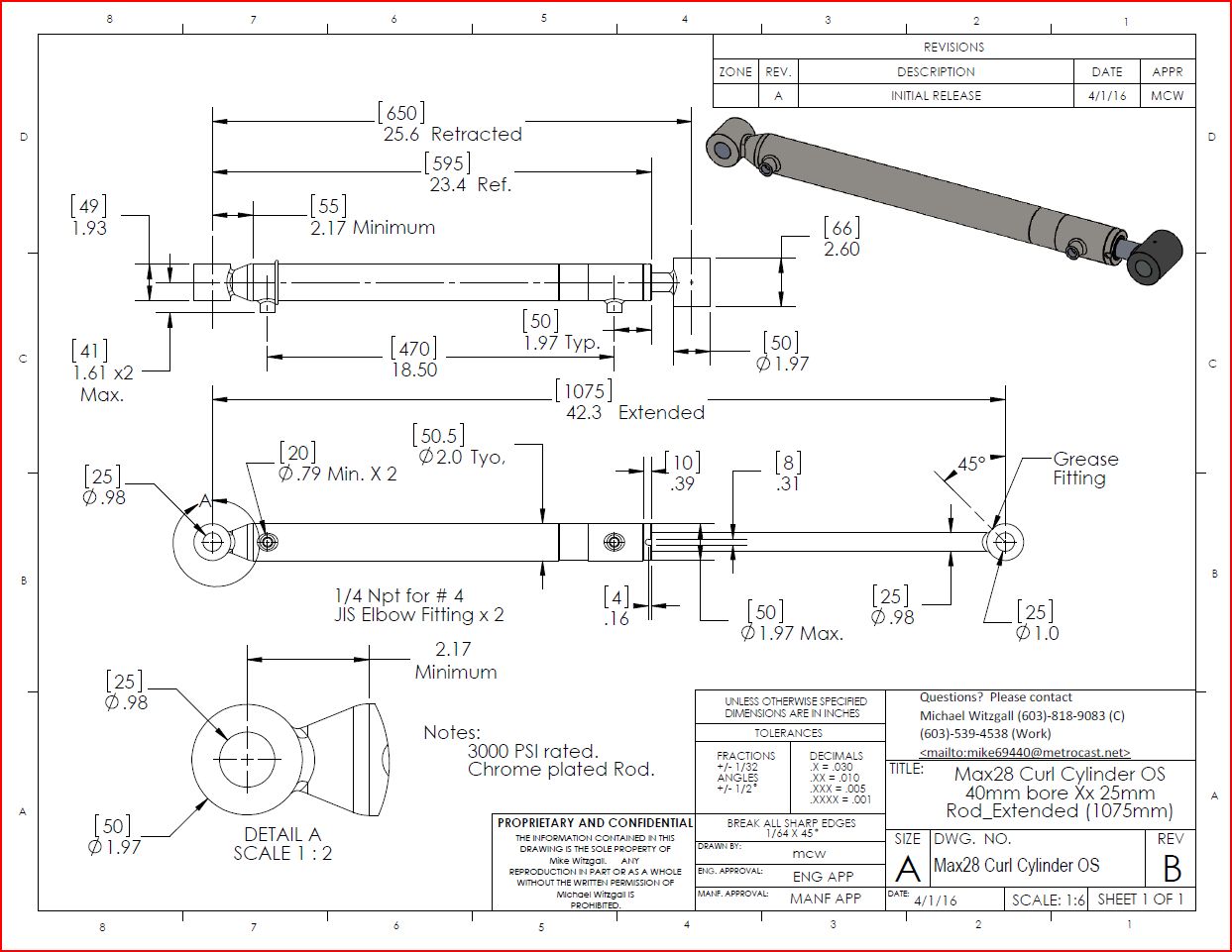

Re: Weak Loader Curl Possible Solution For the Max28 (Drawings attached)
If anyone wants i can PM you a spreadshead to caculate how much changinging cylinder size will effect capacity.
I can consider haveing Cylinders for othe loaders done also.
Attached are some cylinder drawings for the upsized Max28 with Ml205 loader.

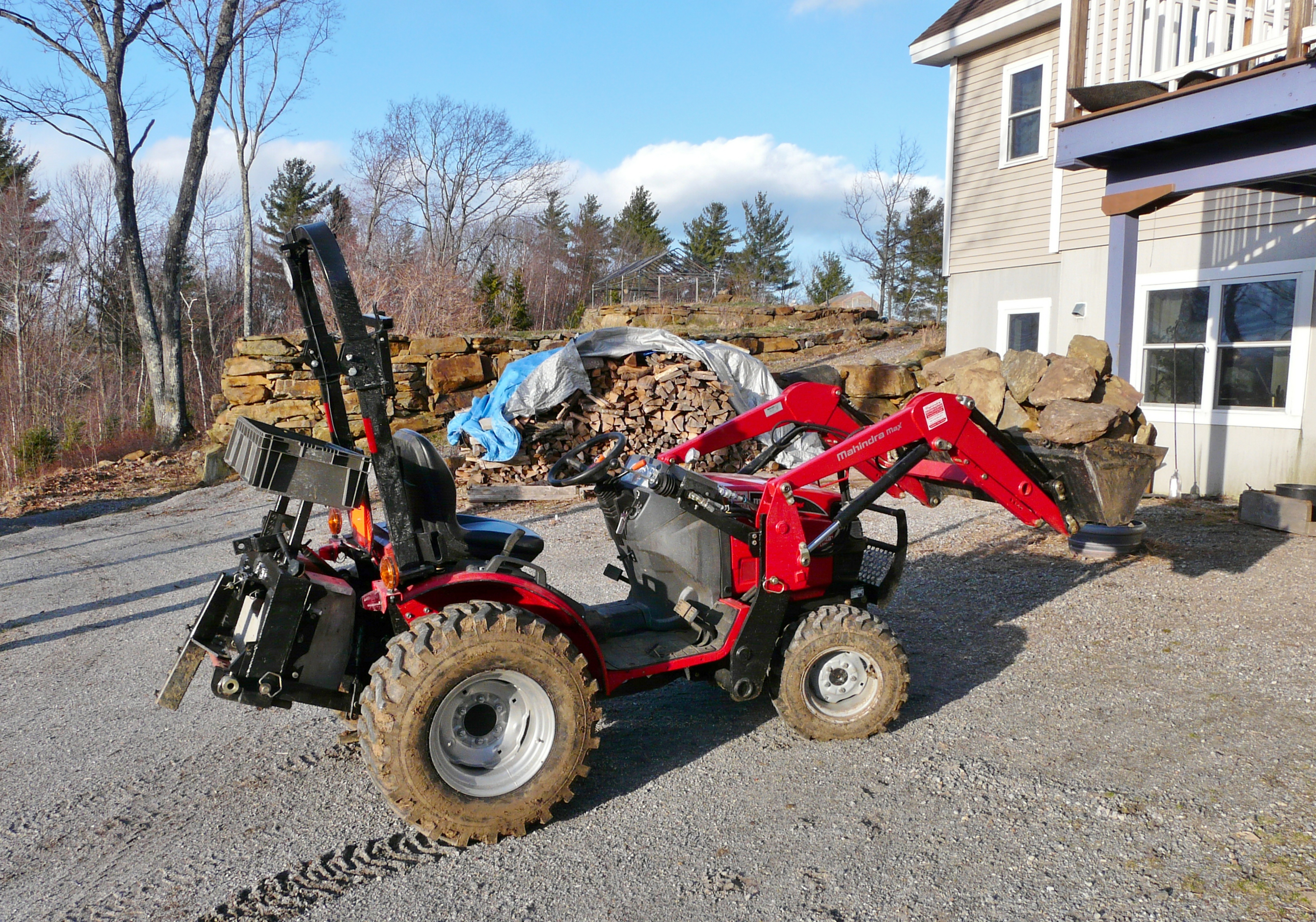

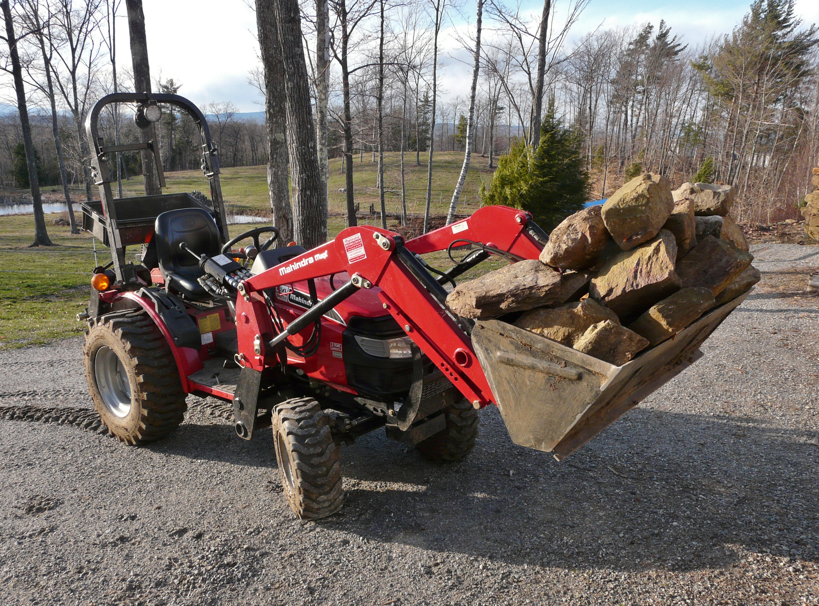

Re: Weak Loader Curl, used My max today to mve a few rocks.
It was cold today.
I was planning to blow out the outside faucets around the house because tonight it is supposed to be in the teens. I managed to blow the faucets in the front of the house that got some sun, but in was in the twenties all day and the 2 faucets in the rear of the house are frozen solid. Happy spring, everyone. It was 65 F Christmas day? Go figure.
One of the first things we (actually my wife) did about 8 years ago before we built the house at Brezzy Rdge Farm was she wife built 3 rows of terraced rock walls about 100 long for one of her gardens. Not all of the area got used for garden so she told me to get rid of the trees and brush so she could reclaim the whole area.
http://www.tractorbynet.com/forums/...weekend.html?highlight=busy+wife+this+weekend
Today I used my excavator trying best I could not to destroy her walls (somewhat a fail) by plucking the trees and brush using the hydraulic thumb. Darn roots took hold so even pulling vertically I still disturbed some rock wall, needing to rebuild about a 12 section. As my wife is not so keen on wall building so much any more, I was instructed to build some rock stairs into the garden while I was repairing the wall.
Wall builders know that fixing a damaged wall actually involves tearing the wall down and starting over. So I took the wall apart and piled the rock, the small stuff by hand, all the while being careful not to put myself in a wheelchair with my herniated back. Needing more rock, and not wanting to push myself like days of old, I took the Max28 rather than the L39 for a ride down my graveled walking trail to one of my rock piles for a few rocks.

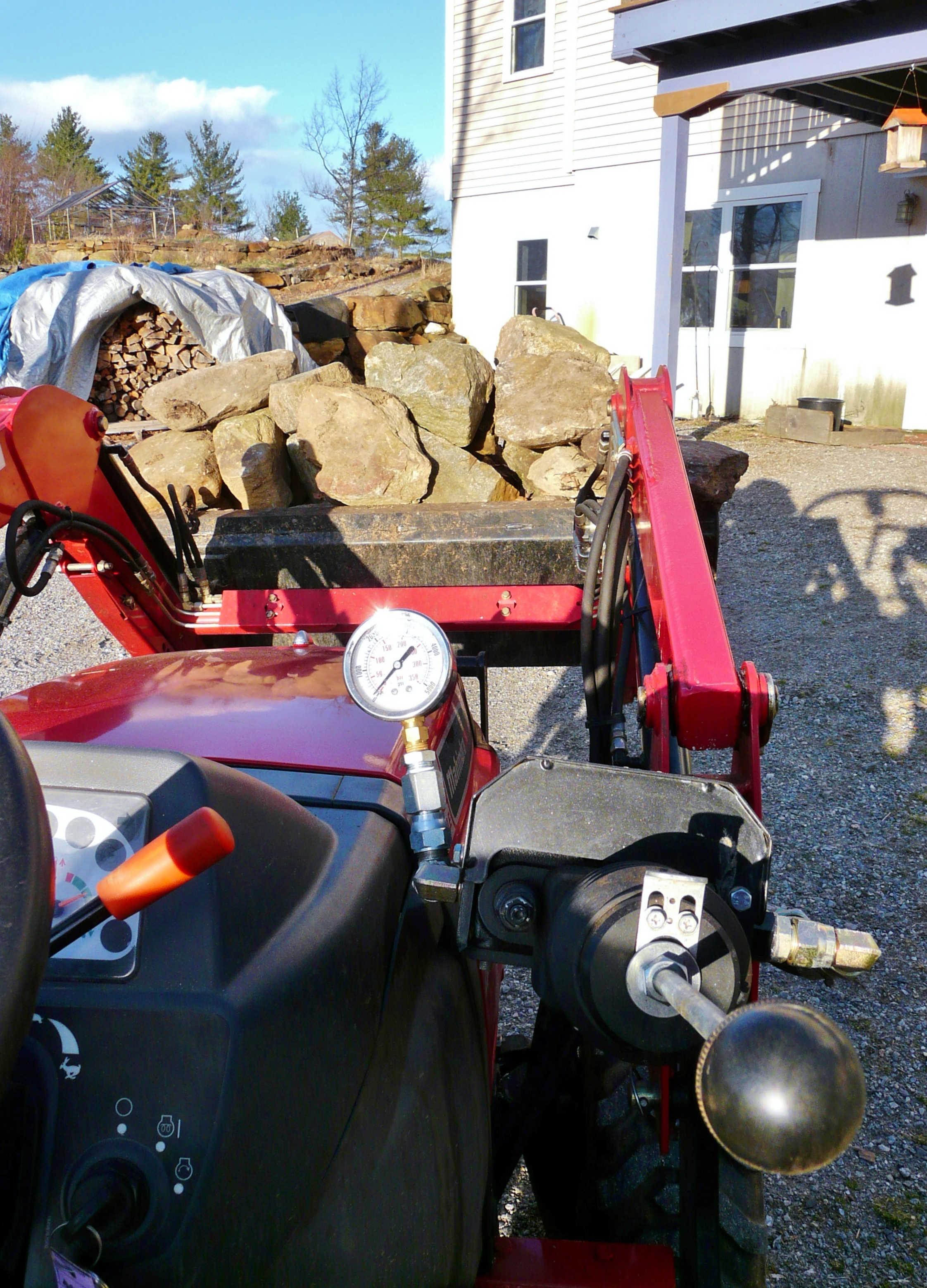

I have a pressure gage on the loader, which gives a good idea how close you are to the maximum capacity of the loader. I removed my old Fisher commercial duty plow from the L39 the other day and used the Max28 to carry and put the plow to storage. To lift the plow, chains over the front of the bucket required over 1800 PSI on the gage, as an example.
I point this out that the attached photos of the more than full bucket was less than 1500 PSI on the loader pressure gage. I was at 2/3 capacity of the loader max lift. I figure my plow goes a good 850 lbs with all the extra metal welded to it over the years, so that pile of rock I guestimate at about 750 lbs. it is a small 54 wide, 6 cubic ft Bucket.
So the max really does not need larger lift cylinders for lifting and moving stuff, thought the bucket curl cylinders struggle. Traveling with that pile of rocks you notice how the steering struggles unless you are on firm ground. And that the whole loader frame is way more flexing and bouncy than the integrated frame of the L39 is even with the L39 carrying 3x the weight.
The only reason I would go with 2 lift (50mm) lift cylinders is that using the max28 last week to spread 10 tons of poop into the area I plowed, it struggled to break the manure out of the pile. In any case the 35MM OEM bucket curl cylinders are pretty lame, and I intend on upsizing to a 40mm bore bucket cylinder.

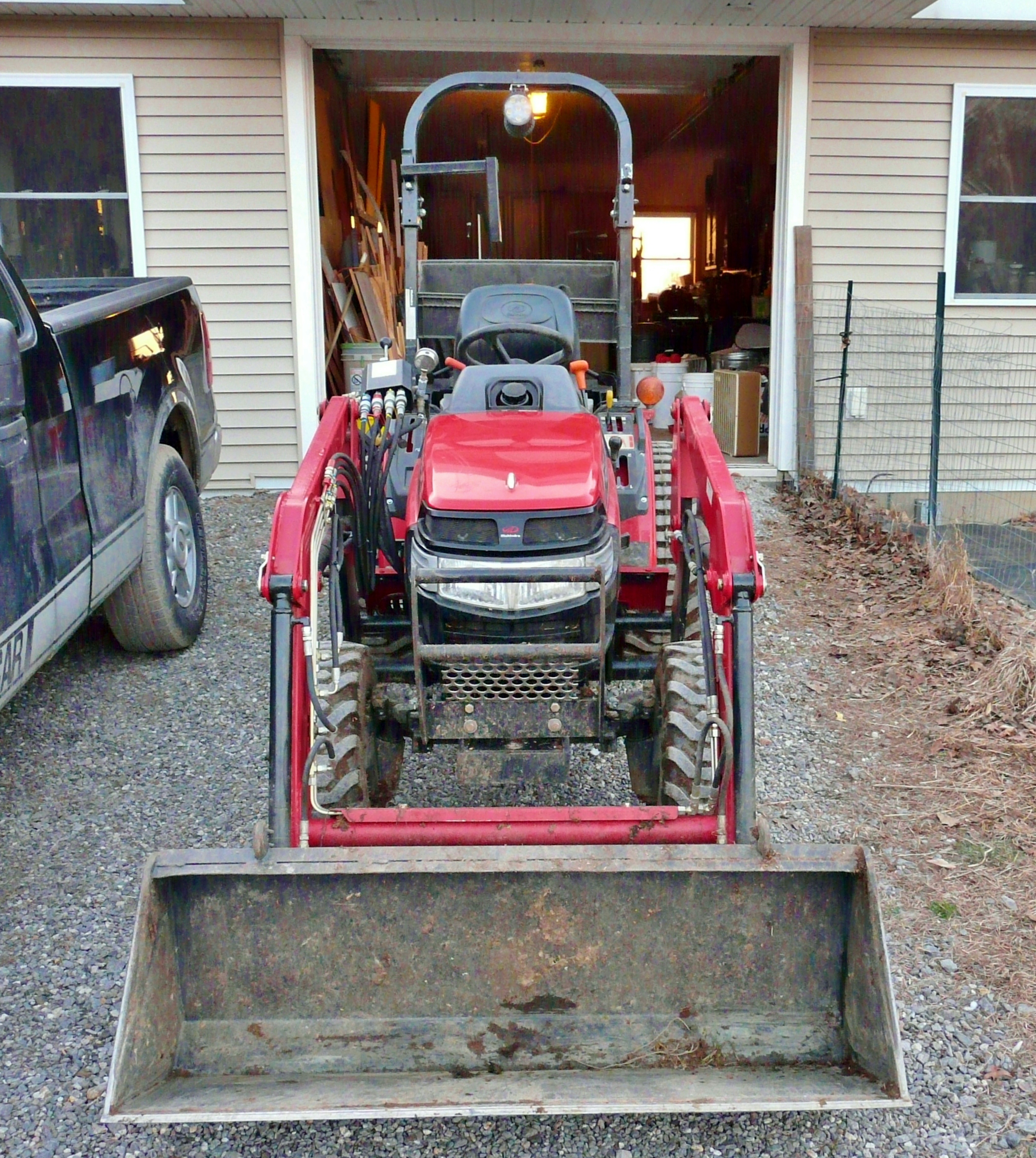

Just remember the tractor has a small footprint on the ground. My neighbor's Max 28 has similar (maybe better) lift specs than my L3200, but we both discovered that's no substitute for size. We were lifting two ends of a large log with our tractors and the Max looked like it was about to fold over sideways, everything from the loader arms on down to the tires. Except in a few controlled situations, I think the Max's loader is too strong for such a small machine. The paper specs are not practical in the real world.
/ Weak Loader Curl Possible Solution For the Max28
#15
The L3200 Loader is stronger in many ways than the Max. It might have same lift capacity, but curl is better. The Kubota loader is stiffer tan less jouncy on the frame, and the loader control is a lot more precise.
The L tractor (or other mid size compact) is bigger, wider and heavier being more stable. Day to day heavier work the L beats the Max28.
I would only use the extra like doing pallet work in tight spots and heavy lifting using the center of the bucket, always keeping load near the ground. Here the smaller Max will go places a larger machine just can't but has the ability of a larger machine.
The Max28 is small enough to get in our barn and work in the confines of our small gardens and paddocks but is not a toy.
PS: Note that 1400Lb lift rating has a caveat in the fine print stating the rating is based on a pressure about 100 Psi over what the machine is set at the factory. Still, even with 500 lbs. plus of counter weight, I pucker just at the thought of lifting 1000 lbs. full height.

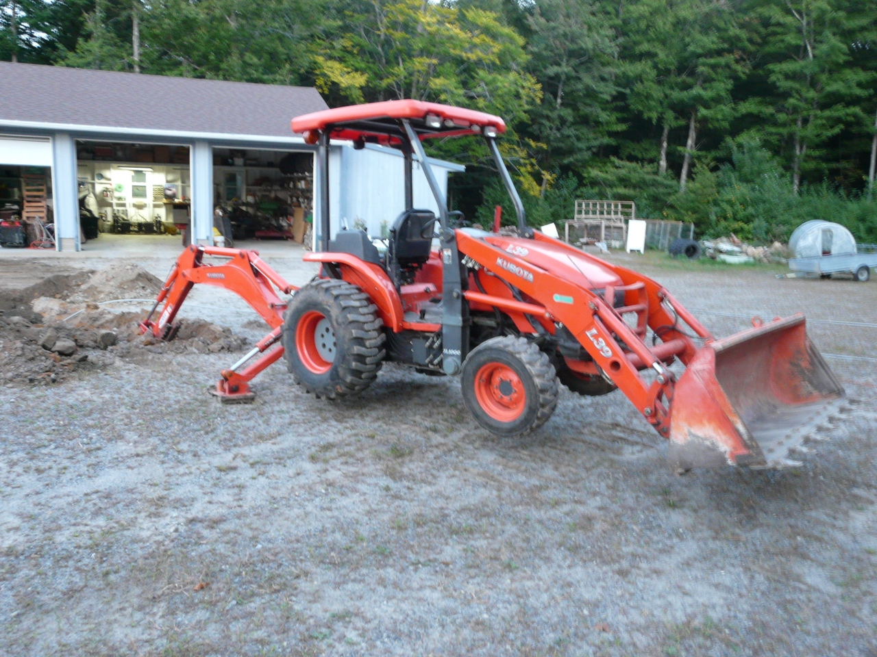

Tomorrow I Pick up the 1526L 40mm bore cylinders for my little Mahindra Max 28
Also I found these guys in Maine, The first people willing to work with me regarding hydraulic cylinder fabrication for my L39 Kubota.
Most likely on the L39 I'll end up with 60mm Lift cylinders vs stock 55 and 70mm Curl Cylinders vs stock 60mm size.
Kubota now sells replacement upgraded 65mm curl cylinders for the L39 at $900 apiece. Way too much for me, but I am told they are premium cylinders.
For anyone in new England looking for hydraulic shop that will bother to speak with you try:
